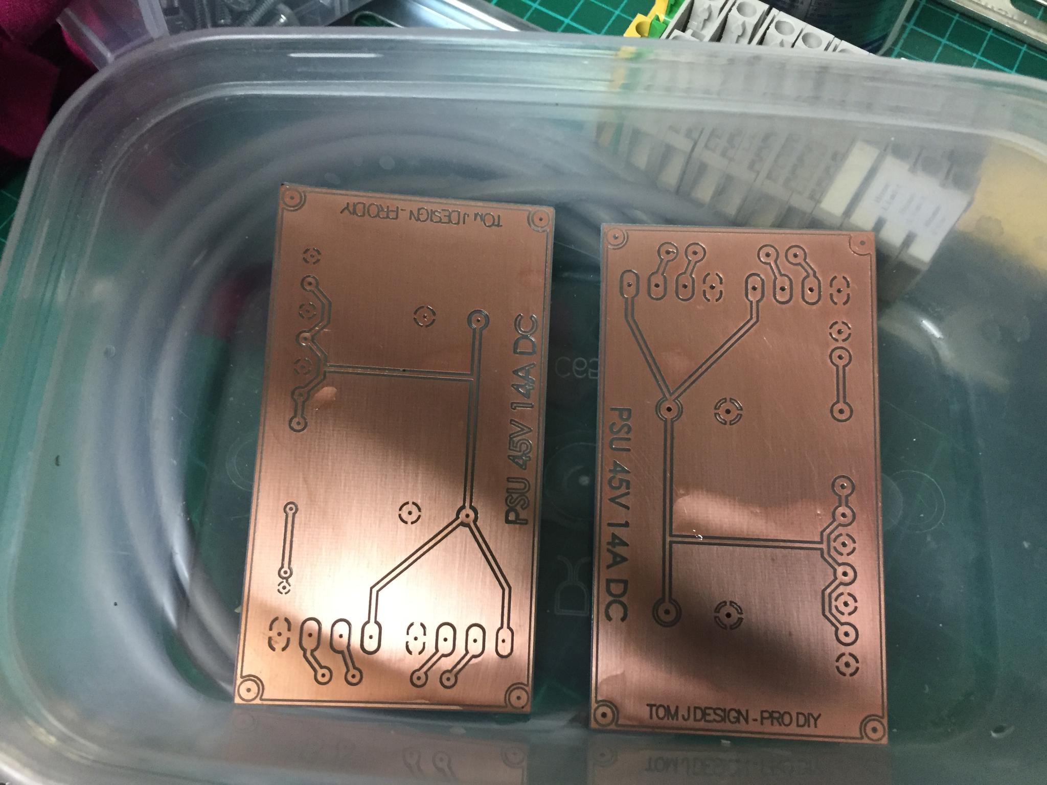

    this is my pcb with rectifier and 2 capacitors.
    Attachment 20217
    The tracks you have for the DC positive are wide enough for maybe 3 amps ... certainly nowhere near 14A. The current wont be near to 14A, but still those tracks are optimistically sized.
    You could do something similar to mine - happy to share the dxf for the PCB.

    This is wrong on so many levels.
    Please don't push 14A through that PCB.

    10 amps through a similarly sized track:
    Attachment 20223
    Attachment 20225
    Attachment 20224
    So don't forget the volt dropped across the PCB track
    Jonathan this pcb is for 3x3A steppers which takes no more than 7A from my calculation, but real test by clamp meter revealed that was no more than 0.86A therefore even perforated prototype board worked fine (but should not)
    I really should't show that - 1st pcb cut (on the left was Eagle pcb, on the right my revised version which still is not wide enough)
    For my 70VDC 7A motors I use the same layout but wider path on pcb.
    Just checked current-carring capacity and 1mm2 will handle 11A.
    For 16.5A i need exactly 1.5mm2 conductor, so 1mm pcb has 0.035mm of copper.
    Path width=1.5/0.035=42.86mm - my entire PCB is 50mm wide, according to this calculation we both wrong

    Poorly rectified AC going in to a inductive load with a chopper circuit controlling the current.
    What could possibly go wrong?
