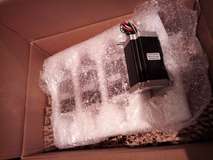

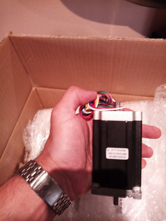

    Came from work today and a box was waiting for me,motors are here!
    AM882 are one their way home and I have to decide about the breakout board, any suggestions?

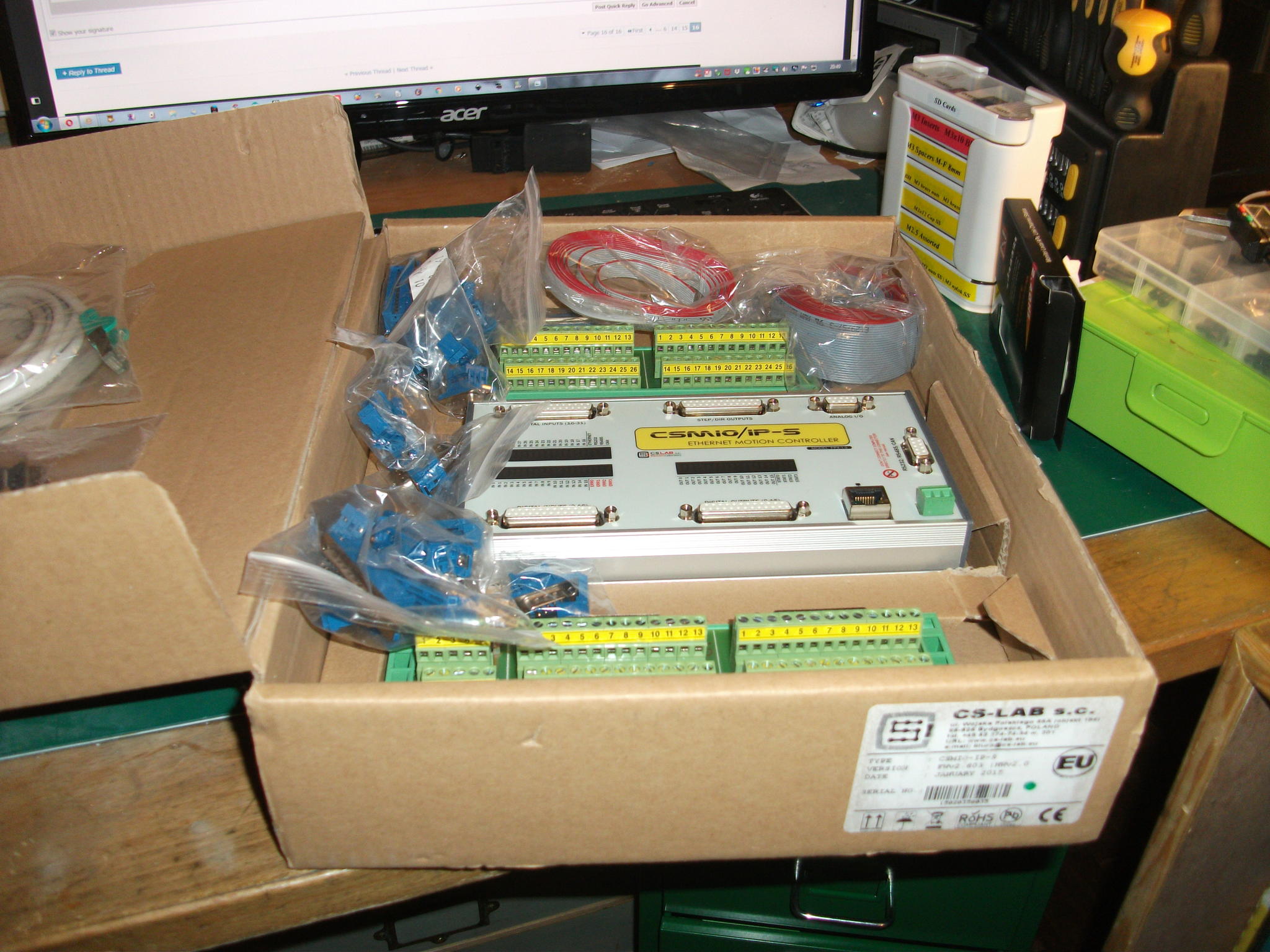

    Cropwell ,I thought that parallel pots was superior that USB! Am I wrong?I am asking to learn,the only experience I have is with parallel ports.
    Actually, I have only experience of PP BOBs.
    I bought this beast because it was cheap and I intended to use it for my current machine and/or the next build, but various bits of my life got in the way, so it sits in a cupboard, next to the Super-PID speed controller for my router. One day, Maybe !!!
    I just think that Printer Ports are soon to be history, like floppy disks and you would be better served by looking forward rather than staying stuck in the past.
