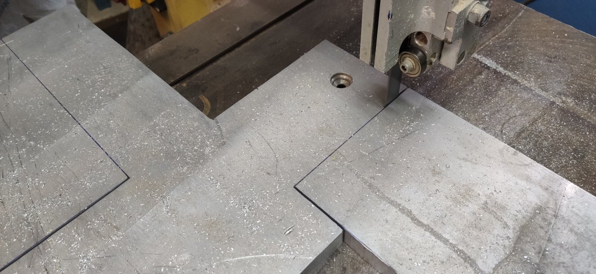

    I cut with my bandsaw the 20mm thick aluminum plate I bought from a scrap yard for 80 euros, to replace the MDF I use to mock up everything.
    Things went well.
