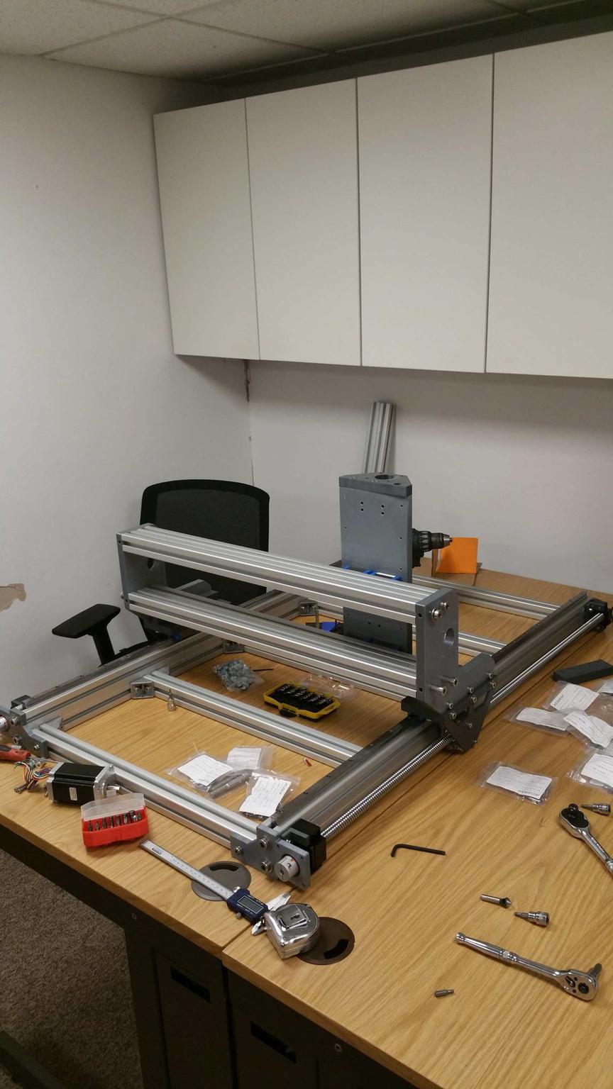

    Ok so bit of an update, i spoke to KJN and he gave me some tips on how to do it by hand and said that is best to use a Fluted Spiral Tap, managed to do the threads EASY and used the cordless drill to do it in no time at all, just goes to show with the right technique things are made easy!

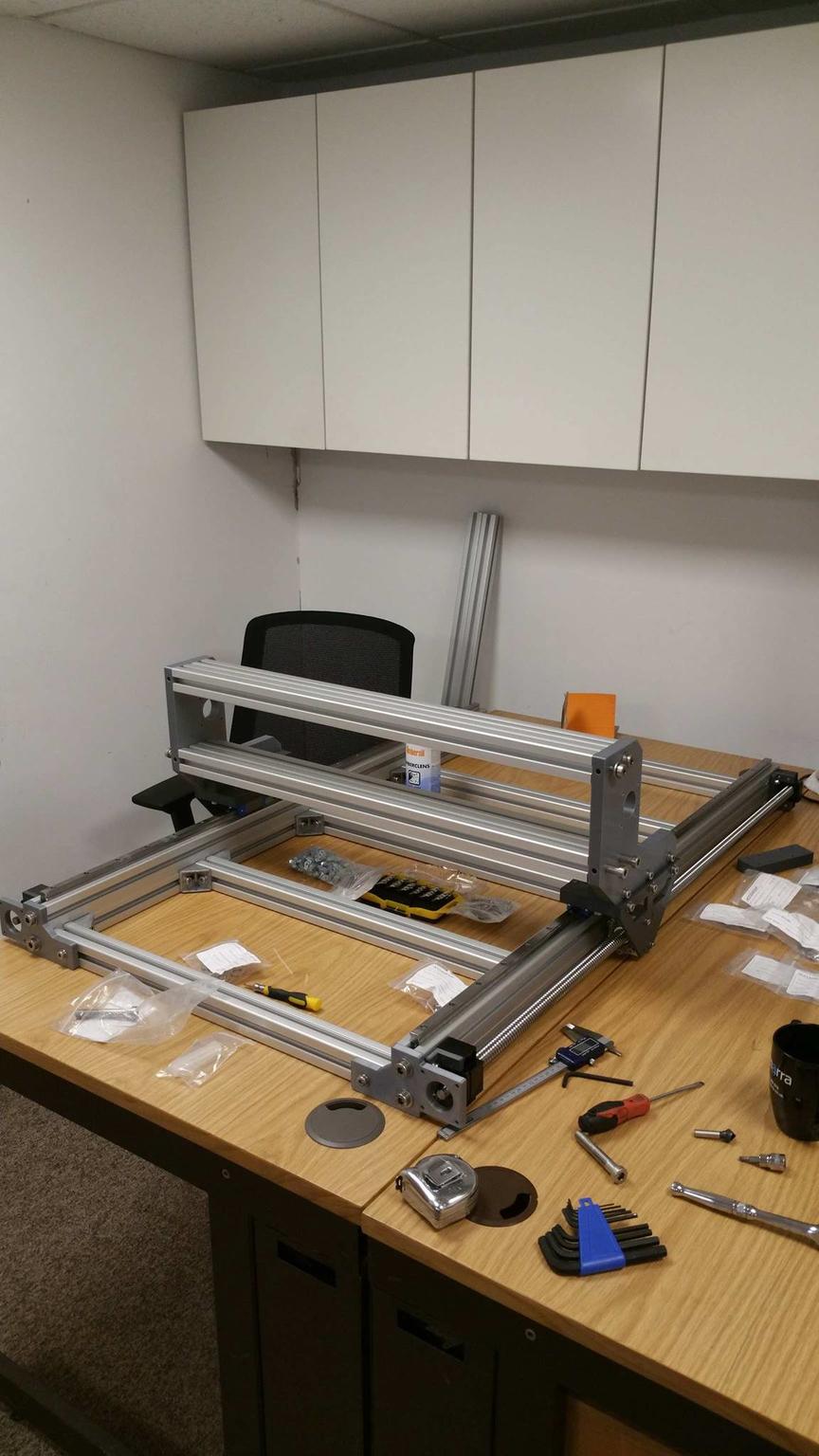

    I began to mock up the router using the 3D Printed parts today, found a few things that need sorting already so im glad i went this route of the dry build first.
    One of the problems that really made rage was that i need longer spacers (yes the ones i painfully re-worked are no good LOL), the couplers are 5mm longer than the suppliers drawing of them, so i will need to source some longer ones and also longer M5 bolts to match.

    Hi Desertboy, recessing the gantry extrusions into the side plates sounds like a solid idea, maybe i could incorporate it without changing too much as i have already ordered most parts (except the ally plates).
    In terms of the bed, i was expecting to use two types (or maybe even 3), like you say - using MDF as a spoilboard for wood cutouts will likely be one of the methods. I had planned to use a similar method for cutting with misting / coolant, our vacuum pods on our bigger machines here use a Phenlolic Plywood and Bakelight / Tufnol ( Link ), its an expensive material and awful to work with but is very resilient and will be immune to blowing out like normal MDF / Plywood when exposed to moisture. I was planning to use 18mm thick, and machine for those hammer-in threaded nuts to give flexibility in terms of mounting clamps / vices etc.
    My 3rd method might be to make a basic vacuum table for machining the 1mm thick interdens / intumescent, however i think a few strips of double sided tape will more than suffice.
    Yes you are correct i left those angles to help align any bed i fit easily, i will probably fix it to horizontal extrusions but nothing overkill just 2 or 3 bolts per length.
