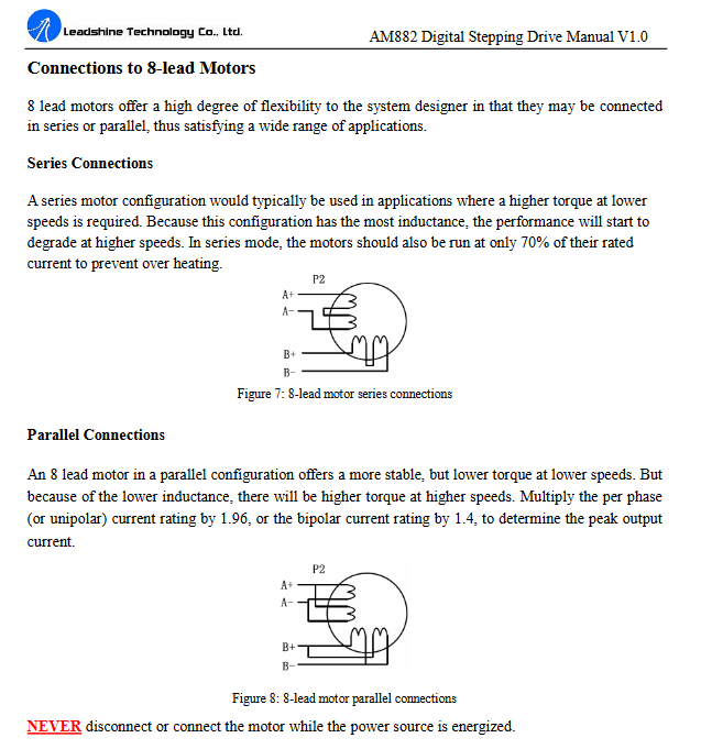

    Starting to think about my wiring in general, how would it be best to run my Nema23's in Bipolar Parallel or Series? Considering i have 68v PSU's? Also, can anyone point me in the right direction of the name of the 8 pin twist a lock connectors i see commonly used?
    Bipolar Parallel is the way.

    The motors have 8 cables, is there a way to wire in parallel whilst only trailing 4 core wire back to the driver??

    Yes, that's how it's usually done. Bring the 8 wires into some kind of junction box with a four-core cable coming out and going to the control box. You can hard-wire the four-core into the control box or use an appropriate plug and socket. I use XLR latching connectors but there are others. My "junction boxes" are 3D-printed (cheaper than small plastic boxes from Maplin) with choc block inside but as long as the cables are securely joined and protected, use what suits you.

Name:	Am882 wiring.png
    From the manual
    http://www.leadshine.com/UploadFile/Down/AM882m.pdf
    Mine never came with a manual but I bought 2nd hand AM882's.
