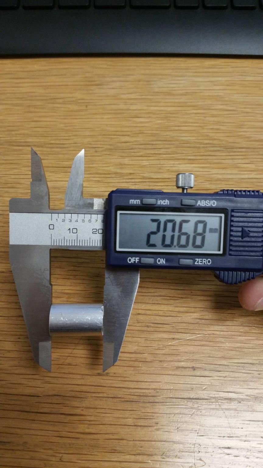

    Ok so bit of an update, i spoke to KJN and he gave me some tips on how to do it by hand and said that is best to use a Fluted Spiral Tap, managed to do the threads EASY and used the cordless drill to do it in no time at all, just goes to show with the right technique things are made easy!
    However i am really pissed off with the M12 bolts i go from ACCU Group, they are A2 Stainless (55mm Long & 75mm Long), but they only thread 30mm of the bolt, this wouldn't be a problem if the un-threaded part of the bolt was smaller than the threaded part, i honestly don't see how you are supposed to use that bolt in any kind of normal application, i didn't order a bloody shoulder bolt, but that is pretty much what they supply, if you attempted to screw the bolts in, it simply squashed the thread in the extrusions. So i have had to thread the rest of the bolts myself - never again, they are just too tough!

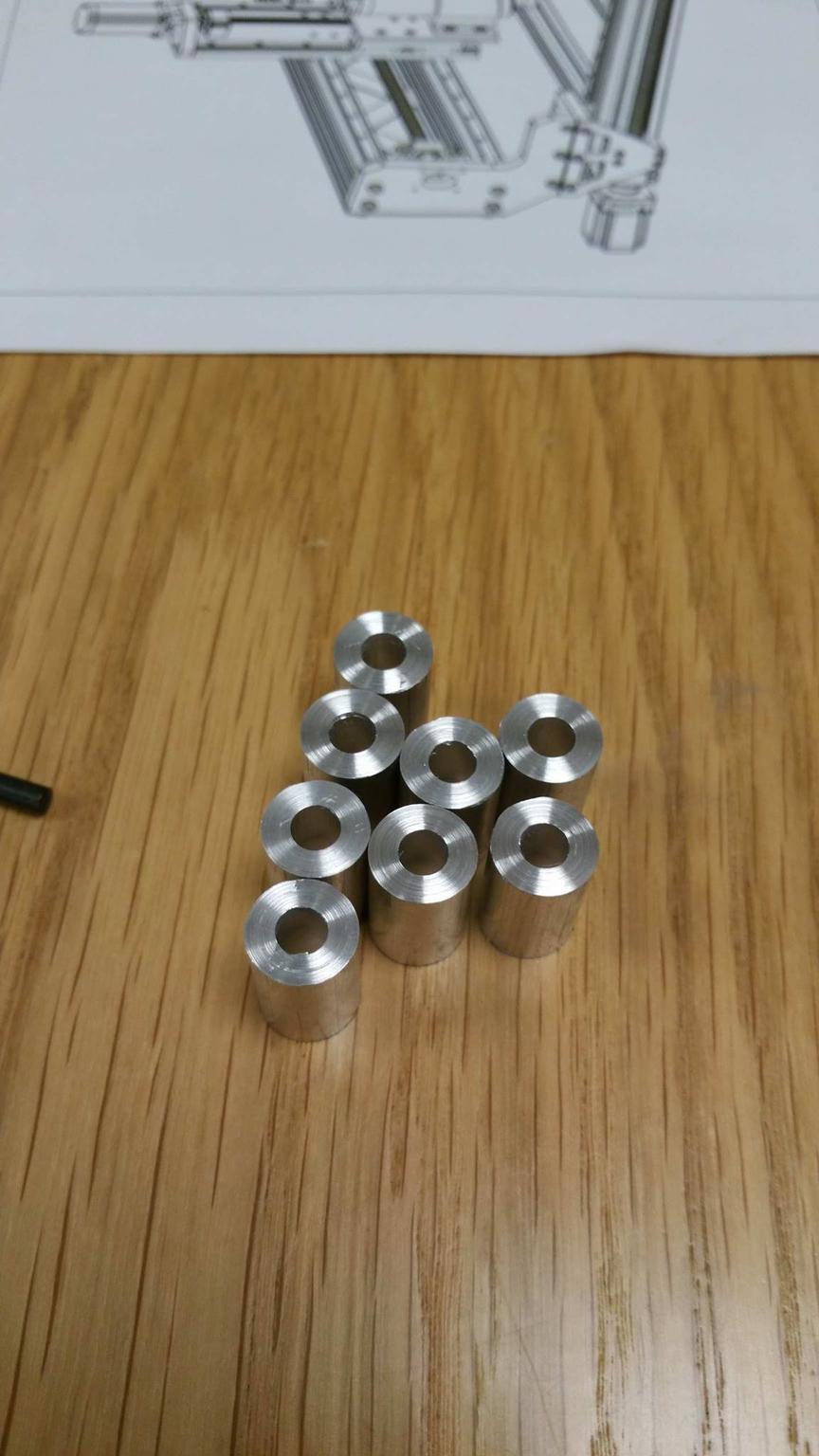

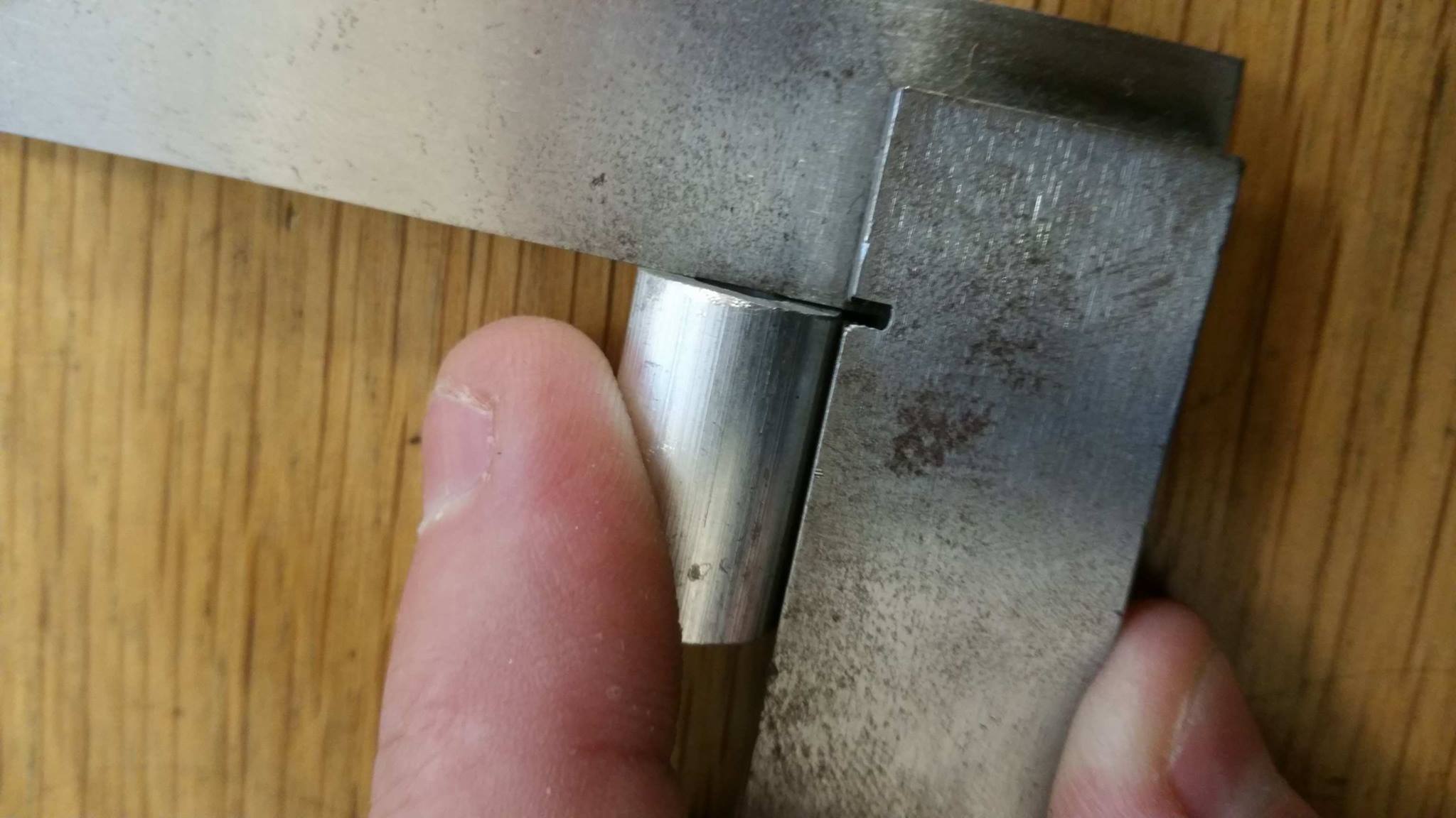

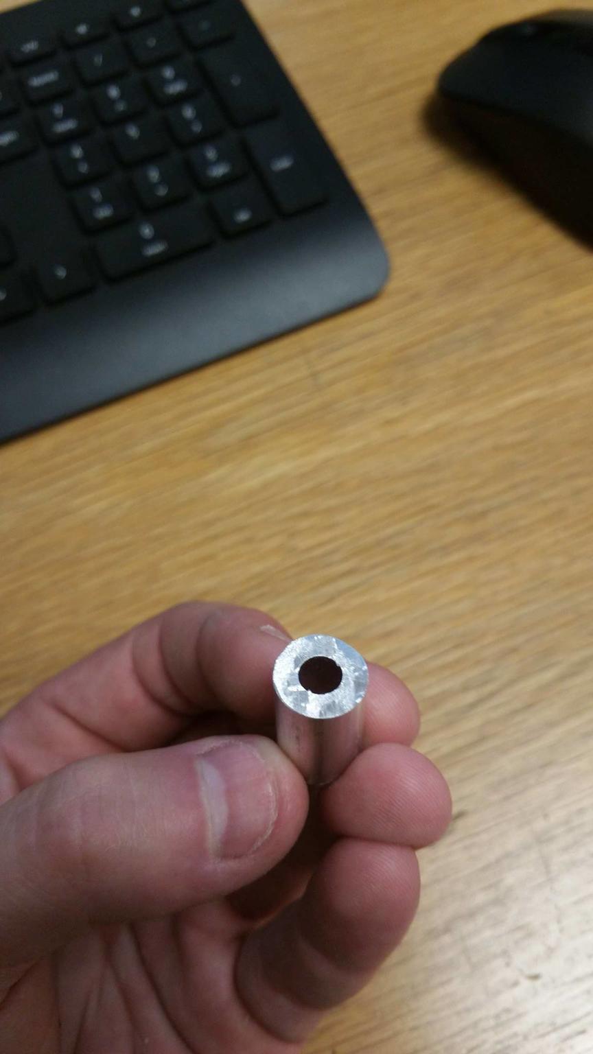

    On top of this, i ordered some M5 x 20mm "Precision Spacers" from ebay, well i will let the pictures explain:

    I dont have a lathe so what i decided to do was clamp each one in a pillar drill and drive it into sandpaper until the faces were square / true and they were the correct size.

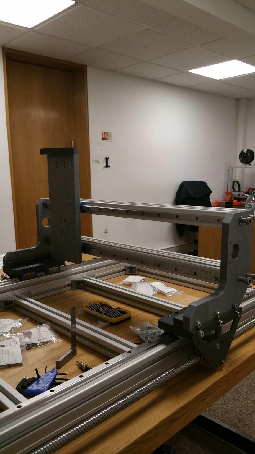

    I began to mock up the router using the 3D Printed parts today, found a few things that need sorting already so im glad i went this route of the dry build first.

    One of the problems that really made rage was that i need longer spacers (yes the ones i painfully re-worked are no good LOL), the couplers are 5mm longer than the suppliers drawing of them, so i will need to source some longer ones and also longer M5 bolts to match.

    I ordered these, they were threaded to the end I ordered 50mm length (says 45mm is threaded but the whole 50mm was threaded)
    http://www.ebay.co.uk/itm/M12-12mm%C...72.m2749.l2649
    My gantry mounting plate thickness is 20mm but I recess into the aluminium 5mm so the bolts go 35mm into the extrusion it seems rock solid far far more so than when I assembled it with corners. I have enough corners to do it all without bolts and drilling but it just seemed to make sense to me that a big M12 35mm into the end is going to be stronger than a T nut and £35 drilling cost seemed ok given the hassle it would have been for me to line them up correctly. Having at least 1 (2 is better) corners with T nuts is very useful when you want to assemble it.

    Hi Desertboy, recessing the gantry extrusions into the side plates sounds like a solid idea, maybe i could incorporate it without changing too much as i have already ordered most parts (except the ally plates).
    In terms of the bed, i was expecting to use two types (or maybe even 3), like you say - using MDF as a spoilboard for wood cutouts will likely be one of the methods. I had planned to use a similar method for cutting with misting / coolant, our vacuum pods on our bigger machines here use a Phenlolic Plywood and Bakelight / Tufnol ( Link ), its an expensive material and awful to work with but is very resilient and will be immune to blowing out like normal MDF / Plywood when exposed to moisture. I was planning to use 18mm thick, and machine for those hammer-in threaded nuts to give flexibility in terms of mounting clamps / vices etc.
    My 3rd method might be to make a basic vacuum table for machining the 1mm thick interdens / intumescent, however i think a few strips of double sided tape will more than suffice.
    Yes you are correct i left those angles to help align any bed i fit easily, i will probably fix it to horizontal extrusions but nothing overkill just 2 or 3 bolts per length.
