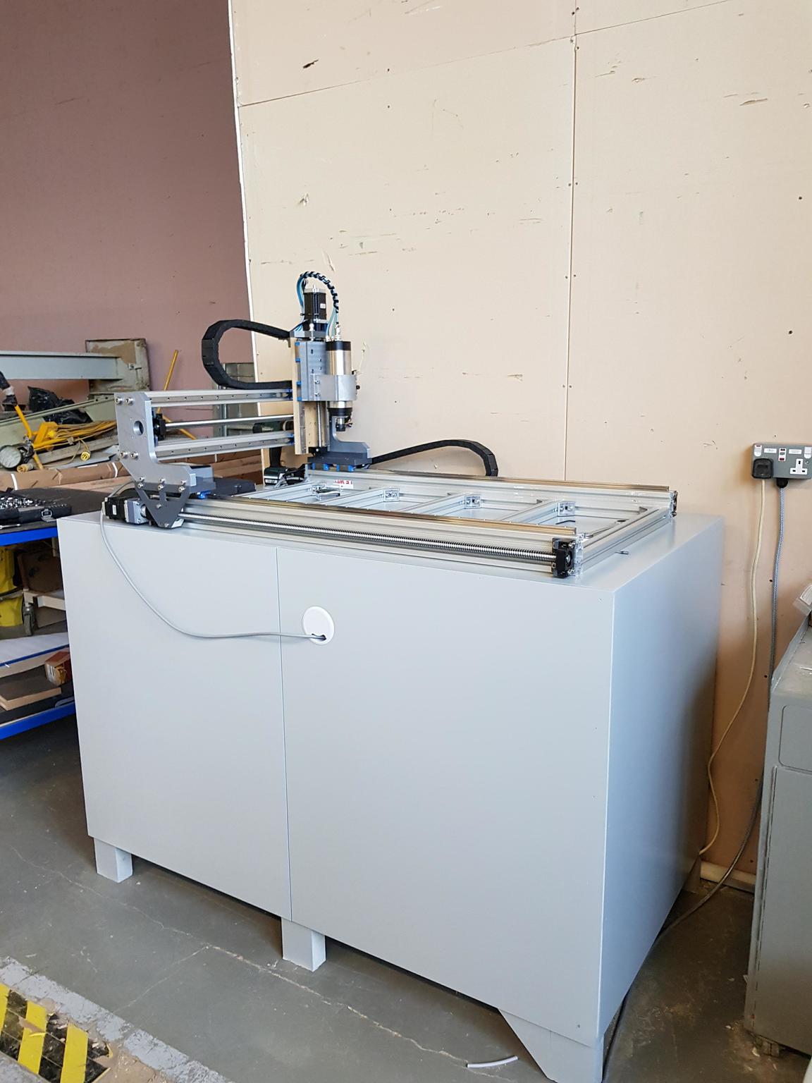

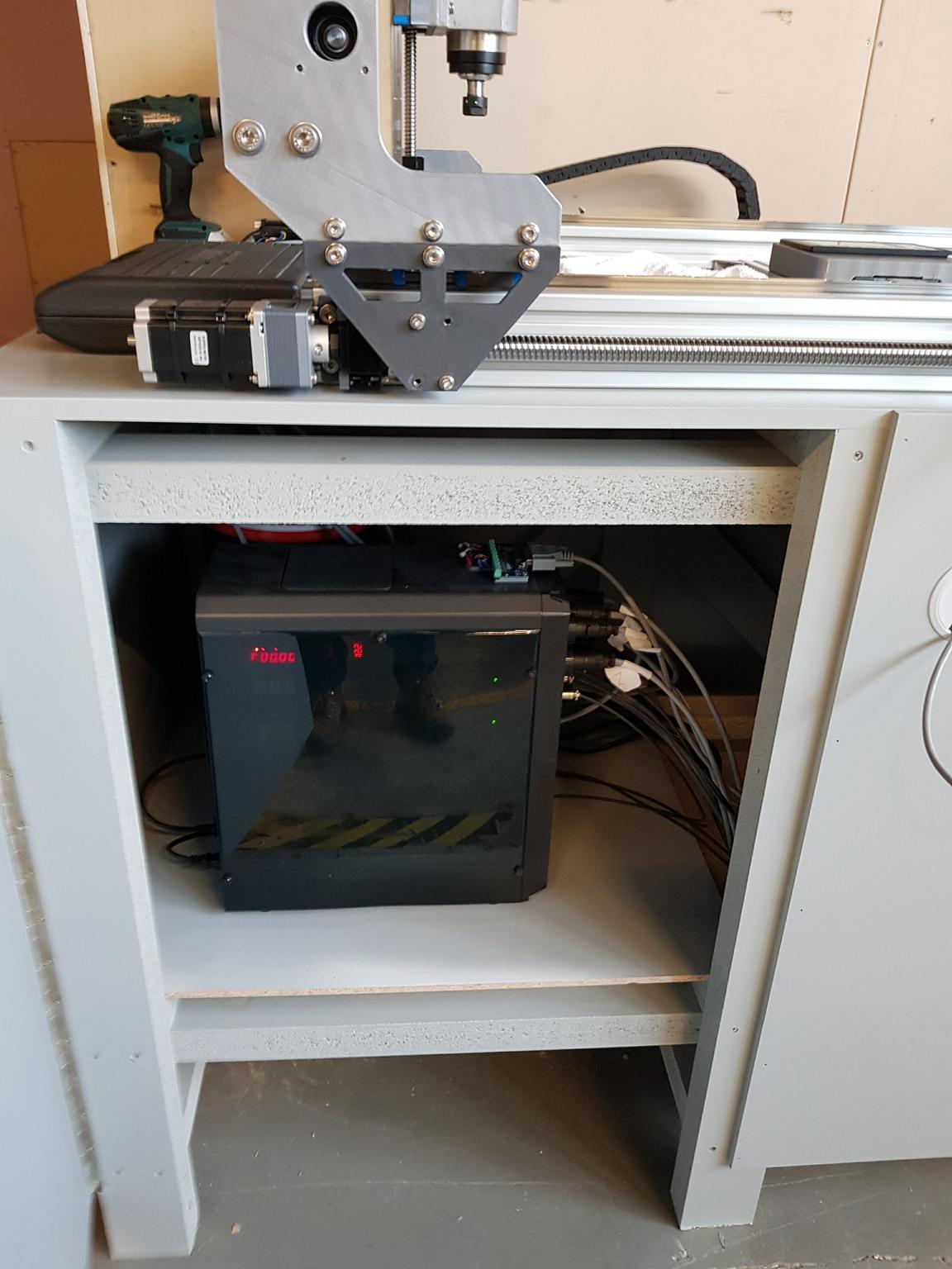

    Hi Jeremy! I hope you are well, i have been meaning to send you some updates on the build since we last spoke. Cad files would be great to a lot of people i think, a lot of people on the Facebook groups have asked - i just don't seem to have time to compile them neatly with a BOM right now.
    I have made a lot of progress yesterday and today, i have finished wiring the machine now (almost, but i'm leaving Max Limit switches off for now, the loom is there if i want to use it in the future). I added a Ferrite ring to the Spindle Cable where it exits the VFD enclosure & also at the other end where it wires into the Marine Connector Socket, i hope this helps keep inference down - i have also grounded the CY cable correctly (i think., I also just need to add an E-Stop to the controller.
    I got the Spindle working and also got it fully operational from the DDCSV1.1 controller. The Huanyang VFD is slightly strange, it requires you to daisy chain / common ground the DCM & ACM terminals (Analogue & Digital Control Signal Grounds), which does not make any sense to me. I'm not sure what the Chinese logic behind it is however it wasted an hour or two figuring it out but now works fine.
    Also got the Coolant Drum (An old & cleaned out 20 Litre Lacquer Tin), setup with the pump in it - which all seems to be working nicely with no leaks. If the Drum is 20 Litres, would this be a sufficient volume to passively cool itself? Should any type of Antifreeze / Coolant be added or replace the water to improve performance, help cooling, prevent corrosion in the Spindle Water Jacket?

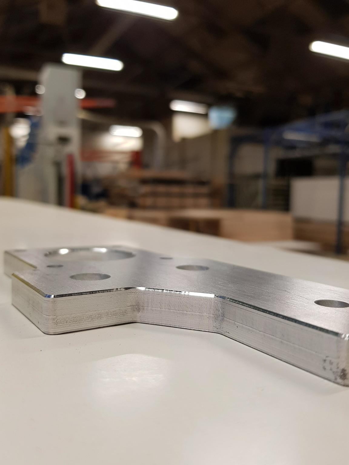

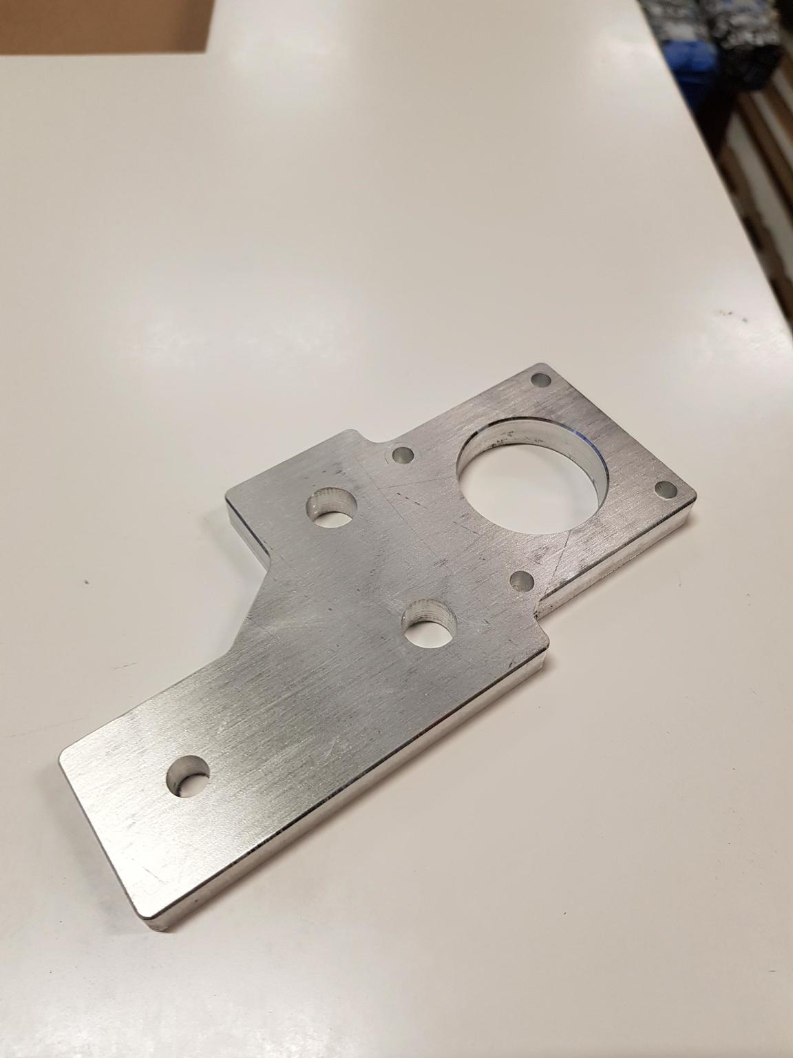

    Next on the list is to try and wrap my head around SolidCAM, creating a Post Processor for it & getting some test programs run. Also at the point now where i need to look at getting the aluminium plates sorted.
    Alex
