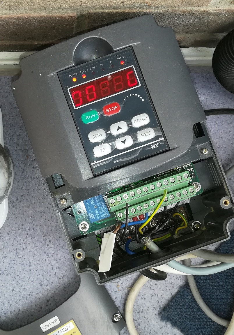

    a few years ago JazzCNC built me a router, however this last year I've had a reoccurring issue- the spindle either stops after a few mins, or more typically just doesn't start, the VFD has no reaction to mach3, even hammering the spindle button on mach3 has rarely worked.
    Normally it's just a minor niggle - I leave it for switched off an hour and it magically works again (any less than an hour and it doesn't!?) but today it did 4 mins work and then decided no more, and the VFD hasn't reacted to mach3 since.
    I've tried2 PC's, and changed the Ethernet cable, but neither has made a difference.
    I'm not too technically minded, but maybe someone can help (Dean??)- I have taken a pic of the VFD, I've no idea why!
    All I can tell you is the taped off wire is because the water pump was playing up a while ago and so I disconnected it- it's not made much difference as I haven't run any long toolpaths since, and it's sadly not corrected the issue!
    Cheers for any thoughts, it's been a stressful day!

    OK Mark Have you tried shorting the FOR (green/yellow wire) and the DCM (black wire) terminals together.
    Remove them from the terminal block and link the two terminals. the motor then should run. That will prove if the relay on the bob is faulty
    Clive, thanks so much for the detailed reply. I tried what you said, the vfd tried to accelerate up presumably too fast and makes the distinct click of a circuit breaker or similar, presumably because it misses the speed, however, as I power it down and a second click is heard as the vfd releases the spindle very briefly spins. I'm not sure where to go from here.

    So if I understand what you are saying. With the FOR and DCM (without the original wires connected) the spindle powered up, If then you remove the link the spindle should stop. If that is the case then check the original cables from the FOR and DCM back to the BOB and makes sure the connections are secure. A picture of the bob might help

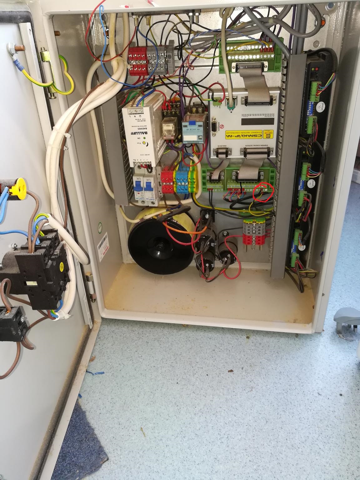

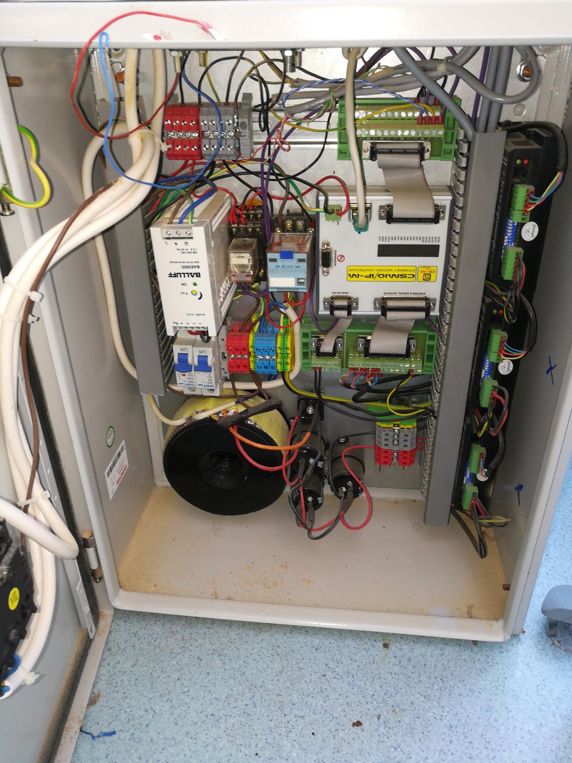

    Hi Clive,
    I can't actually locate the breakout board, I've taken a pic of the whole cabinet, if you could spot it that'd be great!! Sorry about the bother. Click image for larger version.

    Clive S's Avatar
    Lives in Marple Stockport, United Kingdom. Last Activity: 18 Hours Ago Forum Superstar, has done so much to help others, they deserve a medal. Has a total post count of 3,348. Received thanks 620 times, giving thanks to others 90 times. Made a monetary donation to the upkeep of the community. Is a beta tester for Machinists Network features.
    Ok I think that the two cables that go to the vfd that control the spindle stop/start are the one's that I have put a red ring around.
    Make a note of which terminals they are connected to. Then disconnect them and check them for continuity to the vfd FOR/DCM if necessary remake the connections.
    I have never used that controller but I can see Dean's influence in there .

    Thanks Clive, i'll check it out when I'm home later :D Your help is very appreciated.
    Any idea why Dean isn't around by the way, I notice his account hasn't been used in months? Hopefully he is well.
    I couldn't find any issues with the wiring, though I've taken the connections out and cleaned them before tightening up again, and it's working, I'm unsure if that's just coincidental but at least it's ok for now.
    If the problem keeps happening could I move the connection to the next port across?
    Thanks for your help Clive :)
