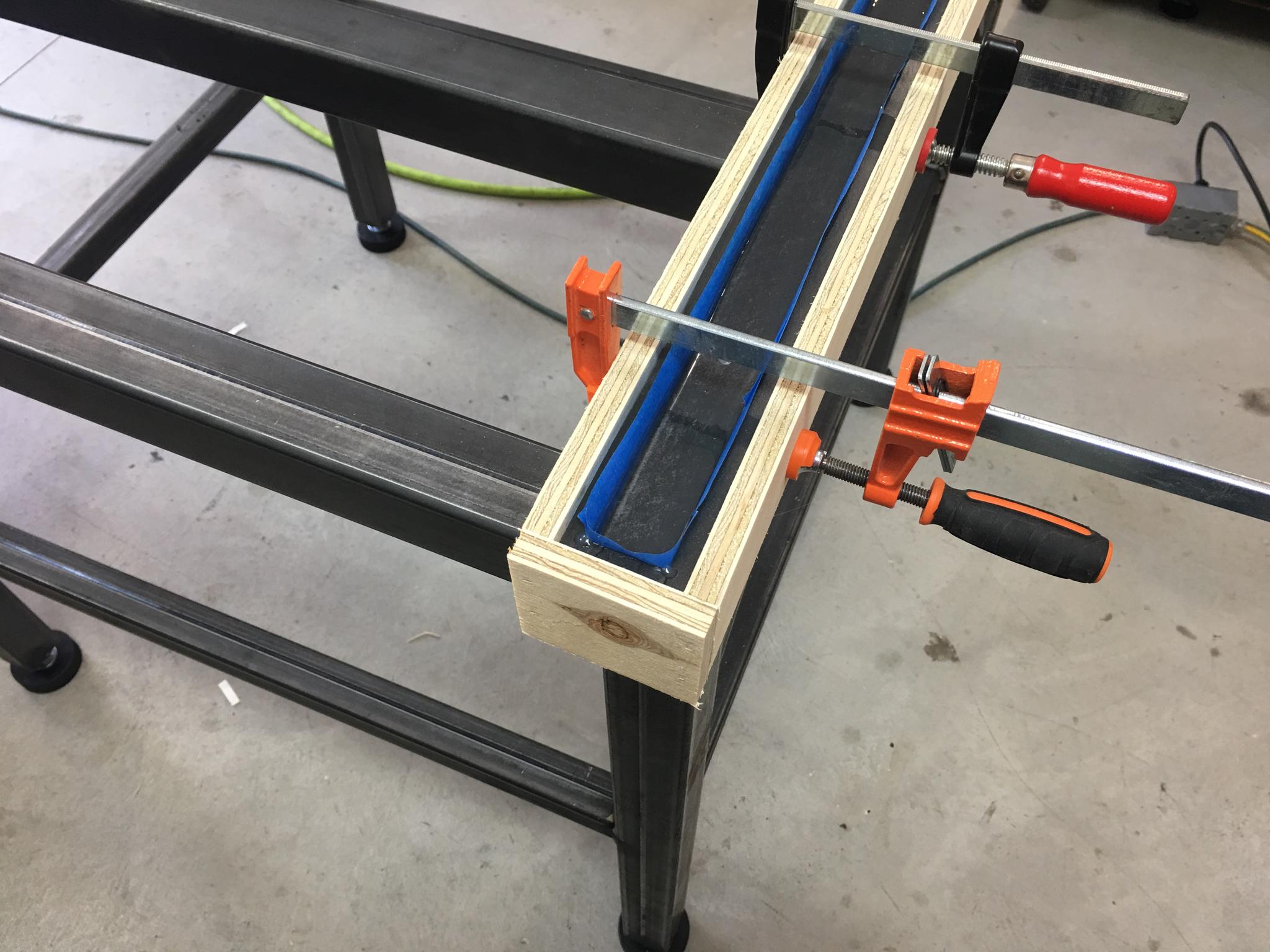

    Well, I have it about ready to pour epoxy:

    Brushed a thin coat on to seal joints, seams, etc:

    Read over more epoxy-related posts before pouring and came across the one by Boyan Sylvaski discussing shrinkage of centered bridge causing distortion in the middles of the rails! Well, I wasn't tearing it down and starting over. So, I did the pour, gave it time to flow out, and then blocked the bridge entrances with razor blades:

    Used a heat gun multiple times to get rid of bubbles. I was surprised at how well that worked. You could see the bubbles pop and disappear as you waved the heat gun over. Top looks like glass at this point.

    Pulled forms off today. Not sure if this was because I used the Totalboat epoxy, but I was surprised at the size of the meniscus. I have one side pretty much cleaned up, but I'm guessing I had to file in maybe 5mm from the edge to get rid of it. Does this sound like what most of you see? Nothing to base this on, but I expected it to be a narrow and steep meniscus. I'll try to get a pic of the other side before cleanup.

    I've not done epoxy before but your query may be answered in this excellent epoxy thread :
    http://www.mycncuk.com/threads/8197-...-for-levelling
    IIRC others have suggested pouring epoxy 40mm wide for 20mm rails to allow for a miniscus of about 5mm and then some.

    Wow.. fast progress! I had my moat on for 8-10 days for guaranteed cure..
    But you didn't have the super slow stuff?
    I used reactive resins and had about 4-5mm meniscus.

    It seems super hard though. I used the slow - not extra slow. Sounds like the meniscus on mine was about right then. Still amazes me how this works. I could not get the frame level in all directions due to an apparent twist. But no matter which way I put this level, all I see is:

    Granted, that is just a (high quality) carpenter's level, but still pretty cool.
