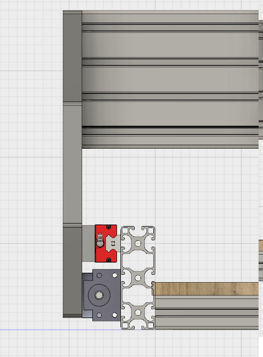

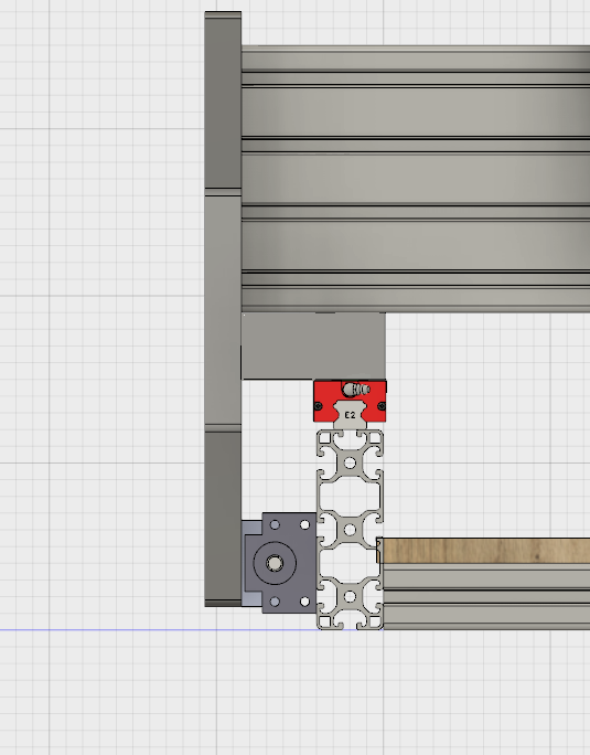

    It's clearer now, really nice! I finally found locally a plate 20mm, but this is grade 5083. (500x500mm is 182.- with the cut.)
    Here is the specs: height tolerance: +/-0,1 mm, flatness tolerance max. 0,15 mm/m
    I have made several changes on my design according to your advice. I'm trying to find the best way to mount the rails.
Name:	Sans titre.png
    In this configuration, the block is on top of the extrusion. Will it be stiffer?
Name:	Sans titre2.png
    In this arrangement, it will be easier to mount as the space between the block and the plate is the same size as my aluminium height (20mm).
    Which one do you think is the best? (The first image has the y axis a little bit lower)
    Thanks again for your help :)
  7. #27
    In both scenarios you need a way to adjust the width of the gantry as you will be "trapping" either the ballnut or both ballnut and linear bearings.
    If you have the rail on top it can be adjusted sideways in the screwdown moment.
    For the ballnut you can mount it like that if you shim it..
  8. #28
    Top one will most likely be stiffer as you are not bending the gantry sides. Limiting factor is the gauge of the extrusions on the bed sides. If space and access to the bed at each end allows you can plate over the ends to join them to each other.
  9. #29
    I'll go for the top one so, I wasn't thinking that it could have any bending problem, thanks.

  10. #30
    Quote Originally Posted by BriceO View Post
    I'm not sure to understand it. Do you mean the extrusion is it too high?
    Good idea for the end plat, do you think 5mm aluminium is enough to do it?
    I found this documentation about hiwin rails : http://www.hiwin.com/pdf/linear_guideways.pdf
    It can be interesting for someone. Is it a good choice to have a HGW (wide flange carriage) could be a good choice for the Y axis for example? And HGH for X and Z axis.
    Any advice higly appreciated.
    The extrusion is not too high all I wanted to point out was that using extrusion, especially thin wall (gauge) extrusion, will be the limiting factor for the stiffness. The wall is thin, and it essentially has lots of deep slots cut in it. Imagine pressing sideways where the gantry rail is situated, and imagine how it will want to bend and vibrate.
    Lost of people use steel box section instead as it is much stiffer, with a continuous outer section, usually with a high wall thickness (to allow thread tapping), and it is cheaper.
    End plates of 5mm will be fine as shear panels don't need to be massively thick to be effective, but it will limit feed in / out access if that is a consideration.
    Hiwin carriages - either wide or narrow are both fine. Use wide if that gives a better footprint and mounting for your design.
