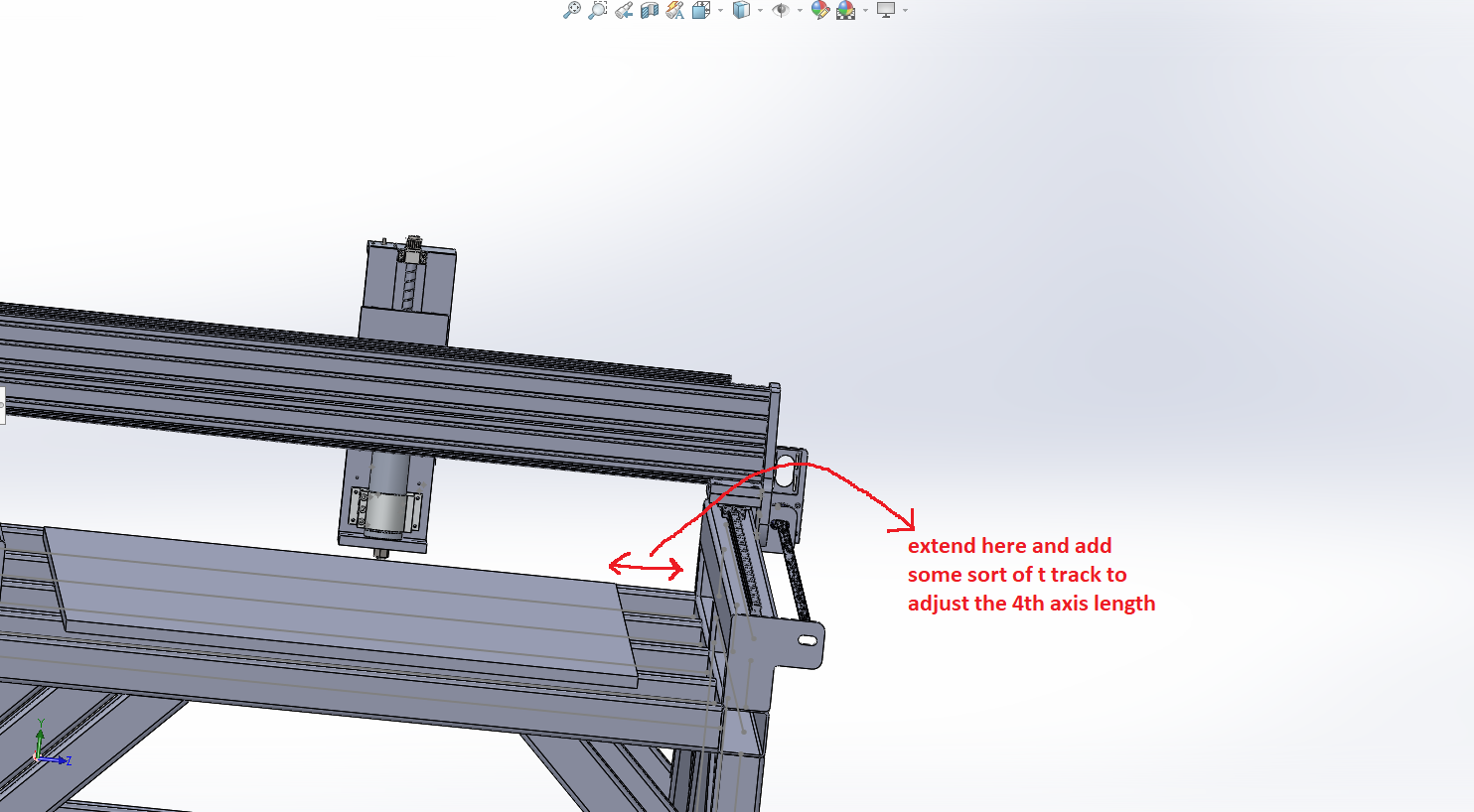

    is it possible to combine a 4th axis capable of cutting up to 200x200mm to my design? i am struggling to figure out how i would without having to adjust the z height, my plan was to adjust the width of the machine to allow me do add a t track to the side of the machine which does not affect the spoil board so i can adjust the 4th axis length so maximum cutting for the 4th axis would be 2400mmx200mmx200mm. So far my z height already has a cutting height of 200mm so if i was to somehow add the 4th axis i feel as if i would now need to adjust my z height to around 300mm and i have no idea how weak it would make my z axis doing this.
