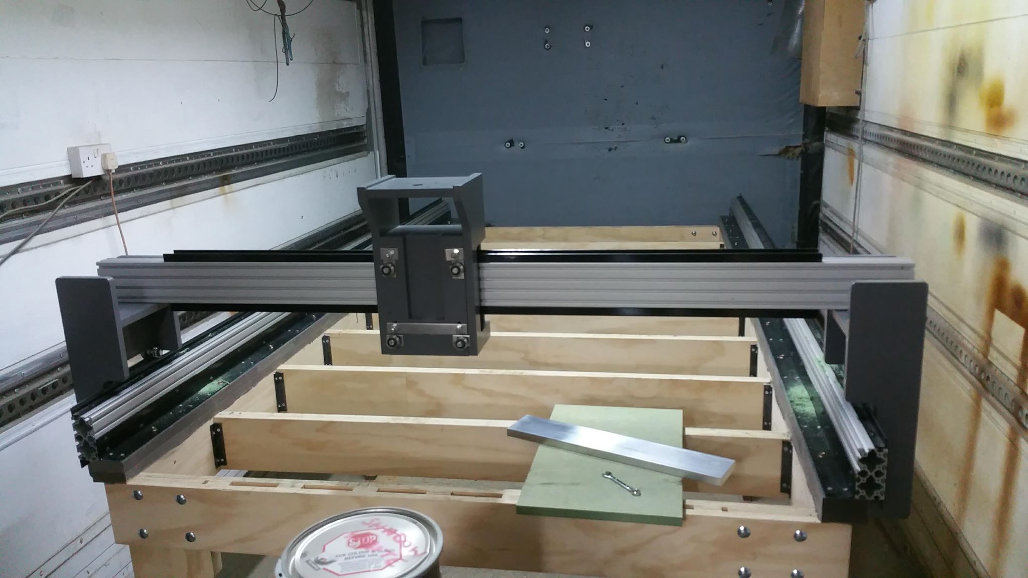

    So this is the progress so far
Name:	cnc so far.jpg
    The Y axis to X are not finished yet, still have more support for the gantry to be fitted.
    The plans called for ACME lead screw on the Z but after hunting for the elusive 1/2"-8 2 start bar across the planet, I gave up and bought a ball screw 16mm 05 lead off of ebay with the mounts and coupler.
    I'm hoping they are similar - the acme was a 1/4" lead per turn where as the ball screw is 5mm - not sure how that will affect the Z performance at all?
    I will be running the 4Nm 23 motors at 68-70vdc as Jazzcnc suggested so there should be enough extra oomph I hope to compensate for the Z?
    Now onto a redesign of my Z to allow for the ball screw mounts
    The ball screw is far superior than the acme. With the ball screw I would go with nema 23 3.1Nm

    The difference in screw pitch will mean very little performance difference. The difference in efficiency, however, will be a lot better.
    Now your not going to like this next bit but it's in your interest it's said.!
    The Z axis is THE most important part of the machine so whether Acme or Ballscrew won't make a jot of difference because of the weak nature of this Z-axis design. Those V bearings are simply not good enough for Z axis and this design will be massive weak link. It would be wise choice if you changed the design and invested in some profiled linear bearings.
  6. #16
    Yes I have to agree with you:( lol
    although it's not so much of a problem now that I have to modify it for the ballscrew anyway.
    I'll probably do a quick fix for the vee bearings to make sure on clearances and then the first decent mod. i'll redo the Z.
    Would supported round rail be an option over the vee bearings?
    I've gone for SBR16 rail- looking at a few z axis they seem to be built with the idea I have in mind
    Also got the 84mm long bearings so plenty of stability I hope
    All mounted on 19mmx 90mm 6062 ali plate with 6" piece crossways for the spindle mount
    This option works with the X axis as I have bearings studs through the front face so hopefully I can make it work

    Quote Originally Posted by GrahamWhite View Post
    Yep that will be lot better than V bearings. Just make it strong.
