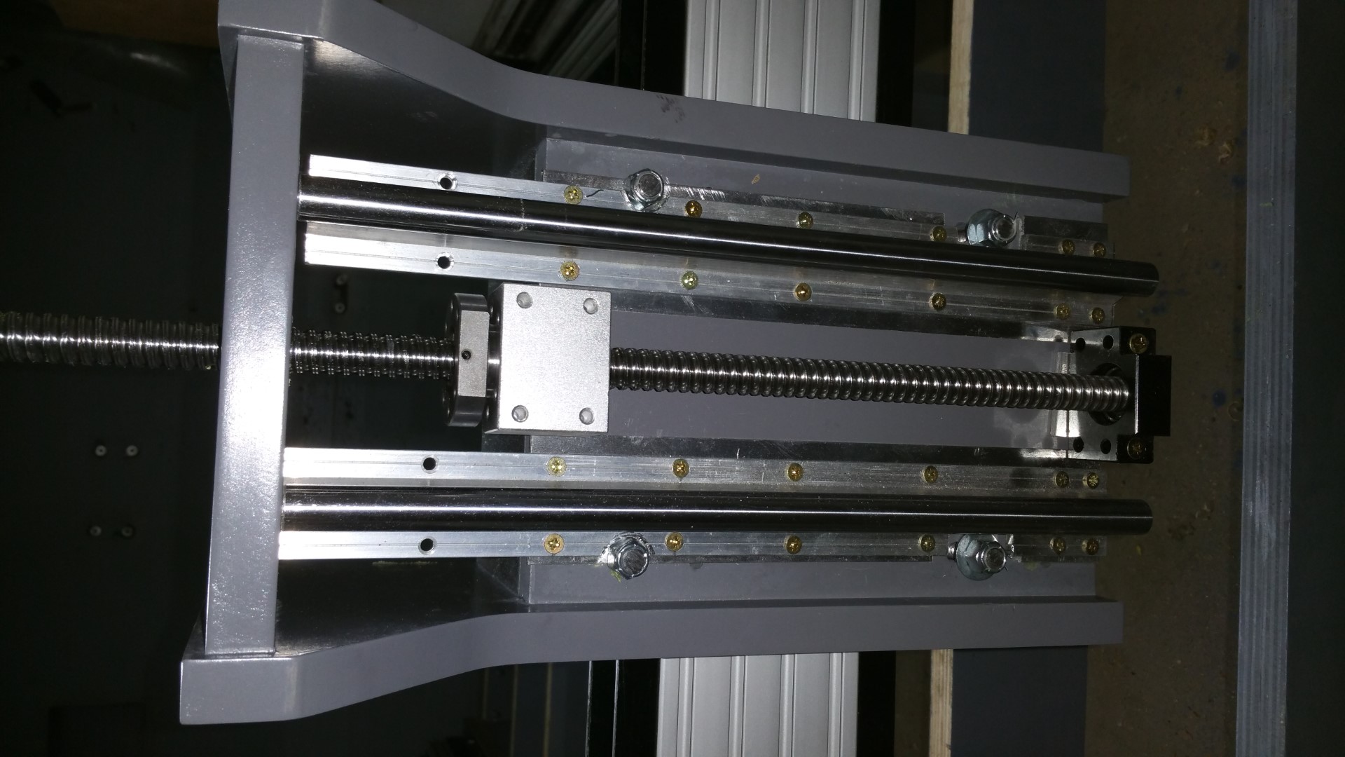

    So with the ball screw it needs space for the mounts top and bottom- so doesn't work with the Vee bearing rails :(
    I went for SBR16 - supported rail bearings- would have liked square profile but the cost was too much.
    This is the state of the Z axis at the moment -getting there :) waiting on the long bearings for the rails- will be going for MDF front plate at the minute and changing to aluminium later I hope :)
    The clearance on the X axis bolts is tight but clear is clear :)
    I will have to manually adjust the Vee bearings on the X but hopefully that's not too much of a pain(instead of cam adjusters).
    I hope this is an upgrade to the Z and not a downgrade!!
    The bottom of the X has approx. 7" clearance from the bed after I add a whole base board and then a spoil board on top- gives me a usable Z height of 7"!! providing it doesn't have too much play.
