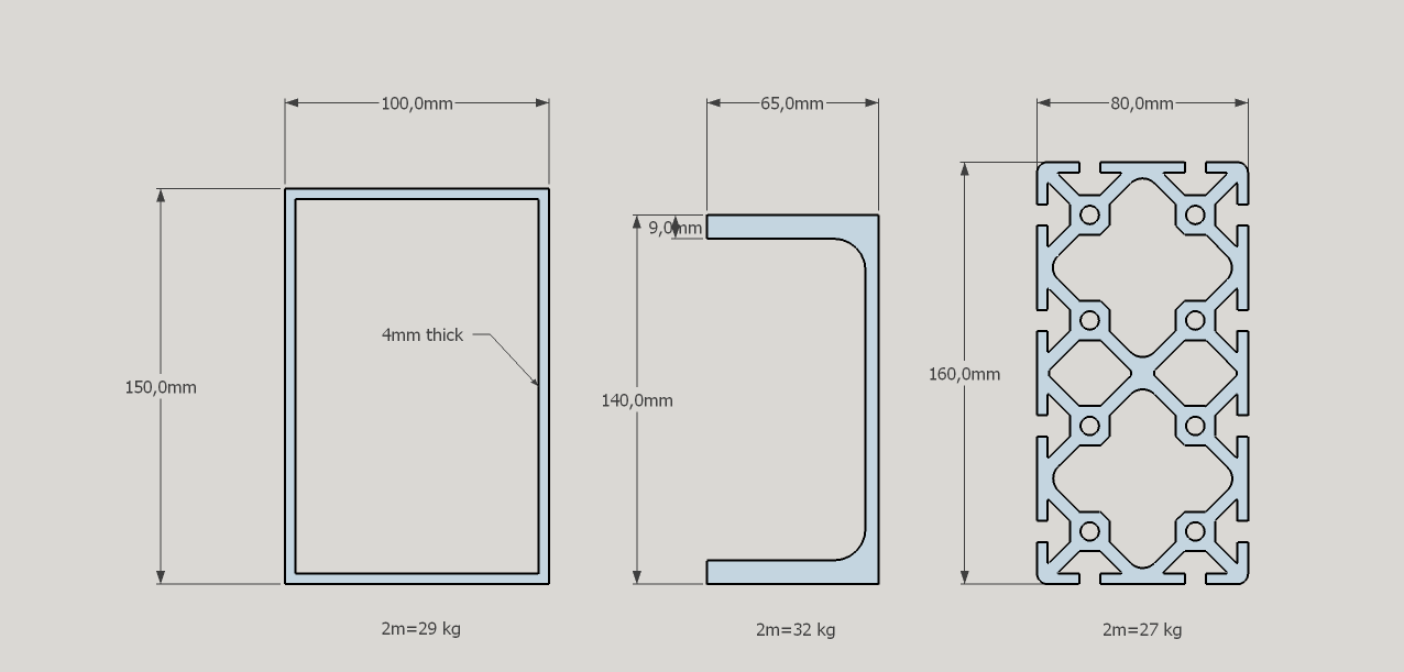

    Planning to build a gantry type machine. Before the construction goes on, would like to know the opinion of specialists. My machine has a beam of 2 meters long. What would be the most appropriate profile when you consider that the spindle weighs 12kg.It should be fast sheet cutting machine - the cutting speed of about 10000 mm/min.
    Thanks,
    Kalle
