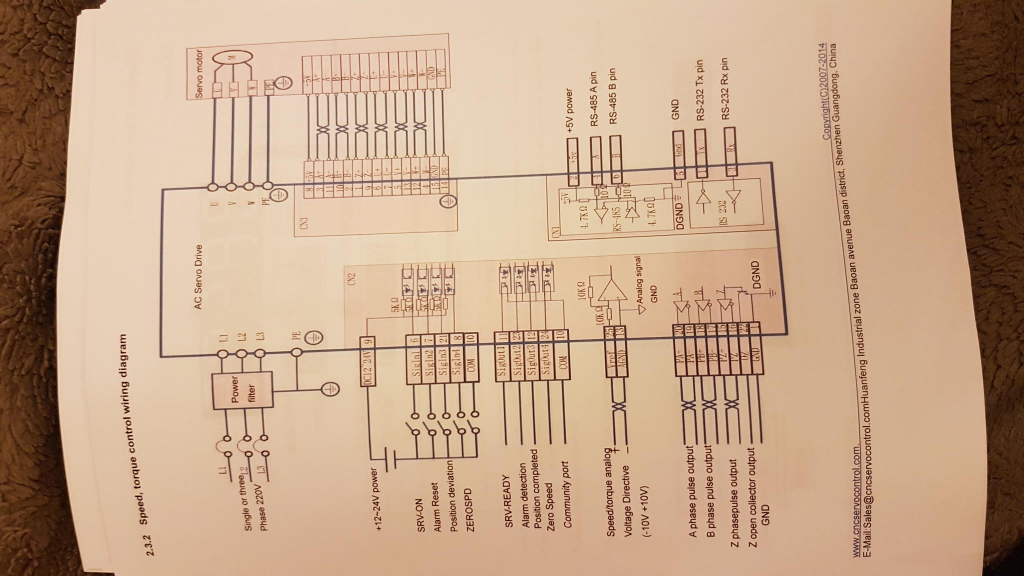

    So.. after much trolling this and other cnc websites, youtube and all the other stuff you end up looking at whilst researching, I finaly ordered up some AC servos, a VFD and a CS Labs CSMIO IP/A with I/O expansion and MPG module.
    Being that this lot cost a fair lump of cash, I want to be VERY carefull in getring the wiring correct.
    I get the majority of the connections, but wanted to make sure that all was correct before I started.
    I emailed CS labs for help, asking if they could do a quick connection diagram for a servo drive and for VFD ( literature supplied), as none on the diagrams on their web site, fully matched up with the drives I have.
    ( is it just me, or does an ISO standard for terminal identification not exist yet for drives)
    The response was far less than I would have expected, for a company pitching their goods at industrial users.
    It was basicly " busy, may be able to help in about 8 weeks".
    What!!
    A.C. Servo drives are AASD-20A
    ( CONTROL VIA -10V~+10V)
    VFD is a chinese 9100 series 2.2KW
    ( speed control 0-10V +fwd, rev, stop)
    Anyone got experience of wiring these in to an IP/A?

    I can show you how to wire the stuff, not too difficult. Is that the driver manual / image of the connections page?

    Hi Chaz,
    Yes that's what I was able to attach.
    I have also just attached an xcel spreadsheet I did, showing everthing I have worked out so far.
    ( probably a bit unconventional, but it seamed a simple way to plan it)
    Feel free to mark my homework...... LOL.
    Comments welcome from all.

    I dont see the spreadsheet. Can you put it on googledocs or dropbox or similar? Else I can pm you my address.
    I did the same (excel) for one machine I retrofitted (IP-A with Mitsubushi servos).

    Ah, didnt see you updated the original post. Ill take a quick look. Actually, send me your email address and Ill dig out what I did.

  9. wont your new drives run position mode? step/direction?
    would make it much easier to set up and would have saved getting the csmio.
    i can help you with the ecogoo .
