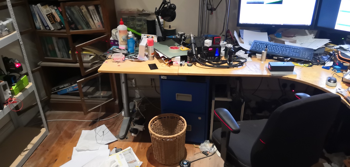

    The focus (no pun intended) of this thread is to explore using a very cheap webcam (~£15) and a laser level to achieve both accurate planar and line (straight) alignment.

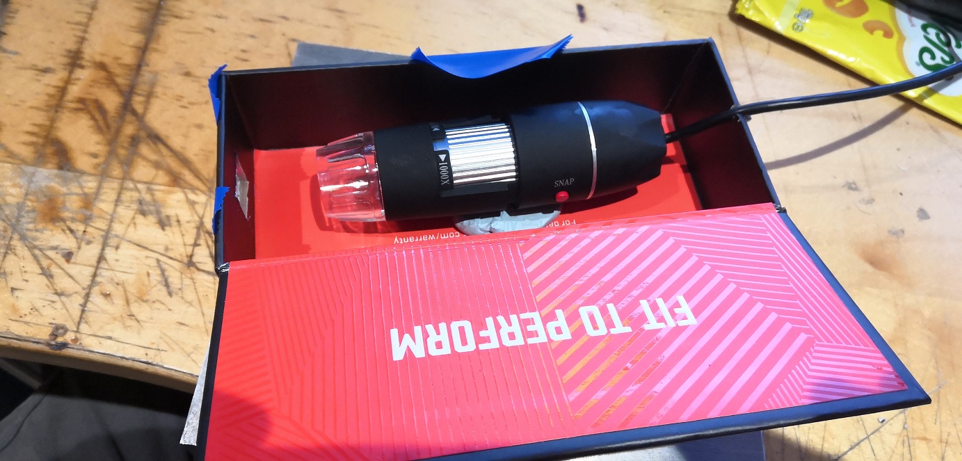

    I've been playing with some projects using cheap webcams for various measuring tools and other things they weren't designed for. In thinking of how to perform the various levelling operations my new machine build will need I looked at the laser line level and detector I used during my house build. This is a dewalt model (line generator lens, not rotary), works great for tiling and putting up shelves/lights and for building straight walls, however with the matching dewalt detector in high sensitivity mode it only resolves down to 0.5mm at best.

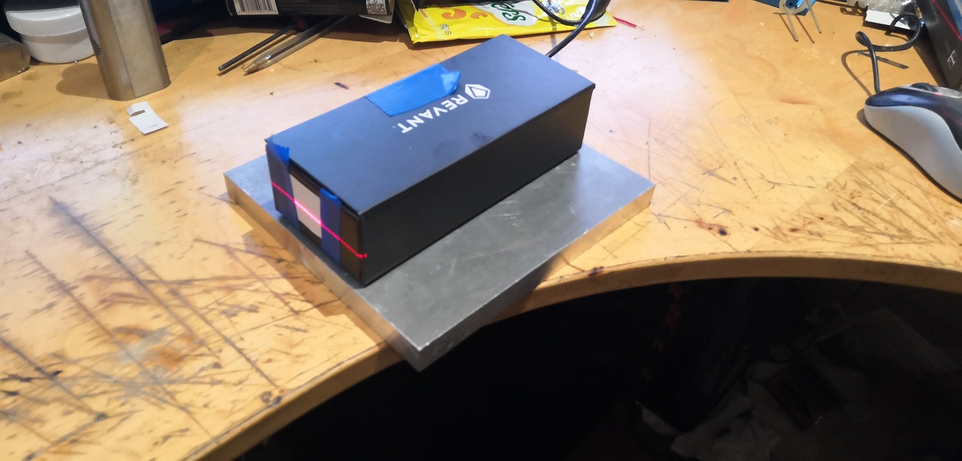

    Anyway I figured a webcam and a bit of custom software could do better. I put together a very crude test using a usb webcam (actually a microscope but that isn't relevant). The webcam is placed in a box to shield it from stray light and a small window is cut in the end of the box. The window is 'glazed' with a bit of white paper to act as a screen. The webcam is focused on this screen.

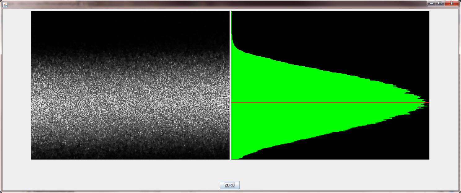

    The laser line is then fired at the screen. I wrote a quick and dirty program to grab the webcam frames and perform some image processing. In short this takes the sum of brightness across each row of the frame to plot the natural gaussian of the laser beam then uses some clever maths (not mine) to fit this gaussian. The mean of the gaussian is the centre of the beam with respect to the cmos sensor.
    With the laser a few meters away (all though distance doesn't matter within reason) the tool can resolve height variations down to ~0.01mm (a piece of copy paper that is 0.08mm thick resolves to a height change of ~12 pixels of the cmos sensor). This could be increased by increasing the magnification of the sensor, currently I have it set quite low and this setup is extremely crude thrown together in a few minutes.
    Anyway I thought I post some pics of the setup here to see if you guys thought it has any legs. It could be extended to read horizontal variations using the laser in vertical mode which could be used to lay rails straight for example. If I progress this the next step will be to build a solid metal housing for the image sensor (discarding the body of the webcam) then it can be clamped to things like hiwin carriages. I would then extend the software to take multiple samples say along each X axis and display the error from the plane so that this can be corrected. First use will be to get the table i'm going to weld the frame on into plane.

    Your workshop is as neat and tidy as mine!
    I'm all in favour of using your head to save your wallet, that's a really interesting project.

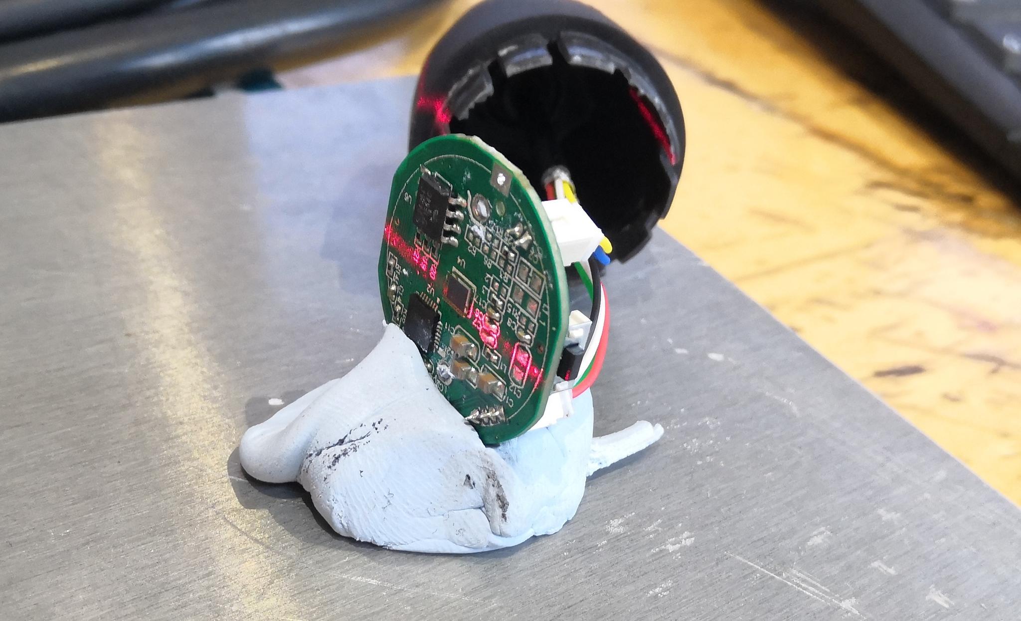

    A little bit more experimentation, some good news and some irritation. Firstly I stripped the sensor out of the microscope and used it without a lens, to my surprise this works very well. Effectively we are using the cmos sensor as a very high density light detector, it seem undamaged with direct exposure to the laser beam. This also means I can repackage it in a nice compact unit.

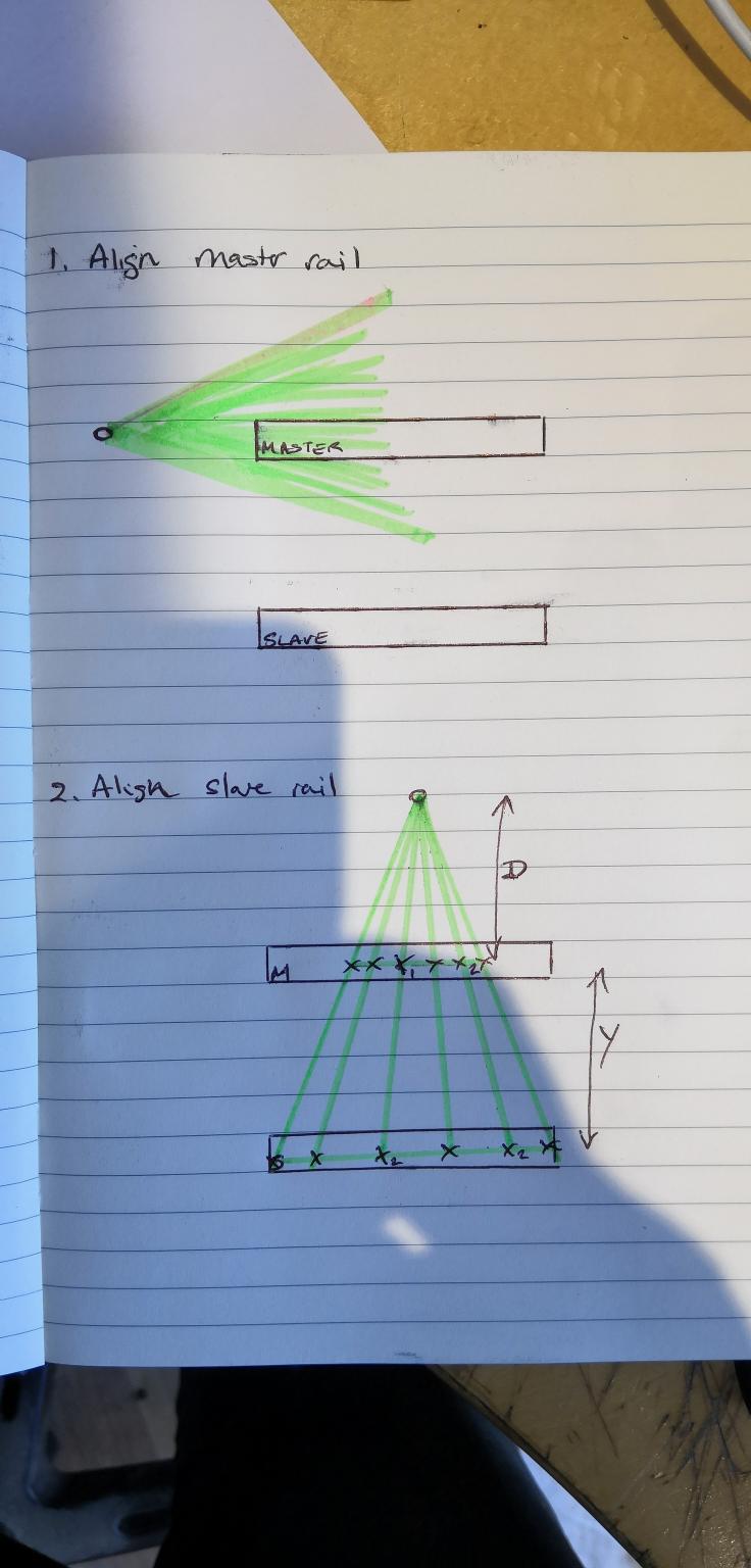

    I was just wondering (mentally wandering !) if you could get three mirrors on right-angle blocks, you could set up your rails to be co-planar by directing the laser back to the sensor at the same place.
    I was thinking you'd put the laser on some fixed external support, e.g. a stack of bricks, and mounting the sensor on a hiwin block and plotting heights relative to the laser reference plane by sliding the block up and down the rail, then off the rail and onto the other rail. Best fit a plane to these 3D points and show the height error to each point, then shim and repeat. This is the same process you would use with a machinist level but possible more accurate.

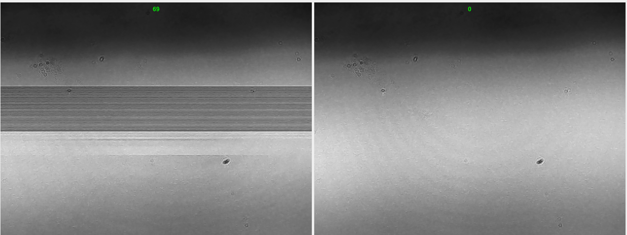

    I've now fixed the problem with the dewalt modulation, quite elegantly I think. The modulation was interfering with the rolling shutter on the sensor. All cheap camera sensors employ a rolling shutter, what this means is unlike a real film camera or a DSLR that have global shutters, i.e. the entire frame is exposed simultaneously, a rolling shutter is simply the sensor allows each row to integrate (usually from when it was last read out) and then reads the pixel value for that row after the previous row. This means that each row of the image is exposed at a slightly different time leading to horizontal artifacts such as banding due to 50hz AC lighting, motion blur where an object moving horizontally across the camera may appear to have the bottom leading the top, or vica versa, or in the case of a Dewalt laser level the light source being annoyingly flickered on and off a banding of black lines that moves up the image frame to frame.
    Since we are only interested in one dimension (height) the simple fix is to make this dimension perpendicular to the direction of the rolling shutter, i.e turn the sensor through 90 degrees! This has the added advantage given the aspect ratio of the sensor is wider than tall like your TV screen, in giving us more vertical resolution.
    Now works like a dream, short video of me deflecting my desk which the sensor is sitting on with light finger pressure, maybe 0.1-0.2mm, watch the PC screen behind reacting. Note you can still see the banding from the modulation but this is now vertically aligned and traveling horizontally so doesn't interfere with our nice gaussian beam.
