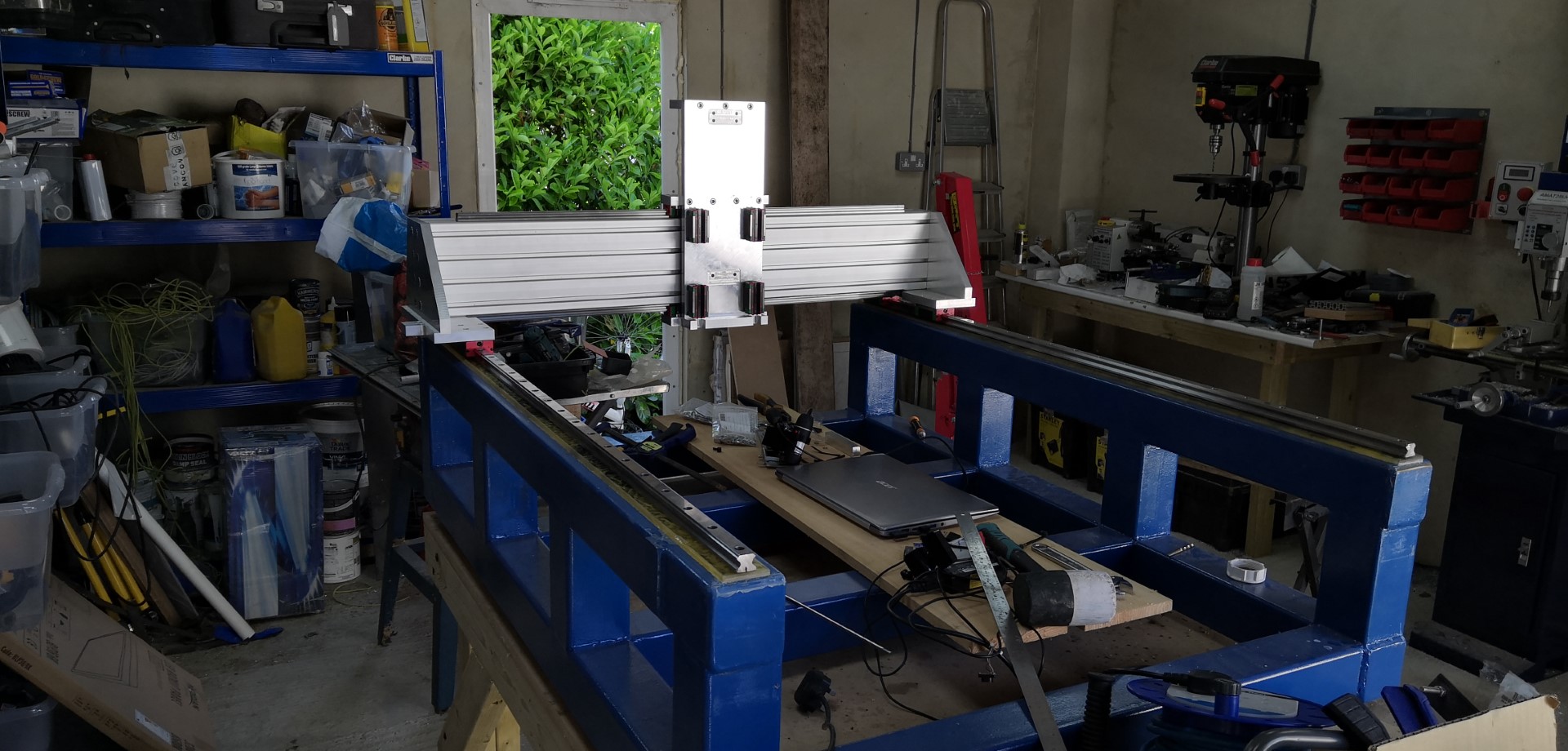

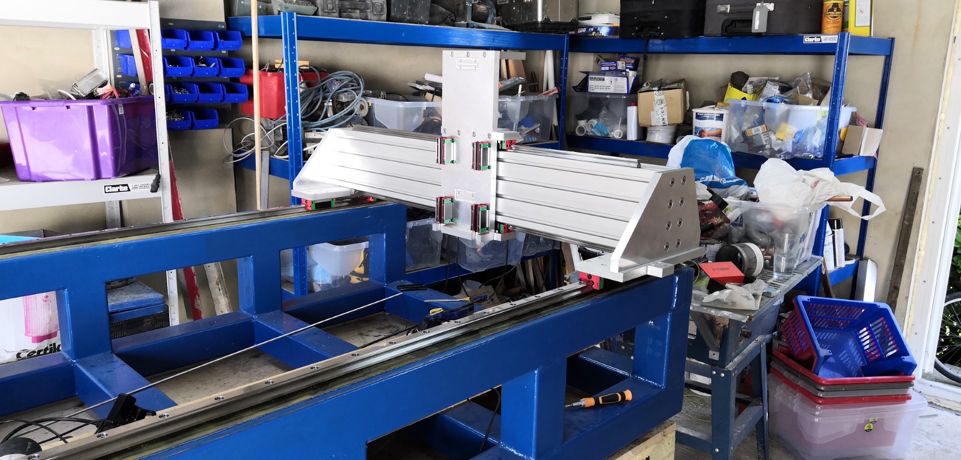

  3. #263
Name:	IMG_20200526_161419 (Large).jpg
ID:	28205 Click image for larger version.
Name:	IMG_20200526_161433 (Large).jpg
    Will use gantry to space slave rail correctly, progress on this particular machine will continue in my build thread:
    http://www.mycncuk.com/threads/13178...-started/page8

  7. #267
    Quote Originally Posted by devmonkey View Post
    Afternoon all.
    Anyway the purpose of this post is to describe a new app I put together today for laying the master rail straight. I decided it would be easier to use a taut wire rather than the laser for this and a cheap USB microscope.
    The microscope is attached to a hiwin carriage and the new app accurately locates the wire allowing you to zero the tool then reports the error as you slide the carriage back and forth.
    Nothing new in the process that other people have performed other than the app that lets you achieve excellent accuracy with little effort.
    The wire locating algo is quite different from the laser gausian model and seems extremely robust.
    Cheers, Joe
