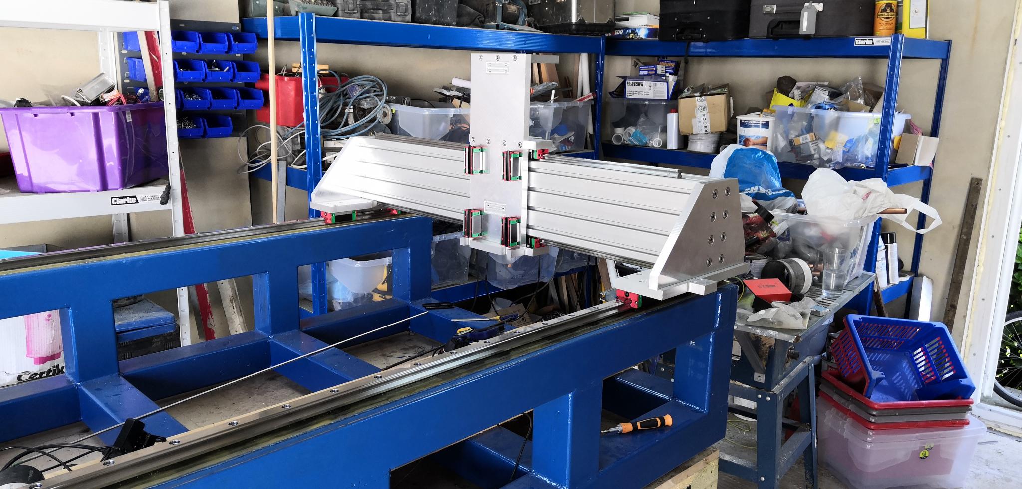

    I got back to the project after a break of a few months to work on other things. I ended up pouring epoxy to bring the X rails into plane, then set the master rail straight using a taut wire, microscope and some software as described here:
    http://www.mycncuk.com/threads/12966...r-level/page27
    I now have both rails mounted and the gantry moves very smoothly.

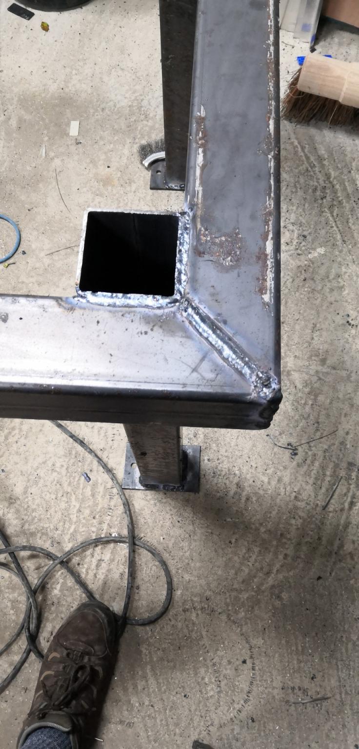

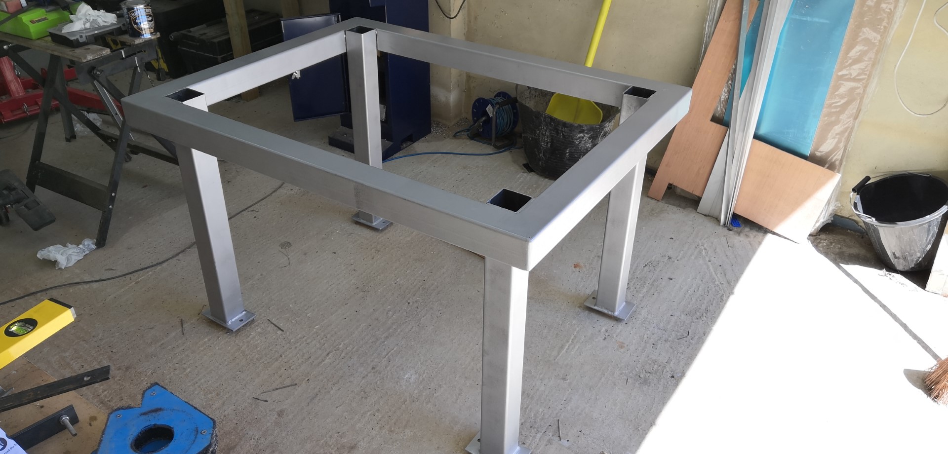

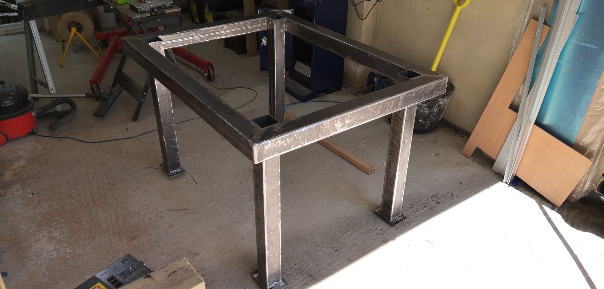

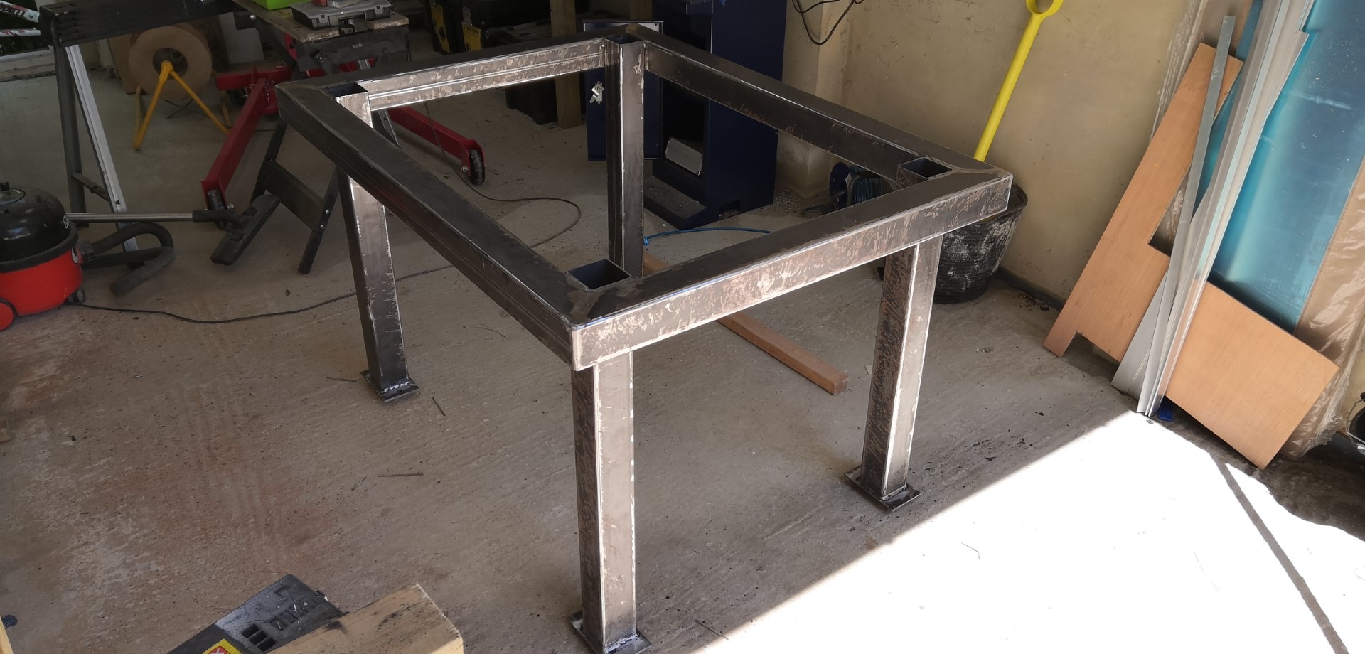

    Next step is to fabricate the motor brackets and mount the ballscrews and steppers. I've ordered belts and pulleys and am waiting on these so in the meantime I started to fabricate a stand for the machine. Since the machine is itself a rigid structure this stand only serves to anchor it to the floor at a decent working height, hence the lack of bracing. All 4 legs will be bolted to the concrete floor then the machine will sit ontop on leveling bolts, finally the machine frame will be clamped hard to the stand so that it doesn't throw itself across the room (voice of experience...).
    Cut and welded yesterday, painting in silver hammerite today. The more I use it the more I love this little MMA stick welder. welded the 3mm box section mitres at only 45amps! Almost as good as a MIG without any complications.
Name:	IMG_20200528_195623_1 (Large).jpg
ID:	28237 Click image for larger version.
Name:	IMG_20200529_115806 (Large).jpg
ID:	28238 Click image for larger version.
Name:	IMG_20200529_123836 (Large).jpg

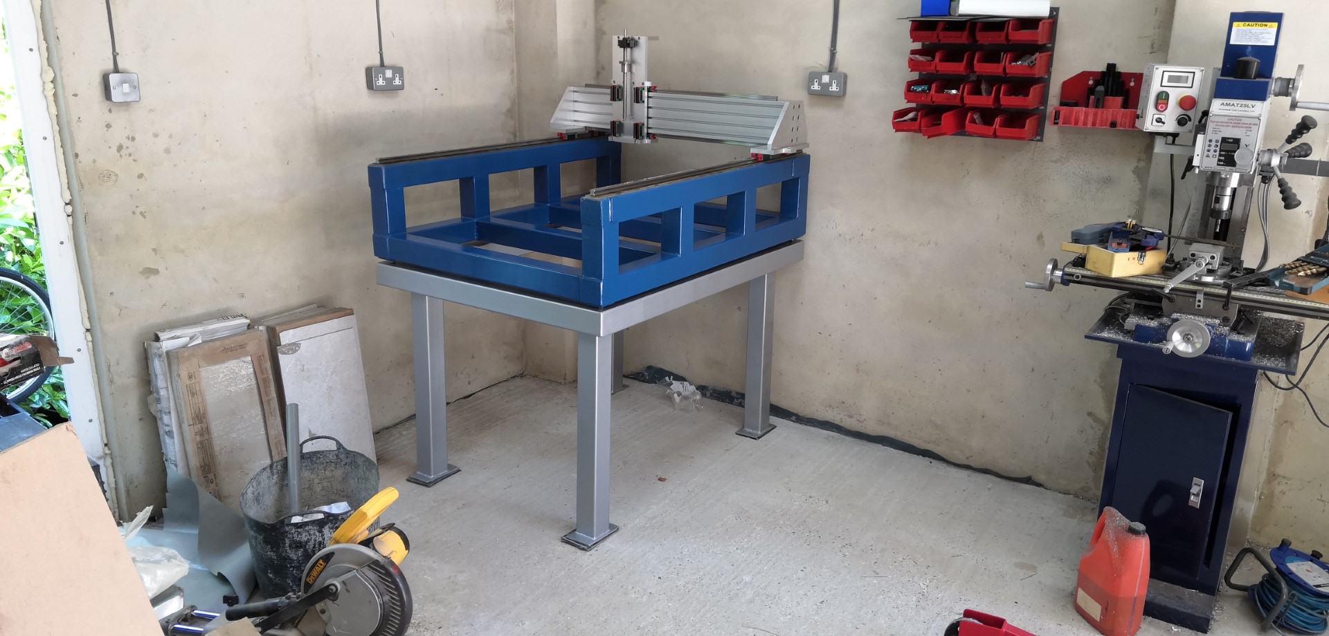

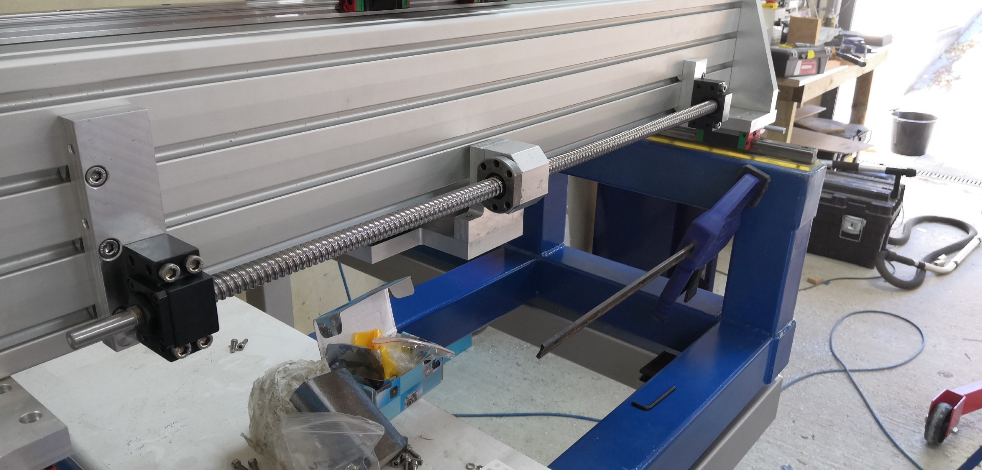

    Stand levelled on floor and machine craned ontop to check final position, needs to be moved out from the wall a bit so I can fit/service the ballscrews motors. Starting to look like a CNC machine!
Name:	IMG_20200530_124355 (Large).jpg

    Looks seriously serious! Make sure you have enough room to move around it while bending over and enough room to fit a screwdriver in all the places you didn't think you'd need to fit a screwdriver when you first thought "I'll put it here!".

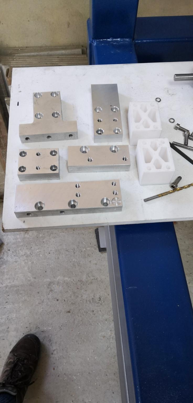

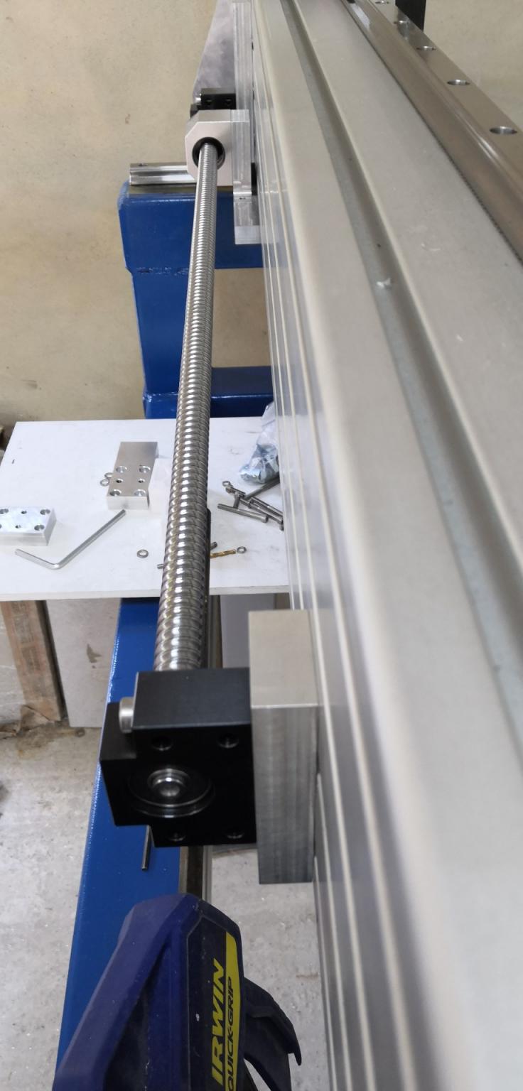

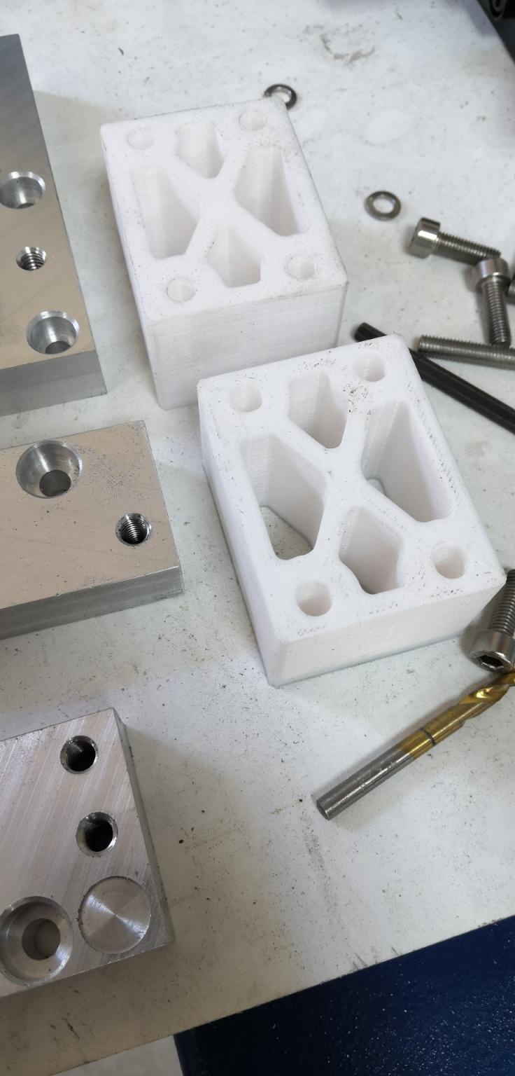

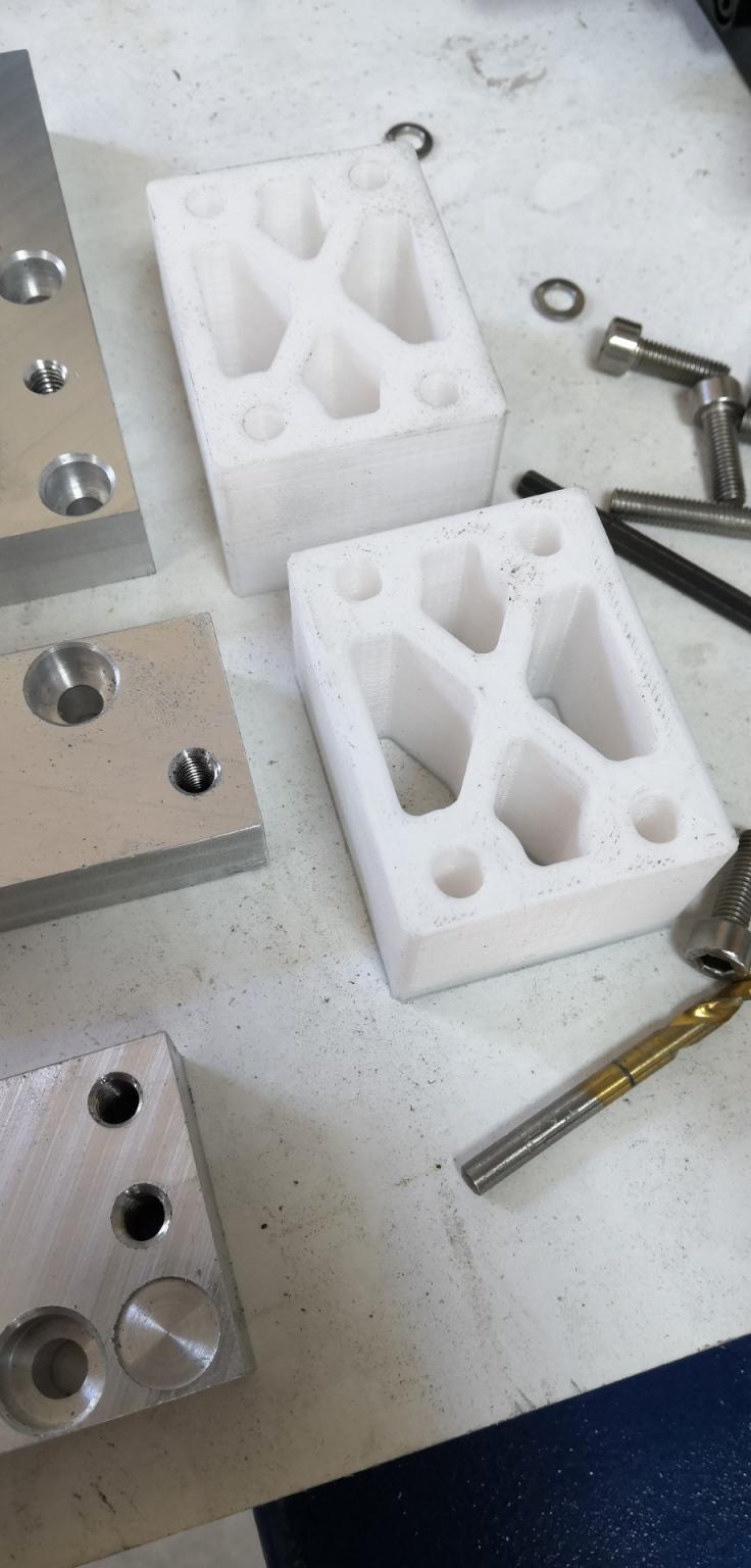

    Finished making the last set of plates, these are for the X and Y axis, ballscrew mounting. Hopefully this is the last of the aluminium work on the manual mill. I still need to make some stepper mounting plates but leaning towards doing those in 3mm steel.The white parts are 3D printed standoffs for the X axis ballnut holders, I didn't have any large enough ally stock so we will have to see how they fare. They get clamped between two aluminium lumps so should be ok, if not will replace when I have some bar stock.
Name:	IMG_20200531_154645 (Large).jpg
ID:	28250 Click image for larger version.
Name:	IMG_20200531_154654 (Large).jpg

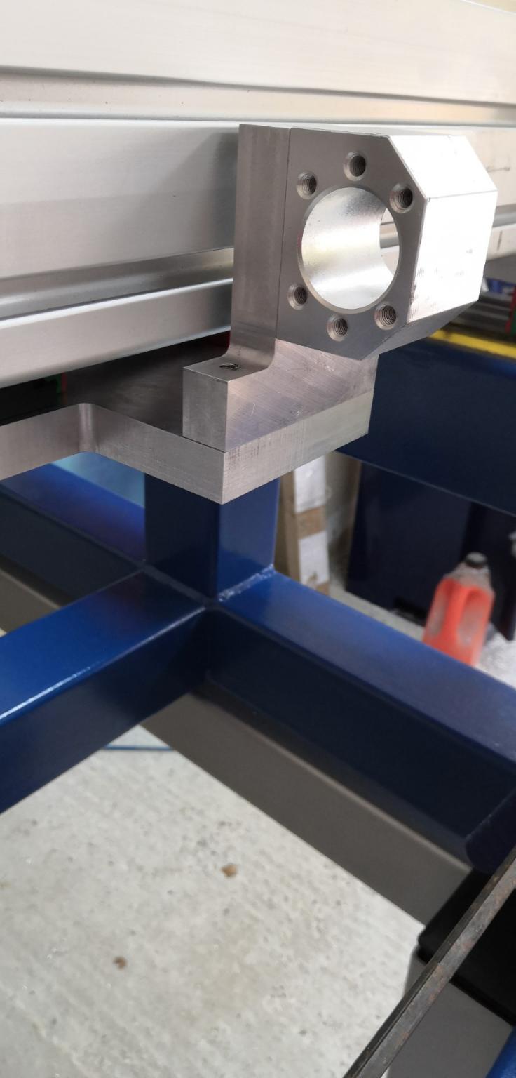

    Any they all fit:
