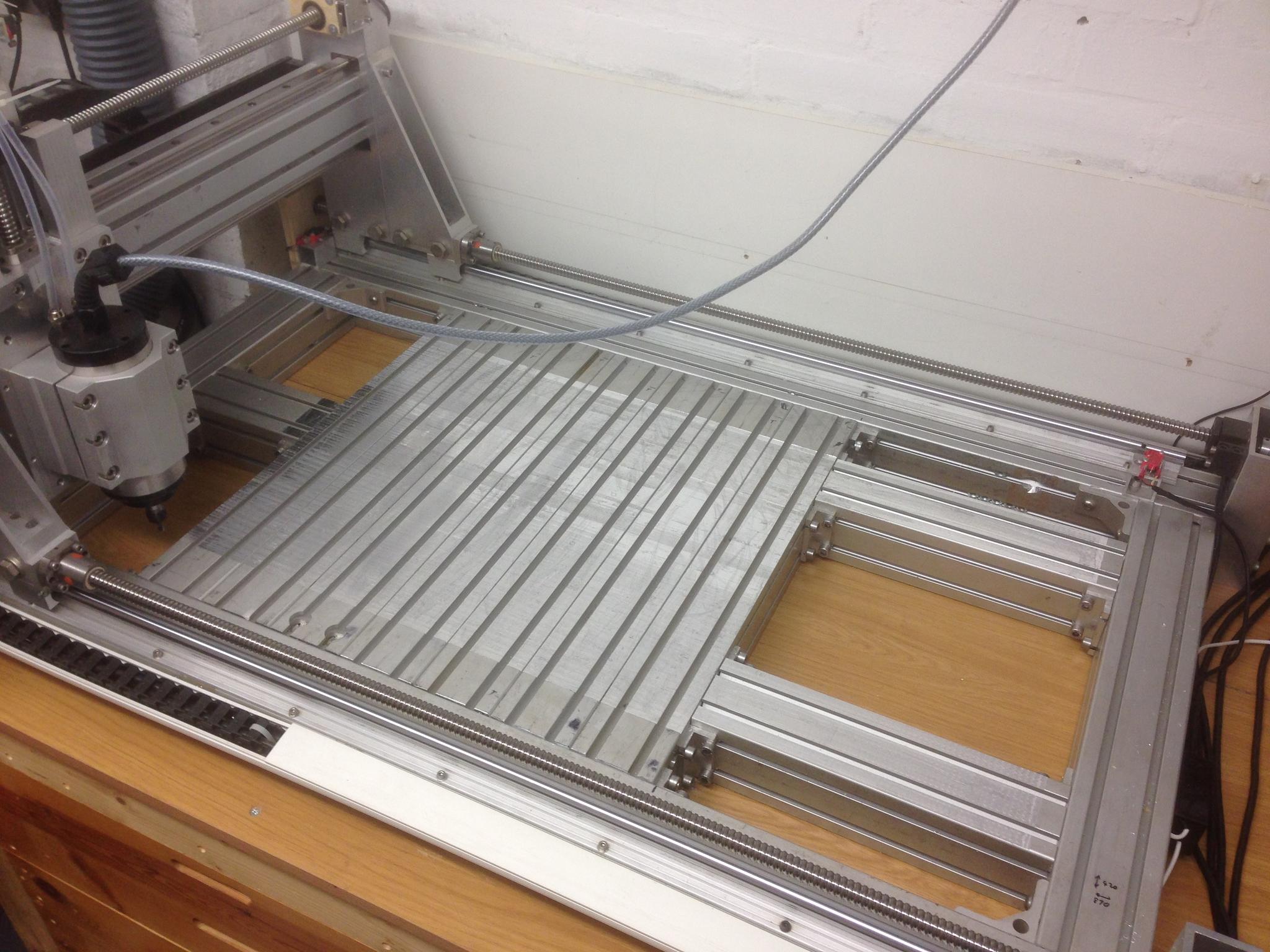

    CNC router MK3:

    Footprint approx: 1200x700mm
    Cutting area approx: 800x500mm
    Z travel approx: 150mm
    Linear movement: X=16mm supported rail, Y=Hiwin 20 square, Z=Hiwin 15 square
    Transmission: 1:1 ball screws 1605
    Motors: X,Y,A = Nema23 3Nm at 72V (DIY linear PSU), Z = Nema23 1.8Nm at 72V, all DQ860MA analogue drives
    Breakout board: DB25 (Free simple board which came with the drives - OK so far . . .)
    Spindle: 1.5 kW watercooled spindle with Huanyang vfd/inverter
    Frame- 80x80 heavy gauge aluminium profile, bolted
    Gantry- 80x80 heavy gauge aluminium profile, bolted, plus aluminium box section sides, bolted
    Build log: http://www.mycncuk.com/threads/6988-routercnc_MK3
    Machines: liteply, wood, and occasional aluminium
    Notes:
    1. Works very well for intended purpose (wood mostly).
    2. Would go with 1610 ballscrews on X and Y next time, most likely digital drives, plus at least 2.2 kW spindle to allow tools up to 12mm.
