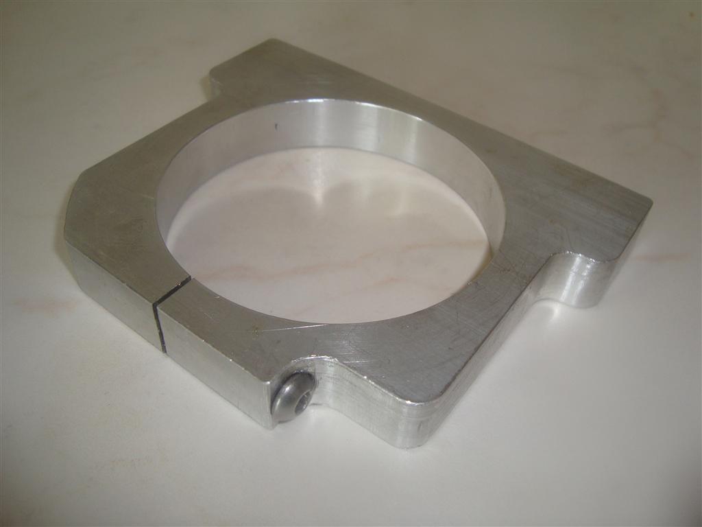

    I've made a few 80mm spindle mounts (only one picture shows finished mount):

    The drawing is just an example - if you want a different size or to draw your own that's fine. I have got aluminium in stock to do up to 150mm wide and 1/2" thick, or 5/8" thick and 125mm wide.

    Do you think that mount is strong enough? it looks to be very thin near the clamping bolt (If my maths is right, 4.7mm) and you have a sharp internal corner at this point too. With this stress concentration and the cyclical loading that a spindle typically gets, I wouldn't expect it to be too long before a crack appears.
    Yes I thought that looked like a weak point when I'd made it. Once it's clamped on to the spindle it can't bend, so fatigue shouldn't be an issue. It seems perfectly solid.
    That's why on the next version (last photo) I rounded off that corner and moved it further from the spindle to make it stronger. Changing the drawing is not a problem.
    If it breaks naturally I would replace it free of charge.
    Possibly a bit late now, but just in case anyone reads this and is interested in one here's the 'latest version' without the aforementioned weaker point:

    Only kidding. Mine is very similar, basically the same shape but without the rounded off corners seeing as I made it on the milling machine then lathed out the inside.
    I have just cut two more alu plates today at work and I am going to make two more spindle mounts and see if I can get two identical mounts that are a better fit for the spindle than the last one I made.

    [QUOTE=Web Goblin;23056] Mine is very similar, basically the same shape but without the rounded off corners seeing as I made it on the milling machine then lathed out the inside.
    I see, same as the one I made with my CNC router then bored on the lathe...last photo in post #2 shows it before boring.
    Jonathan,
    I would have loved to make them on the router, that way they would have been identical. Why didnt you mill out the inside completely on the router?
    Ian
    I did them on my router as it's far quicker than the milling machine. I left small (1mm thick) tabs so that the middle bit didn't go walkies on the final pass. Boring the hole is more accurate (by accurate I mean it's closer to a circle, and better finish) than milling it.
