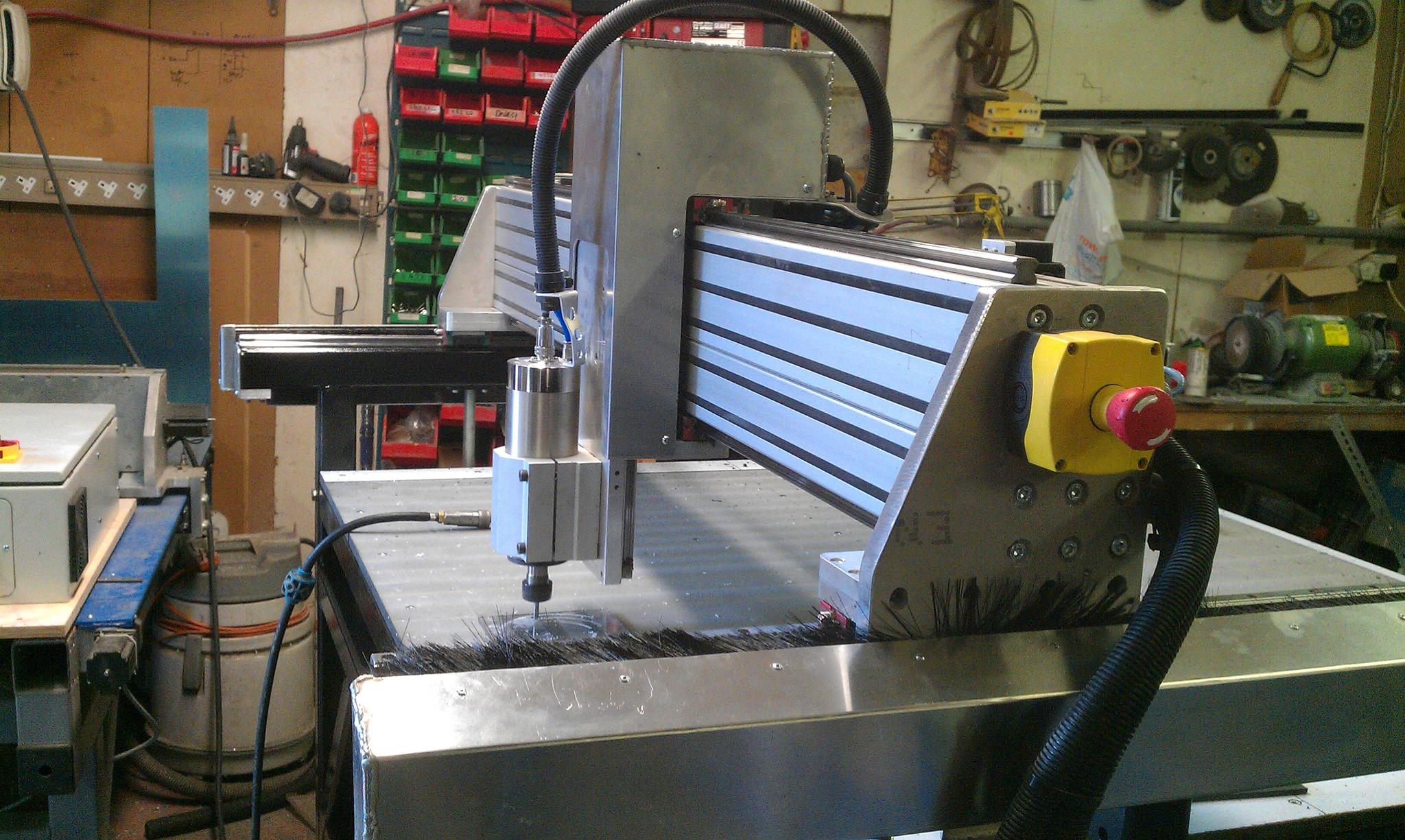

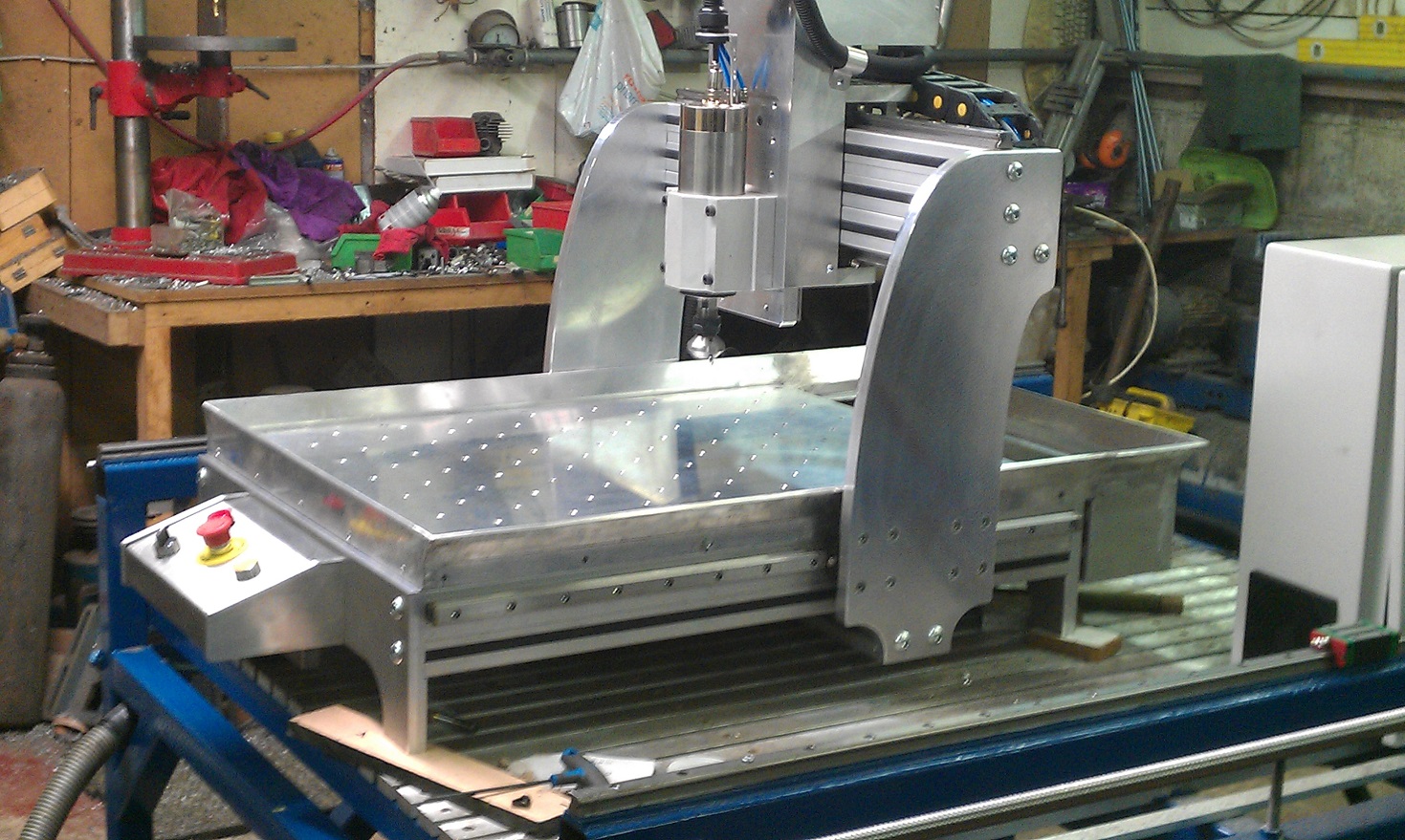

  4. I don't mind the highjack interesting to read... Although I think the cornflake packet is where I'm headed! Jazz when you build your L gantry machines which option do you use? I thought I had seen you use rails top and bottom?
  5. #165
    Quote Originally Posted by JoeHarris View Post
    Yes top and Bottom like this.
    Or This without tall sides.
  7. #166
    Hi Jazz,
    So your small design above doesn't have a back piece on the Z axis assembly, but has side panels to give strength to the joints?
    Looking again at rail location, would one rail on the bottom and one on the front be a good combination? Like this machine:
  8. #167
    Quote Originally Posted by Tenson View Post
    Hi Jazz,
    Yes doesn't have back piece because it add's no strength just weight. The Panels you refer to are not for strength, thou they do slightly add some. It's purely a Cover to protect the whole Z axis assembly from dust and crap. It's very affective and neat.
    The 90Deg joints are perfectly strong enough for any type of work upto and including machining aluminium.!
    Regards rail location then it's a personal choice and also partly machine design related. Me personally I prefer to keep things stout and compact and gain maximum real estate. But if you need clearence for ballscrews etc at the front then putting rails on the front allows this and keeps it stiff. Each way has it's own Plus's & minus's. Both work equally well so take your pick.!!

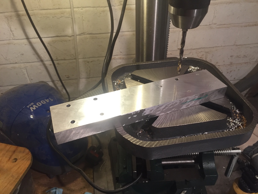

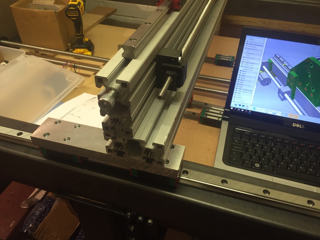

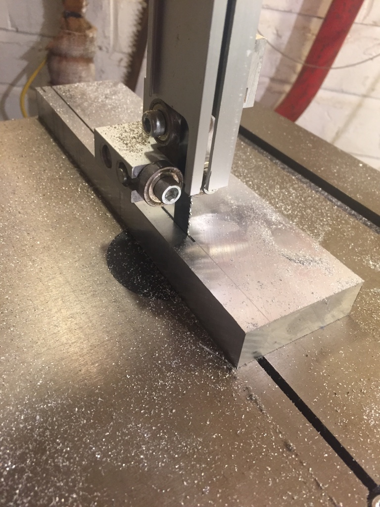

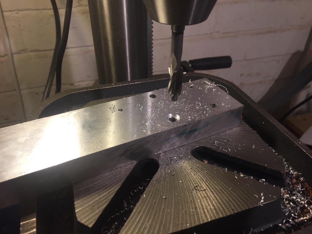

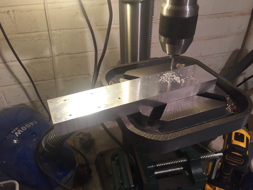

  9. Bit of an update. I've bought some plate and started to make some of the aluminium parts. Tried out my new counter bores too which were an absolute joy to use Click image for larger version.
ID:	16896Click image for larger version.
ID:	16897Click image for larger version.
ID:	16898Click image for larger version.
ID:	16899Click image for larger version.

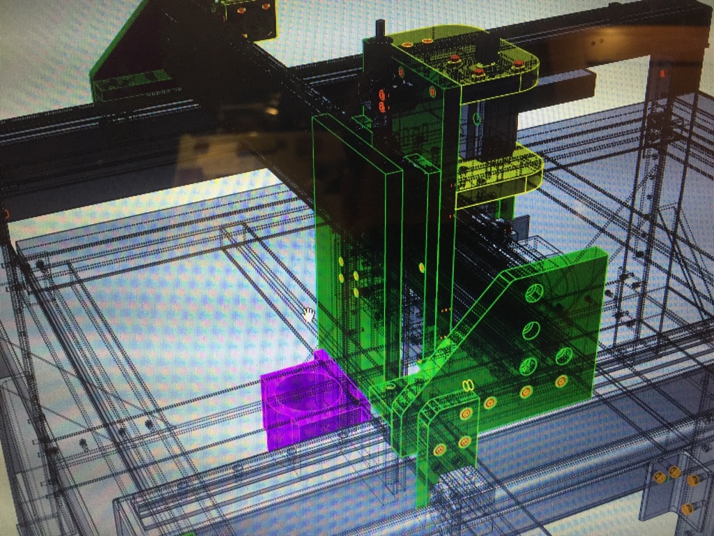

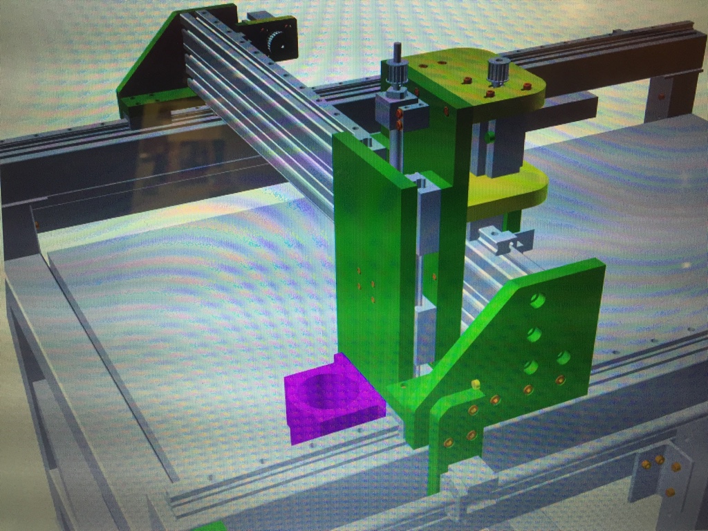

  10. Oh and the model has changed again too! Click image for larger version.
ID:	16901Click image for larger version.
  11. #170
    Looking good Joe coming along nicely
