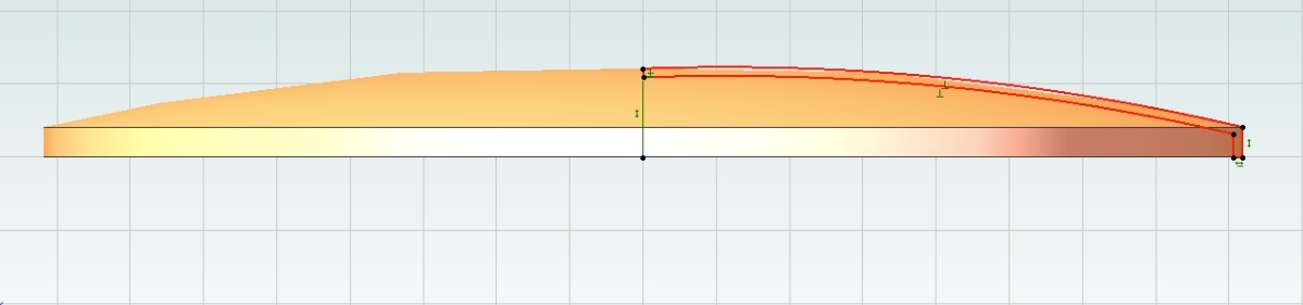

    It has rotational symmetry, so use the revolved profile tool... or whatever they call it these days. You then just draw the cross section, specify the axis and the program creates the solid.
    Nice one J! Now ive manage to do that dont suppose you have an idea of how to hollow the middle out do you? say 10mm thick
    Your 2D profile needs to include the 'hollow' as well, then there is no need to hollow out.. the red area indicates the original profile before revolving to 3D.
    See the attached file:
    By the way, this is Alibre Design, not solidworks but the principle is the same.
    Ah ha nice one robo! unfortunately i still cant draw like that in SW so i have to draw that shape in corel and import it that way lol still getting used to the planes
    would it be the shell comand in SW by any chance Clive
    I know it intended for Clive, but it was indeed the revolved tool. worked like a charm
