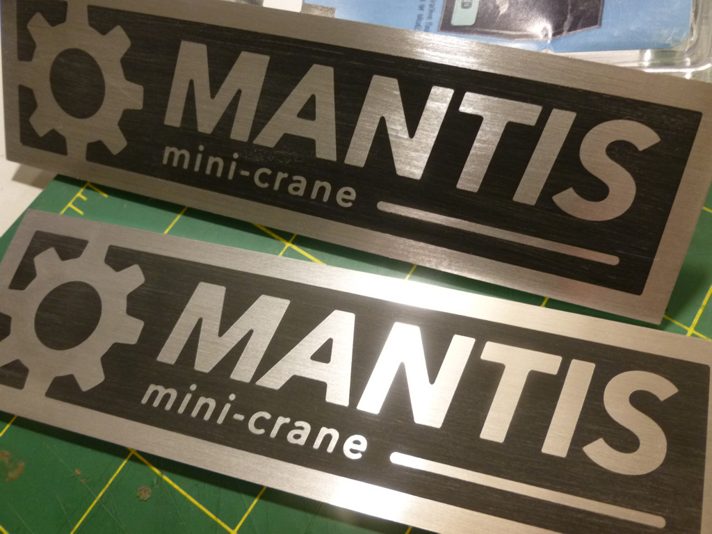

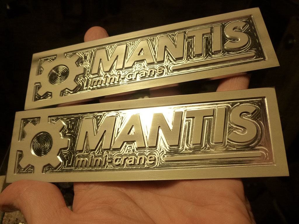

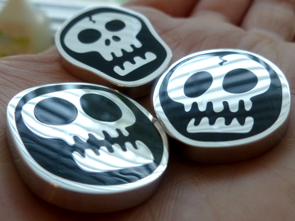

    Finally had a bit of success using the pressure tank - it still leaks but using the compressor as a remote tank keeps it topped up for long enough to do its job. Bubbles sufficiently minimised - well , I can't see any... It's still important to prod the epoxy into the nooks and crannies - the pressure won't force the epoxy into any left-over voids in corners, as I discovered on an earlier test piece.

    The MANTIS badges have been belt-sanded flush, I did attempt to polish one of 'em but the finish was rather patchy - heh - it's difficult to get a decent consistency across a larger surface using small mops on a press-drill... smaller stuff (like the skulls) come out a treat, though.

    Hi Wal
    If you warm the epoxy up it'll get thinner and run into the corners better. Vacuum chamber would also help reduce bubbles.
    Andrew

    I do quite a bit of resin filling, the resin I use is as thin as water until it sets and I have no trouble getting it in to the finest detail, I apply my resin using a dropper and a syringe for very small detail. I work mainly on glass and stone but it works equally well for metal, Can be baked in an oven as well for fast curing.
    The resin is 2 part and i can adjust the opacity and colour using colourants, also get some very good effects using colours as you would a water painting.

    Quote Originally Posted by alboy View Post
    Interesting - thanks for the tips guys. I've heard about flashing the epoxy with a blowtorch after pouring - not tried it as yet, but warming it up seems like a good idea. Alboy, what resin are you using? I use the stuff from Cookson Gold and it's pretty thick stuff - certainly too thick to apply via a syringe. Currently I'm using a cocktail stick and dripping the resin in off the point - and then using the point to push in to the nooks...
