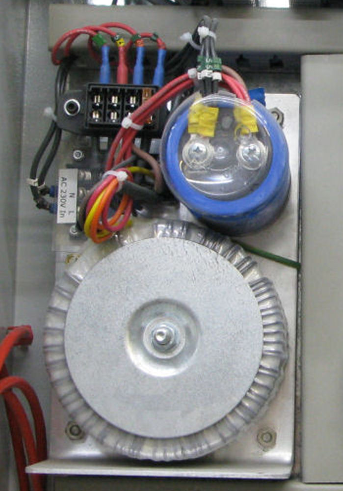

    Here's a picture of how mine looks, the bridge rectifier is under those wires between the terminals and the capacitor.

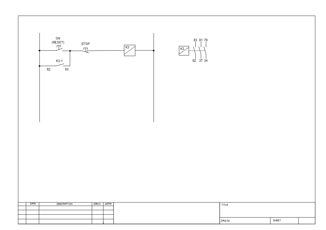

    And here's a typical latch circuit

    Nice pic. Eddy but I only see one cap!! How big is it ..Clive
    22000uF 100v

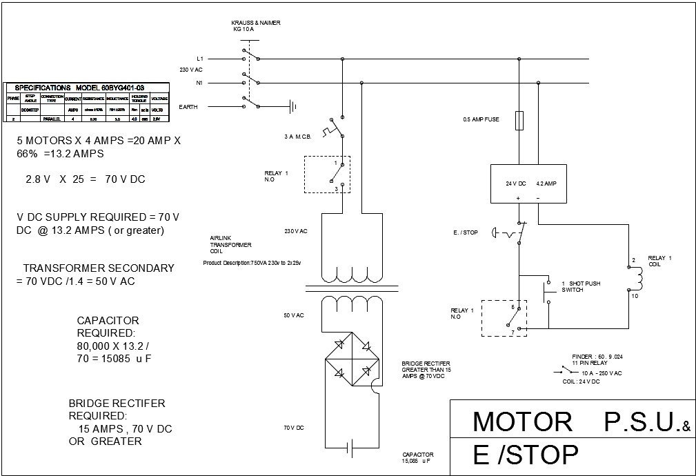

    well here is the PSU and e stop circuit . i'm not sure if my calcs. are correct so i could do with a second opinion. i have calculated for 5 motors but i'm only using 4 to get the me up and playing . the 5 motor will be for the A axis further on up the road ( https://www.youtube.com/watch?v=EIwEh6ZmFFs) i have calculated for the lowest cap. and rectifer but will go with something with more head room. any way , feed back would be great , cheers in advance

    22000uF 100v
    Wow that's big for one cap I am using 3 to get 14100uF may I ask where you got it. ..Clive

    Paulro That looks fine to me the rectifiers are usually 30 - 50 A anyway. Not sure I would switch the earth out though. ..Clive
