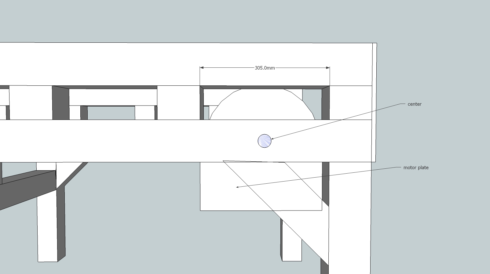

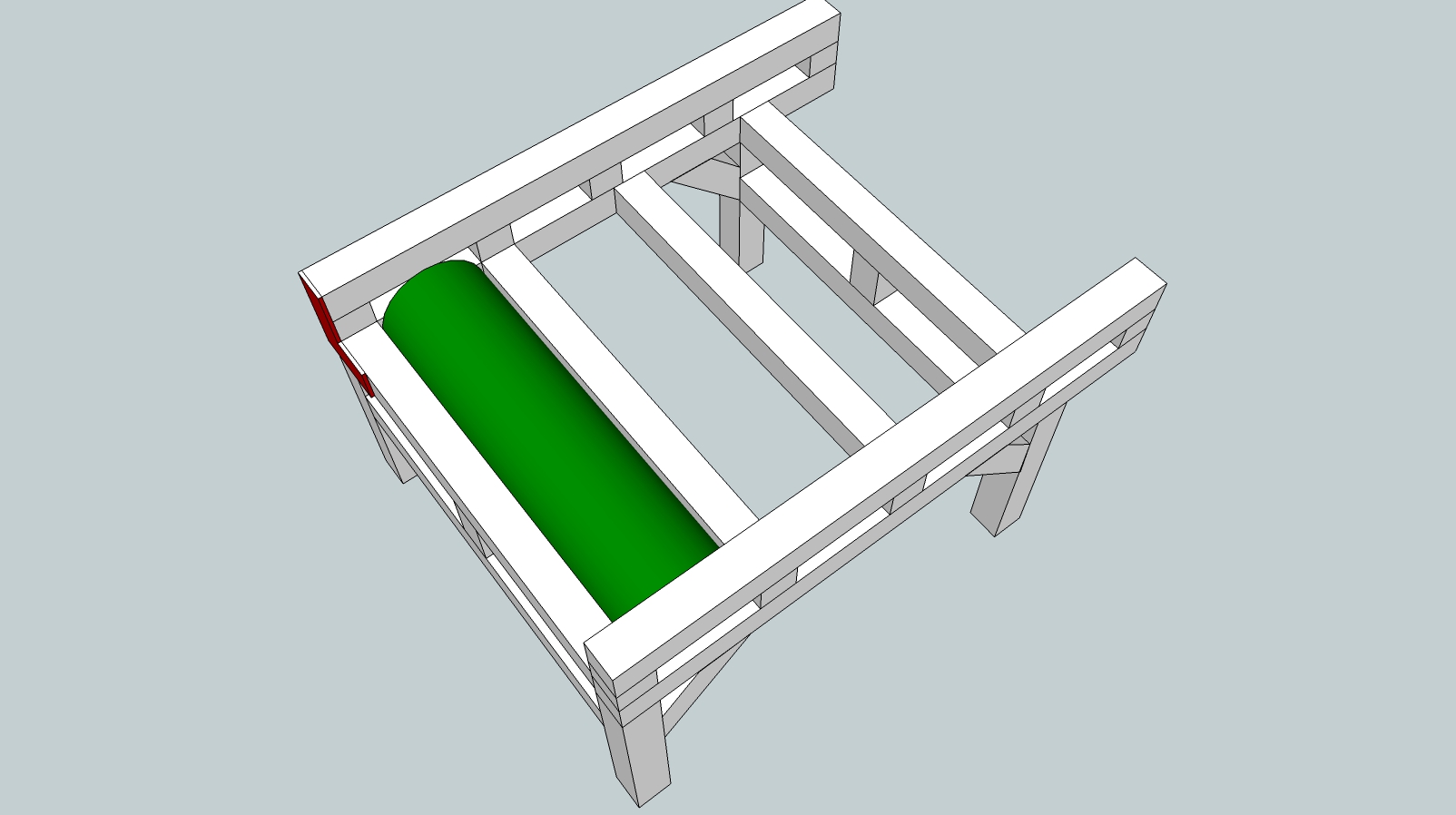

    - Now that you want 4rth axis to be 300mm OD is not a problem with 200mm axis and 2 beams separated on bed say 350mm where you can fit the axis and when not in use cover it with sheet.
    Will now go less radius as stated, but I can't quite picture what you actually mean here :).
    i mean this, the green is the 300mm diameter workpiece

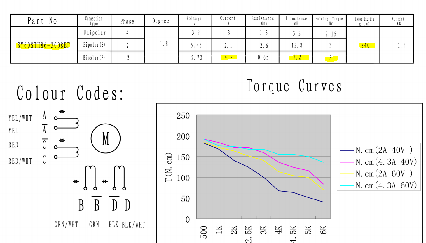

    No. this is nema 34 stepper . You need Nema 24 stepper 3Nm 4.2 A and look for the Low Inductance. I mean if you can not source that exact one below, which most people here use with the AM822 drivers or similar.

    That in case you decide to move the gantry with 2 motors which i recommend personally. Otherwise you will need to investigate Low inductance nema 34 motor which is not easy to come by at all. In that case you can look what motor they sell at http://www.cncrouterparts.com/960-oz...tor-p-112.html. its not so easy to source such motors as one may suppose.Read more here why it matters. But may be some one here can enlighten me which China guy sell them. Its good to know.

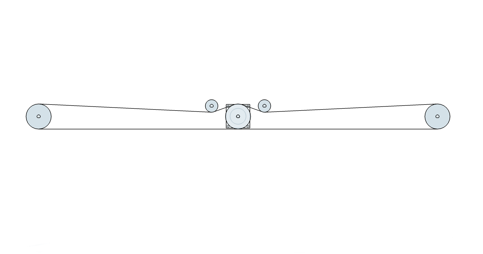

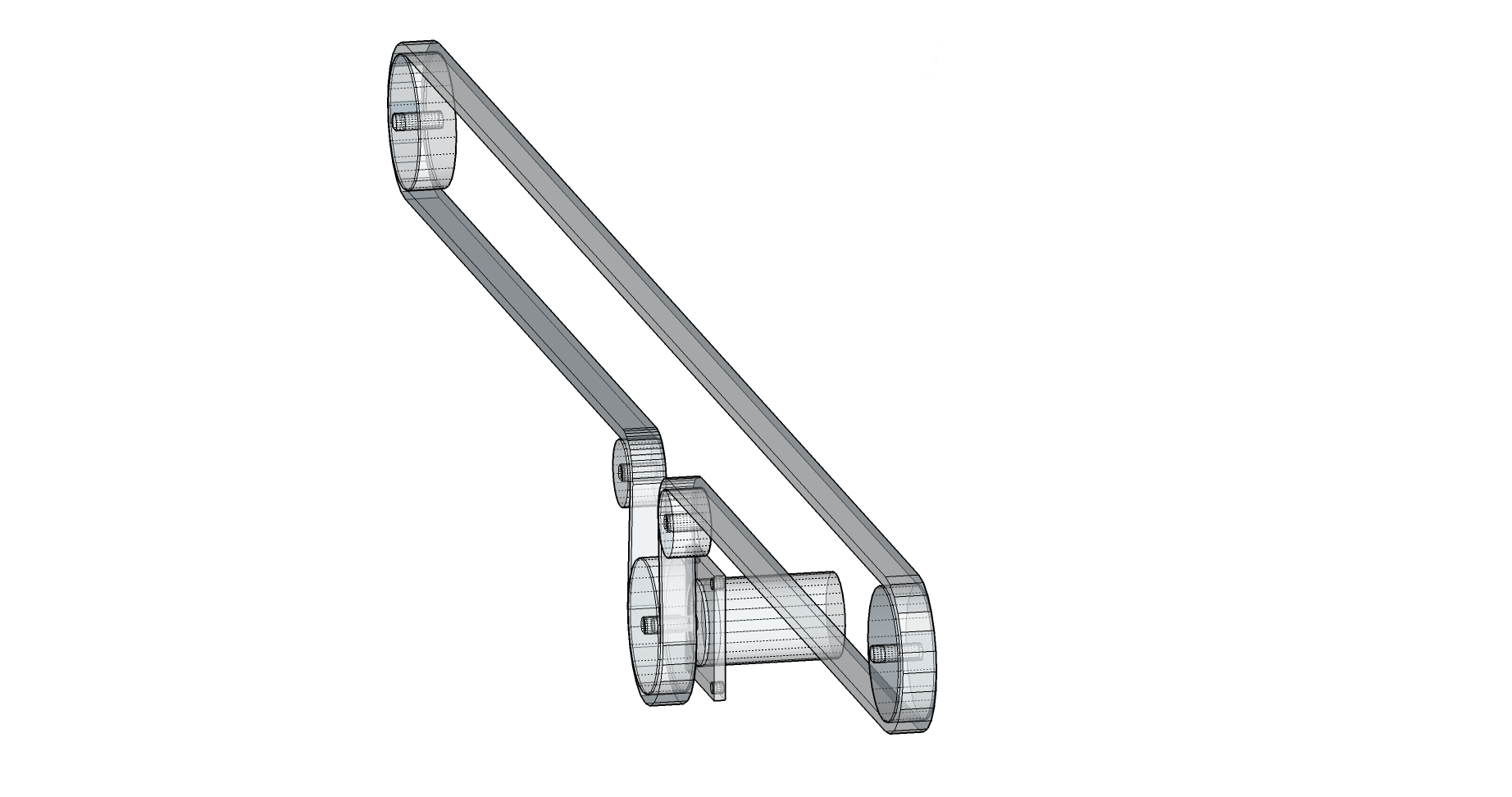

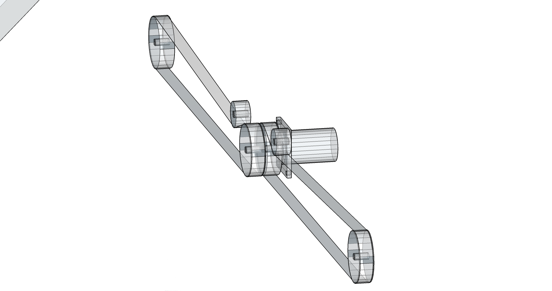

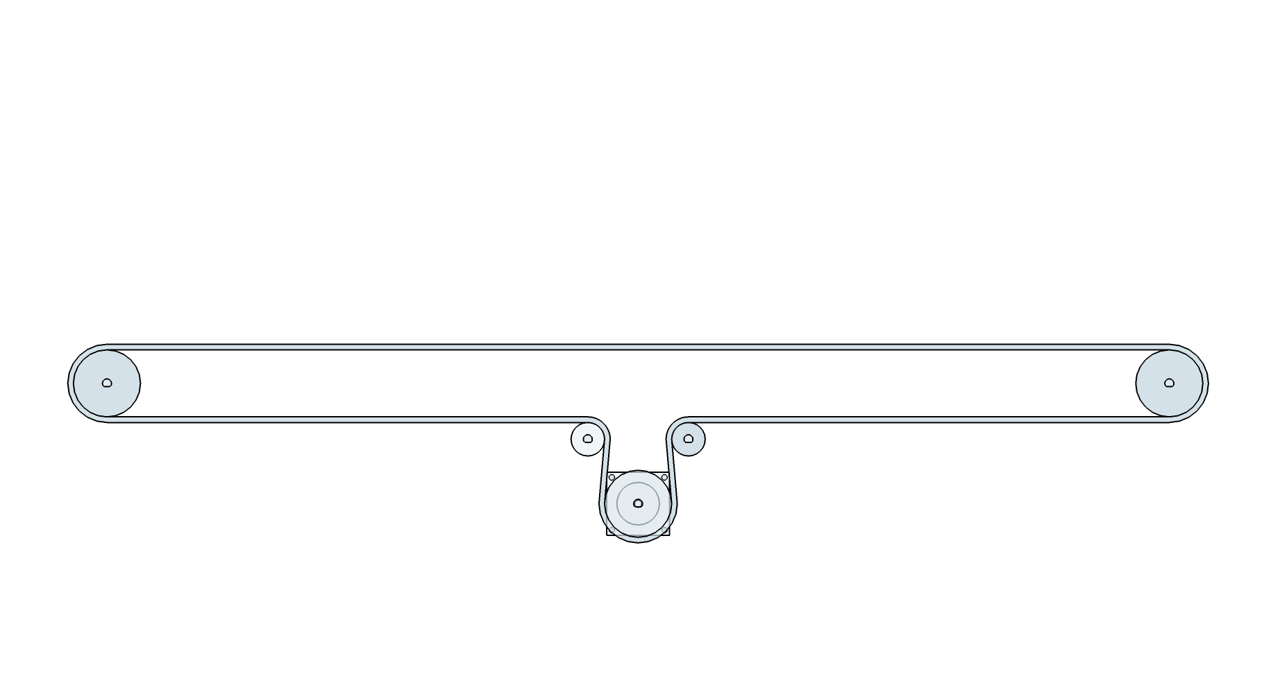

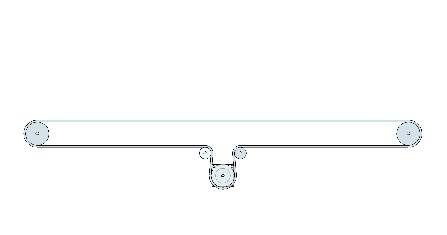

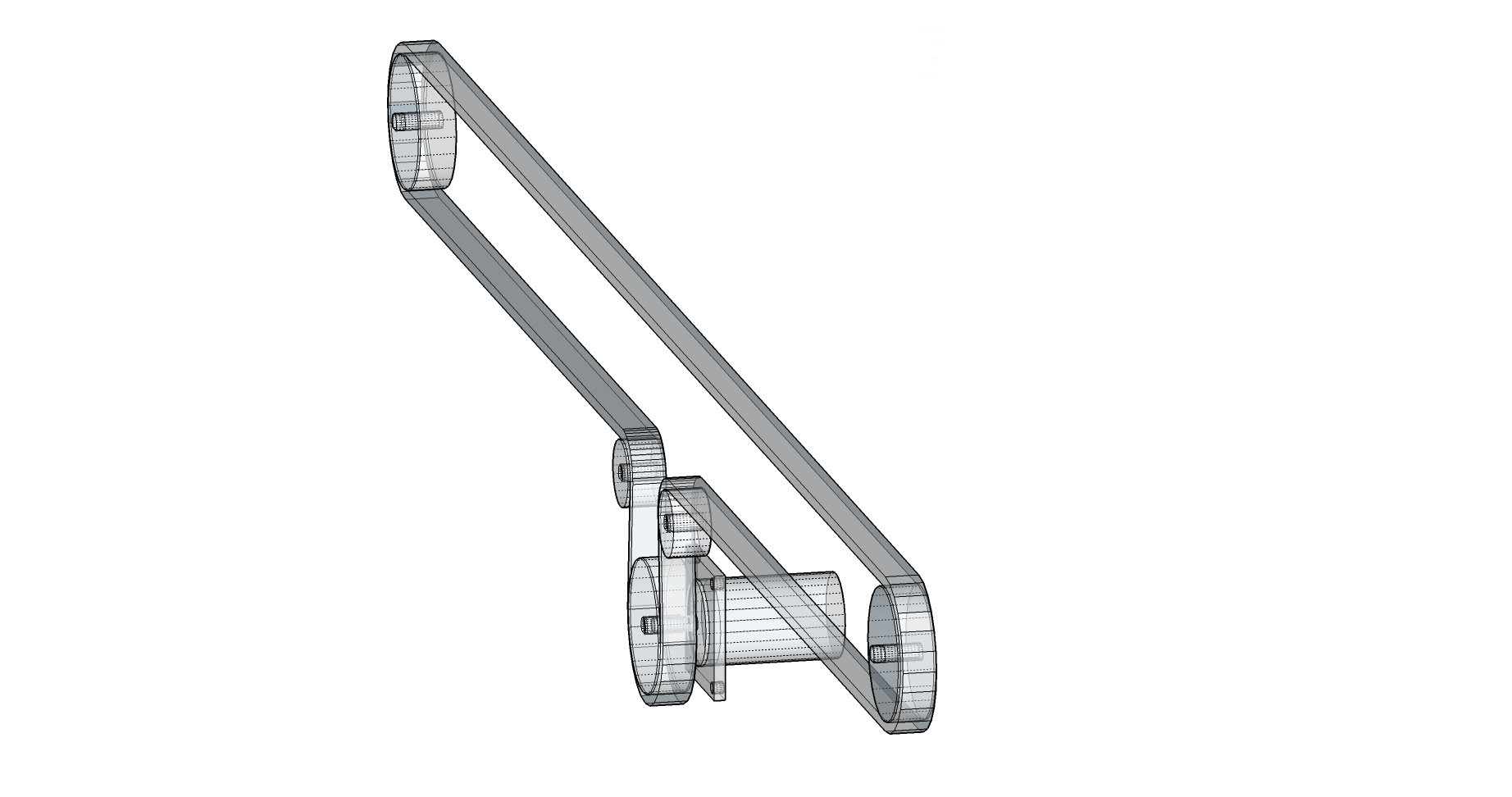

    Thanks,
    Either I'll go 2 motors (NEMA23 3Nm my preference at the mo as well) but I'm also looking into going with belt & pulley on the y-axis, using 1 motor. Lots of advantages, just have to mess with different configs. i.e. these options (tensioners not included - yet):
ID:	13134Click image for larger version.
ID:	13135Click image for larger version.
ID:	13136Click image for larger version.
    Where 1 & 2 are single belt and 2 & 3 are 2 belts, 1 to each side from the center. I'll do the calcs and maybe present for comments.
    I'm moving house at the mo, so will only really be online again in about a weeks time from Thursday.
    Thanks so far for all your comments.
