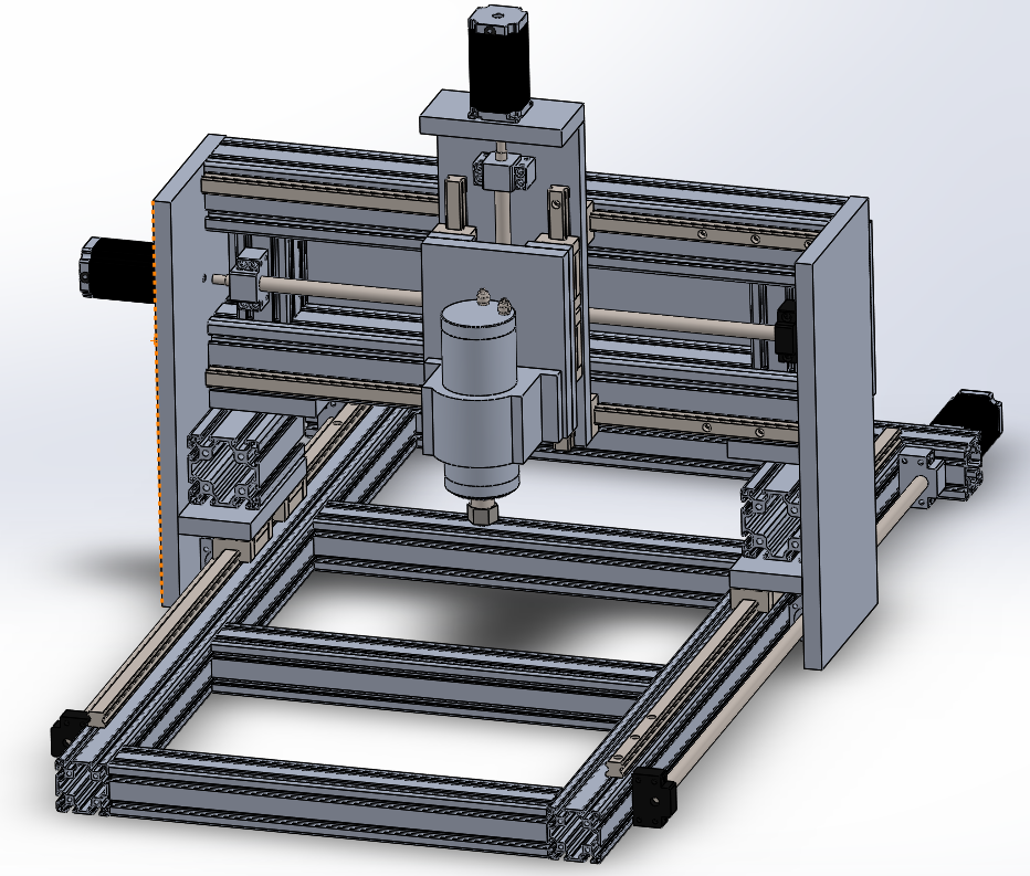

    I'm about to start a build of an all aluminum router. It's not my first build, but the previous ones were MDF abominations that should have been birthed squatting over a bucket of water. Let's not mention them again.
    Right now I'm in a design phase, and I'm very open to input. My build is constrained by rather small space, complete lack of decent tools, severely lacking metalworking skills and a tight budget.
    I've uploaded an album with some pictures of the build, and a few FEA simulations giving a hint of where the weak areas of the construction are.
    http://imgur.com/a/F77V6#0

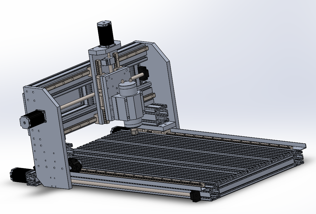

    Edit: Revised build after getting some tips - http://imgur.com/a/pM3GU
    Edit: Third iteration: http://imgur.com/a/kszzz
    Edit: Fourth iteration: http://imgur.com/a/zyBVw

    It's designed using 60x60 aluminum profiles and 20mm 5083 alu plates. I know 5083 is less than ideal, but it's what motedis.co.uk is carrying, which is where I plan to buy the bulk of the materials.
    The linear parts are designed from a kit:
    http://www.aliexpress.com/item/3-SBR20-300-600-1000mm-set-3-ballscrews-RM1605-ballscrew-support-3-BK-BF12-3-couplers/522559269.html
    My questions are:
    Will I be severely crippled by using 5083 instead of 6061 or 6083? If so, do you have a recommendation of an alternative to motedis? Apart from that, I am very impressed by them, without actually having bought anything yet.
    I'm considering going dual ballscrews on the x-axis. But I only have 3 steppers+drivers, meaning it would be a pretty hefty investment to get everything extra for that. Is it worth it? Is it essential for success?
    I'm having some trouble finding a good way to mount the ballscrew supports, any ideas?
    I'm going to use a 2.2kw water cooled spindle. Any ideas on a cheap, closed loop cooling system? Also, anyone tried the "Sanven" spindles on amazon.co.uk?
    Apart from that, I'm looking for any and all input on how the design could be improved. I'd like this one to be near perfect before I start buying stuff.

    You haven't mentioned what you want to cut, but with a machine like that you will be limited. Wood and plastic would be reasonable if accuracy was not critical - e.g. engraving, or general shape cutting.
    Beyond that there are many features which limit this machine, the high sides and single ballscrew being the immediate ones.
    Looking at your lateral stiffness analysis this shows 1000N gives 0.39mm. This equates to about 2500N/mm. Although this would be a reasonable start point if you could achieve it, it's not clear if the force is being applied at the spindle centre line, or closer to the gantry on the Z plate. If it is on the Z plate then the real figure would be much less. This analysis is also idealised assuming ballscrew bearings etc. are all solid. Putting this analysis to one side I would say based on your comment about 'near perfect before buying . . . ' this needs more work on the general design before you worry about material spec (e.g. 5083 vs 6061).
    Your other analysis showing maximum stress of 18MPa for 1000N is not that useful since all it shows is that the machine is massively strong enough and will not break during cutting. For example yield for 6061-T6 is about 240MPa and I think your cutting forces will be much less than 1000N. But don't confuse this with stiff enough because this will be a very basic machine as mentioned above.
    I think this is the least of your worries as the spindle will only need about 2-3 litres of water in a tank to keep it cool.
    Don't buy anything until you have put some sketches on here and had feed back from the very knowledgeable people on here and take the criticism in the spirit it which it is intended.
    Good luck with your build. ...clive
    If you want to go down the FEA route, then make sure you get the boundary conditions right - for example it looks like you've got the X-axis bearings on round rails, but constrained to the rail not free to rotate. Also, you've applied a force to the spindle mount and fixed the machine base, but it's the deflection between the spindle (tool) and the workpiece that matters - so draw a block of material on the machine bed and constrain that.
    Co-incidentally I've just been working out stiffness (torsional and axial) for ballscrews including the bearing mounts - the cheap 16mm ballscrews get around 50N/um. That's an order of magnitude greater than the stiffness of the gantry, so it could reasonably be neglected.

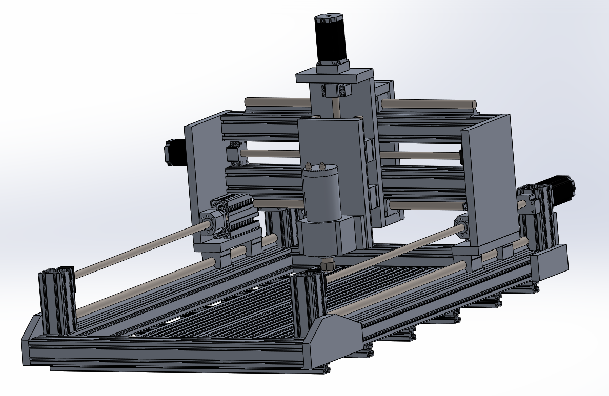

    Thanks for the feedback, much appreciated!
    I'd like to be able to mill aluminum, otherwise I'd feel like I failed. The building materials I'm using can handle alu at the precision I'm happy with, as Washout clearly shows in his build videos. It's up to me to make sure it does.
    As for the FEA, I'm not really looking at the numbers at this point. I know I've made too many simplifications and false assumtions for that. It was mostly there to get a visual feel of where the weaknesses were.
    I've redone large parts of the construction, trying to listen to the advice routercnc gave me. I've also taken some inspiration from Washouts machine.
    What kind of precision are you getting with yours when milling alu?
    Also, what kind of problems are the round rails giving you? Chatter, instability, binding?
    It's out of my league working with steel I think, even alu is stretching it.
    I've uploaded another album with some pics of my revised build.
    It was done in a bit of a hurry, I have to admit.
    What do you think? Did I improve it? Have I missed anything, apart from the obvious mounting of the ballscrew supports on the y-axis?

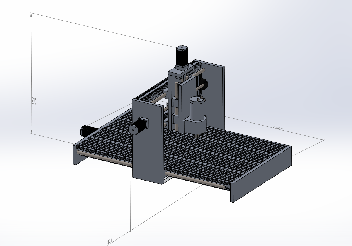

    To help you get more feedback I've dropped a screengrab from your site into this post - hope this is OK.
    Here is your version 1:

    Here is your version 2:
    If you are keen to stay with supported rails and aluminium extrusion then this is a pretty good layout, and much better than the first one. My view is that you will be able to cut wood easily and accurately, and the occasional bit of aluminium.
    But if you end up doing a lot of aluminium then you will find that this machine is not enough. An upgrade to profile linear rails on at least Y and Z is recommended, the gantry sections are too small and not joined to each other (e.g at least a plate over the back), and the X axis stepper motors are mounted off long brackets.
    With the layout you have now I would look at moving the X ballscrews outwards and down, level with the supported rails. Then extend the small horizontal plate which the gantry sits outwards and screw the ballnut to the underside of it. There are other variations but you get the idea. This will enable you to mount the motors nearer to the frame, effectively stiffening the X direction when cutting. If this is too big a change then at least make the small plates on the outside much bigger and triangulate up to the motor position.
