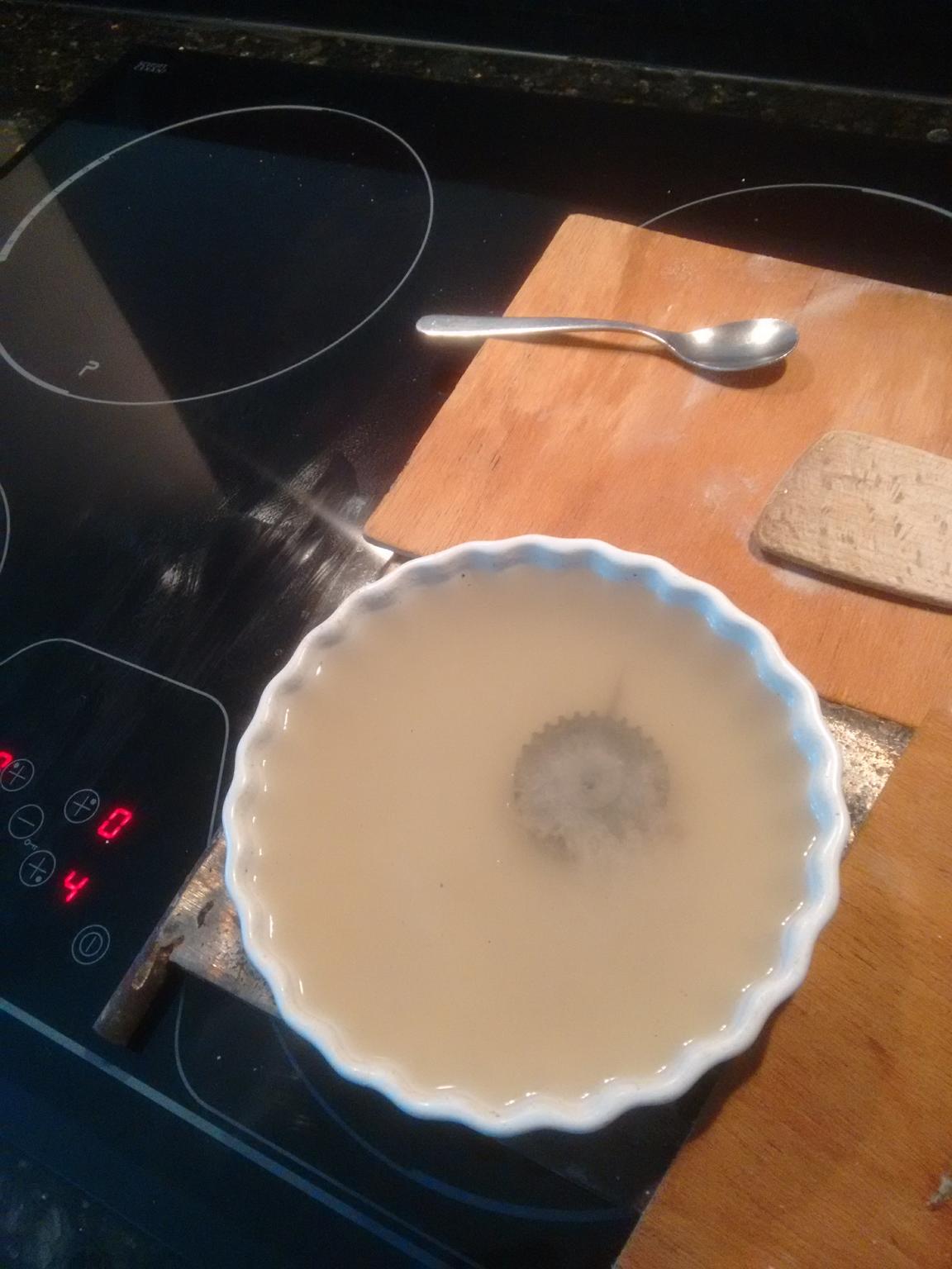

    Ok after making this for a HTD belt.Click image for larger version.
ID:	23701 upon drilling & tapping for the grub screws the tap broke full depth so I had a go with alum. Click image for larger version.
Name:	Tap removal Alum.jpg
    it took 500g of alum and 12 hours on the induction hob (the dish was on a piece of 3/8 steel plate) in two sessions at just below boiling point and having to keep it topped up with water ever 45min.
    Result tap was dissolved completely but did discolour the aly a bit, I could have made a new one quicker but wanted to try out the procedure. If I had to do it again I would have use a much deep container and suspended the part on a copper wire.

    Ah Yes, You need somebody to keep an eye on it to make sure it was topped up
    Nice post Clive glad it worked out. You might remember me messing about with alum to remove a broken tap without much success. I think keeping it hot must have helped you which I think you advise me at the time (?) but I couldn't get near the hob
    Luckily I don't break taps any more (ahem) . . .
    This -
    https://www.youtube.com/watch?v=bhzbpDgTvXU
    Use a 3L pop bottle to keep it topped up unattended
