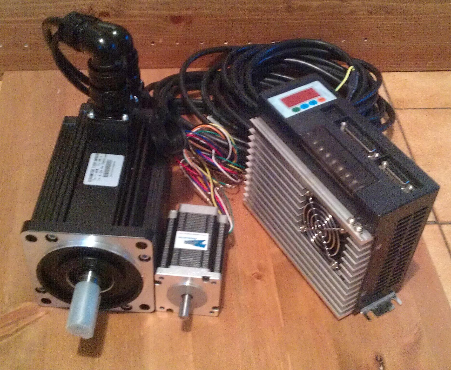

    Few things... Reckon il get away with steppers? if so, what size?

    If you go stepper motor route, get nema 34 12nm hybrid servos from the likes of leadshine. They are worth it. If the machine had cranks i would have said go the servo route but steppers will be fine. Worth investing in a dro too, just to keep a tab on how the machine performs.
    Keep us updataed on how it goes and who moves it for you
