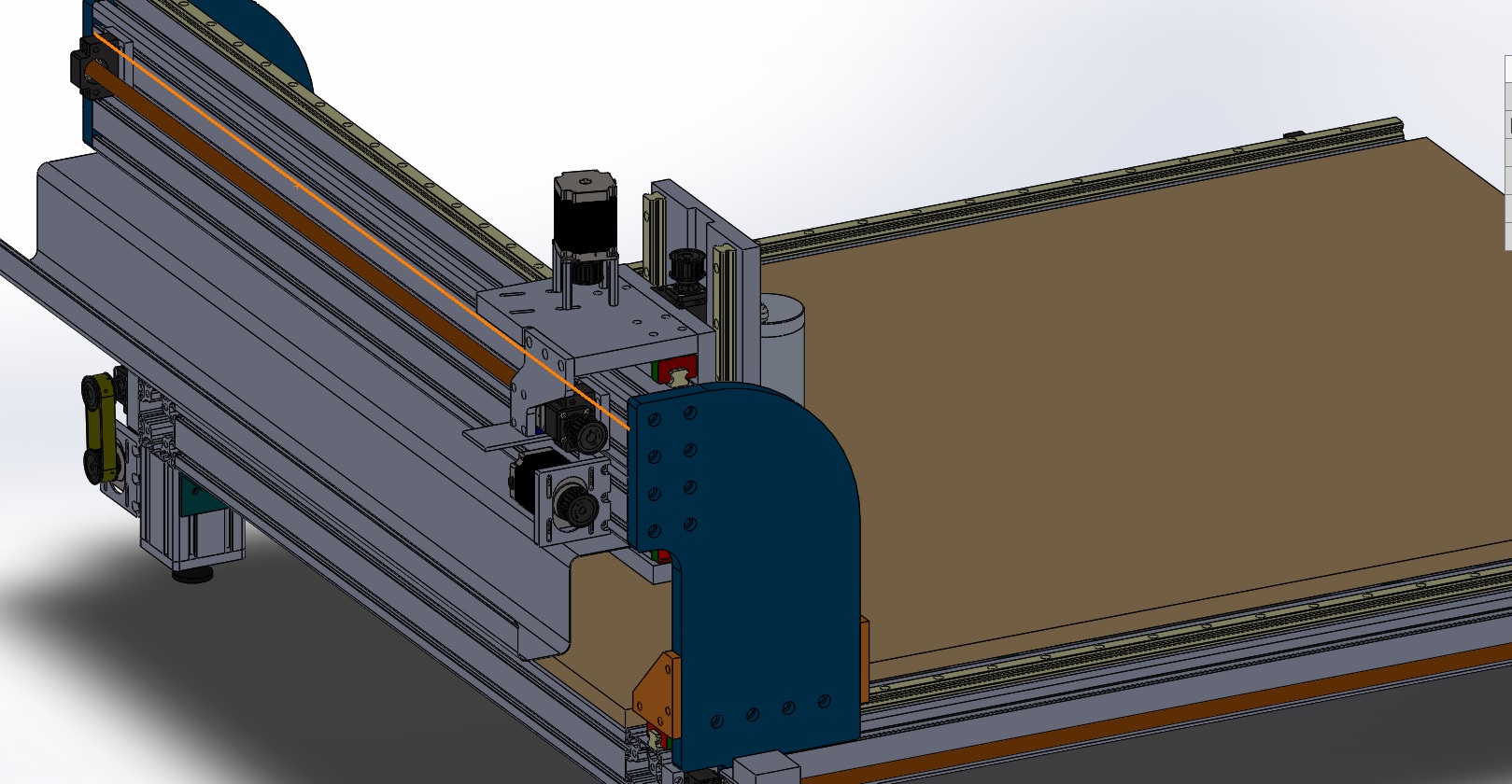

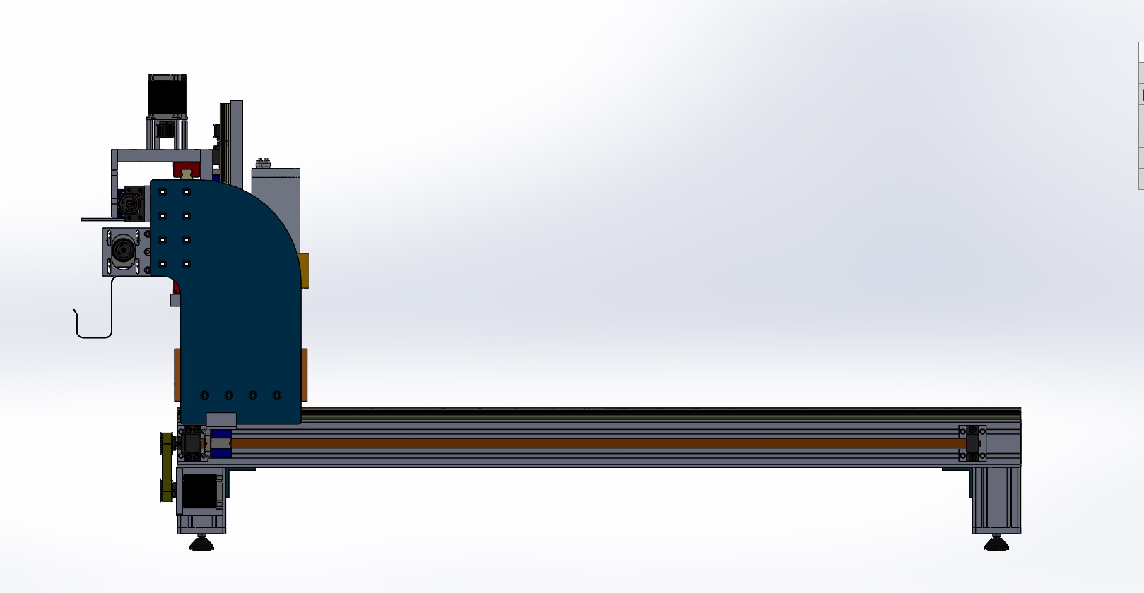

    Valdis in Reply to your PM then can't see any major issues with the design. Couple of small suggestions but other than these nothing seriously wrong.
    #1 I would brace the connection between bearing plate and gantry side.
    #2 Would bring the rails on the Gantry to front slot to lessen the lever affect.

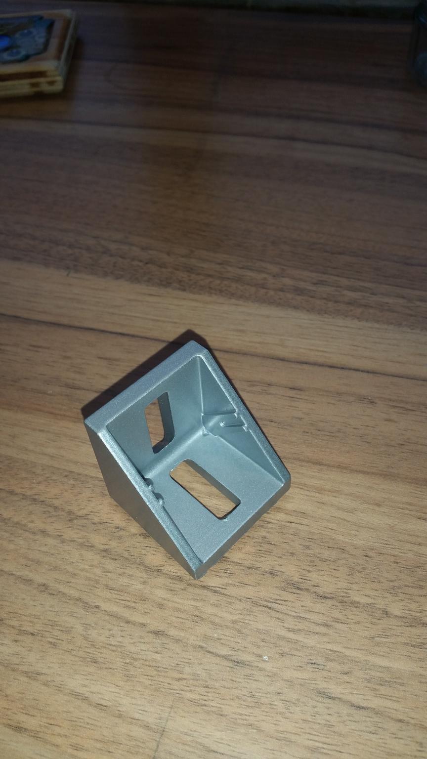

    #1 If I move rails to the front slot i will have bigger gap between gantry and Z axis back plate (at the moment it is 3mm) if I am using wide carriages. Maybe i could use the narrow ones the same like on Z axis?
    #2 How i could brace that connection? I have some of these so i could use them.
    They are 40x40 and 6mm thickness.
    OR this version?

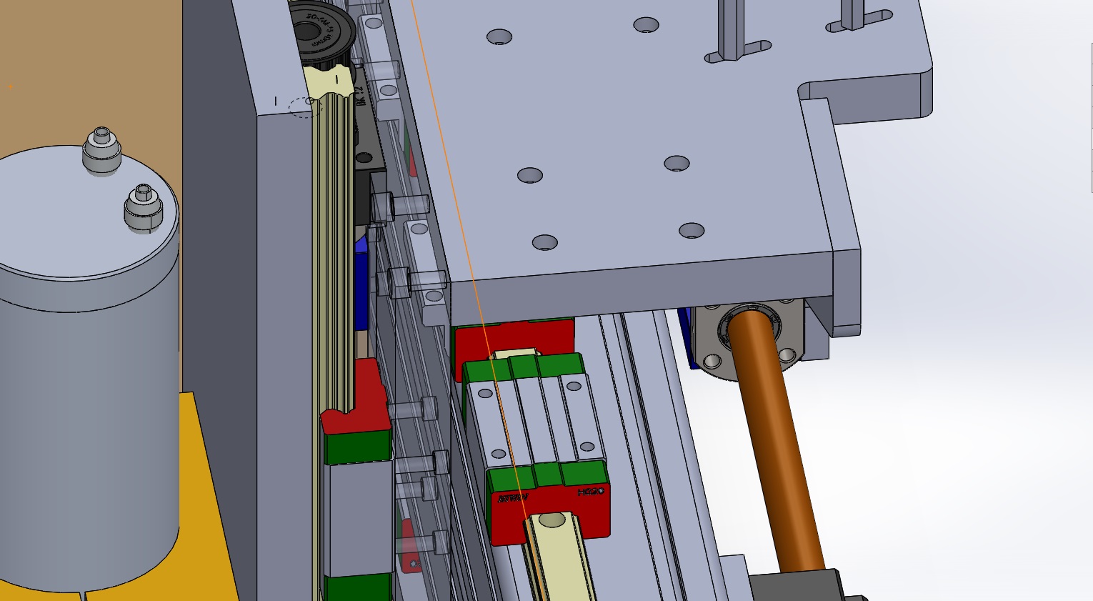

  8. #38
    Quote Originally Posted by valdis034 View Post
    I was going from your pics which looked like wide gap between z rear plate and gantry profile. Without seeing better view then can't comment further.
    No wouldn't use those and would go with something like your second option.
  9. #39
    Here it is. Between narrow carriage and gantry profile side is only 2mm gap, and the same dimension for wide one is 11.5mm. So the question is if I benefit a lot from wide carriages?

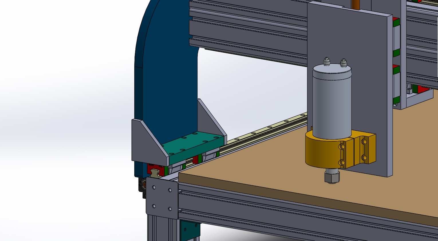

    Some small update from me :)
    During last days as i been advised moved Y axis rails to the front slot, then made a bit smaller plate on which going Z axis motor so saved some unnecesary weight. Now trying to find out the cable routes..
    For the cables and water pipes on the gantry I done a channel from 1mm sheet metal just to see how it looks. Not sure if it will be strong enough to hold the chain.. Any suggestions on that?
ID:	18979Click image for larger version.
    Started to look for the companies which does aluminuum extrusions, got some quotes. The best price for all the extrusions seen in my model was £340, which is bit more than i expected, but i guess thats the price for them. Does anyone knows a good supplier for them where i could get for the best price? Thanks guys.
