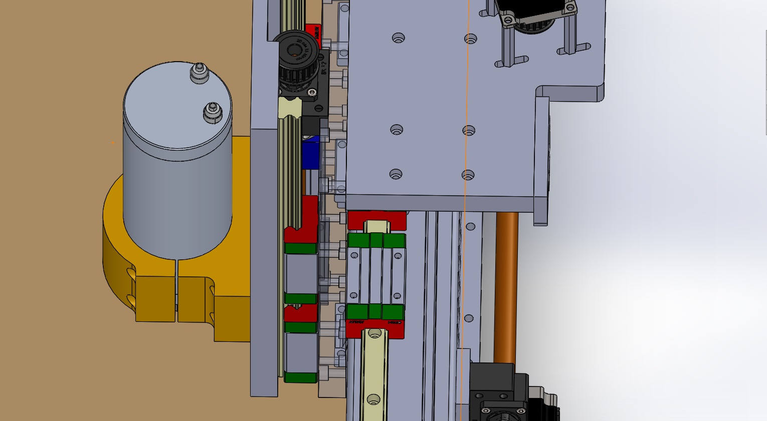

    Valdis in Reply to your PM then can't see any major issues with the design. Couple of small suggestions but other than these nothing seriously wrong.
    #1 I would brace the connection between bearing plate and gantry side.
    #2 Would bring the rails on the Gantry to front slot to lessen the lever affect.
    #1 If I move rails to the front slot i will have bigger gap between gantry and Z axis back plate (at the moment it is 3mm) if I am using wide carriages. Maybe i could use the narrow ones the same like on Z axis?
    #2 How i could brace that connection? I have some of these so i could use them.

  8. #38
    Quote Originally Posted by valdis034 View Post
    I was going from your pics which looked like wide gap between z rear plate and gantry profile. Without seeing better view then can't comment further.
    They are 40x40 and 6mm thickness.
    No wouldn't use those and would go with something like your second option.
  9. #39
    Here it is. Between narrow carriage and gantry profile side is only 2mm gap, and the same dimension for wide one is 11.5mm. So the question is if I benefit a lot from wide carriages?

    Some small update from me :)
    During last days as i been advised moved Y axis rails to the front slot, then made a bit smaller plate on which going Z axis motor so saved some unnecesary weight. Now trying to find out the cable routes..
    For the cables and water pipes on the gantry I done a channel from 1mm sheet metal just to see how it looks. Not sure if it will be strong enough to hold the chain.. Any suggestions on that?
