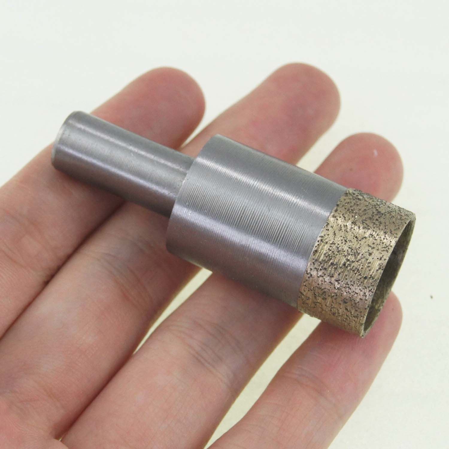

Has anyone come across a supplier of diamond impregnated brazing rods local to Europe ?
I can get them from the US but wondering if anyone knew of a more local reliable supplier?

Sounds like you may want to approach people that deal with the oil field or mining. (Cutting and Wear springs to mind) In all my time working with diamond, this is the first I am hearing of impregnated rods, would have thought the brazing temps would cause the diamond to graphatise... learn something every day.
Have you contacted Johnson Matthey? They supplied me with some very rare rods a few years ago.
http://www.matthey.com/about_us/prod.../metal-joining
I think they where designed for large concrete / stone cutting tools.
I have had some from here years ago , well I say I got them , actually a got one from someone who had bought them from the site.
But then I kicked myself because I remembered he had changed to a 2 part diamond epoxy which worked nearly as well at a lot lower cost.

Can't help but you got me intrigued. . . What you welding.?
For a try at making some of these :) I have a couple that where in a shed clearance (somewhere).. on eBay. And I PM'd the seller and he said his dad probably got them from the US site. But I have seen people use 2 part epoxy mixed with diamond powder for the size of spheres I'm attempting.

This appears to be data from reputable sources -
http://www.colorado.edu/physics/phys...62_Diamond.pdf
This suggests that diamond is OK to 800C - which might explain why diamond can be embedded in brass/bronze in a variety of applications and is commercially supplied in brazing rods.
- Nick
I have a friend who is a glassblower. He has a couple of lathes with diamond impregnated brass wheels and I often wondered how they were made. So the answer is casting, but with careful temperature control.

Theory is fine , but its like trying to fine hens teeth to get rough to polish grades , hence why I'm experimenting with epoxy . But for anything above a 5" sphere I doubt epoxy will be useful.
Never seen an article on truing the wheels but have seen people say if used correct they can last 10-15 years. At £150 a pop for a big one I'd want them to last a bit to lol :)
These guys produce the finished brazed cups in all sorts of grades and sizes
Big scale sphere making.. Highland Park grinding cups
