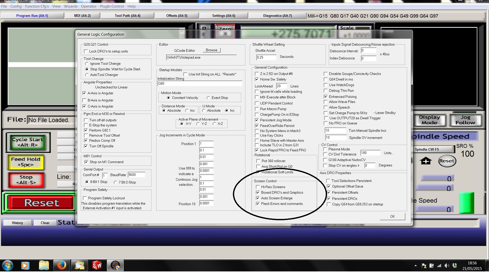

My mach 3 has decided to stop running on full screen.
it worked fine and now it doesn't, I know that sounds like a cop out, but I never touched any settings, that im aware of.
im hoping its something simple.
thanks, paul

Try changing the screen settings in General Config.
Attachment 15405

		Well firstly, i have no excuse for the waterfall :welcoming:
just tried those fixes but no dice, tbh they were already set from when you set it all up spot on dean.
when it dropped, i did piss about with the properties when you right click on the exe file shortcut on the desktop.
it works but all the text is falling all over itself and i think my eyes are sowing a little age wear and tare too.
cheers mate.

		It happened to me once....
just changing the screen resolution (Im talking about windows control panel, not mach) and then setting it back how it was did the trick.
hope this helps

 He's sorted out now it was just a simple thing.
If you minimise mach and then shut it down it remains minimised when re-opened. If you then expand the screen it stays minimised until you re-start Mach.
Paul just wasn't re-starting Mach.!
