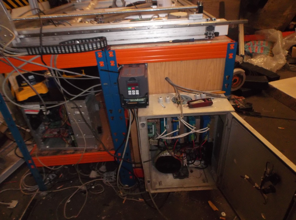

Got the spindle back on was nice to see it move with the spindle on and test the water cooling hoses for kinks, etc during movement.
I am going to put the limit switches sideways on like someone suggested maybe 3cm away from the original switches, ordered a couple of roller type ones and have 1 spare. The original ones going to leave in place as hard limits so when I do get a latched relay I can wire it to that with all my other emergency stuff.
Re: New build with recycled parts on a ridiculous budget 120cm*60cm work area
Water cooling works ;)

Quick question the 12/24v spindle input on my BOB which is + and which is -? I assume left would be - and right +

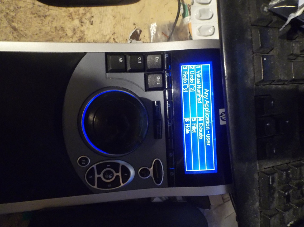

Got a 2nd hand 3d connexion space pilot from Ebay for a good price and condition is excellent it doesn't look or feel like the one I have has ever even been used lol.
http://www.ebay.co.uk/itm/IBM-3DConn...72.m2749.l2649
Was slightly fiddly to setup as it's not supported by the latest software from 3d connexion but download the legacy software from there site and works 100%, just remember to restart fusion 360 if you install it whilst fusion is open. Lol spent 20 mins before I realised a simple restart of fusion was all that was needed nothing to configure to get it working.
It's weird! But I like it I can see I'm going to get on with it very well but it's going to take a little while to get used to it I can already navigate fusion 360 300% better in 2 mins of using it without trying the trainer yet lol.
Need to work out how to configure the 1-6 buttons as well for most optimal workflow but undo and redo have to be on that list ;)
have you looked under the board on one of those that I have it is printed on the pcb. On mine +ve is third from the cap and -ve is forth. I am talking about the power supply input.
No I didn't before I bolted the BOB to the plate and the plate into the box lol, but I have an identical BOB luckily spare so will check that one ;)
I think its like this
https://image.ibb.co/kag1jb/mach3_br...otor_drive.jpg

Really liking the 3d mouse gives you so much more control over how you view your model.

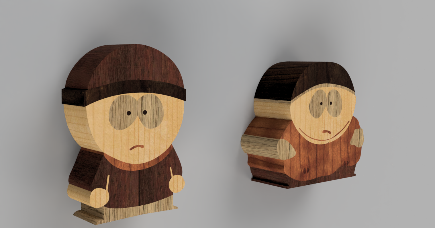

The southpark figures are 3d illustrations?? The wood grain looks wrong to be real cuts?
Davek0974
Renders from within Fusion 360. Shows how good they are, the need to check / question :-)
Davek0974
Chaz is right there Fusion 360 models I then "coloured" using different woods in physical material.
I was playing with different ways of making cad models from bitmaps
The South Park figures were a simple spline trace over a canvas, Obey from They Live (Cracking film) I used Inkscape trace bitmap function to vectorize the image then used the SVG to extrude from.
