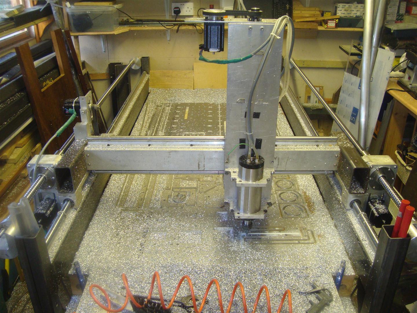

Looks good but pretty certain you wouldn't catch my fingers in the slot with the tool that close while in cycle!
Re: Comments sought on new build: A CNC Router for RC Gliders and Planes
CharlieRam
Yes not a practice I'd recommend....in my defence I've run the simulation 20+ times so knew it wasn't going to rapid on me anytime soon....however I'll agree, no excuse :hopelessness:
Good stuff Neil.
Was that a Fusion 360 part or i-machining?
One method I've used to avoid faffing about with zeroing off of a part like that is to cut a holding fixture in the bed and then use the same zero to then run a contour pass(es) to clean up the part.
Of course you know Jazz is going to turn up soon and goad you into cutting deeper and faster ;)

Cheers Chris, it was Trochoidal machining in Estlcam. I've not really messed with fusion 360...downloaded it and installed it but I use Geomagic at work so until I get more proficient at that I'll not confuse myself by using two 3D programs....
I'm going to give the bed another surface soon and at some point I'll put the 1" thick bakerlite sheet on and use that as my surface and tap holes into it for holding down workpieces but use sacrificial wood as necessary...
I'll not need much egging on by Dean...I started at the speed and feed that was recommended for the cutter...onwards and upwards!

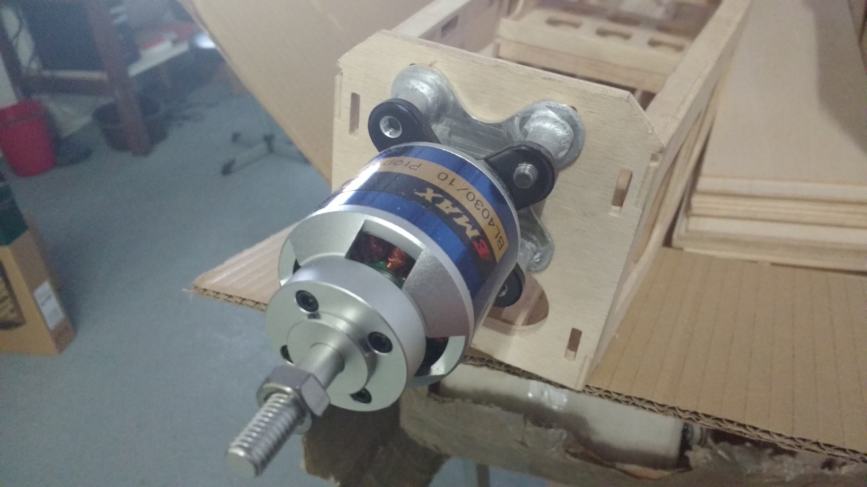

Just finished the Mk2 mount....could have been a Mk3 but this will do! Did put some engraving in the middle but got the depth wrong and it snapped the engraving bit :dejection: Still I forgot the hole in the middle for the shaft to go through (manually drilled) so that would have gone through the engraving anyway....Pressed the tubes into the plate on our hydraulic press and at 2.5 tonnes pressure I don't think I need to use the Durafix to weld them in...might do it anyway but I'll see. The bolts are pulling the tubes into the plate so they're not going anywhere, just the torque twisting them. Might get a big block of Ali and mill it out of 1 block though I'll probably not bother if this works...
Attachment 18396
Attachment 18397
Attachment 18398
Attachment 18399

No it's simply a spacer to hold the motor off the firewall so the propeller sticks out the nose the correct amount...

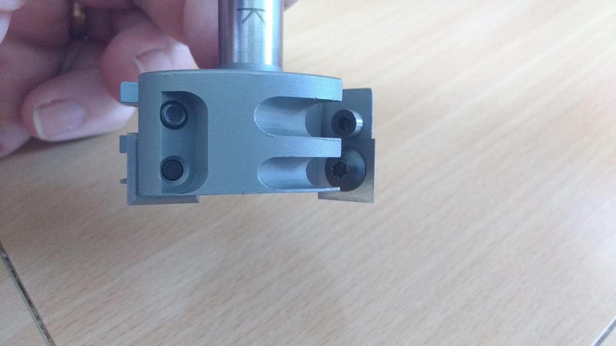

Hi Neil
That looks like a nice cutter - might grab one myself when ordering from Wealden next (I've been very impressed with their routing bits etc. to date).
I always thought trepanning was used to relieve headaches by cutting a hole in your skull - learn something new every day :)

Hi Neil
I can tell you one thing....there's no way that I'm using that bit to drill a hole in my head!!! However it does surface the bed beautifully :biggrin:
Looking good Neil I will be looking forward to see how it pans out in use.:yahoo:
Great stuff Neil - bet that felt like a big milestone reached.
Will be nice to see how it runs in its new configuration.
Chris
Washout
Chris
Cheers Chris, it's a relief and will spur me on to get it finished now.....till something else pops up.

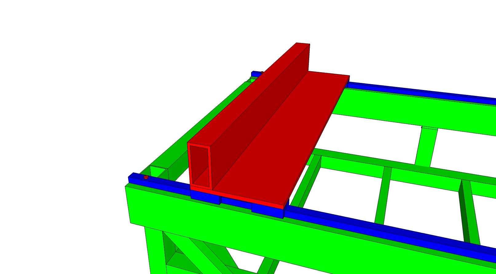

Neil Do you think you will need another bracket to bolt the frame to the wall at the top, shimmed as to not twist the frame:applouse: Hope you are only using he hammer to tap the connections into place
Clive S
There are 2 additional bolts half way up bolting the frame to the wall...shimmed with custom cut bits of pipe 😁 the base is shimmed and bolted at all 4 corners so I'm hoping it's still all square....will tell when I first go to cut later today...
