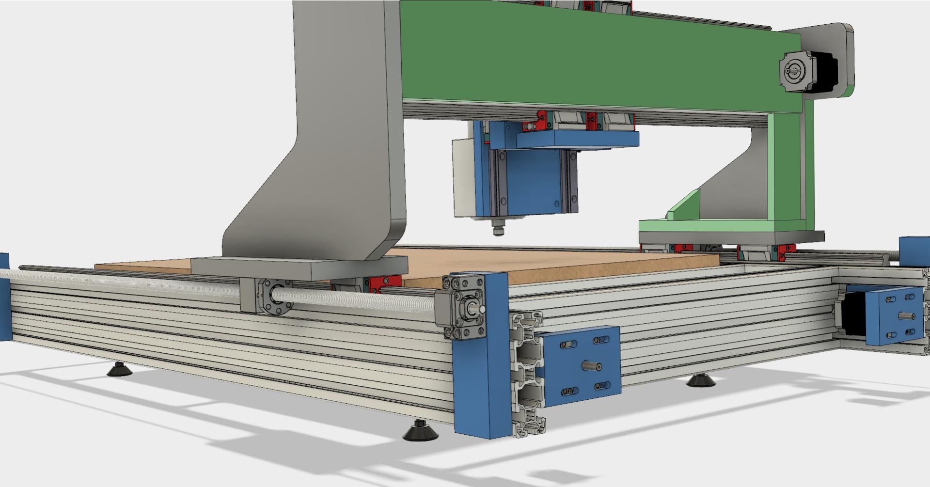

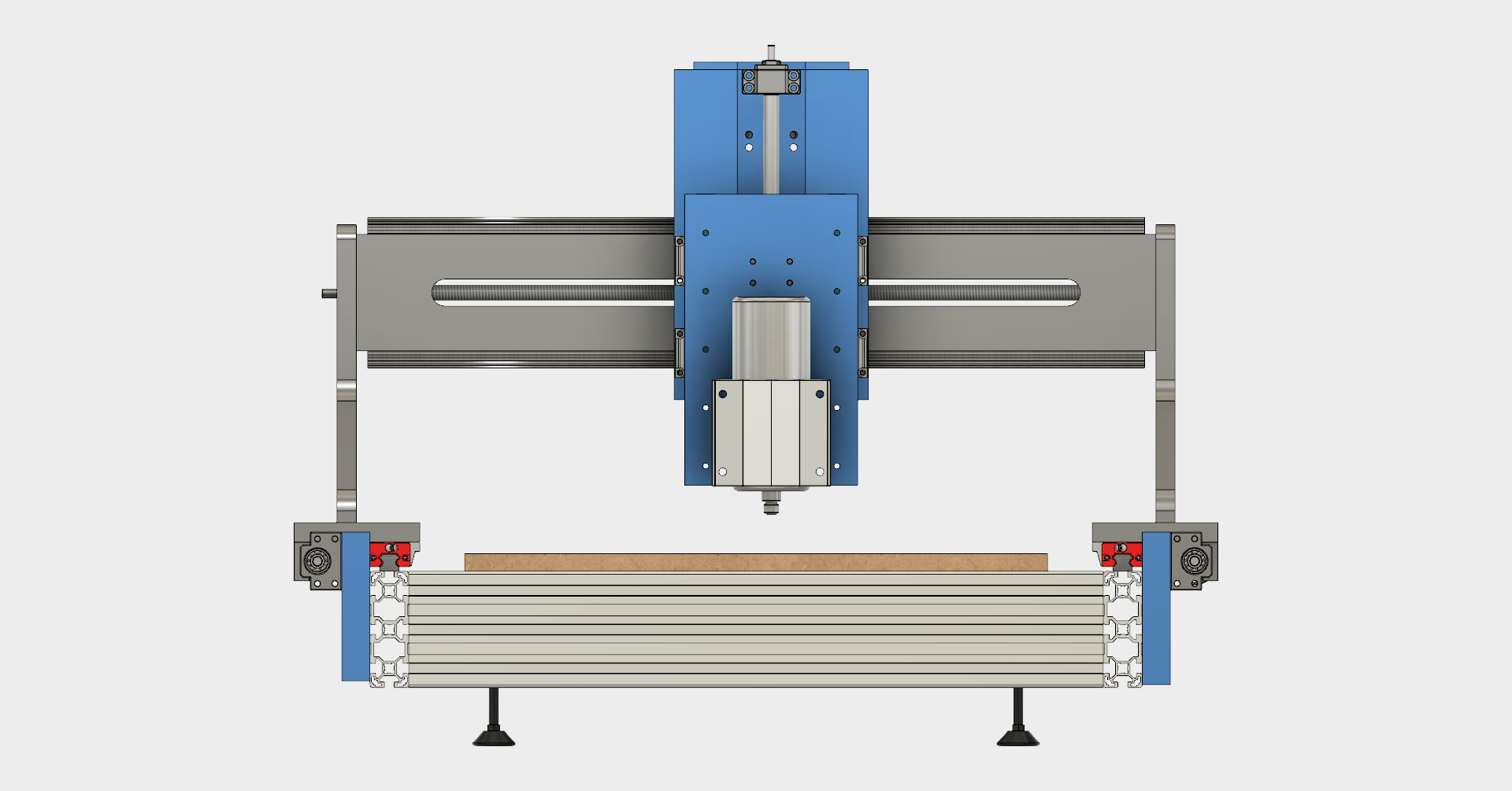

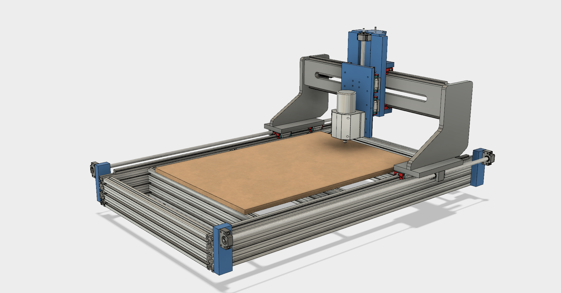

3 Attachment(s)
Re: Eyeballs and comments sought for noob build
So, having taken your sagacious advice on board, the gantry walls now sit on a block that is shared between the ballnut and the blocks. The ballscrews are essentially level with the bed. So, gentleman, in your considered opinion am I at the point where it's worth putting all the detail in now?
Attachment 21018
Attachment 21019
Attachment 21020
danilius
Attachment 21018
Attachment 21019
Attachment 21020
Yes, looking good now.

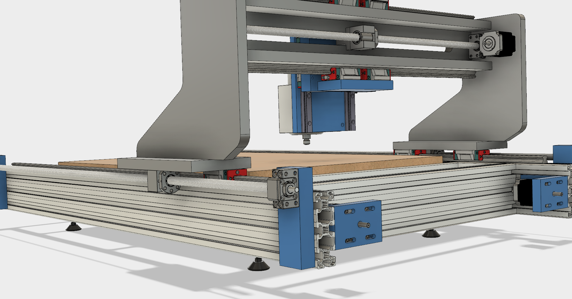

If you want a stronger machine...
Attachment 21064
Regarding the length of the X axes screws and the overall length of the machine I do not see why you need the frame longer than the linear rails. If you lower the ballnut mount with a spacer and move it to the back (closer to the motor) you can shorten the screw at front by at least 10 cm, having the end blocks going under the gantry base plate.

Attachment 21064
Oooohh, nice one. Definitely need to give that a go. Thanks for that.
