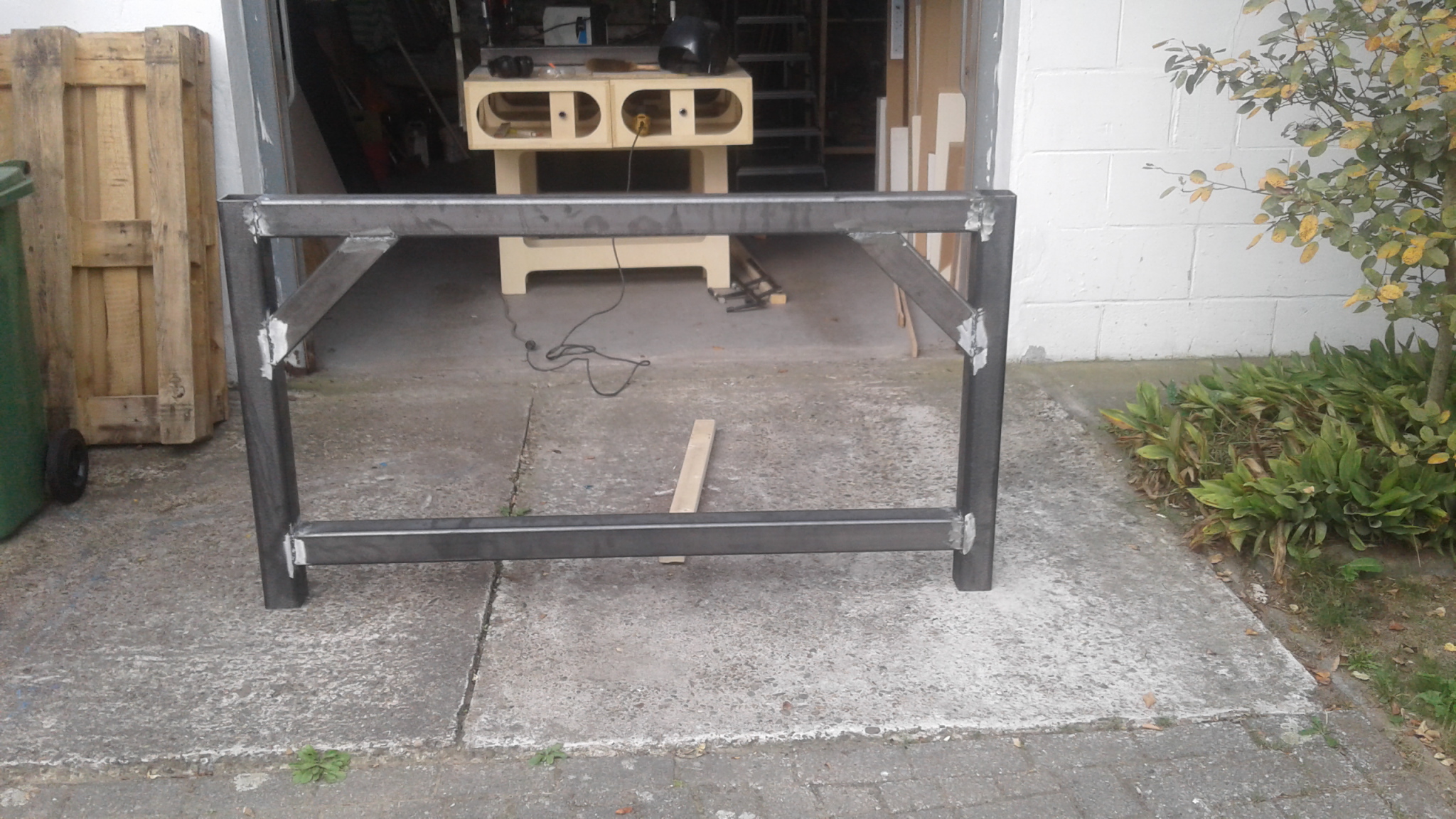

i was thinking making the frame like this
Attachment 22030
Attachment 22031
I would add some triangulation trusses to the box frames - stop it twisting etc.
If you were really good at carpentry there is no reason the base could not be made from timber, it would mean very tight joints and good design but the forces to resist for machining wood are not massive so i see no reason it could not be done. Cheaper in wood? I doubt it? Easier to build - not for me as i dislike wood and like metal but for a carpenter???
Anyways, that frame needs triangulation or it will wobble each time the spindle changes direction rapidly.

and triangulation trusses in both way's?
Definitely - the frame has to resist the thrust created by the spindle changing direction in all directions so a good sturdy base is essential. Downwards it needs to resist the weight of the material plus the force of the drill or tool etc, no sagging or spring so again, a good firm base is needed.
Without triangulation if you use min 80x80x3. Otherwise as others said.

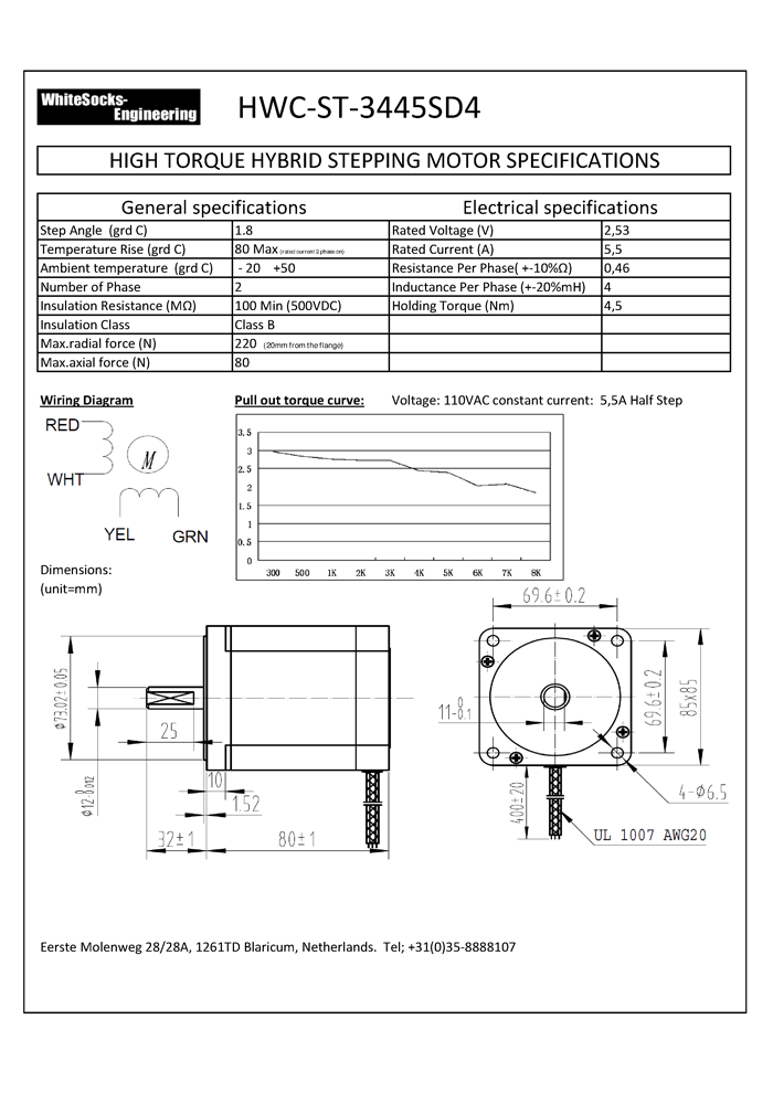

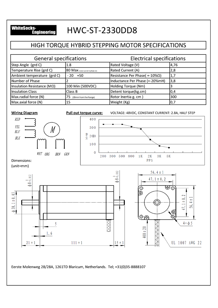

You could move 60-70 gantry with 2x 3nm nema 23 motor driven at 70VDC, as most people on forum do.
The motor you show is nema 34, will have more inertia. Ok, looking at the inductance of it its not too bad, i could say its even good. But you will need to drive it at least 110VDC as per its chart, or even better use 230V main power drives, which are much more expensive than AM822.

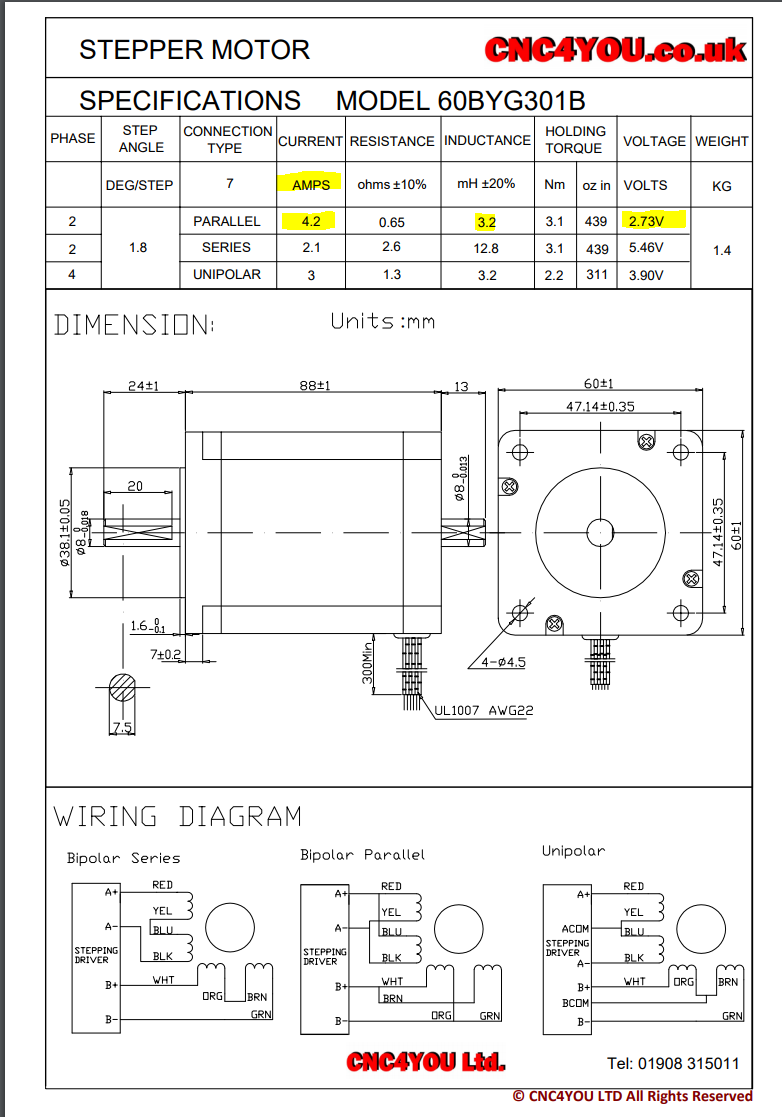

is there a set of nema 23 that u reccomend or do's it not really matter only that they need to be 3nm?
What about this set?
http://www.benl.ebay.be/itm/DE-Free-...cAAOSwiQ9ZR3aF
this is the short motor. You need the longer Nema 23 . Could buy it from Uk, Price is good and they have full kit with drives, https://www.cnc4you.co.uk/Stepper-Mo...YGH301B-Nema23
could this one work ? Attachment 22164
it could but is not the ideal. I pointed you the previous message to the ideal. Building the CNc you can make like 500 mistakes. When you are not sure which, what why, just follow the recommendations :-) or look more carefully into the data. And when you dont know what it means, follow the ...

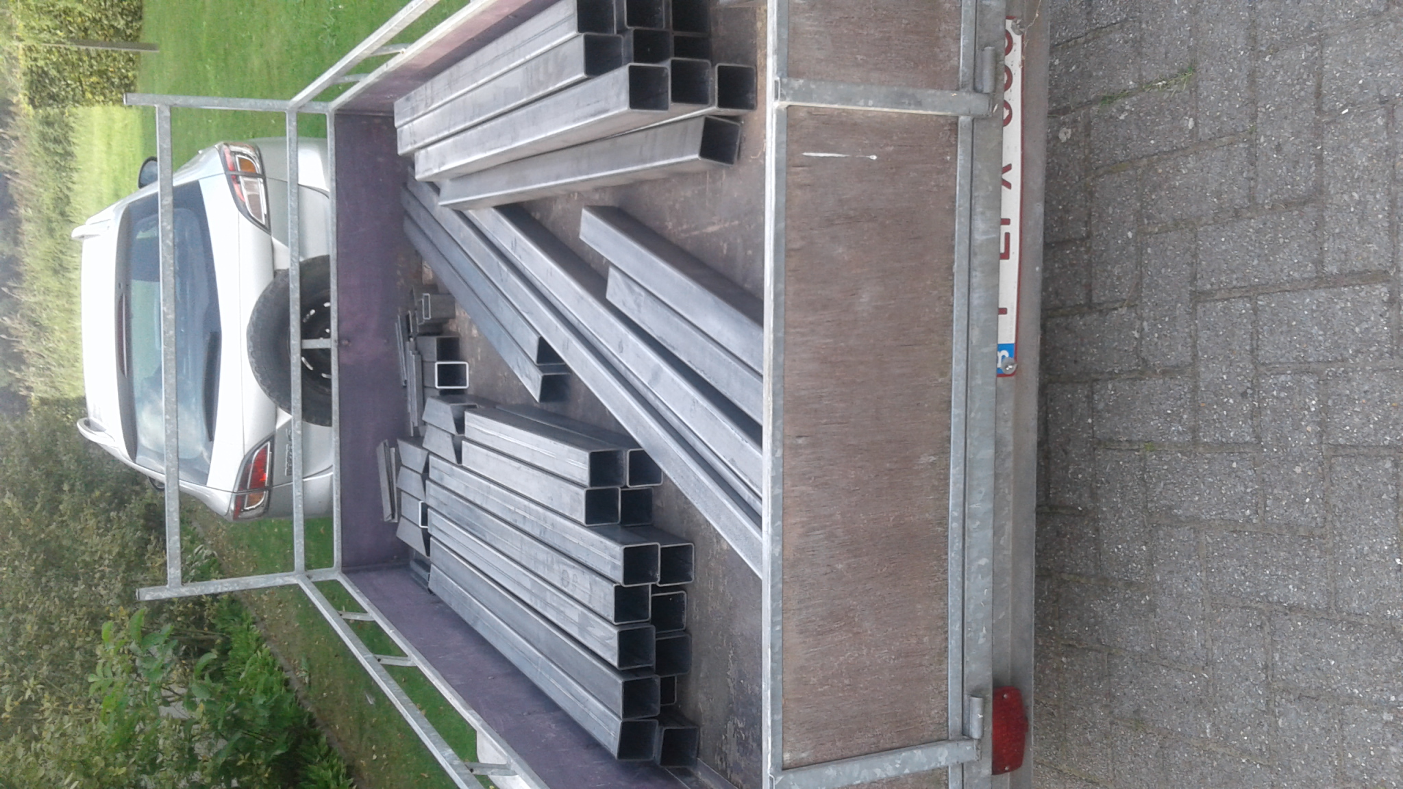

Got the steel since friday i was a lot and very heavy.
this weekeind i started to weld everything together with a small inverter and it works very well.
