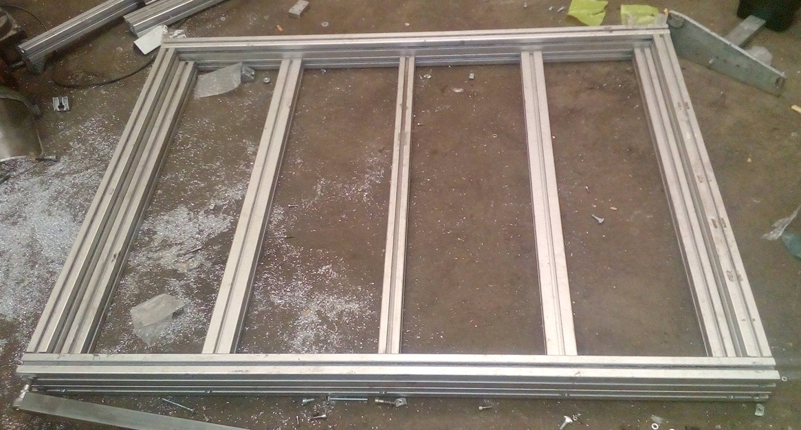

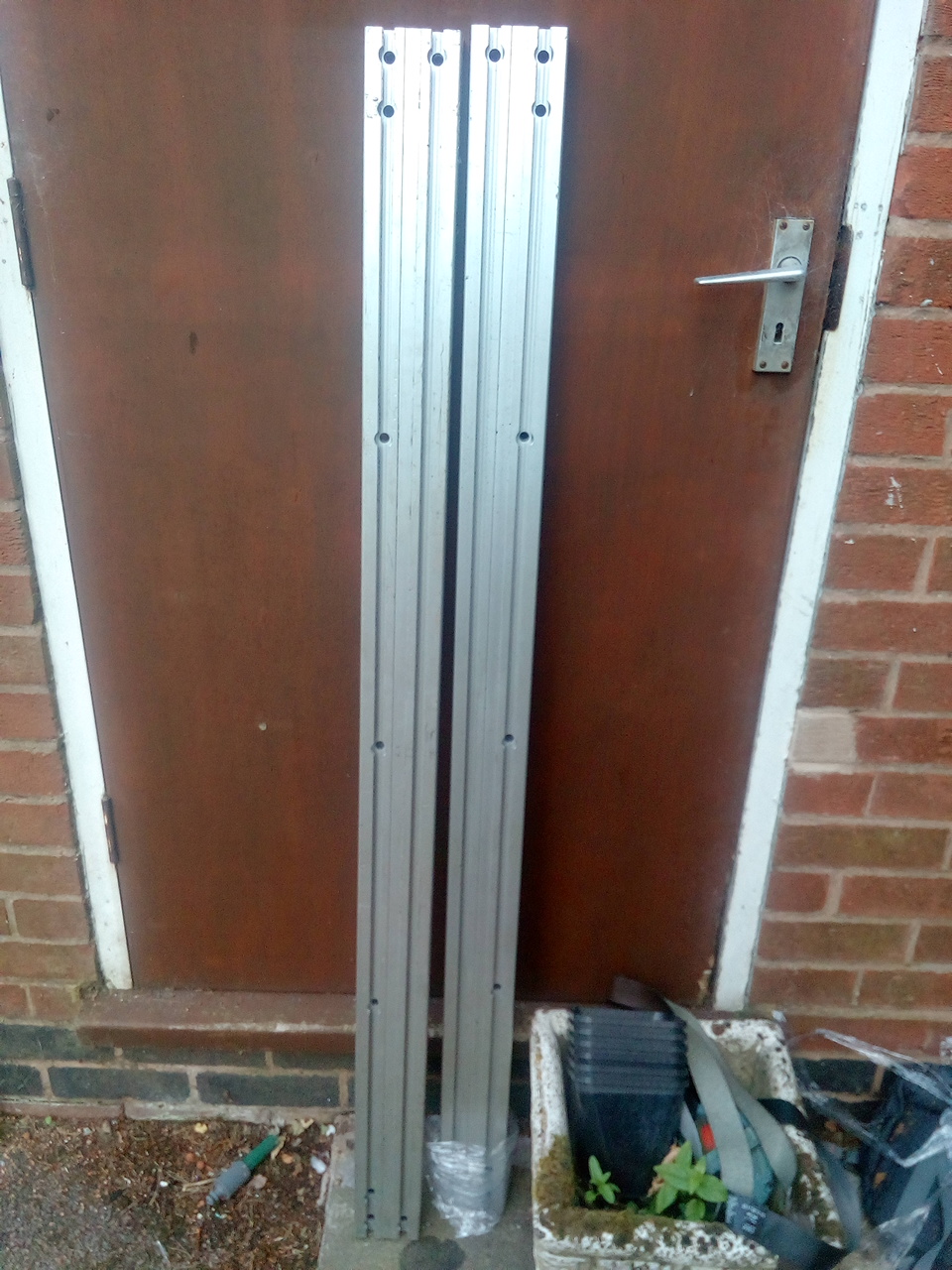

2 Attachment(s)
Re: Building My First CNC Router, Looking for Advice & Other Info
AlexDoran
Hi @Desertboy,
I remember you saying previously that you had ordered extrusion from KJN, out of interest did you need to tap the holes in the ends of the extrusion? I thought those holes were sized for an M10 thread to be tapped but they are too big, not sure if there is enough material there to get a M12 thread tapped. M11 seem expensive and the site where i have ordered my fixings from don't supply M11.
Alex
Hi I was convinced they were M10's (You maybe got that from me) so holes I had drilled were too small in the end I widened them myself. I never tapped the ends I used M12 bolts and drove them in using an impact driver and stainless steel A2 socket caps was still hard work with the impact driver lol but only took 15 minutes just heavy on the hands.
I used the T nut 90° corners to assemble at right angles the frame before I drove the bolts in then undid the corners and moved on to the next piece to try and keep everything as straight as possible. This was especially important on the bed frame which wants to twist when you drive the bolts in.
I recessed the gantry into the aluminium which removed any twist when I drove those bolts, when I tightened the gantry mounts to the Hiwin carriages the gantry sat it fine without any bolts perfect fit this really made it a lot easier. In fact if you don't recess I doubt you could do it the way I did. I have a 5mm recess either side in 20mm tooling plate.
I think it turned out ok
Attachment 22710
Attachment 22711
It could be done with a bar and a lever (I did a few like this) but it's very hard work. You could also drill the internal out with an the correct sized drill bit (Guessing 10.5mm or 11mm) then it'll be easier to tap.
In retrospect I should have had KJN tap it.

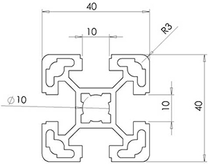

4 Attachment(s)
Hi Desertboy, your machine looks good, nice progress! I can now see why you did not tap the ends of the extrusion - what a f*cking nightmare! Fortunately KJN sent me two lengths of the incorrect extrusion that i quickly had a practice on, so the middle of the Extrusion is indeed a hole that is the correct size to tap an M12 thread in, HOWEVER as the diagram below, because the circle is within a square it makes it impossible to tap, once the thread has been cut into the circle material, it slips out and into the the 4 empty corners.
Attachment 22720
I think i will do the same as you and drive the bolt in to get the thread... I'm worried now that there isn't enough meat there to provide a strong connection.

My profiles look different on the internal core.
Attachment 22721
Both my 4545 and 9045 have the same internal core
http://www.aluminium-profile.co.uk/a...20.html#SID=29
http://www.aluminium-profile.co.uk/a...KJN990300.html
e2a, Ah I see you have 4040 extrusion

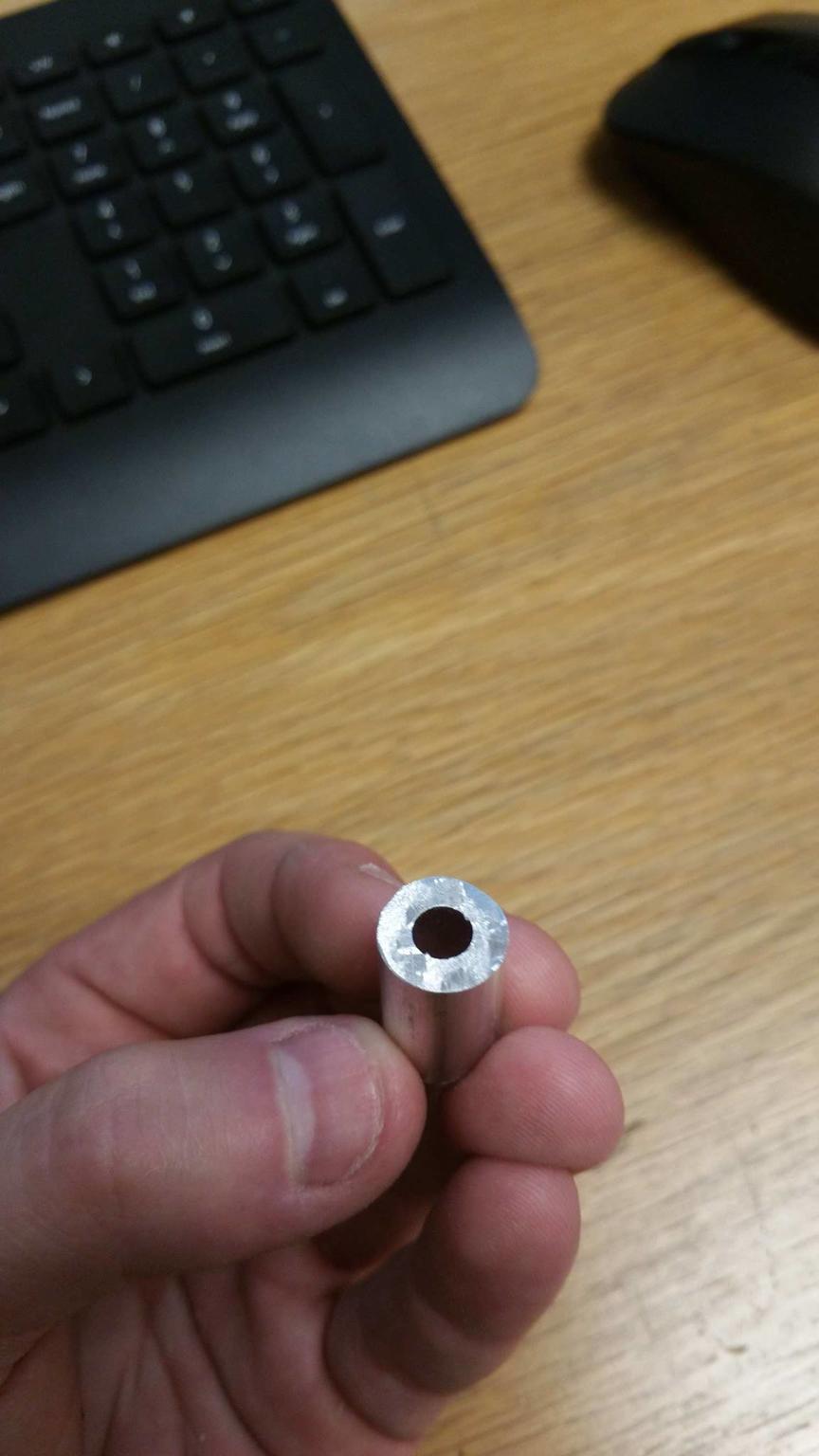

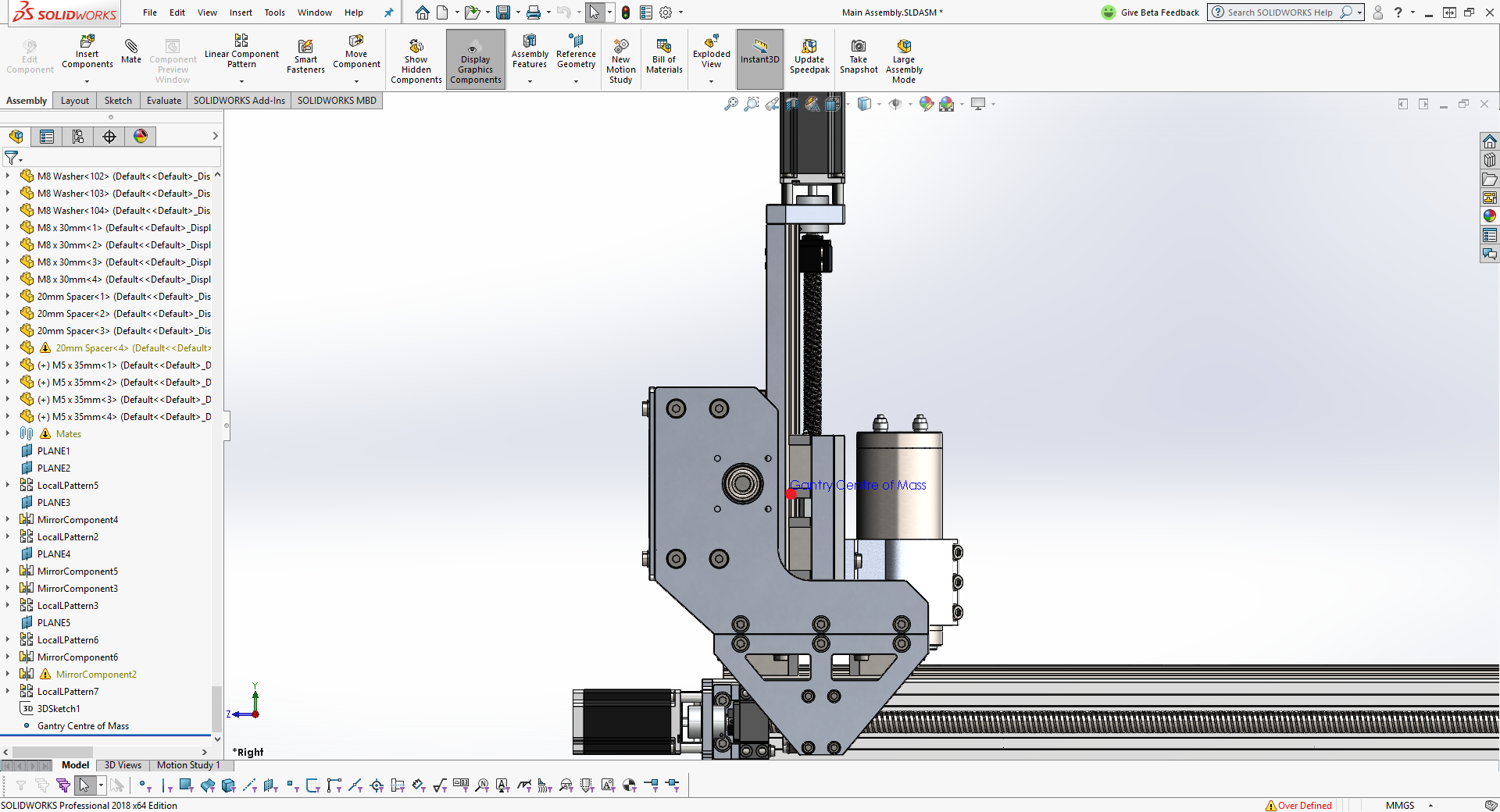

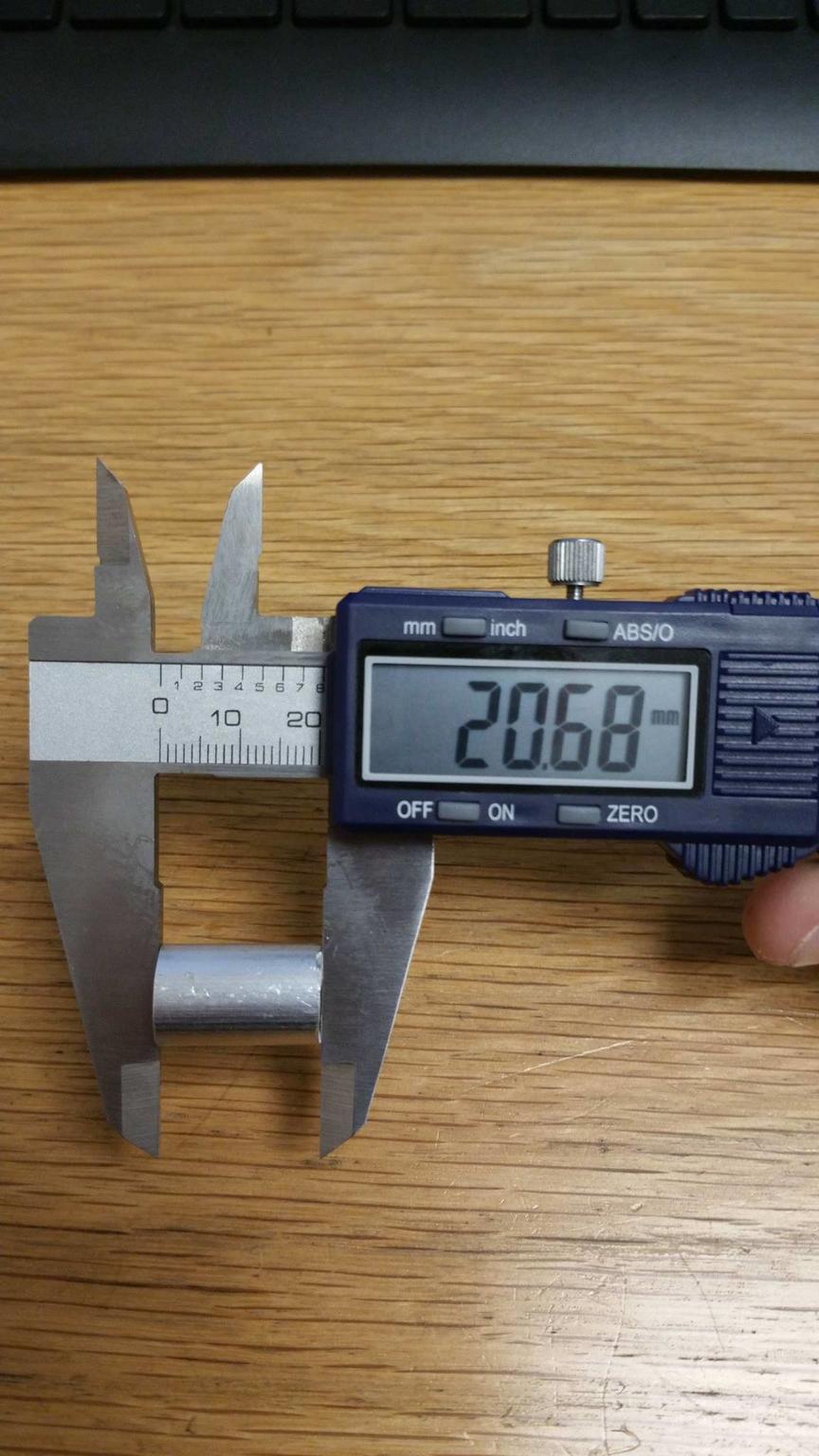

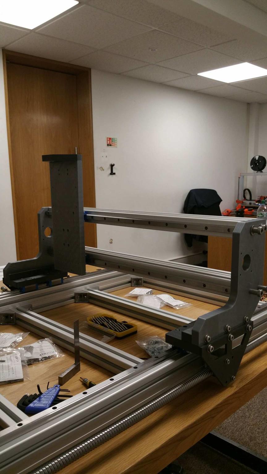

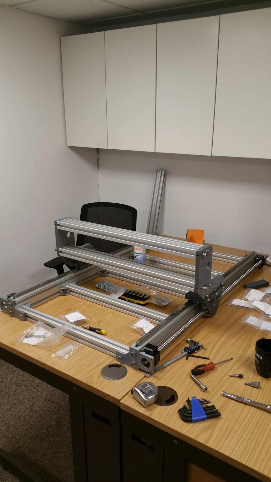

7 Attachment(s)

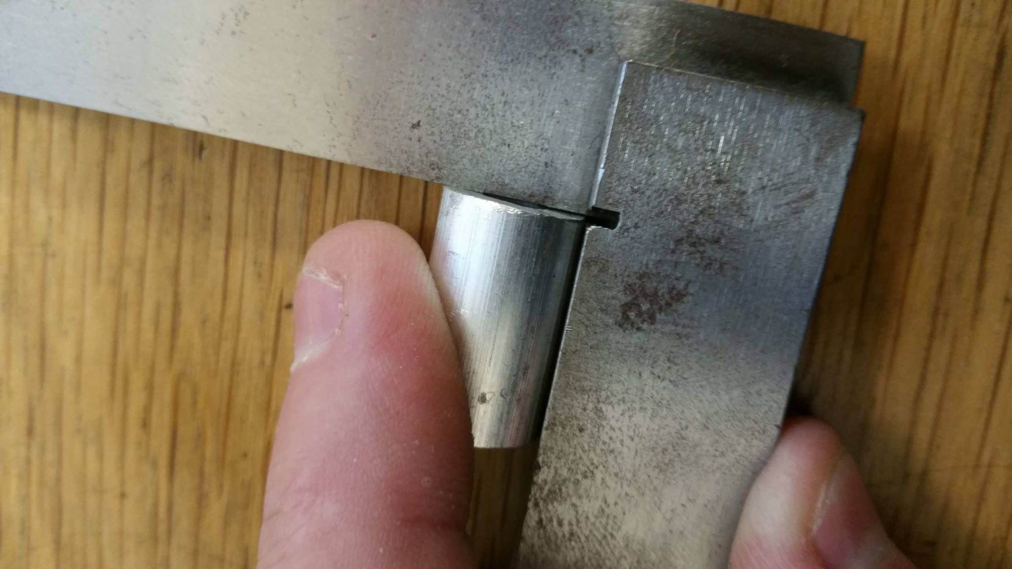

Ok so bit of an update, i spoke to KJN and he gave me some tips on how to do it by hand and said that is best to use a Fluted Spiral Tap, managed to do the threads EASY and used the cordless drill to do it in no time at all, just goes to show with the right technique things are made easy!
However i am really pissed off with the M12 bolts i go from ACCU Group, they are A2 Stainless (55mm Long & 75mm Long), but they only thread 30mm of the bolt, this wouldn't be a problem if the un-threaded part of the bolt was smaller than the threaded part, i honestly don't see how you are supposed to use that bolt in any kind of normal application, i didn't order a bloody shoulder bolt, but that is pretty much what they supply, if you attempted to screw the bolts in, it simply squashed the thread in the extrusions. So i have had to thread the rest of the bolts myself - never again, they are just too tough!

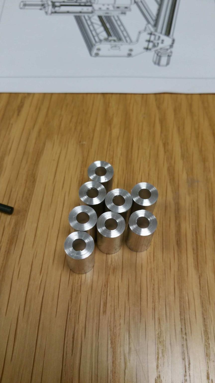

On top of this, i ordered some M5 x 20mm "Precision Spacers" from ebay, well i will let the pictures explain:
Attachment 22757
Attachment 22758
Attachment 22759
I dont have a lathe so what i decided to do was clamp each one in a pillar drill and drive it into sandpaper until the faces were square / true and they were the correct size.
Attachment 22763

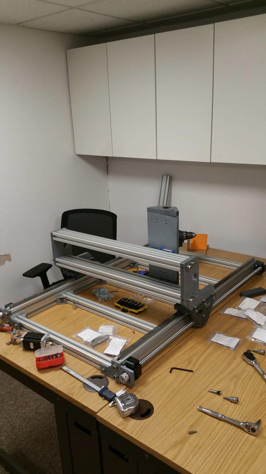

I began to mock up the router using the 3D Printed parts today, found a few things that need sorting already so im glad i went this route of the dry build first.
Attachment 22760
Attachment 22761
Attachment 22762
One of the problems that really made rage was that i need longer spacers (yes the ones i painfully re-worked are no good LOL), the couplers are 5mm longer than the suppliers drawing of them, so i will need to source some longer ones and also longer M5 bolts to match.
Still waiting to hear back from a lot of useless engineering companies regarding prices and lead time for the aluminium plates, i noticed whilst scanning through a build the other day that a guy on here had supplied the aluminium plates for the build and they looked great - however i now cannot find the thread, can anyone point me in the right direction of someone on here who would be able to manufacture them?
Alex
I ordered these, they were threaded to the end I ordered 50mm length (says 45mm is threaded but the whole 50mm was threaded)
http://www.ebay.co.uk/itm/M12-12mm%C...72.m2749.l2649
My gantry mounting plate thickness is 20mm but I recess into the aluminium 5mm so the bolts go 35mm into the extrusion it seems rock solid far far more so than when I assembled it with corners. I have enough corners to do it all without bolts and drilling but it just seemed to make sense to me that a big M12 35mm into the end is going to be stronger than a T nut and £35 drilling cost seemed ok given the hassle it would have been for me to line them up correctly. Having at least 1 (2 is better) corners with T nuts is very useful when you want to assemble it.
She's looking real good there! What are you going to use as a bed? I'm going to use MDF for now but limits my ability to use oil misting if I cut aluminium. It's a cheap solution of course but I mostly want to process woods, mdf & ply down the line once I've bought some decent compression bits from USA. I see where you corner mounts are (Where the nema's mount on the Y axis) you left a little overlap which means whatever material you use for a bed if you cut it to the correct size will fit snugly in on gravity alone. I'm going to make mine a vac bed so I'm not going to bother to bolt my bed in T nuts in the extrusion but you could do for extra strength.
Are you going to mount her on the table in the picture?
Desertboy
Hi Desertboy, recessing the gantry extrusions into the side plates sounds like a solid idea, maybe i could incorporate it without changing too much as i have already ordered most parts (except the ally plates).
In terms of the bed, i was expecting to use two types (or maybe even 3), like you say - using MDF as a spoilboard for wood cutouts will likely be one of the methods. I had planned to use a similar method for cutting with misting / coolant, our vacuum pods on our bigger machines here use a Phenlolic Plywood and Bakelight / Tufnol ( Link ), its an expensive material and awful to work with but is very resilient and will be immune to blowing out like normal MDF / Plywood when exposed to moisture. I was planning to use 18mm thick, and machine for those hammer-in threaded nuts to give flexibility in terms of mounting clamps / vices etc.
My 3rd method might be to make a basic vacuum table for machining the 1mm thick interdens / intumescent, however i think a few strips of double sided tape will more than suffice.
Yes you are correct i left those angles to help align any bed i fit easily, i will probably fix it to horizontal extrusions but nothing overkill just 2 or 3 bolts per length.

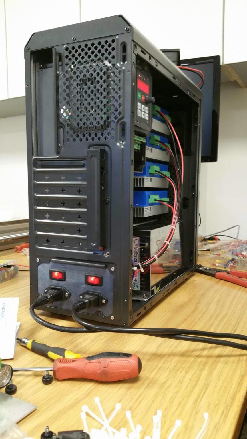

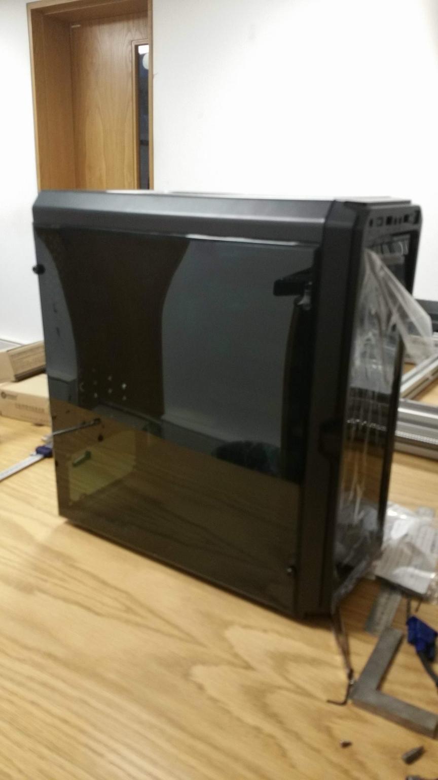

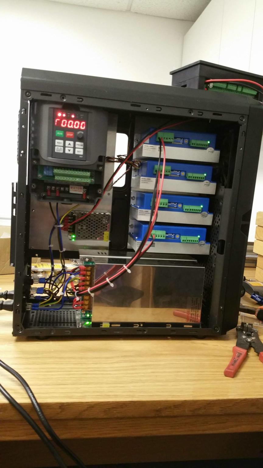

2 Attachment(s)

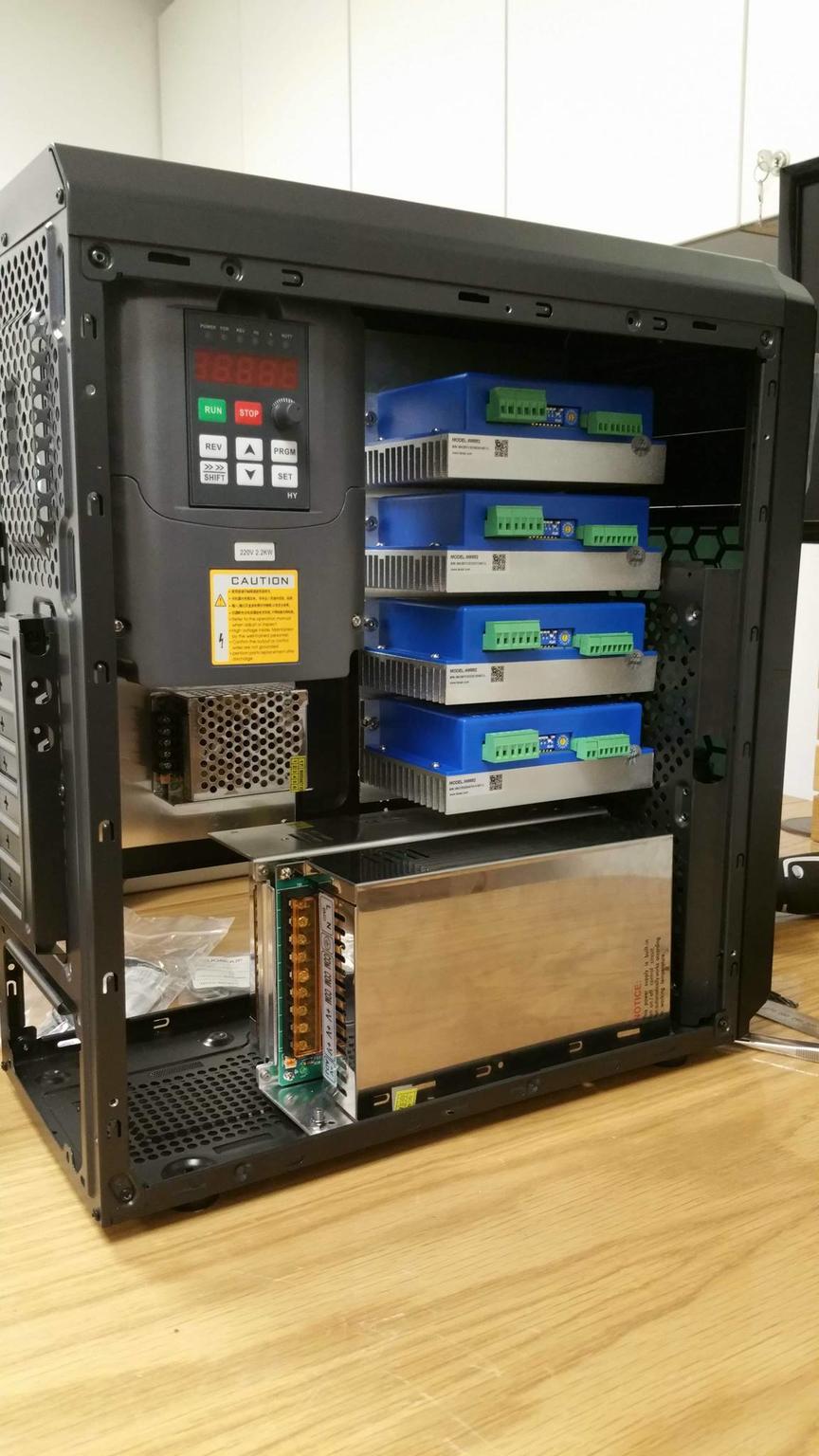

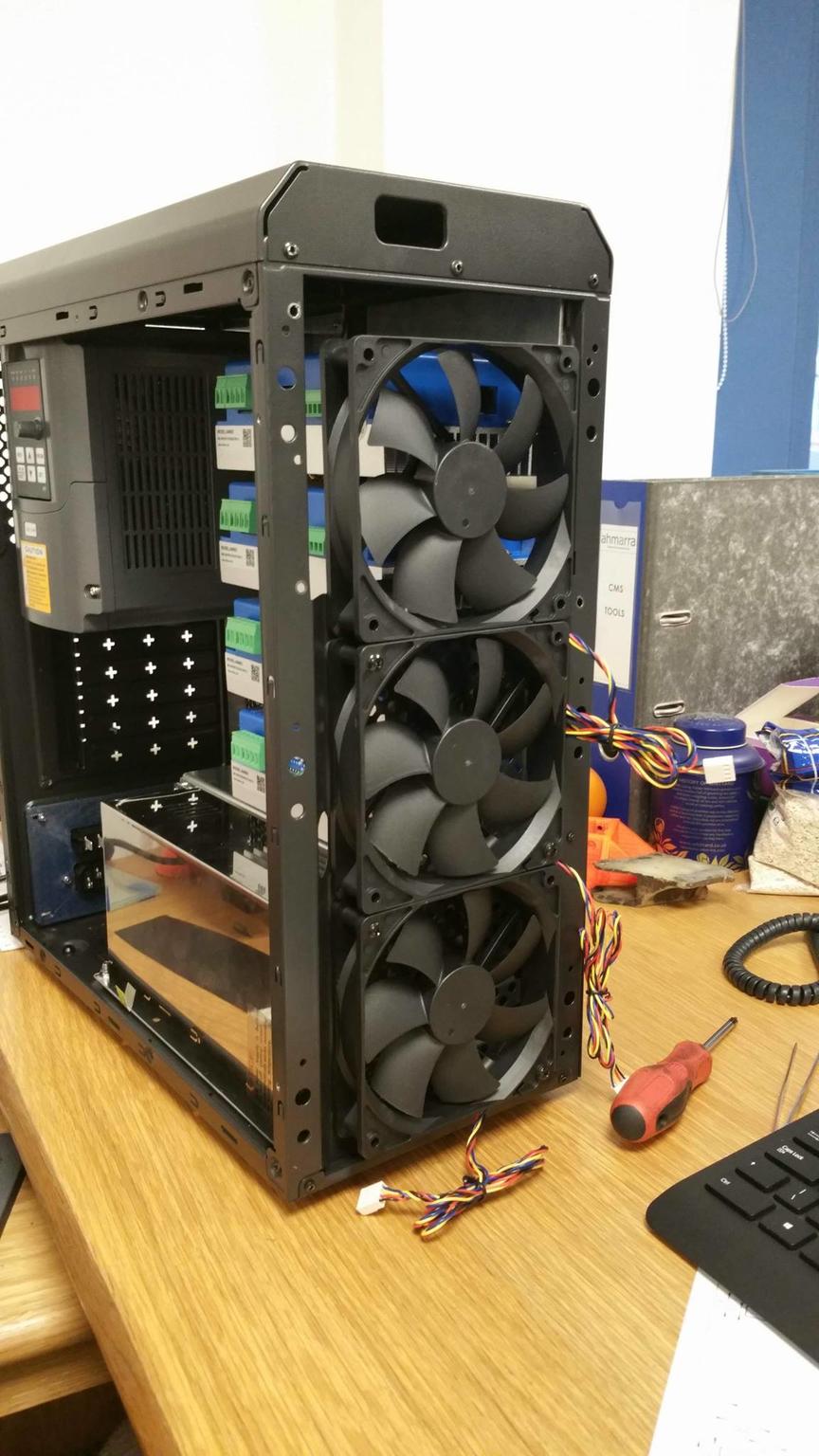

Made some progress on the electronics enclosure over the weekend, few people have already mentioned about cooling and moving the VFD out, i got some methods to try and reduce EFI and there will be ~4 fans in the case for cooling.
Attachment 22810
Attachment 22811

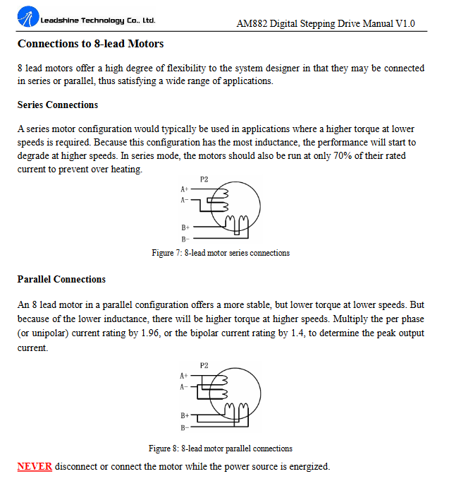

Starting to think about my wiring in general, how would it be best to run my Nema23's in Bipolar Parallel or Series? Considering i have 68v PSU's? Also, can anyone point me in the right direction of the name of the 8 pin twist a lock connectors i see commonly used?
Alex

Nice! Very neat there, I'm going to use a mini tower case for my PSU, steppers drivers & breakout board.
I'm mounting the VFD directly onto the T slot aluminium frame.
Bipolar Parallel is the way.

Motors has 8 or 4 cables, I miss that.
The motors have 8 cables, is there a way to wire in parallel whilst only trailing 4 core wire back to the driver??

Yes, that's how it's usually done. Bring the 8 wires into some kind of junction box with a four-core cable coming out and going to the control box. You can hard-wire the four-core into the control box or use an appropriate plug and socket. I use XLR latching connectors but there are others. My "junction boxes" are 3D-printed (cheaper than small plastic boxes from Maplin) with choc block inside but as long as the cables are securely joined and protected, use what suits you.
They're a little bit bigger than the usual choc-block style connector strip, but I've used a few of these which seem to work well. They also have the advantage that because they're spring-loaded, they are much less sensitive to vibration than screw terminals. Also, each wire goes into its own little socket so no need to twist wires together as you do with choc block - always end up chasing odd strands, trying to balance the lengths of wires, etc, when I use them. Don't know if anyone sells them in smaller quantities.
Thanks for the replies guys, think i've got my head wrapped around it now, would it be bad practise to splice & solder the wires then heatshrink it all up afterwards?
Alex
AlexDoran
Alex
That's the way I always do it. Use screened 4 core and ground the screen to the star point in the control box.
Neale

4 Attachment(s)
Clive S
Thanks Clive, this is what i will also be doing then.
Done some more on the electronics whilst i wait for some bolts to come, also need to machine some mock up parts tomorrow to finish the dry assembling, then hopefully should get some movement early next week. Was confused as hell earlier trying to figure out wiring the VFD using single phase, actually it was simplest thing ever!
Need to decide if i want to mount the controller on top of the PC Case using some kind of Arm / Swivel attachment, then fix the PC Case to the Bench the machine will be sat on, or have the Controller as a portable unit. Not sure the machine is big enough to warrant a portable one.
Attachment 22832
Attachment 22833
Attachment 22834
Attachment 22835
Alex
Alex I would be putting some insulation over the mains terminals in the box before it bites you.:hororr:
Yeah i got a load of Heatshrinking to do, just wanted to make sure everything was functional before i made it pretty & safe :D
Alex
