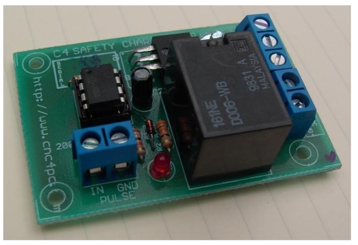

something like cnc4pc's C4 charge pump I made reference to in post 12

#3 This is known as a latching Circuit and is easily done using a relay.
The Charge pump Output is not designed for this purpose, it's designed to monitor the connection between PC and controller so if the software crashes or PC dies the AXBB-E sees this and disables the Output. This, in turn, would drop the relay which should be incorporated into the E-stop circuit and before the MASTER relay.
I use a safety relay because I got them for $10 for NOS on Ebay. If I had to pay the $200 they actually cost, I'd use Jazz's method.
Thanks!! This is fairly similar to my original plan (minus the relay). I just got hung up on the wireless mpg part and the two types of estop (hard and soft). From what I understand the charge pump can be set to stop when UCCNC is on 'Reset' mode. In Jazz's case this would then be passed on to the safety relay which would in turn cut the contactor. In that case an estop from a wireless mpg could act like a hard wired estop - albiet passing through a layer of software first. Getting the contactor back on would then require both clearing 'Reset' mode in UCCNC and using the physical button to latch the coil of the contactor. I guess my question would be is it possible to have that same behavior from a wireless estop as it is from a hard wired one?
Don't think it works as you think, there is no setting in the software other than to keep the charge pump loaded at all times.
This is from the manual
"If the 'charge pump always on" checkbox is not set then the PWM signal is only active if the software is not in reset and inactive if in reset.
The charge pump signal can be used to enable an external electronics only if the UCCNC software is loaded or if it is not in reset making the operation of the electronics safe."
"If the 'charge pump always on" checkbox is not set then the PWM signal is only active if the software is not in reset and inactive if in reset."
That's what I was getting at. In this case if UCCNC goes into reset then the charge pump signal stops right? So that can be used as a way to tell if an e-stop on a wireless mpg has been hit. Thanks again for your help!
Kind of but that then defeats the point of a Charge pump, you want the charge pump working all the time.
Also, not sure it will work, you could end up stuck in a loop, Master relay won't reset because don't see the charge pump signal and you can't activate the Charge pump without resetting the software which won't come out of reset without the master saying it's safe to do so.??? Give it a try.!
