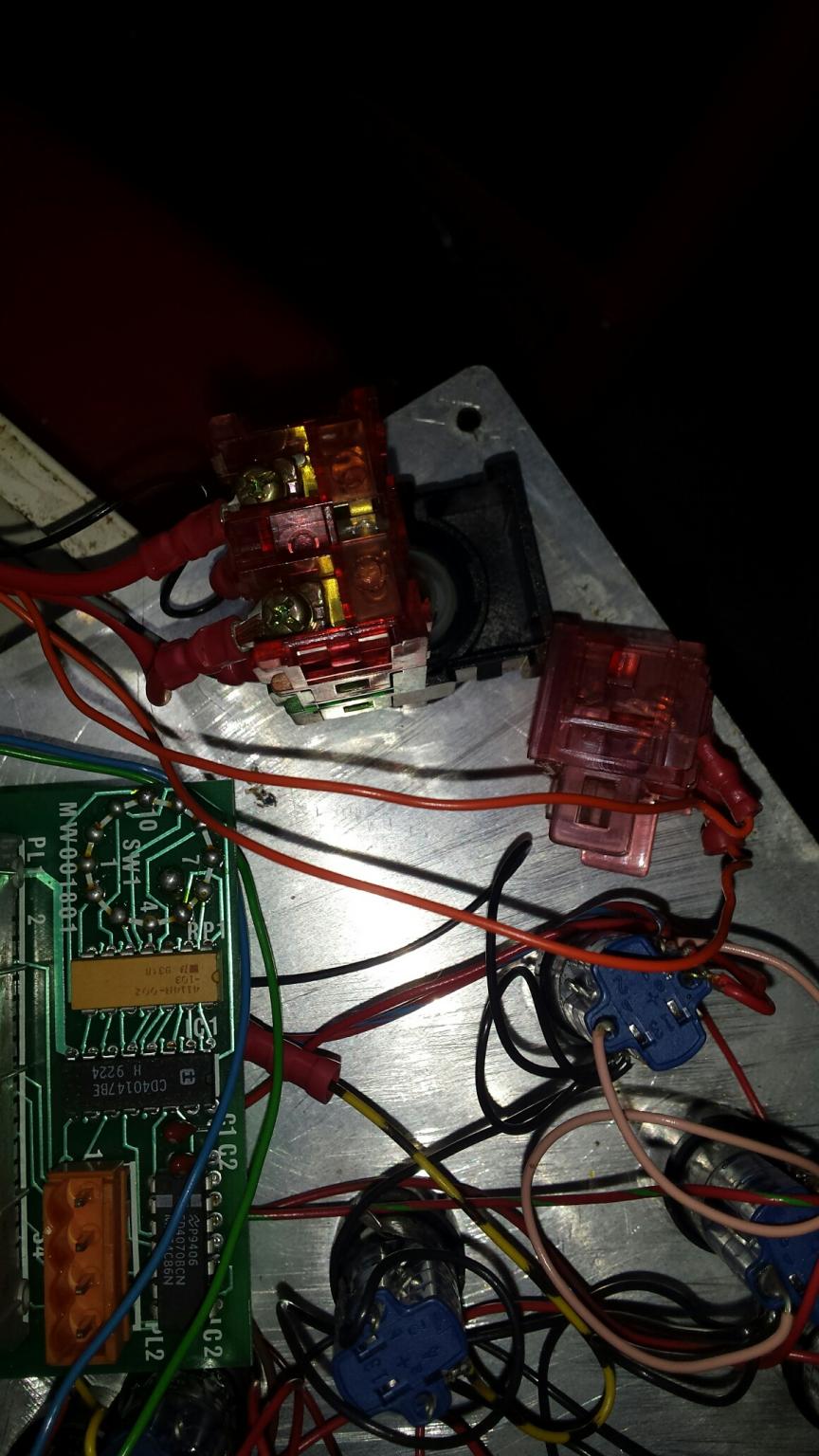

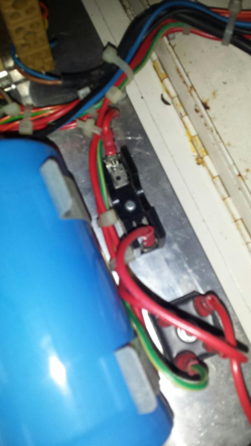

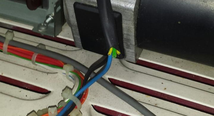

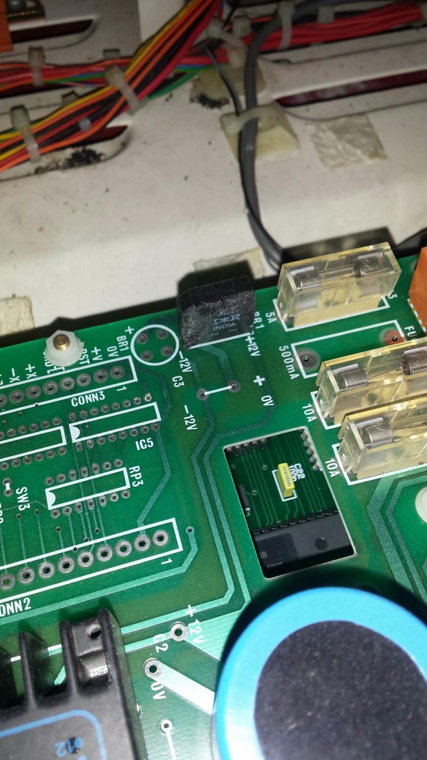

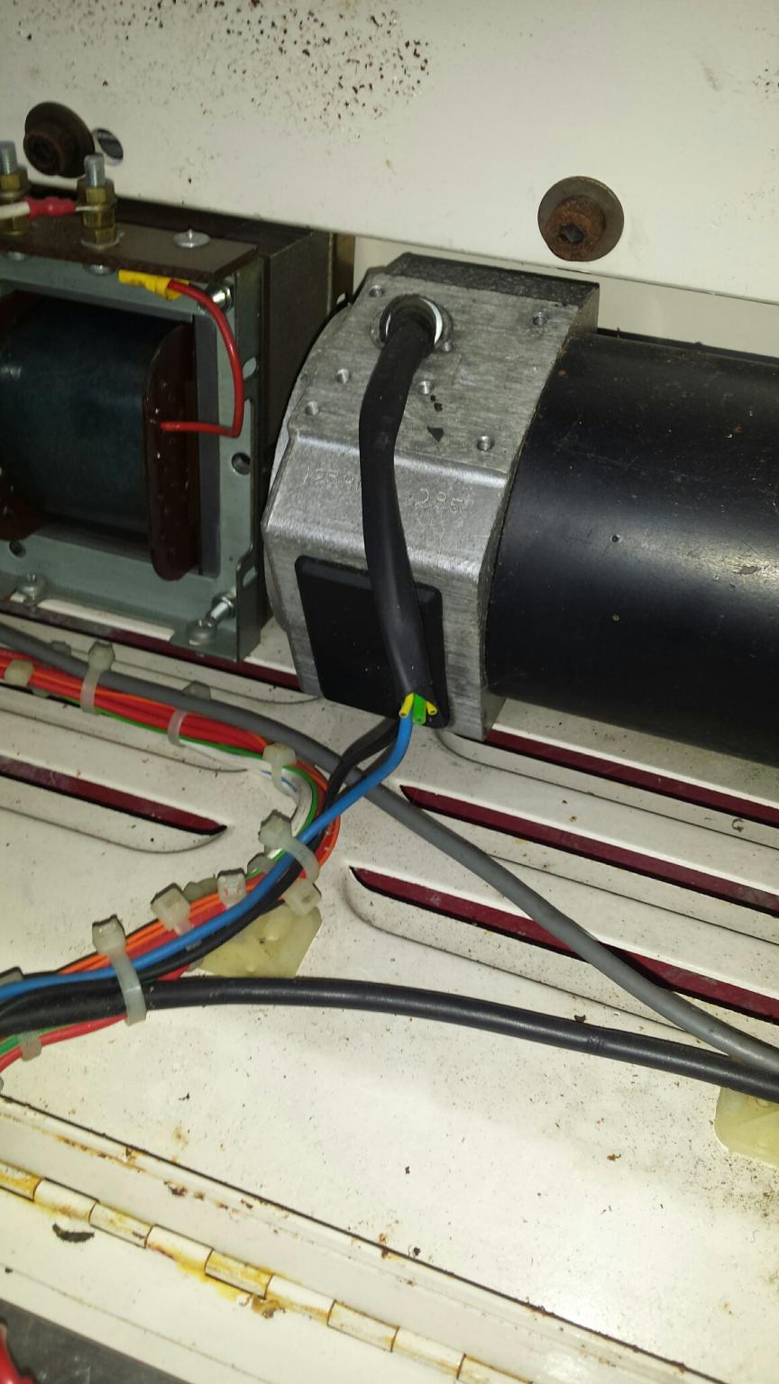

the steppers lock up when lathe is powered, if so then some power is getting to the drives.
The dodgy wires under the top board were probably fitted by Boxford, i had a few on my original boards.
I would pick an axis button and check for continuity right back to the board, then check from the board connector back to the stepper drives.
Also check from the lower board.

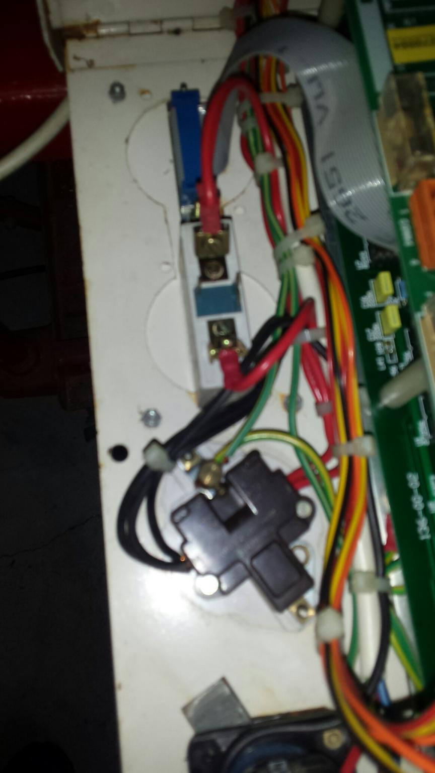

Difficult to trace Inee!
It looks like there is a ring of black ground wires around most of the button switches , and each switch then has a signal wire at 10.6 volts dc.
I also presume that the motion is operated when each of those signal wires is grounded by pressing the button. All the wires seem to be supplied by the 34 wire ribbon connector which also connects to both Microprocessor (Bottom) board and to the feed regulator / potentiometer board on the back of the feed rate switch.
Difficult to follow the ribbon connections.
I wouldn't waste any time on it just gut it.!!
