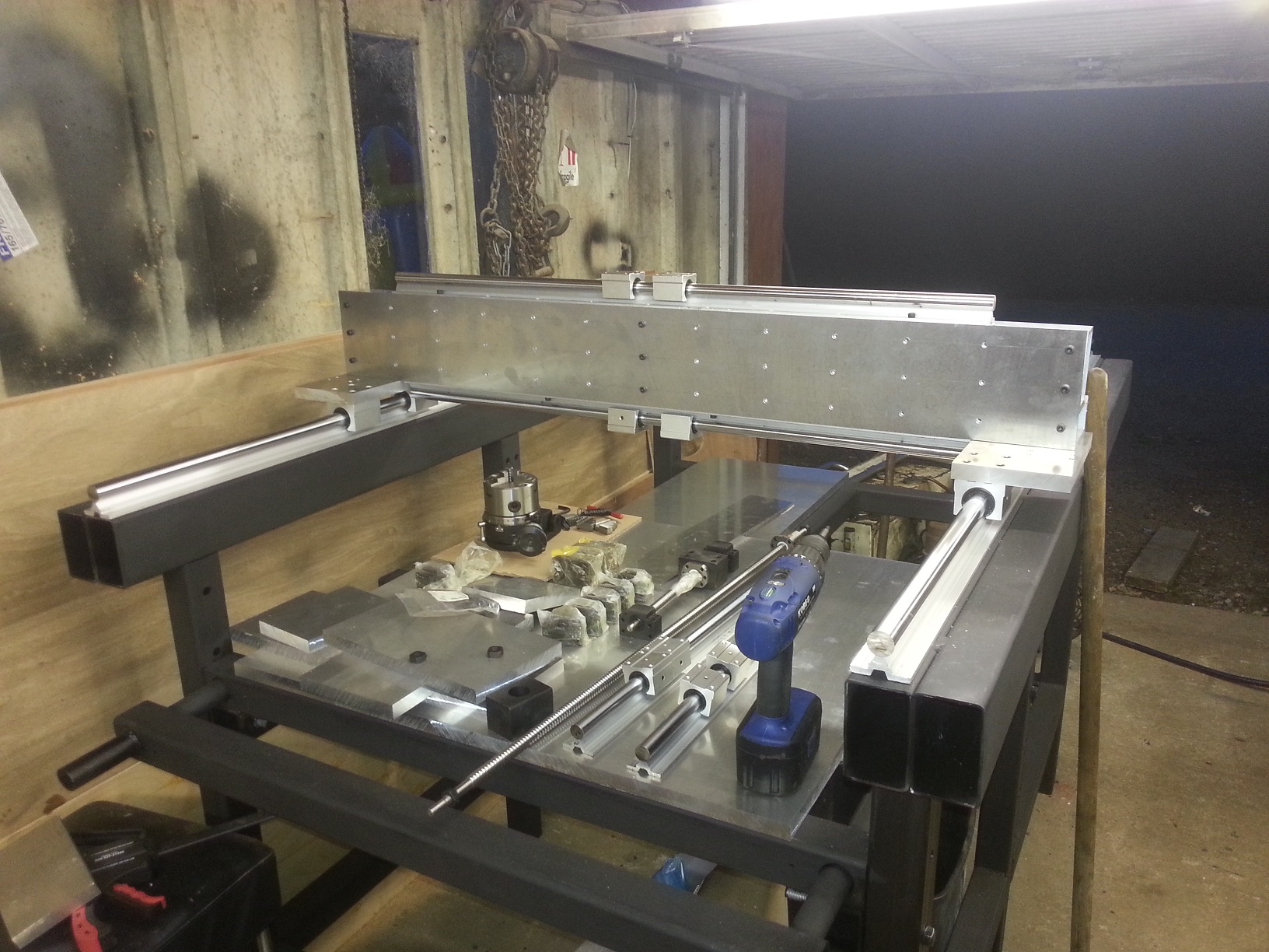

Ok - I have a gantry drawn up now that i'm feeling much happier about.
Weight as it stands currently is approx 28.5kg...obviously z-axis & spindle etc still need to go on.
Motor mount shown is rough & a guide only.
Leadscrew is guide only.
Teal parts: 75 x 50 x 3 steel box
Green parts: 60 x 5 steel flat bar
Bearing mounts: 15mm ecocast
Front vertical plate: 5mm aluminium plate
End braces: 15mm aluminium plate
Rails are mounted on 50 x 10 aluminium flat bar
Hopefully this is a decent blend of strength, precision/alignment & weight.:concern:
Bracing for impact...thoughts?

Erm.!! . . . It's ok but there's not much holding or supporting that top rail piece. 5mm Ali has no strength in it so your gaining nothing from that really and the Steel plate doesn't add any strength.
The triangle piece on the X axis is about the only thing supporting it and that's not enough it will flex under cutting and transfer to finish quality.
At the very minimum I'd have 2 triangle pieces at each side, really i'd make the gantry sides wider and tie the end of both rails into sides has well as double triangles on each side.
On a plus note you could drop those pieces between the rails and steel has you can drill & tap the steel directly. You only really need those when using Alu profile.
Beef the holding of the cross rails and it will be ok.

Ok - V2...
Inner end pieces are 15mm plate
Outer end plates are 20mm
bearing blocks also beefed to 20mm
Front plate is still 5mm - more to keep crap away from the leadscrew than perform a major structural role...although should help with twist & sideways flex.
Rear stell plate removed - although that was there more for a convenient flat mounting surface rather than anything majorly structural.
Still comes in under £100 - so that keeps me happy :rugby:

Better but still no inner triangle brace.!! See pic of brace on my machine. It's only a small thing but does help stiffen and dampen vibration more than it looks.
Don't let Money run this Build too much because you could easily find you spoil it for not much more money.!! . . . Better waiting and saving up to do it right than skimp. It's a lot of work building a CNC machine and just small things that don't cost the earth can make a big difference.

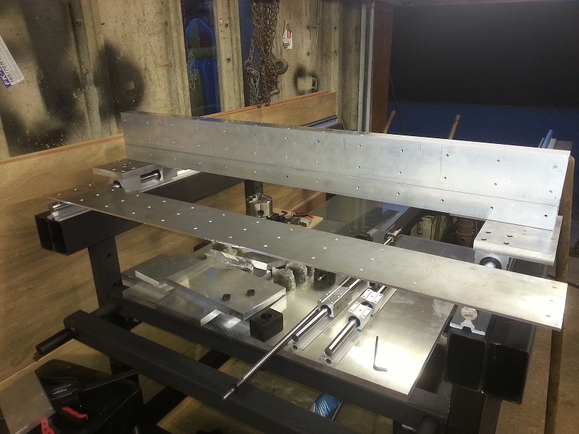

Right, the gantry is moving along nicely - i'm at the stage now where i'm starting to add the Z-axis. Its probably time to finalize rail/leadscrew choices before I go much further.
My thoughts have been
X - SB20 rail with 2x 1605 screw
Y - SB20 rail with 1605 screw
Z - SB16 rail with 1605 screw
I've seen mentions of clearance issues/fiddlyness when using SB16 with, I assume 1605 screws...should I just use SB20 for Z as well?
All axis will have a single Nema 23 motor & be driven by belts/pinions. Initial power setup will only be 24V - but I plan on upgrading this to at least 48V in the relatively near future.
Does this sound ok?...what about the Z axis setup?

No don't use 5mm pitch for X & Y you want 10mm so RM1610. Use Rm1605 on Z axis.
Either rails will work but your correct the 16mm are lower so very close without machining the plates to allow clearance for ballnut.
Dump the 24V ASAP.

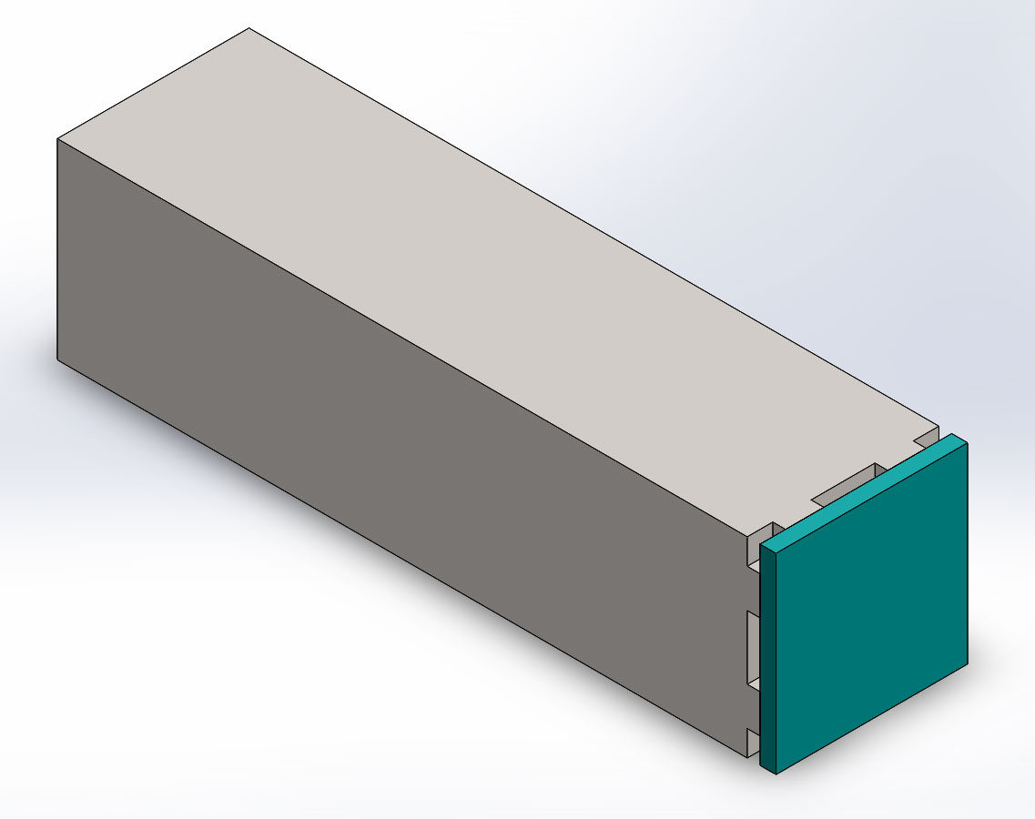

As i'm getting further into the design now & tweaking parts sizes to make leadscrew bearing housing line up etc i'm wondering about methods of assembly & tweaking the fit of parts.
This is a 2 pronged question..
Firstly - I see many mentions of shimming parts to get accurate spacings & alignment....what is normally used for shimming?
Secondly - some of the parts that i'll be constructing have a length of steel box with an end cap plate that needs to be welded on.
On the design, i'm drawing this as a neat, flush fit like this:
Attachment 9594
Given that i'll be completely new to welding (yes i'll be practicing first), the tutorial video that i've watched suggests fitting parts together like the next image so that the actual weld can fit between the box & plate.
Attachment 9595
That obviously makes getting accurate positioning very tricky & i'm guessing a bit of a nightmare.
So I was wondering if something like this would be a better approach...grind out some notches on the end of the box section - sit the plate flat on the end, then tack weld into the gaps that were created by the grinding...this should help keep alignment more straightforward & accurate?
Attachment 9596
If i'm missing something here please fill me in...or I could be missing something entirely :nightmare:
Re: Steel frame cnc router design/build
Could you not just make the green bit a bigger so that you can weld it from the other side to get your fillet weld ..Clive
Some of the joints extend on 2 sides of the box already - I guess it might be easier to tweak the layout slightly so they all do that.
If you practice on some scrap bits with no gap between & try increasing the Amps so you get better penetration, or try a weld prep on both parts(ie 45deg chamfer)
2 Attachment(s)
what if you weld some wire on inside face and use them like a spacers?,
or just grind the end plate edges to get weld in
Thanks chaps - adding a chamfer to the edges could be an option. I'm off work on Friday - I think i'll take a trip to the steel yard & see if I can get some scrap, then have a play with a few different approaches.
Just a pity you didn't have a TIG setup, all you do then is strike the arc wait to get your pool and advance the torch, it make a very clean weld.
If i were you i would try just putting a prep on the box section, leave the end caps with square edge, then when you lay down your weld you won't(hopefully) melt the outer edge of the blank and it will look a lot better, i am fortunate as i have TIG so can just fuse the two together.
