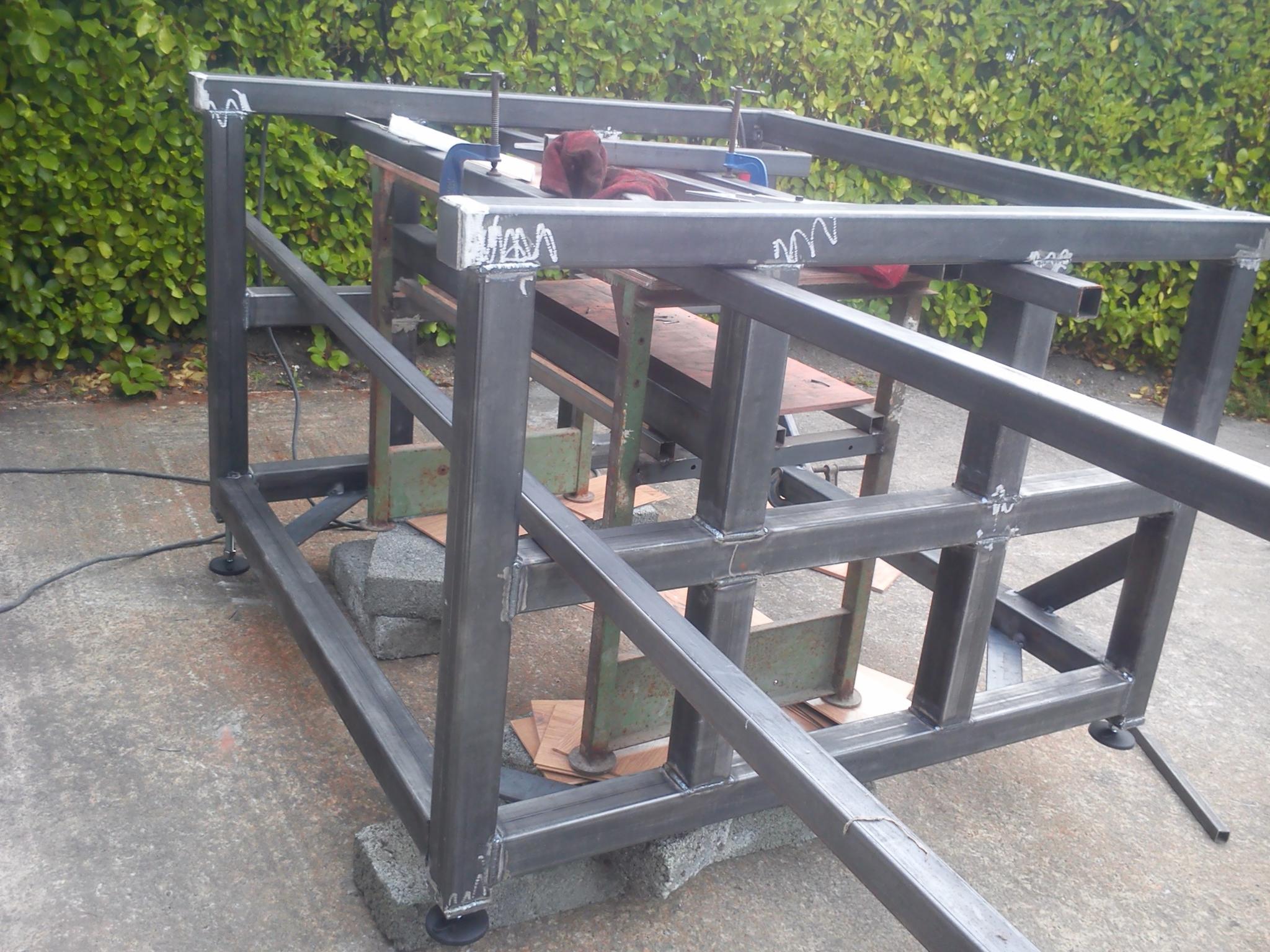

the frame is nearly finished. i have to weld in the table locators on each side and give it a lick of paint. it looks big ( it is ) but i said to myself that i may need upgradeability considering the growth of the DIY cncs over the past number of years and the bigger routers that are coming on stream.
Attachment 13200
i also welded the electric cabinet frame together, 800 x 600 x 200 deep ( just under 3 lengths of 20 x 20 angle). i have 1mm galvanize to sheet it and some hinges knocking about somewhere.
the frame and cabinet should be finished by next weekend and then i'll get a moat organised for the dreaded epoxy pour!!

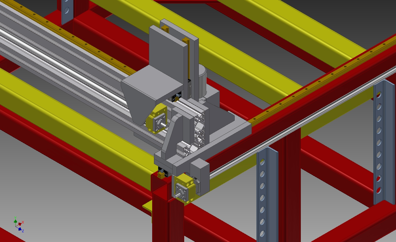

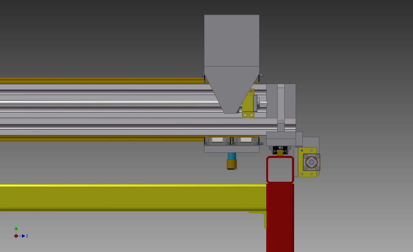

2 Attachment(s)
Re: Let the fun begin !!! ???
more pics .the motor config. is repeated on the far side .
Why do you have what looks like a 3:1 ratio on the screws.? Even with a 10mm pitch screw 2:1 is bad idea if your planning on using as wood router.
2:1 ratio will slow you down to around 5 or 6mtr/min max rapids and for woods you'll want to be cutting at that. 3:1 would be even worse.!!
Stay with a 1:1 ratio is my advise if your cutting woods.
Regards the motors then it's preference thing mostly 2 x 3 or 4Nm 23's will easily handle 65Kg. I prefer single motor with belt for accurecy and piece of mind reasons but I'm equaly happy to use slaved motors provided the correct drives and precautions are used. Slaved motors work ok but I would only use them provided you have Digital drives that can detect stalled motors or have fault output so you can E-stop the system.
Digital drives have made slaved motors much safer in my opion with less stalling as they handle current so much better and can easily detect for stalls. They also dont loose steps as much as the old drives did.

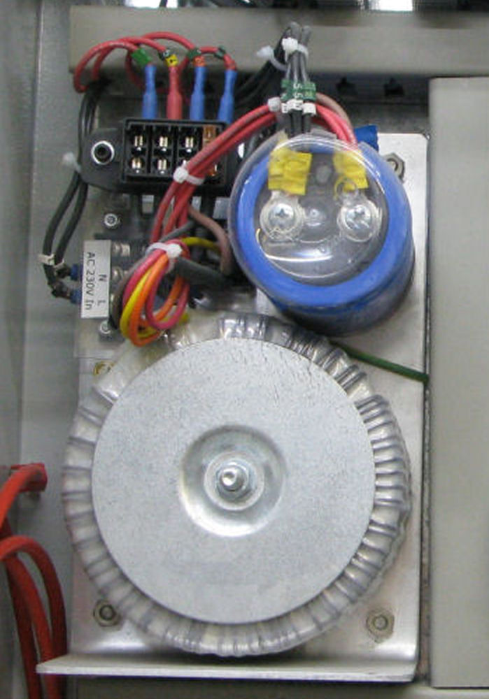

Here's a picture of how mine looks, the bridge rectifier is under those wires between the terminals and the capacitor.

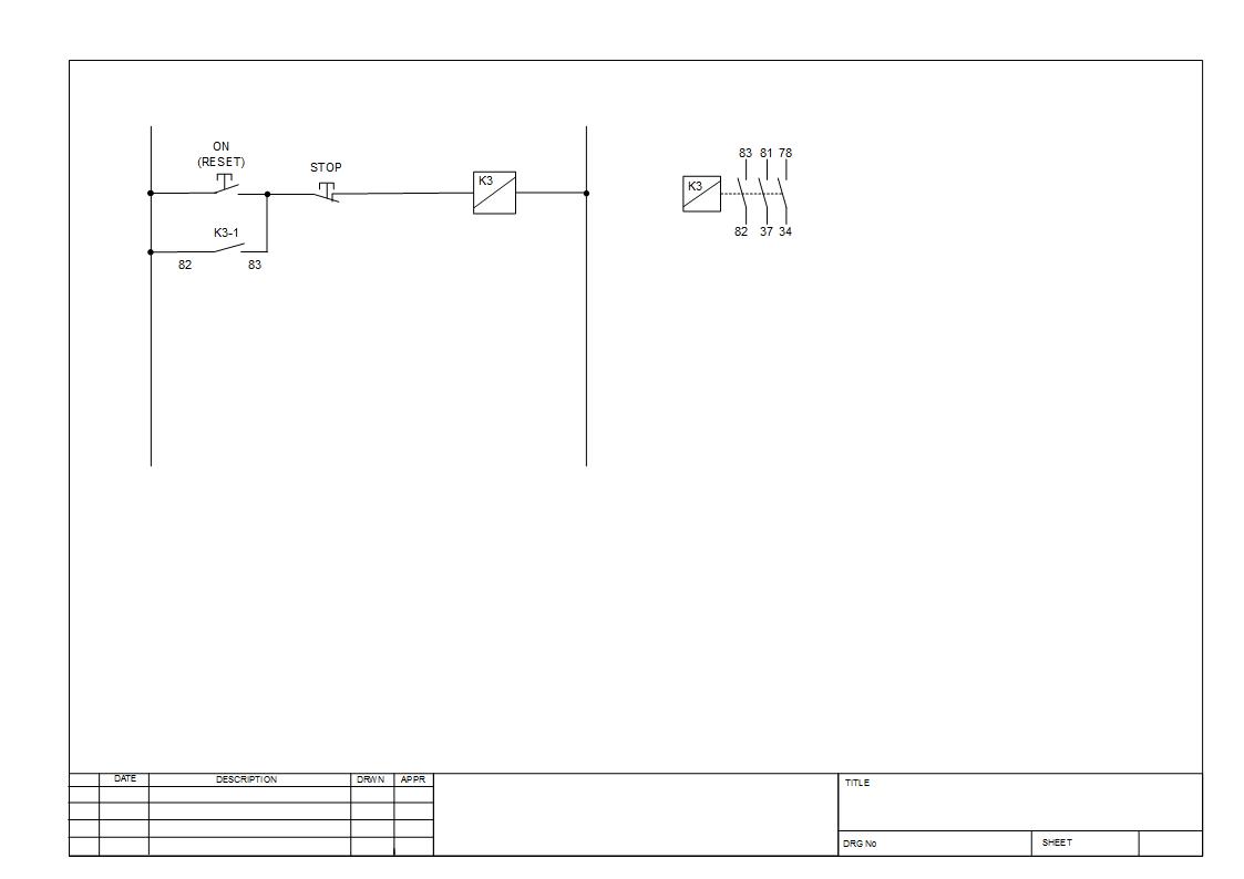

And here's a typical latch circuit
Attachment 14657

thanks guys i'm about to put the first elec dwg. together and when it's finished you might critique it and let me know:dread:

EddyCurrent
Nice pic. Eddy but I only see one cap!! How big is it:barbershop_quartet_ ..Clive
Clive S
22000uF 100v
2 Attachment(s)
well here is the PSU and e stop circuit . i'm not sure if my calcs. are correct so i could do with a second opinion. i have calculated for 5 motors but i'm only using 4 to get the me up and playing . the 5 motor will be for the A axis further on up the road ( https://www.youtube.com/watch?v=EIwEh6ZmFFs) i have calculated for the lowest cap. and rectifer but will go with something with more head room. any way , feed back would be great , cheers in advance

22000uF 100v
Wow that's big for one cap I am using 3 to get 14100uF may I ask where you got it. ..Clive

Paulro That looks fine to me the rectifiers are usually 30 - 50 A anyway. Not sure I would switch the earth out though. ..Clive
