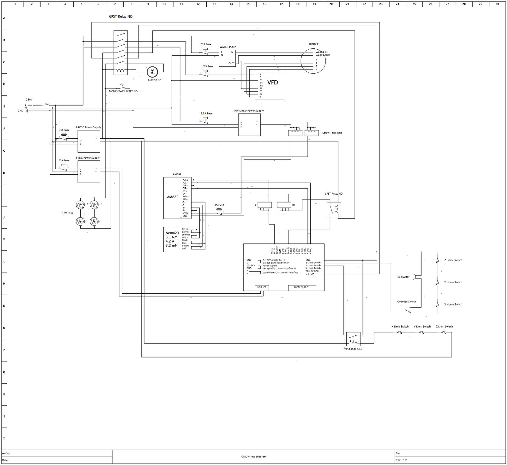

Here is one of my older diagrams (a few changes since) - see the yellow cables which all join at a single point. This is then connected to the mains cable earth.

My question was more about how you stop the spindle. On your diagram, I see the line that goes through the relay and connects to FWD and FVD control interface, but what powers it ? Is that wire getting 24V, or is it just a loop on the VFD itself ? Here is how I understand it: when you power up everything, the spindle can move forward because the loop DCM/FWD is closed. If the relay goes off, the circuit opens and the VFD stops the spindle because its DCM/FWD loop is broken. I am wrong again ?

Jazz, when looking at my VFD manual, it looks like instead of the FWD (which is actually labelled FOR) I should use the RST pin.. If I wire the FOR-DCM loop through the relay, the spindle will start automatically right ? I'm not sure that's the behaviour I want.. I just want to be able to manually control the start/stop speed etc with the VFD front panel, but automatically stop when the relay goes off. I know you're gonna end up thinking I'm dumb, but I promise I'm not that stupid haha :) Now, if using the DCM-RST loop, I guess it would have to be normally closed, so that when nothing's powered the spindle does not start, when the relay is on the RST line is off so the spindle can start/stop as I will, and then when power goes off (due to pressing the e-stop) the relay goes off and the RST line closes which stops the spindle.
Ok well same thing really just controling a different function and how you describe the relay etc is correct. BUT why wouldn't you want the software to Control ON/OFF if you have the abilty.? . . It makes life so much easier.!
You can walk away from the machine and Know it will stop the spindle when finished. It will Stop the Spindle between Tool changes and Start again when press Cycle start. Which is great when learning because it's common for people to push Cycle start after tool change then realise they haven't started the spindle.!!
What you could do is use a two way switch with centre off. One way would switch the FOR-DCM directly and the other would put the FOR-DCM through a relay controlled by the BoB. That would give you three modes :- Fully ON,Totally OFF and Automatic. I do this for my Kress spindle and also my chip blower. I will probably do the same when I build the next machine with a VFD controlled spindle.

I hear you, but I don't see how the connecting the FOR-DCM loop through a relay would help the software control the VFD/spindle. For that I need to wire it to the BOB's VFD control interface, which I currently don't know how, as explained in my first post of this thread. I've given my BOB's model and manual already but I don't know how to use the BOB spindle control interface to control the vfd.. I would love someone to provide a simple wiring diagram with on one side the BOB's VFD control terminal and on the other side the VFD control interface and tell me how to wire the together.. I'm so sorry for looking like an idiot, but I prefer having someone explaining it clearly to me so I can understand it, because so far I haven't found such diagram on the forum.. :(
I was not intending to use panel control, but speed and direction control from the CSMIO-IP-S.
Looks like I will have to read up how the VFD works. My understanding was that DCM connected to FOR by a relay would cause the VFD to spin the motor according to the (0-10v) voltage applied to V1 and that opening the DCM, FOR connection would allow it to coast to a stop. All the setup articles I have seen are just how to connect R,S,T to single phase input and UVW to the motor, presumably then using the front panel to control ON/OFF and speed. I can't find any proper explanantion of the way RST (reset) works and what exactly it does.

Eurikain was talking about using the control panel but in anycase I don't see the point in what you suggest other than to disable ON?OFF. The Software allows you to manualy control spindle ON/OFF rather than G-code. The way you Suggest would work but is open to Error from forgetting to switch back and not turn spindle on before code starts and I don't care how fast you think you are there will be times when you do for get and can't reach it. Just like you can't reach O-shite button fast enough before it snaps cutter.!!
If you do want an actual Manual ON/OFF switch then better to use an Input and set up OEM trigger in Mach to turn Spindle ON/OFF.
If for Safety reasons then would only do this if it was tied to Reset so Control software can't start.
Your understanding is correct.
RST works just like Pressing STOP. Each of the VFD Inputs are programmable and can be set to do various controls and RST is set by default to same as pressing STOP button on control panel. When you Connect DCM to RST it Stops the VFD. Putting this thru E-stop contact will disable the VFD
I'm not trawling back thru your posts to find out what BOB etc you have but if you post details again then I'll draw something for you.

I think my BOB allows controlling on/off and speed as well for the vfd. If you can show me how to wire it in order to do that it would be awesome ! I don't know much about what Gcode can do beside positioning, but I guess it can embed speed control ? I'm also assuming that Mach3 is responsible for controlling on/off of the spindle when the g-code processing starts or stops (so it's not embedded in the g-code).

[ATTACH=CONFIG]It's easy see pic. Here we are using the Relay on the Spindle to Control ON/OFF. (Top 2 wires)
The bottom 2 wires are 0-10V for speed control.
You will need to change some parameters in the VFD. These tell the VFD it's being controlled from external source. (Won't be able to control from VFD front panel unless set back to 0)
PD001 = 1
PD002 = 1
Now just set Mach3 up according to manual regards Spindle speed and Relay control.

Thank you SO much ! I will be connecting these four wires tomorrow and post pictures of the finished control cabinet :) ! Can't wait :D The machine's almost ready :D
I was also wondering what the 10-24V inputs of the BOB (between top 2 and bottom 2 pins you connected to the VFD) are used for ?

Why is the enable signal wired in a relay that's controlled by the master relay?
Why not just use the master relay and skip one relay?
Robert
looking at diagram in post 42 I have noticed two issues-
I would expect wiring in series a 12V fan & 12V pump across a 24V supply will damage the fan !
( pump will look like a short circuit so most of the 24V will be across the fan )
connecting a diode (FR607 ?) across each stepper driver supply fuse
will provide a path for the back EMF from the stepper motor
when a fuse blows
see revised diagram

About the diodes across the fuses for stepper drivers..
How big of a problem is it if you don't use a diod?
In my mind it's more probable that the fuse will break during acceleration instead of deceleration?
I might be wrong? :)
I think that the driver output stages have back emf protection, as the first vulnerable components are the switching transistors. I have been unable to find a circuit for that driver, but they are all much of a muchness. A diode across the fuses is belt and braces.
I totally agree about the pump and fan.
