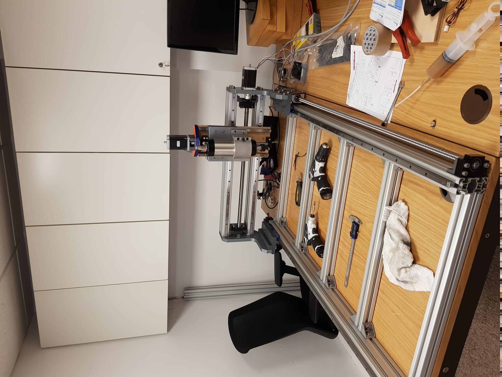

4 Attachment(s)
Re: Building My First CNC Router, Looking for Advice & Other Info
Thanks for your replies guys, i ended up getting a reel from RS Components for about £50 and some marine grade connectors whilst i was there. Had some movement out of the X & Y Axis! Fastest they seem to be able to Jog at the moment is 12500mm/min, i have not played with any acceleration settings yet. Waiting for 2 x DB25 Breakout Boards and DB25 2m cable to come so i can start properly wiring the controller, at the moment i've just run some cables to test movement. Also got the new Samsung Note 8 so now i can take photo's that don't look like they were taken on a potato.
Ordered some 40 x 15mm Cable drags, which should give me enough space to run 4 Lots of the CY Cable and also the Coolant Lines for the spindle. Need to start looking at what endstops i would like to use, i have a hole bag of micro switches that i could use but i think i would like to use some nice LED Inductive Sensors.

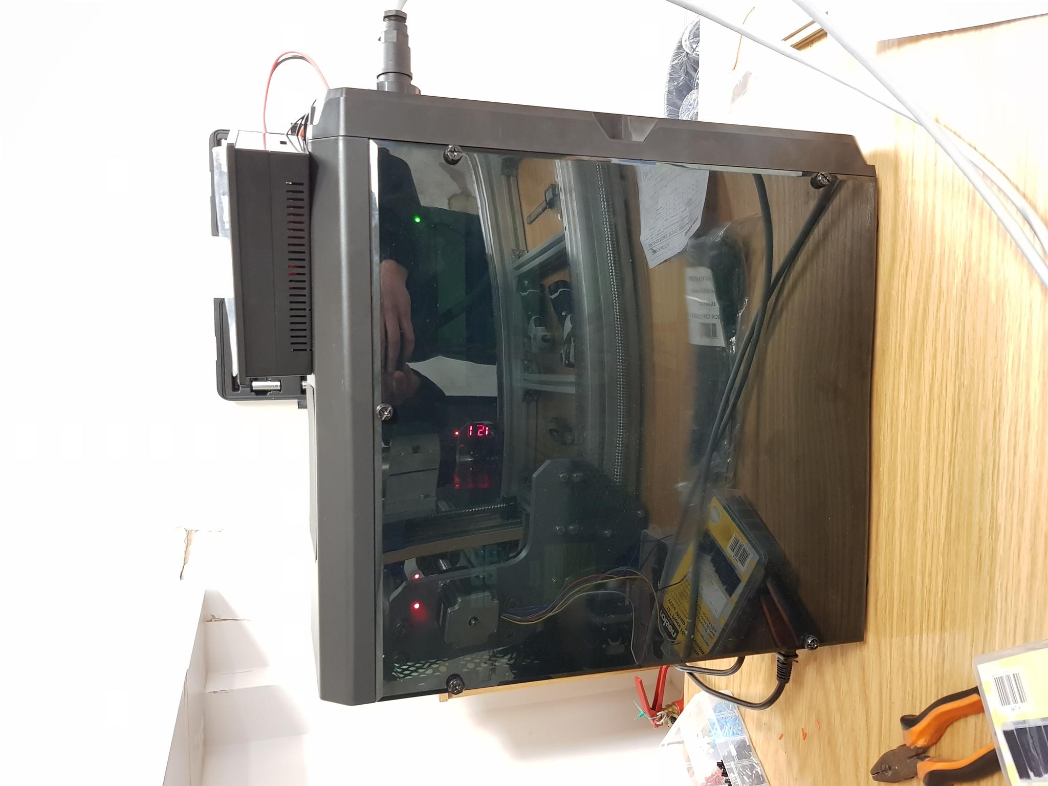

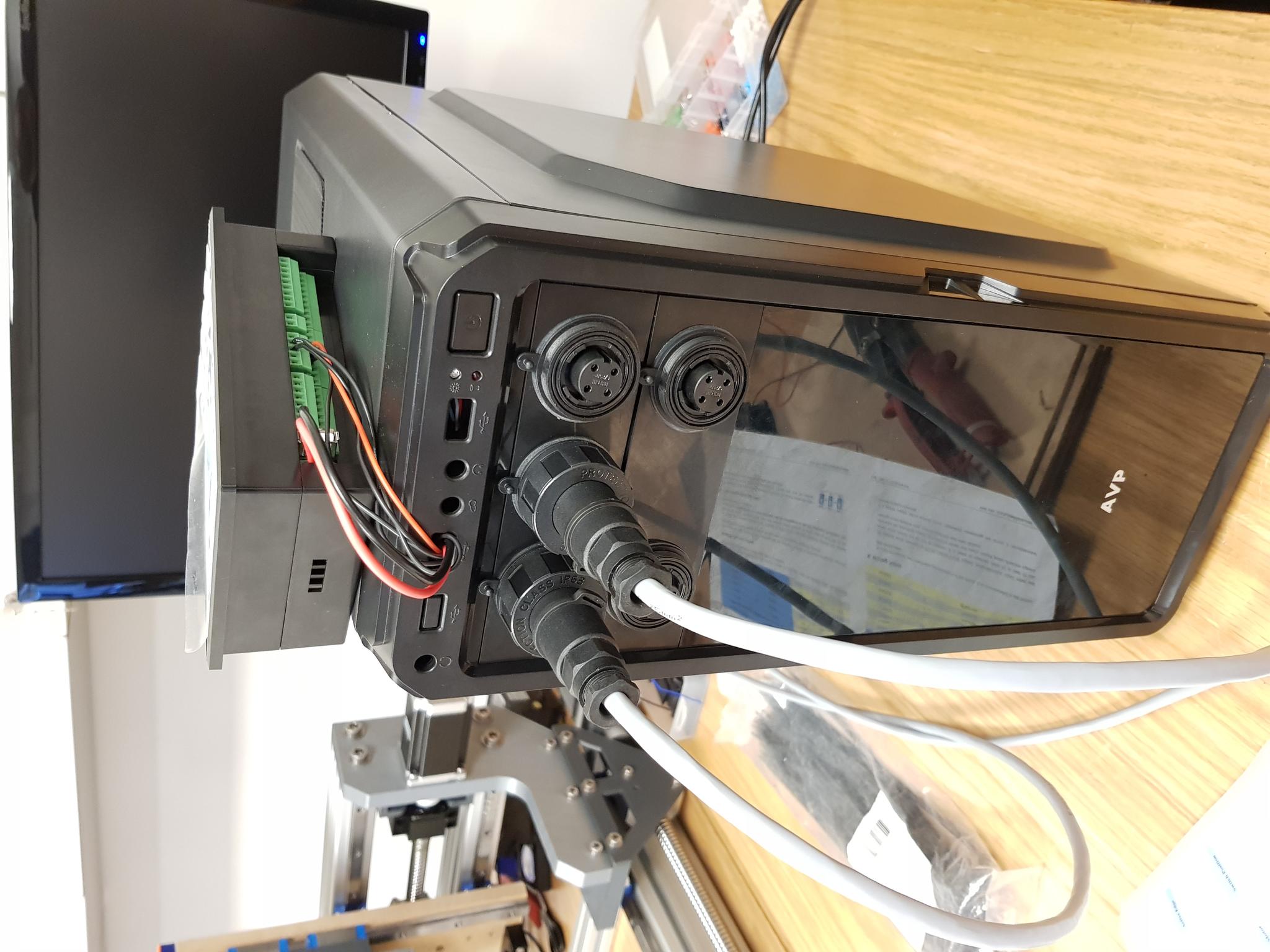

Made a start on modelling a hand held case for the DDCSV controller so that it can easily be carried around the machine to any position, it will also have a stand it can be put on.
I decided that it might be better to fix the machine to the bench it will be on, will this be satisfactory in terms of absorbing some vibrations or should i look at filling the extrusions with resin? What resin should i look at if this is the case?
Attachment 22878
Attachment 22879
Attachment 22880
Attachment 22881

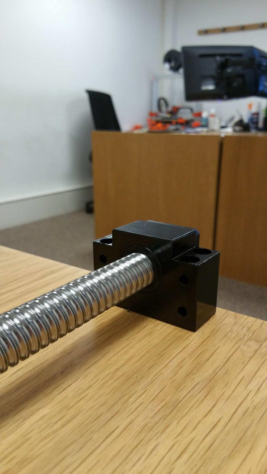

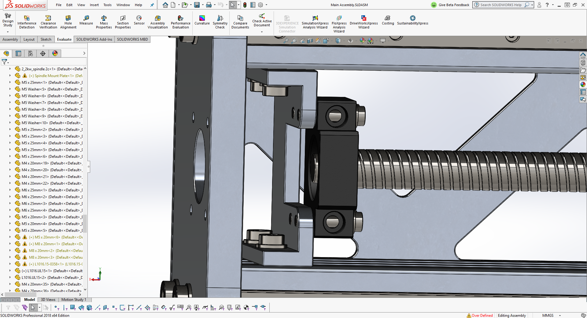

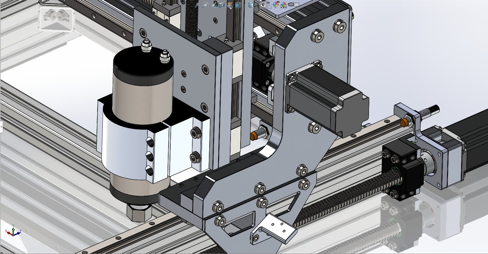

...now you must practice how to set the orientation right. The pictures are nice but they are all (even the videos) turned 90 degrees... ;) I mean, the videos are supposed to be taken with the phone in horizontal orientation otherwise you are wasting image surface area.
Anyway, it is really a very nice machine you are building. The only thing I notice is that you seem to have made the same mistake I did regarding the Z plate. The linear bearings should be the other way round, the rails moving up/down and the bearings fixed. If not too late you should change that. For me it is too late now, but it sure will be the first thing I'll correct next time I upgrade my CNC.
Lol I took the photos portrait and they are portrait on my PC, so not sure why they have uploaded rotated! Schoolboy error on the video though haha

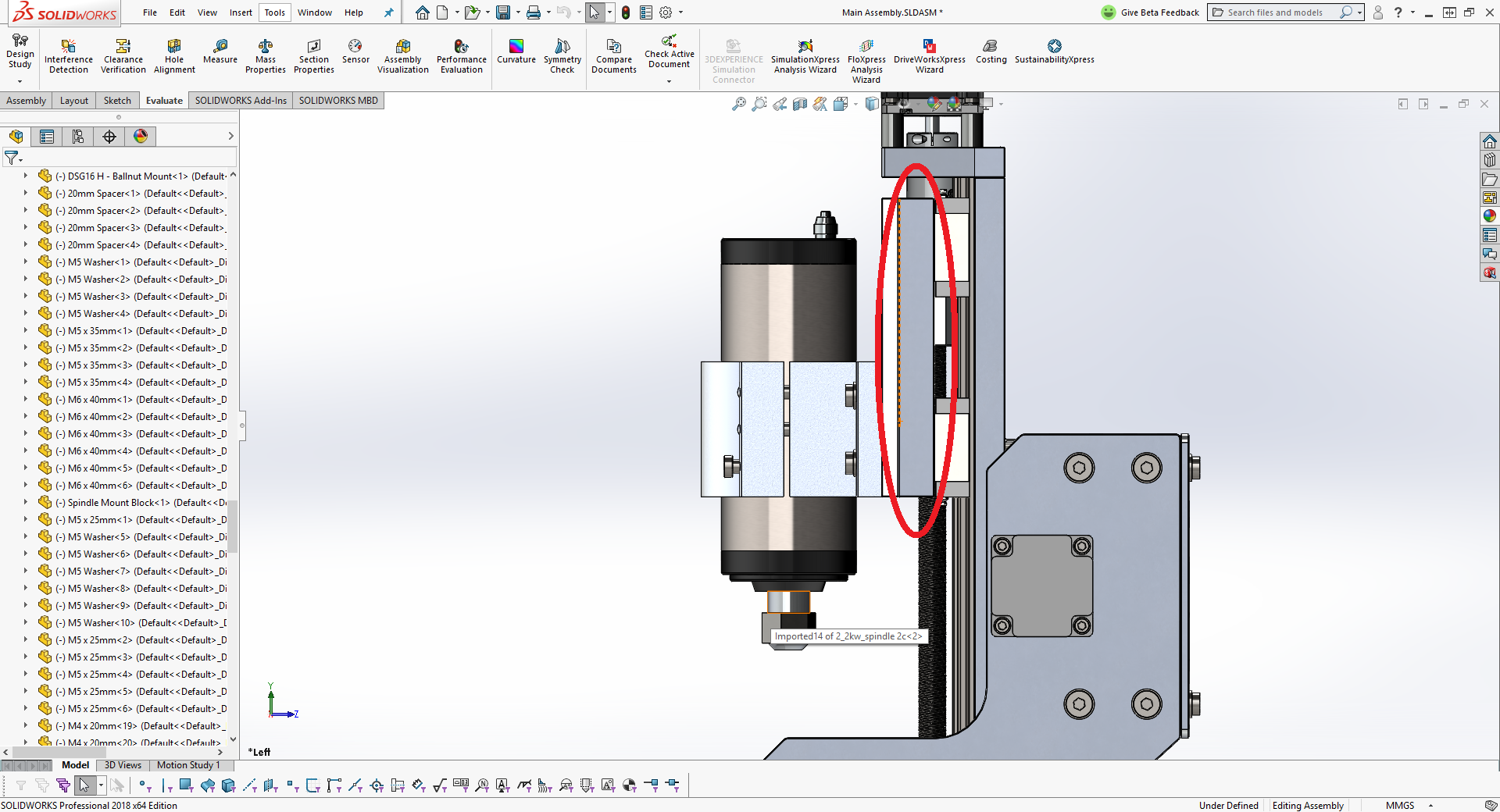

That's an interesting point about the Z Bearings, so is the point of this to be able to spread the bearings further apart?? Maybe I could change the design, I'll have to have a play around with the CAD model.

If you look at the geometry of the Z plates and imagine both ways of positioning rails and bearings, you will see that you get better support of the moving plate through its full travel if you put the bearing carriages on the fixed plate. It feels wrong at first, but it's the right thing to do! The rails also provide a slight stiffening effect on the moving plate as well, although if you use the usual 20mm plate, that's not going to matter much.
While I agree, it was pointed out to me that it can make the Z-axis less versatile... it can limit the ability to retract the Spindle and tool above the gantry base height which can cause problems when using long tools and/or tall stock.
Just worth considering if that sort of thing is on the agenda.
No argument there - good engineering is all about compromise, and understanding the trade-offs so you pick the right compromise is important.

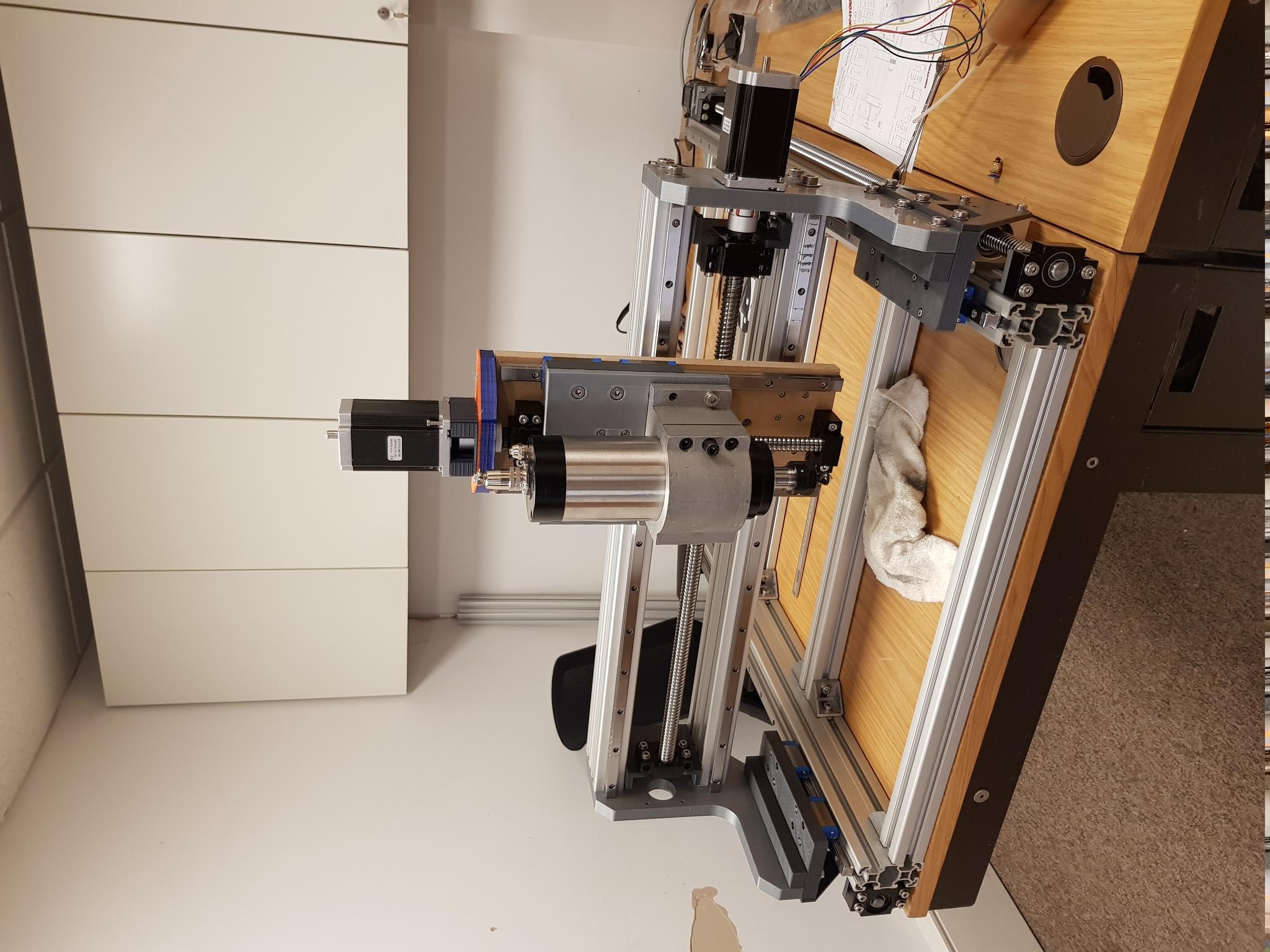

So i adjusted some of the components of the Z Axis to hopefully improve how rigid it is, previously that blocks that connect the Spindle Mount to the Linear Carriages were shorter than the Spindle Mount, in order to try and maximise Axis Travel, however in reality this meant that the spindle could reach well below the bed even without a tool in the collet, so i decided to make the Connection Blocks longer and increase the spacing of the Carriages.
Attachment 22883

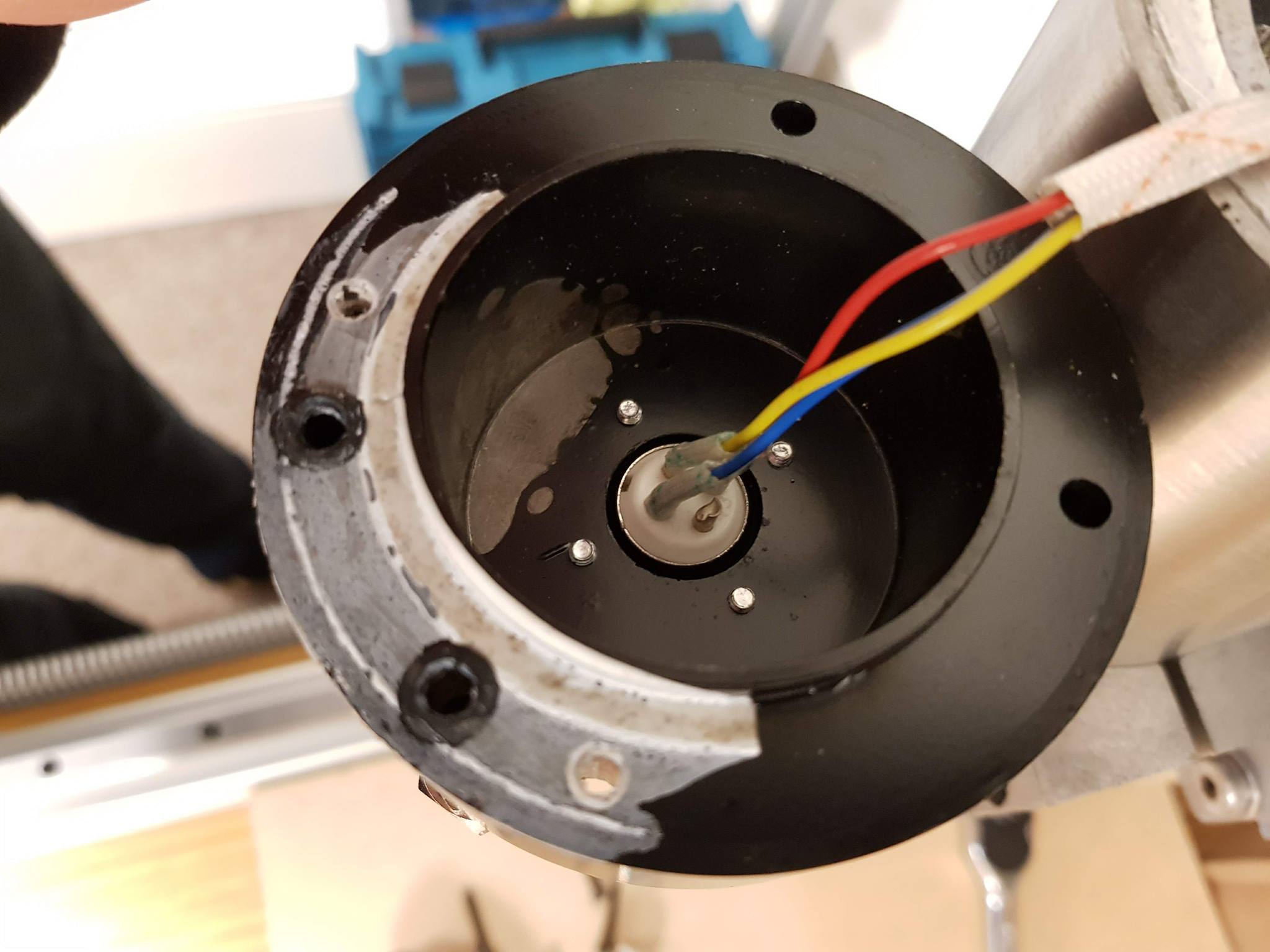

I started looking today about how i need to properly Ground the Spindle at the VFD side, whilst looking for information i came accross a forum post on CNCZone that said many of the Chinese spindles do not have their Ground pins connected to anything inside the Spindle, so i decided to take the top off and have a look - and not much of a surprise as the Ground pin was not connected to anything. Where can i connect this to? Should i just drill and tap a hole so that a connector can be screwed to the casing and soldered the correct pin?
Attachment 22884

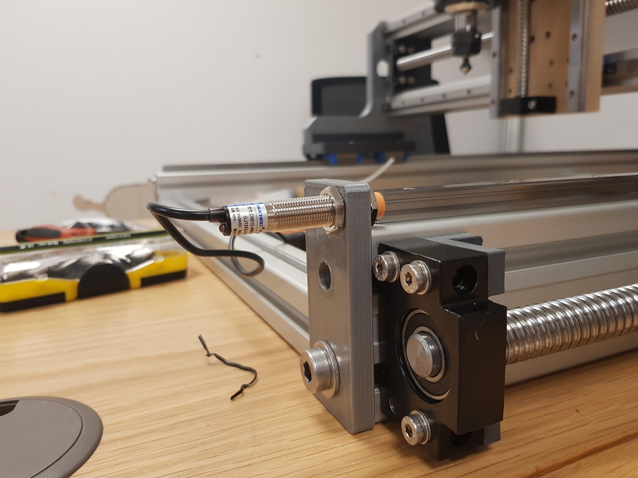

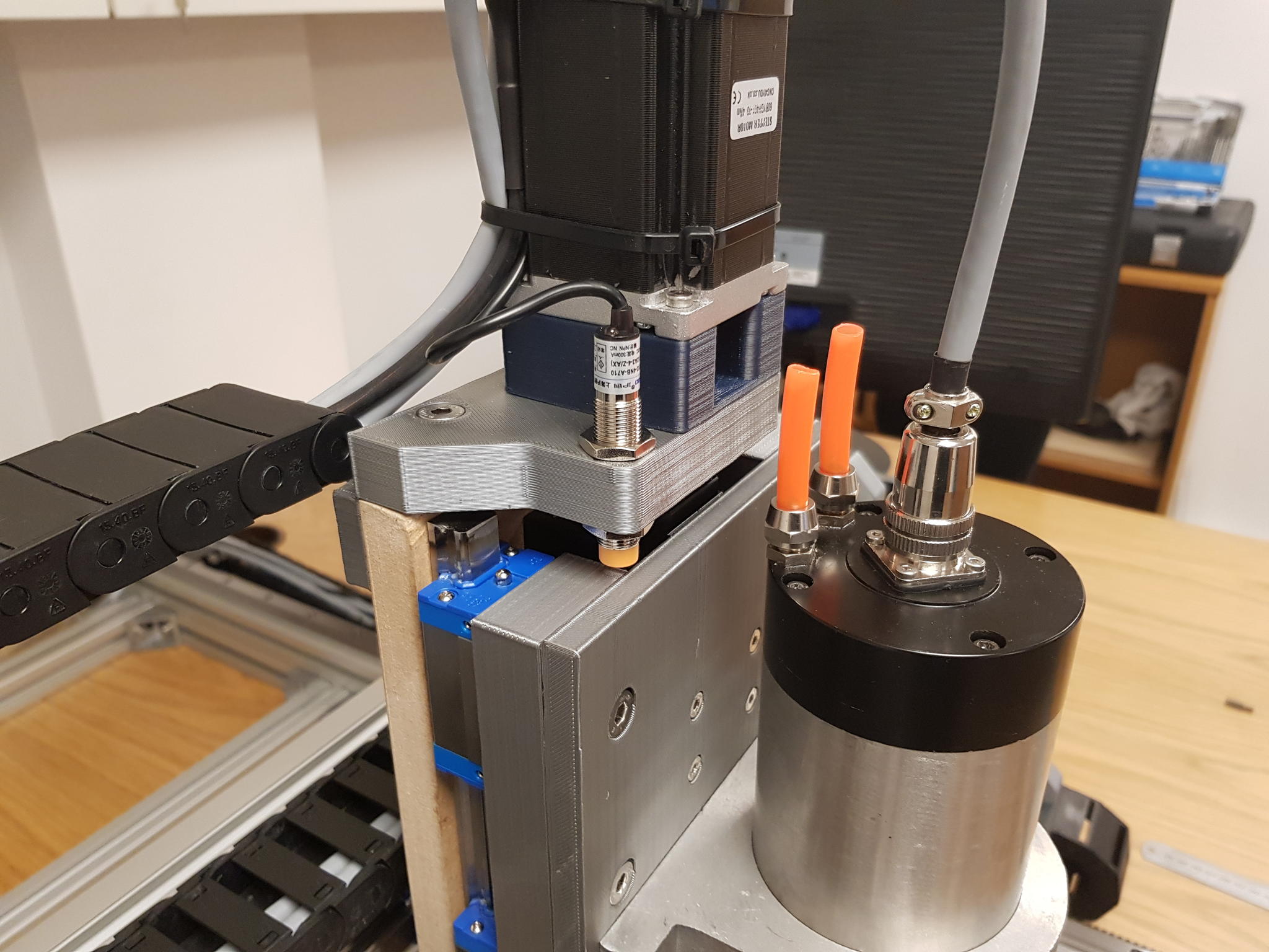

I've also been scouring the net today trying to find some nice proximity sensors to be used as limit switches, i think the DDSCV1.1 can use 12v limit switches? Could be wrong any advice would be appreciated.
I just changed one of the socket hold down bolt to one a bit longer and put a connector on that with a nut.
Make sure you clean the water holes and put a little silicone around them to make a good seal when you put the top back on.
So simple - yet so brilliant ;) :D Thanks i will do that.
Thanks for the silicone tip i will pop out and grab some tomorrow.

Havn't had as much time as i'd hoped the last few weeks to get much done, got all of the stepper wiring done, the cable drags turned up which meant i could get the lengths correct for the cables. I now have all Axis moving which is a nice milestone in the build. Ordered some Inductive Proximity sensors to act as limit switches, they seem to activate about 1.5mm from Aluminium, which should be ok for me. I need to do some research on the controller, as it has Terminals for Min, Max & Home for each Axis, what would be the scenario where you would have Home different to Min? Do some machines have Home at the Max or maybe Bed Centre?
Attachment 22989
Attachment 22990
Attachment 22991
Attachment 22992

Got the Spindle wired in also, just need to configure the VFD properly, watched a few videos online which seems to be simple enough.
Also got through EMI / RDI Ferrite Rings for the Spindle cable to try and help reduce interference from the Spindle / VFD (whether it will or not who knows).
Current task is designing a portable enclosure for the DDCSV controller and the Parallel Breakout Board, i got two breakout boards, one to on the Electronics Enclosure and another to go with the DDCSV in its portable enclosure.

Have you thought about the switches, the way you have them is asking for them to get squashed they might be better mounted so that they slide over the target

Haha don't say that and jinx me :D - Do you mean so that they would be similar to how I have done the Y Axis ones?

Exactly. You have the switches ready to get squashed:hurt:

Thanks, i will try and re-work those, at the moment those positions were the simplest and gave the maximum Axis Travel.

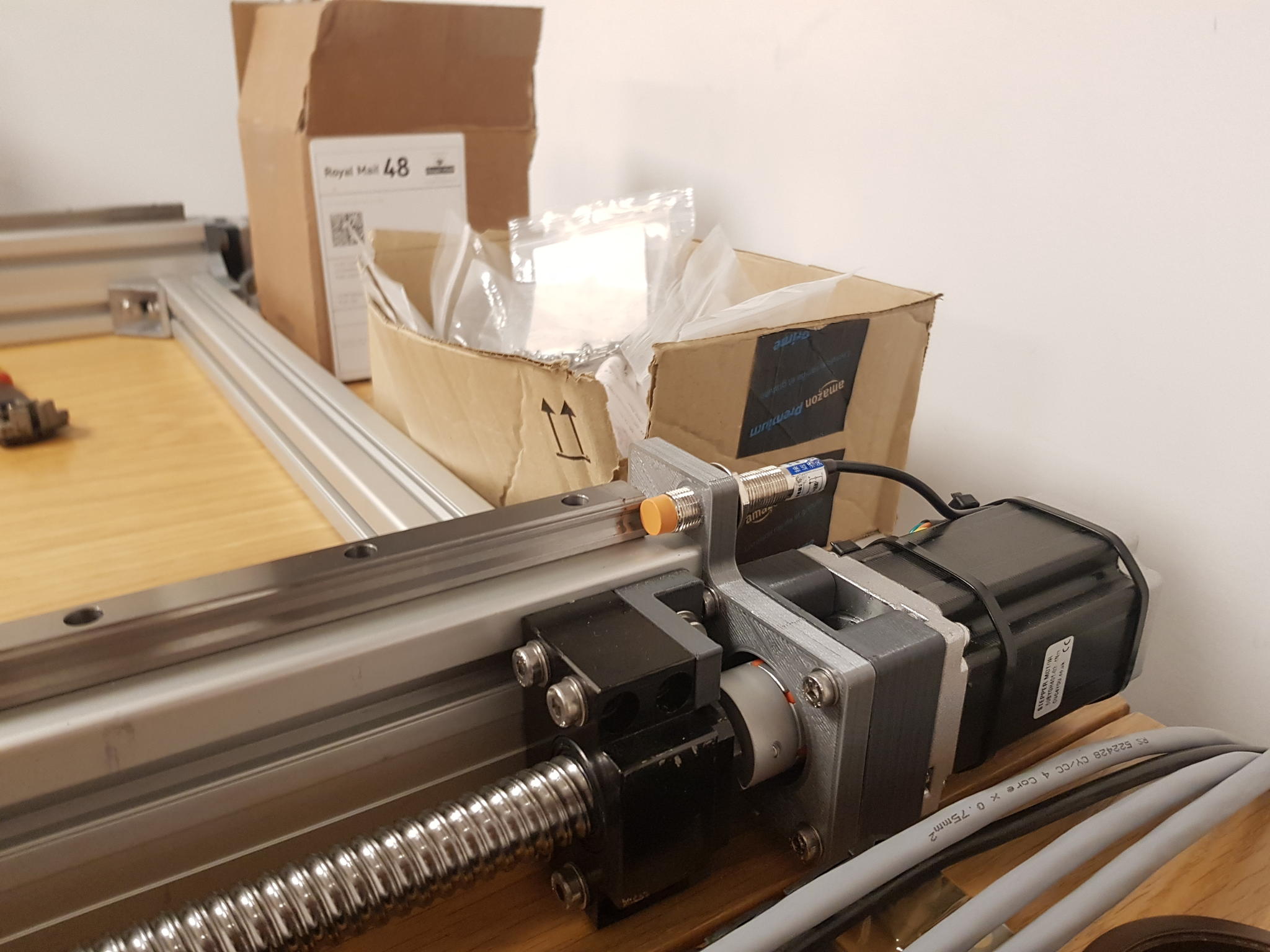

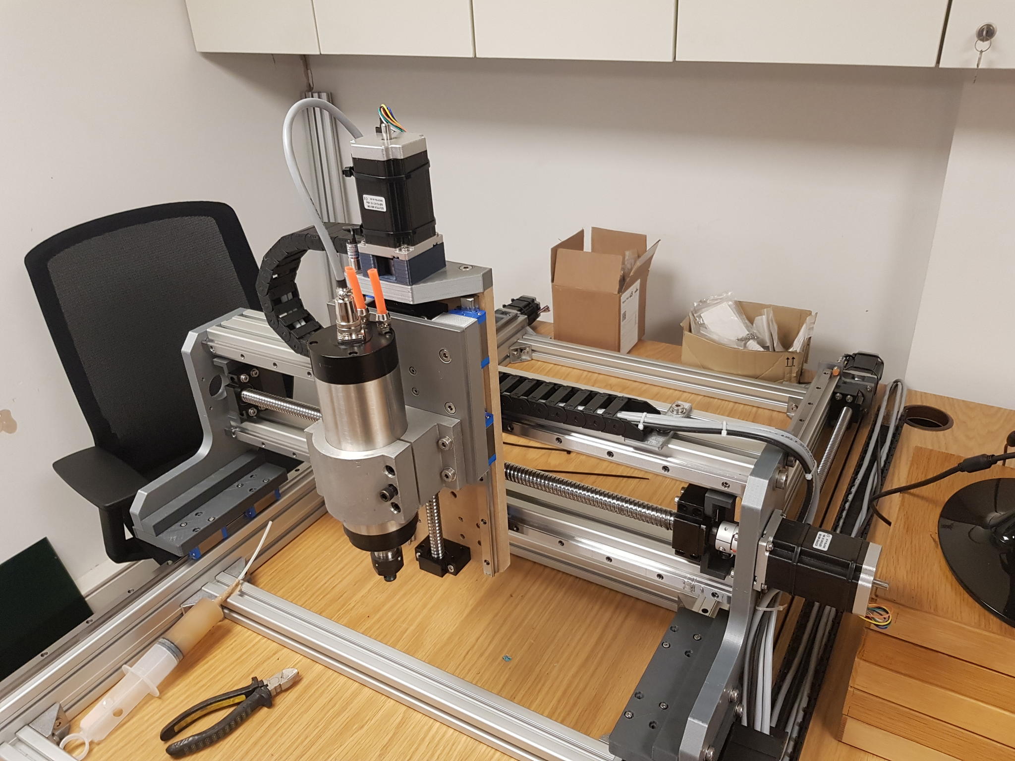

So i pretty much finished the wiring, and ran the coolant lines for the spindle, tried to semi tidy the cables & pipes.
I started working on getting the Limit / Home switches working but i have been an idiot and bought the wrong type of probes, the DDCSV expects a 12v signal from the probe, but mine are NPN and not PNP so i am pretty sure these are not going to work directly with the controller, bit of a pain considering i already soldered them to the longer cables etc, now i need to try and source some PNP variants that are the same size, and dont cost £40 each.
I also wired the VFD to the controller, however when i try to run the spindle, the display on the VFD changes but nothing actually on the spindle, not sure if i have it configured properly, followed a youtube video, but also read a DIY guide that had conflicting information about some of the Hertz values, also i am trying to signal VFD from the DDCSV using the 10v pwm signal, i had the control parameters (PD001 & PD002) on the VFD set to 1 but i think this needs to be 2.
Any advice or help on any of these points would be greatly appreciated.
By pure luck i have managed to find some rather nice (and expensive Balluff Brand) Proximity Sensors in my brothers shed (He is the maintenance guy at work), he only had 4, which is ok as it means i am able to the machine homed, and perform some more tests, and actually - im not sure that i even to have Max Limit Switches? There is a Software Travel Limit that is defined and seems to work very well, im not sure if these get ignored when running a program so i will have to check that out.
However now i can only seem to get the Z Axis to move in one direction, i was thinking that it must be a loose / funny connection somewhere since i had been tidying all of the wiring up. However if there was a problem with the wiring would the Stepper even move in one direction at all?
I was also curious as to how the Axis should be orientated, currently the X (my longest Axis) and the Y both home to minimum - Position 0, and then move positively through the co-ordinates- for example 0 -> 1010mm. However i know that our big machines move negatively, eg: 0mm -> -3000. Is there a standard way of setting this out? What are the implications, do they just affect how you need to setup any post processing configuration from SolidCAM, Fusion etc?
Im also curious about how the Z Axis is orientated too, when moving positively it travels upwards - the homing is set to minimum but when homing it searches upwards. Possibly this is because of the problems i am having with the Axis.
Attachment 22883
Also waiting for the Cable Drags and breakout boards to arrive so i can design some brackets and a portable enclosure for the controller.

Nice one both you and Clive tested my spindle today with an ammeter and it's obviously pin 4 is not connected to anything ;)
Will do as Clive suggested, were the top bolts hard to undo? I tried and felt some resistance like I have some loctite to break didn't want to push it until I asked had a nightmare rounding off A2's next time I build I will only use A2's were needed and stick to proper bolts if appropriate.
I had to crack them, think there was some thread lock on the bottom of mine, i one exactly as Clive suggested. However still cant seem to get the spindle going - have not tried today however; might switch it back to manual configuration and run it directly from the VFD just to make sure that everything is wired correctly.

Hi Jeremy! I hope you are well, i have been meaning to send you some updates on the build since we last spoke. Cad files would be great to a lot of people i think, a lot of people on the Facebook groups have asked - i just don't seem to have time to compile them neatly with a BOM right now.
I have made a lot of progress yesterday and today, i have finished wiring the machine now (almost, but i'm leaving Max Limit switches off for now, the loom is there if i want to use it in the future). I added a Ferrite ring to the Spindle Cable where it exits the VFD enclosure & also at the other end where it wires into the Marine Connector Socket, i hope this helps keep inference down - i have also grounded the CY cable correctly (i think., I also just need to add an E-Stop to the controller.
I got the Spindle working and also got it fully operational from the DDCSV1.1 controller. The Huanyang VFD is slightly strange, it requires you to daisy chain / common ground the DCM & ACM terminals (Analogue & Digital Control Signal Grounds), which does not make any sense to me. I'm not sure what the Chinese logic behind it is however it wasted an hour or two figuring it out but now works fine.
Also got the Coolant Drum (An old & cleaned out 20 Litre Lacquer Tin), setup with the pump in it - which all seems to be working nicely with no leaks. If the Drum is 20 Litres, would this be a sufficient volume to passively cool itself? Should any type of Antifreeze / Coolant be added or replace the water to improve performance, help cooling, prevent corrosion in the Spindle Water Jacket?
Next on the list is to try and wrap my head around SolidCAM, creating a Post Processor for it & getting some test programs run. Also at the point now where i need to look at getting the aluminium plates sorted.
