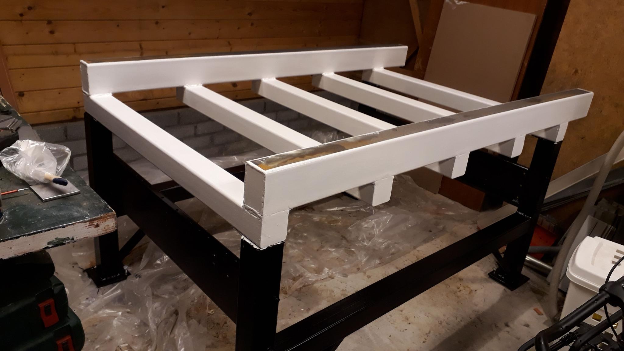

So.... i am working on z axis.
Hope to get it done soon though there is not a lot off spare time to play.
After that ... steppers belts pullies
I still have room in the design to go single or twin motors on the X axis.
I modified the motorcalcs.XLS to compensate for belt reduction 1:2 ballscrew 2010 vs stepper RPM.
Basicly 20N cutting forces @ 2300mm/min
Plenty?
5+ m/min rapids
I split the estimated total weight of the gantry for dual stepper setup calculation.
All looks acceptable in there.
So I am now half convinced twin 4nm nema23 will work ok.
But did not have no irl inertia data or torque curve for the cnc4u 4nm nema23.
uc300 has been on my mind since day 1.
Slaved x axis homing is also feature of uc300.
What questions do i need to answer to make a final choice here?
Any input is welcome .. i am not sure how to move on from here.
Grtz Bert.

Re: MK1 Steel router build log 1500x800x200
Decided and ordered.
Its gonna be 4 steppers
4x 4amp 4Nm nema23 All round : cnc4you
Does anybody have a realistic number on power needed for those?
I would like to do a dual diy toroidal transformer setup.
So 2 dual 24v transformers , dual rectifier.
dual 68volt circuit.
1 for dual x motors and
1 for the y and z motor.
Is it as simple as 2x4 Amp stepper, so 8 to 10 Amp 400 to 500VA per transformer?
Or will less power be sufficient?
1 kW sounds like a lot and ott.
I gues not many times all 4 steppers are running full throttle all the time...
Anyone?
Grtz Bert.

I would go with a 600W psu for 4 x 4Nm motors
Davek0974
Oh ok, that is a lot less then i expected..
Thanx for that.
Grtz. Bert.
Yes, you don't have to add together the peak demand to give a rating if you are using a linear PSU. For one thing, as you say, the chance that all four motors will be running at full power at the same time is tiny. The second is that the load via the drivers is more like a series of short pulses than a continuous current and the smoothing capacitors can provide this pulse load very easily, and the rest of the PSU components just see the average load. In practice, a rough rule of thumb is to calculate maximum load, and use a PSU rated at about 30% less. The final point is that because of the way the drivers work, you do not actually need a very smooth well-regulated power supply (within reason). My 68V PSU has a measured 10V or so ripple under load. This does not cause any problems at all.
These points are also why a cheap switch-mode PSU is less suitable. It does not cope with peak loads very well, so it has to be over-specified to cope with the maximum peak load, not an average load.
I use a 650 VA toroidal which replaced a 500VA transformer which failed. The bigger transformer was only a couple of pounds more, as I remember, but measuring the average power consumption of the machine, I could probably have used something smaller. That's driving 4x3Nm Nema 23 steppers, max current probably about 4A per motor.
Why dual transformers.? Don't see the point just adding expense for no gain. I've built many many PSU's and never had one faulty yet and that's running upto 5 motors.
I'd also just buy regulated linear 24Vdc supply it's cheaper. Doesn't make any difference just for powering switches or Boards etc and actually better for electronics because don't like flutating power.
You'd get away with 500Va but 625Va will give little spare current but you might get fuse tripping with inrush in which case just use D rated MCB.
Voltage then I'd aim to run steppers around 65-70Vdc. So you'll need to check your mains input but roughly 2 x 24Vac for series wired or 2 x 48 for parallel wired.

Hi JAZZCNC.
About the 2 transformers.
I didnt know a single +/- 600VA would be enough for the 4x 4Amp 4nm steppers.
Didn't want 1.2 kw setup in a single circuit.
You mention startup current, i was thinking about short circuit fires :O
I have a single fuse D type 35amp @ 225 volts in the main panel for the house.
MCB for the shop power is now16amp B type..
Maybe dedicated in the future for the machine.
I have a cable 4x2.5mm2 + PE/screen from the house to the shop at about 25 meters.
That is 2 spare wires in my book.
So when i bend the rules a little i can run the machine related stuf from a single mcb 16amps, and the lights and other stuff from some other mcb and combine PE.
Maybe i need to install some kinda peak shaving setup [emoji16] to stop the domestic equipment like water cookers an washing machines and dryers from running at the same time...
I already have a Wago 24v DC 2Amp PSU.
UB1 says 3amps .. i know maybe later ill check if it comes close to 2 amps and upgrade
Need to do some dumpster diving for relais
and stuff.
I did some checking on voltage drop for thecy cable and it looks like 4amps @ 10meters 0.75mm2 is <2 volts.
So... one might think 4x0.75mm2 + screen is about right for everything.
Also the spindle should not top 4.5 amps per wire? Quick rule says 3fase 2amps per kw.. so about 4.5 amps at full load 2.2kw.
http://www.calculator.net/voltage-dr...es=4&x=89&y=22
Or should i beef up the spindle a little.

just realise... spindle will do 8 or 9 amps not 4.5...
OK
1No. https://www.rapidonline.com/vigortro...-x-25v-88-0033
some people use 24-24v secondary depends how high you mains voltage is. I don't know what your supply is? for the primary
3 No. https://www.rapidonline.com/jianghai...-4khrs-59-6175
3 No. https://www.rapidonline.com/lcr-ep08...-clamp-11-3004
1 No. https://www.rapidonline.com/dc-compo...a-600v-47-1012
With you having about 225V mains and over a 25 MTr run you could go with 25 - 25 secondary
625 Va will be more than fine I use 500 Va with 4 3.1Nm 23's with no problems
20000uf is over kill.
cy 4 core either .75 or 1mm for the spindle

It is all in the future for me...
I am still stuck in hardware mode...
But made some progress today..
Grtz. Berthttps://uploads.tapatalk-cdn.com/201...fea1318f8e.jpg
