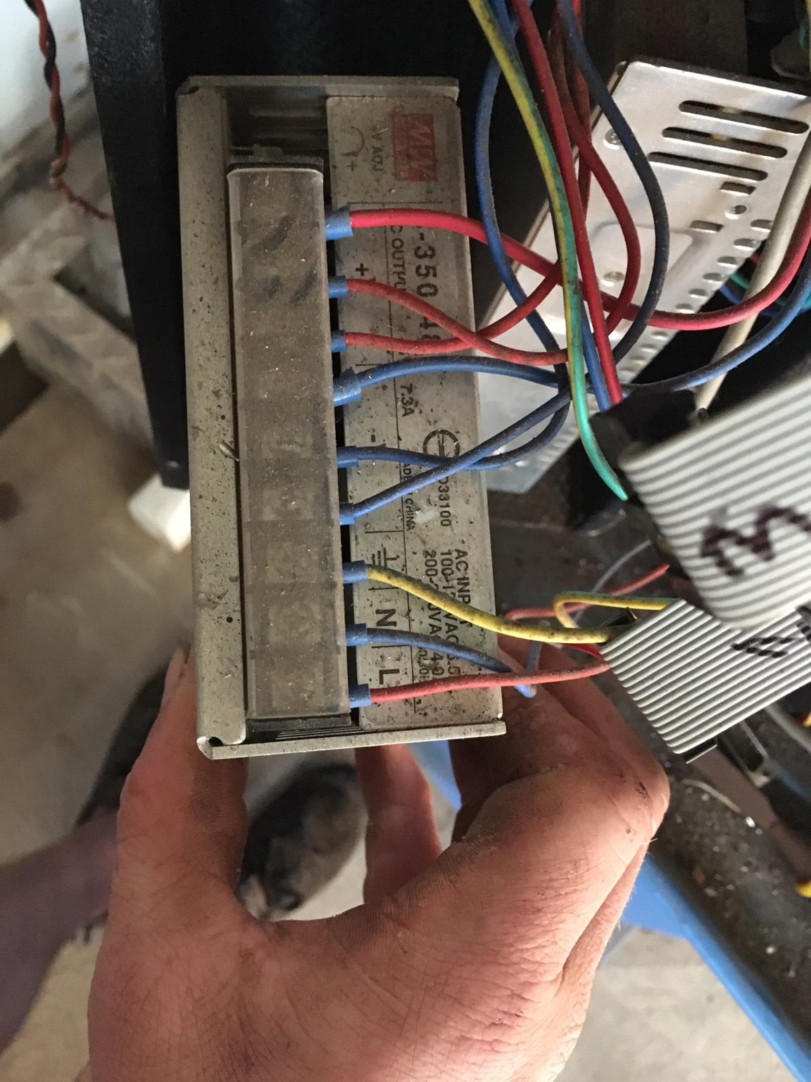

Regards the machine itself then it's very basic machine so won't be difficult diagnose any fault. However first need know exactly what you have in control box. Or better put how hacked up it's been from standard.?
In it's basic form to get movement all you need is power for bob and drives and signals from PP. Everything else can be left disconnected and replaced at later time when got movement.

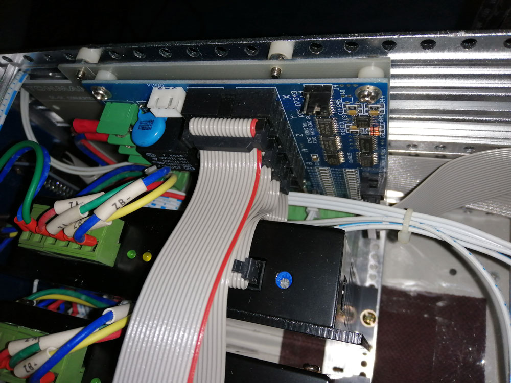

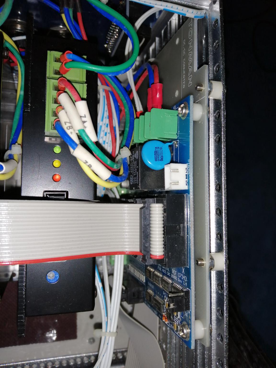

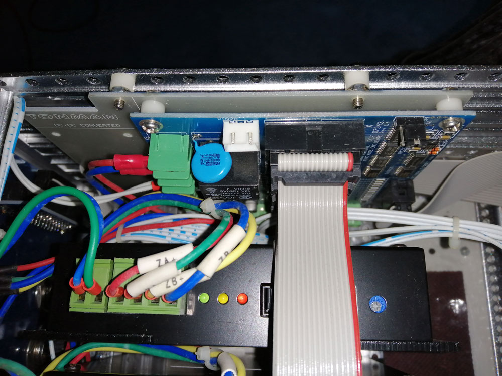

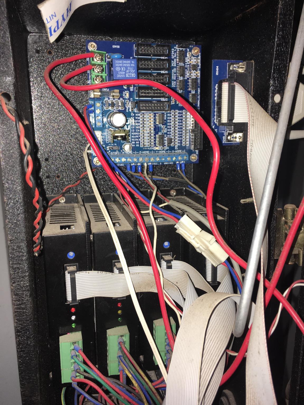

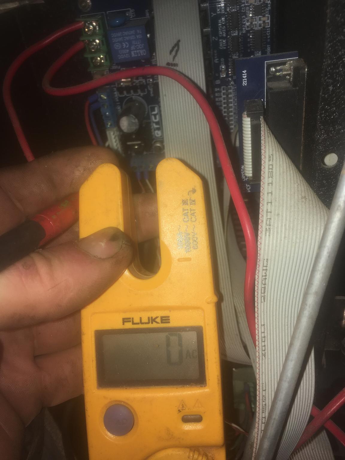

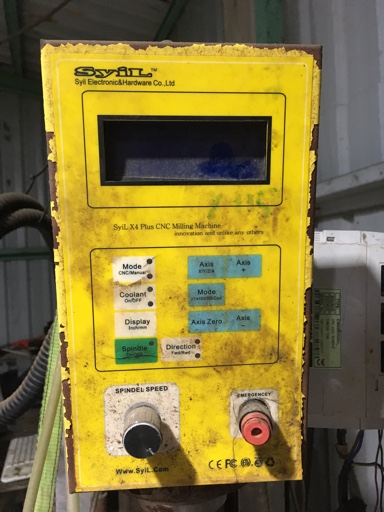

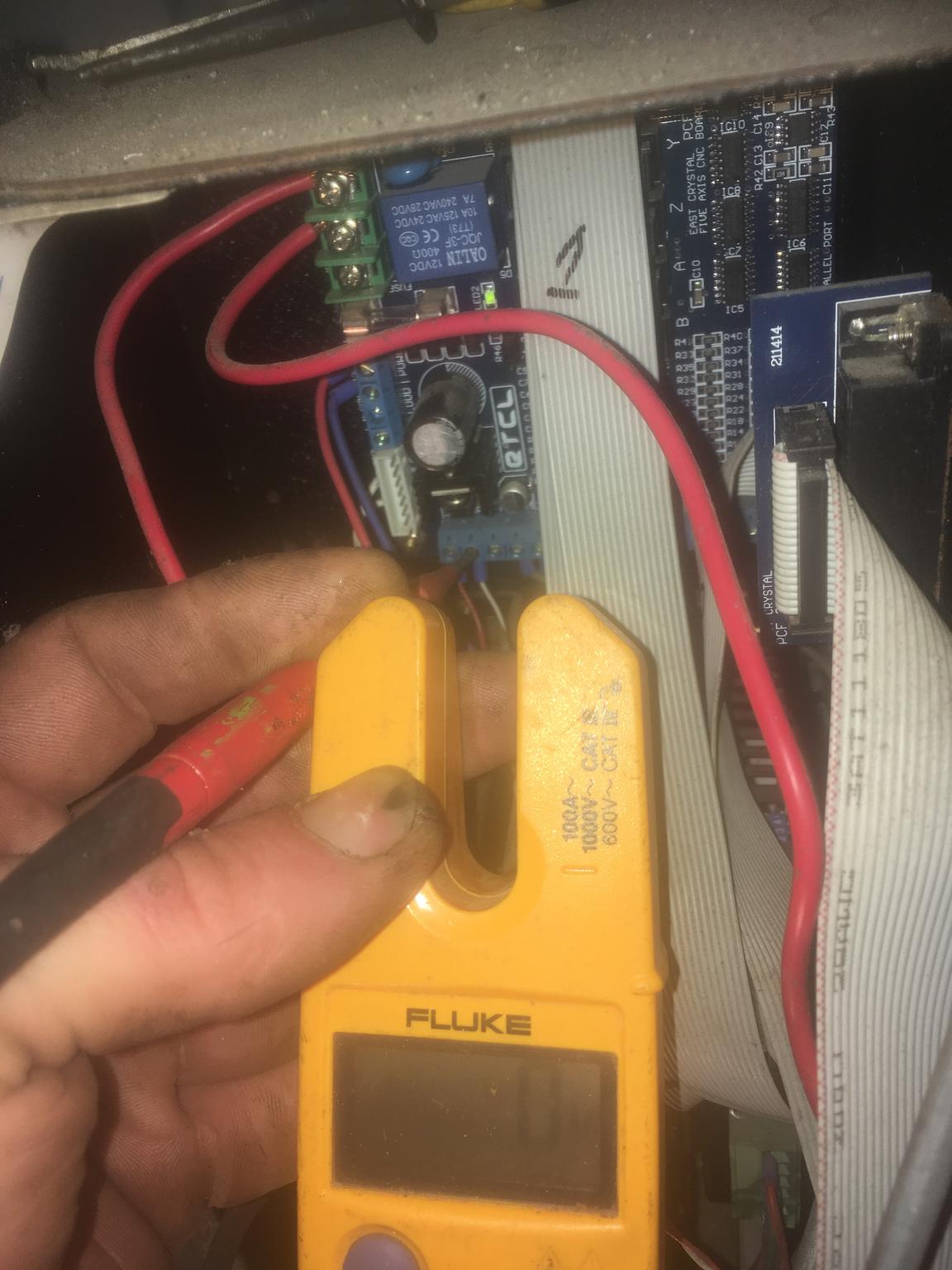

Show us pics of inside control box and each of the boards.

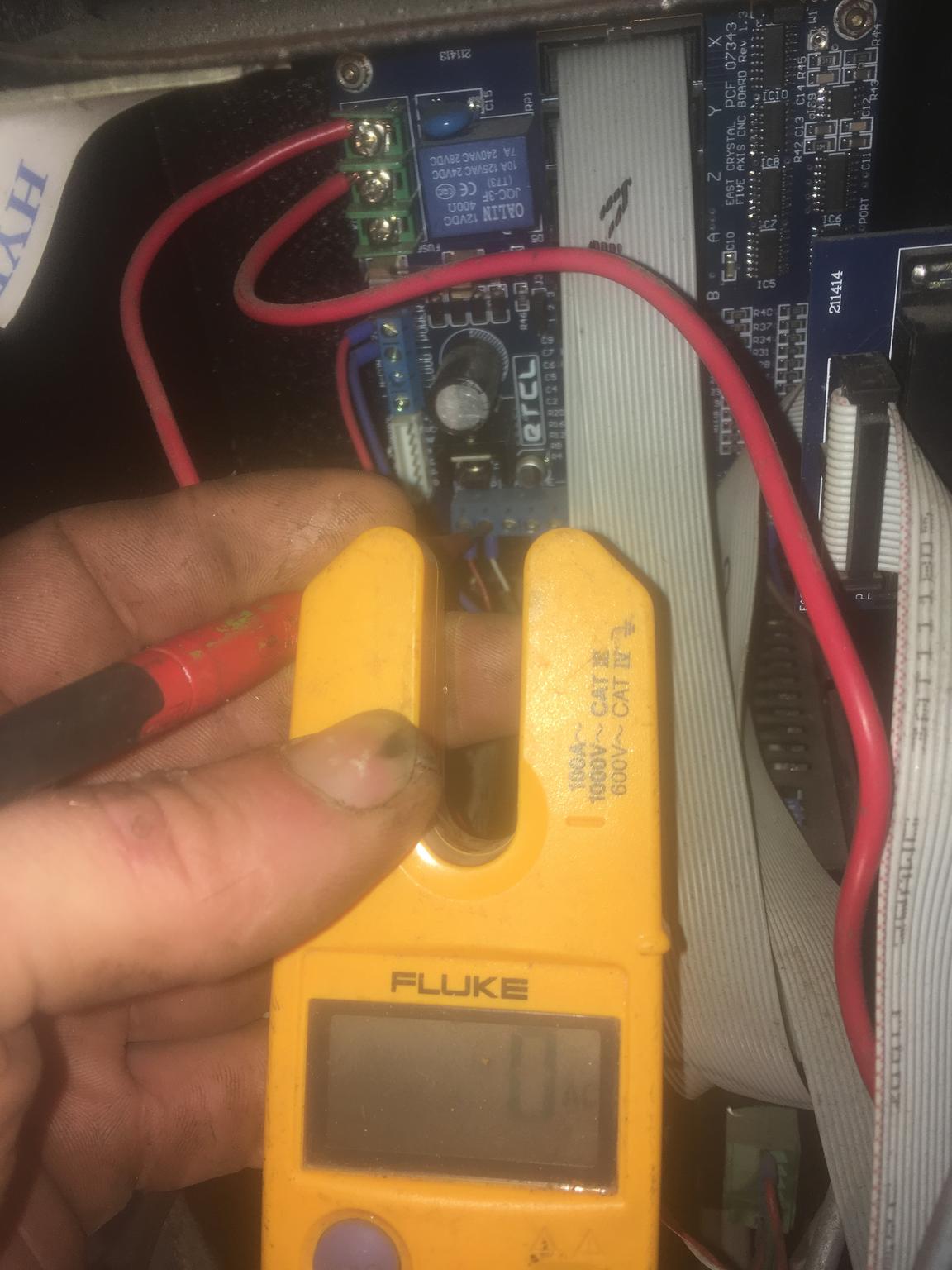

2 Attachment(s)
Re: Troubleshooting non responsive machine- Mach3/Syil x4

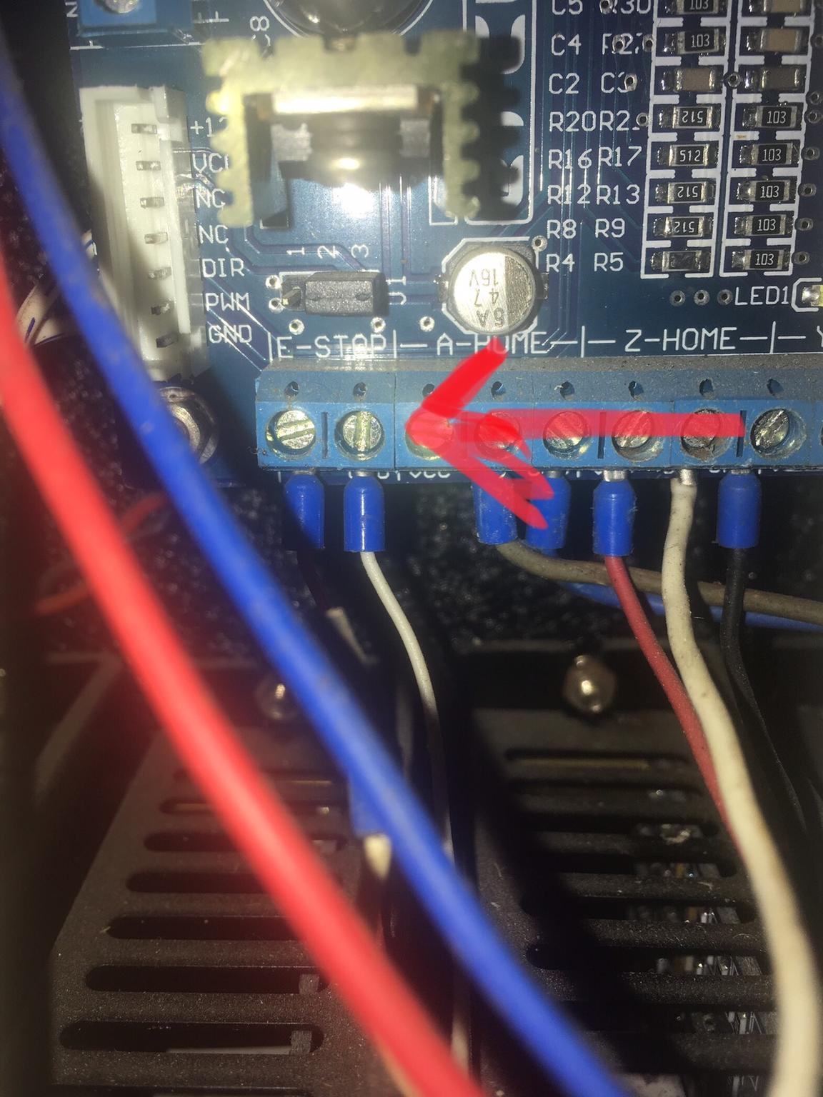

Also noticed these
Attachment 26338Attachment 26339

If they aren't modifications made since it last worked then they should be ignored as it ran fine like that previously?
It's not uncommon for manufacturers to correct a faux-pas on a board with a wire link ;-)

Ok nowhere do I see a Parallel port cable but I do see an Ethernet Cable going to what looks like a Controller board with ribbon cables going to Breakout board so are you sure it's using Parallel port.?
If it's using Ethernet then it won't work untill you set the Ethernet address and it would be Dead just like your experiencing.!
Now I have seen the pics, I get the bigger picture. The QTCL BoB is a parallel port BoB - BUT - in this case it is being driven by the PCF08094 which is an ethernet interface.
You have two options :-
Set up the Ethernet address as Jazz says (which is the better way to go!)
or plug the QTCL BoB into your printer port with an appropriate printer cable adapter like this one - If you could find one (I am not selling mine!)

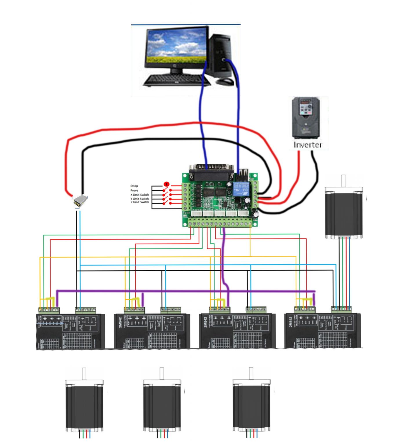

Seems it’s the breakout board - I bought a cheap one + new drivers - Am having trouble wiring it however there is life, spindle comes on when powered (can’t turn off, can control the speed via the inverter and that’s it and z axis moves up (both keys make it go up), the limit switches are now showing in the diagnostics page and if I home the machine it seems to move in all directions - Estop switch is broken and Will be replacing and the estop button in Mach3 doesn’t stop it - so I quickly pulled the power shortly after it started moving, but seems like it moved in all directions.
https://uploads.tapatalk-cdn.com/202...b8e384b28f.jpg
https://uploads.tapatalk-cdn.com/202...c2ef08c3cd.jpg
How I wired it
Attachment 27352
