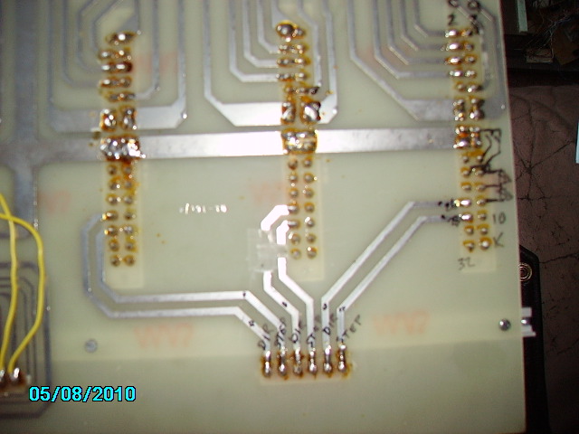

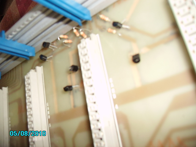

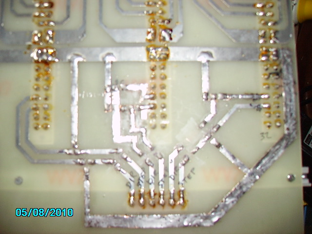

View from below Driver rack ready for Logic voltage mods.
Attachment 2558
New tracks added ready for drilling and component additions.
Attachment 2556
Solder side view with Components added and soldered
Attachment 2559
Component side view
Attachment 2557
All done, and ready for fitting back in machine...(maybe):wink:
Rick
...All done, and ready for fitting back in machine...(maybe):wink:
Rick
neat way of adding the level shifters... looking good...

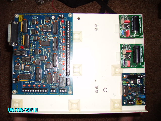

Ok the new break out board, power supplies and speed control interface mounted and ready for wiring..
Attachment 2569
Rick

This may sound stupid, but im just wiring up the drivers to the BOB and i was wondering if there were default ports used for axis, IE X=pin??? y=pin??? etc.. I do like to keep things default, as it makes things less complicated If I get problems.
Re: The illusive Boxford 260vmc
yes there are...
Typically (courtesy DIYCNC)
