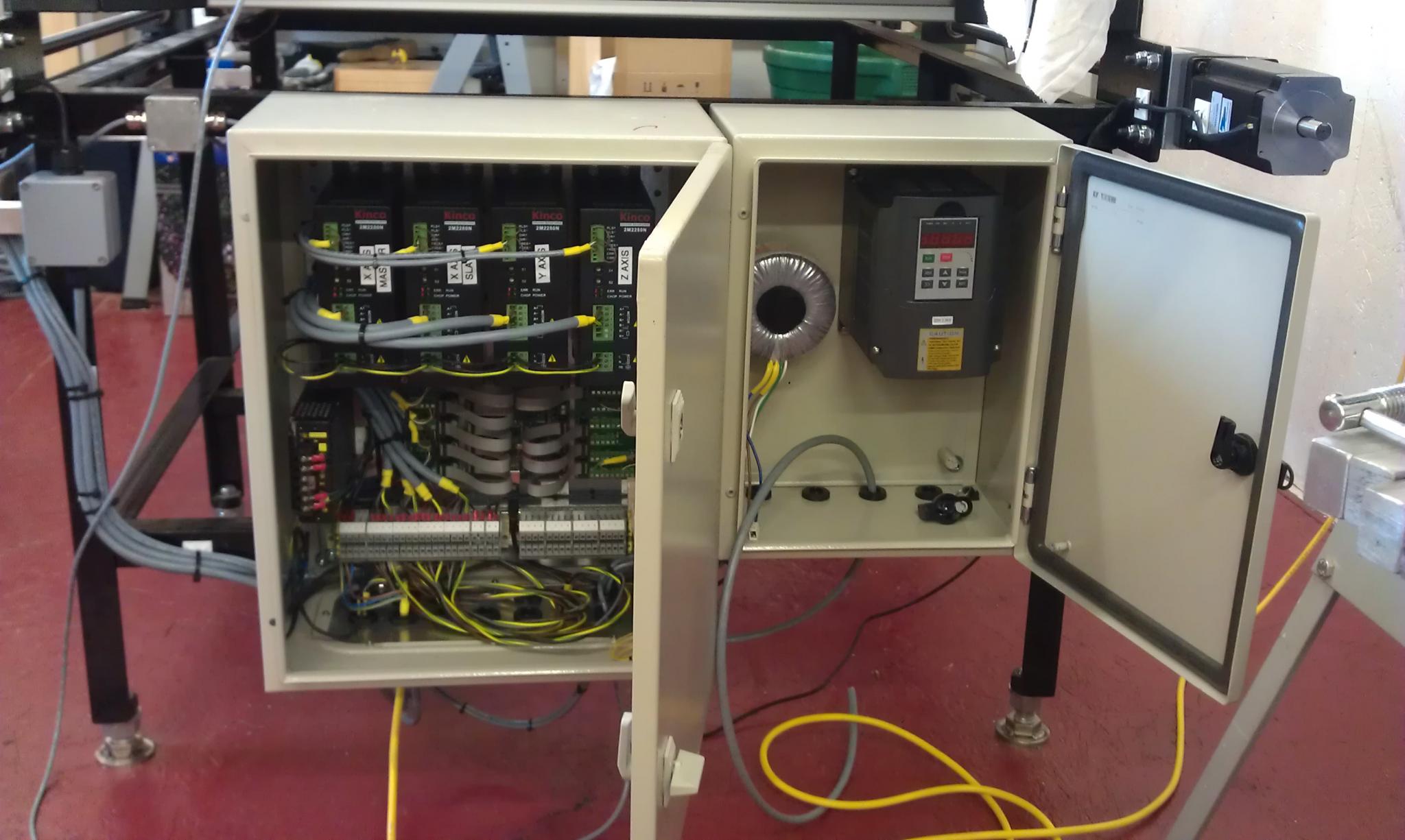

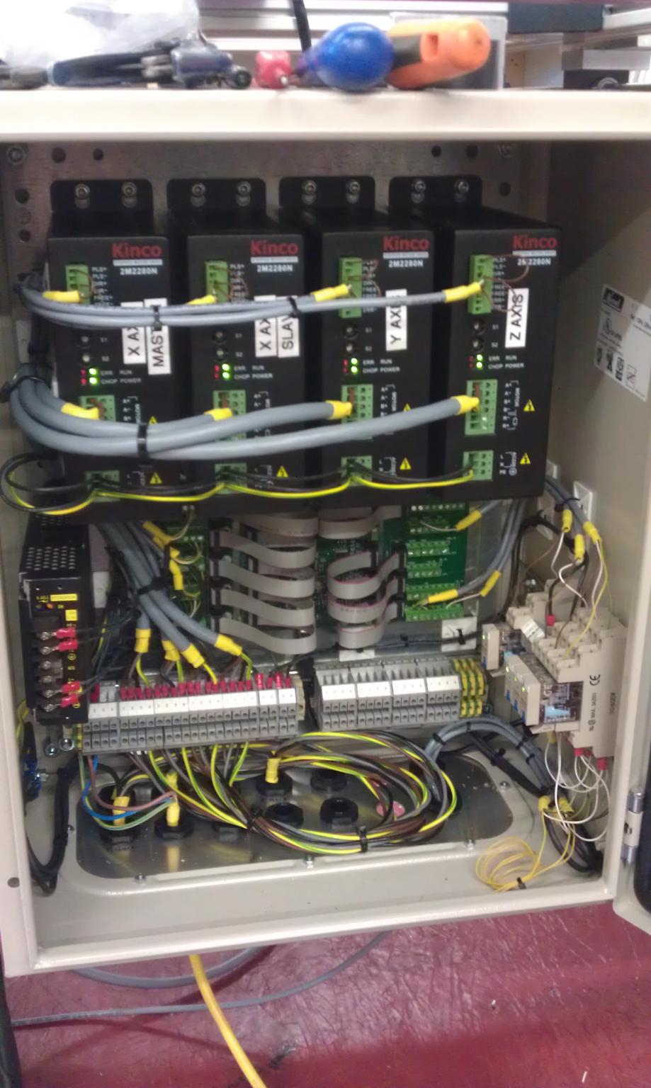

How are you finding the High power kinco drives? I can't decide between those and the normal DC powered variety, any reason you chose those?
The 2M2280 drivers run on 240VAC they run the motors at a high voltage, not sure if it is actually 230*2^0.5 as that seems a bit much. This get much much higher speed from the motors than the 'normal' 70V (or so) drives, however it will make the motors run hotter. That's not necessarily a problem - as long as the case temperature is not above about 80-90C it's fine.
I'm thinking of getting a couple to use on either my lathe/mill or router. They're only suitable for Nema 34 (or 42) motors, not 23/24. A Nema 23 motor with high inductance might be ok... but with how much those drivers cost that's probably not the best option.

Andrew, the kinco drives are good. I have Nema 34 motors on them and they are fine. The only problem is that the drives generate alot of heat but a couple of cooling fans will take care of that.

Thanks for the info,
I'll probably go for these as I won't have to buy seperate power supplies (I'm going to be using the 8nm nema 34 motors)
Did you mean the drives themselves generate alot of heat, or that they cause the motors to get hot?
It's probably both - running the motors at a high voltage tends to make them hot, but as long as it's below about 80C it's not a problem.

Andrew,
the motors get warm to touch but nothing bad. The amplifiers do get quite warm so if you are going to mount them in a cabinet forced cooling would be required.
