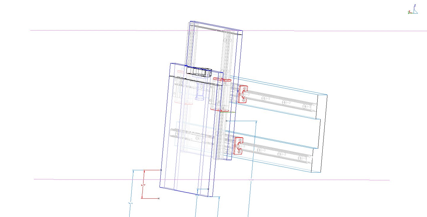

Right now trying to figure out how to use IGUS chain (or something like it) in the space I have to use for protection of the power/control cables to the motors and the spindle. I can fit it no problem. Problem is figuring out how to mount it. My error, though not a large one and from what I am seeing correctable.

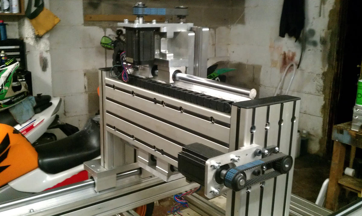

Well here is some very good progress photo's and things are moving forward. Jazz, you're doing a great job and thanks.Attachment 5173Attachment 5174
Will get more up as able.

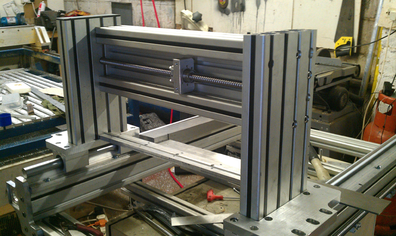

Well folks we are on the home stretch and Jazz is doing great. The design has gone through some minor changes, but is pretty much on track for what was designed. Now the important part the pictures. Side note there are only 2 plates left to cut and 2 extensions to cut for the NEMA 23 shafts for the pulleys.
Attachment 5184Attachment 5185Attachment 5186Attachment 5187Attachment 5188
The HDPE you see the Z axis resting on is 15 mm thick and will be about what I am using for bed material. Right now discussing whether to mill in slots or just drill and tap it. The bed will be either HDPE around 200-250 grade or UHMWPE and looking at a couple of options on how to set that up. Need to get one more piece of energy chain for the x axis. I on the other hand am testing the BOB that I have done the work on to make the A axis work with the X and going to make sure that is all good and need to get the shielded wiring for the switches and most likely will need some more shielded 4 core for the motors as will need longer leads.
Also getting g-code ready for a couple of jigs and such as will be busy right from the get go once it is up here and bedded in. Again a very big thanks to Jazz for all his work:toot:, to James and Luke for the X axis supported round rails:tup: and for all the other folks that directly or indirectly aided in this project.:toot:

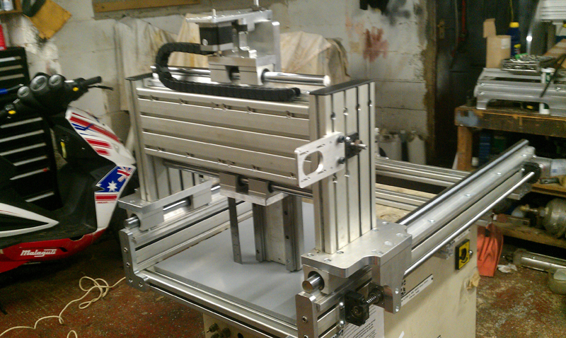

Well,
It is done to the point that it is now coming up here and the wiring, bedding in, last section of energy chain install, and tuning will be getting done.:toot:
Baring something going wrong (touch wood/iron) that will be this coming wednesday, after which all the above will be being done and then a whole bunch of chips are going to be getting made. Big Big thanks to JazzCNC:toot::toot: and also to James and Luke for the rails:toot: and all other folks who have helped and/or encouraged along the way:toot:.
It is sort of funny as I am smiling like crazy as I am sick as a dog with an upper respiratory infection (on antibiotics and hopefully will be better by the time the machine gets here). Now just last bit of cleaning up (funny how work surfaces attract clutter:joker:). Now it is just doing the little stuff and waiting for it to get here.:naughty::dance:
Oh here is some pictures and yes the X axis is not attached as that is going to be unbolted from the carriages for transport up here. Now to be a patient lad :whistling::joker:
for the few days left to go.
Attachment 5337Attachment 5338Attachment 5339

Thanks Jazz and all the folks who helped with this build. It arrived today and I got to meet Jazz in person finally. Great guy, kids loved him. Now I am wiring up the mill and going to be setting up the limit switches and such as well as setting up the electronics. I will get pictures of it in the shop up later tonight (getting the on machine wiring boxes cut and able to be placed.
Michael
Whose a happy boy then?:tup:
bruce
I am coughing hacks included. Went out with Mario (My oldest son, for folks who don't know him) and got the some of the parts I need and hair cuts as we both needed them. Got back home and started working on things and then the hacking got worse from doing to much today so up in the office doing other things I can do. And here is the pictures I promised earlier:Attachment 5359Attachment 5360
A good sized machine that fits as snug as we designed it to and i will be bolting it to the table as that gantry has a good bit of mass and it is going to want to move when i get her up to full cutting speed. Well folks going to rest as this hack is not nice. I will try to get a few better done photo's in the future but the machine takes up a good part of the back wall as both Jazz and Bruce can give witness to.
