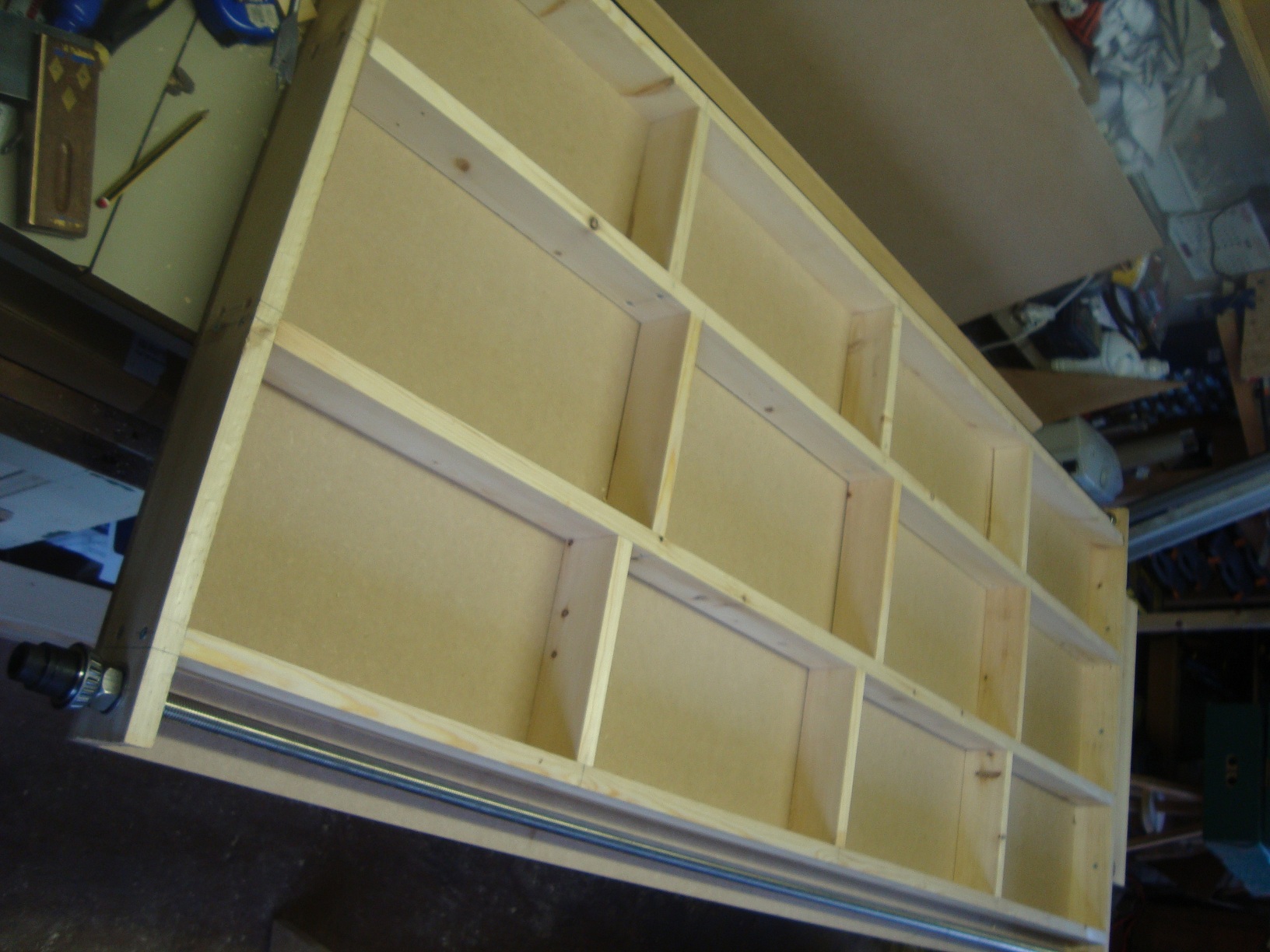

If you use the MDF torsion box mounted between a steel frame like I do now you'll have a very rigid machine:
Attachment 5253Attachment 5254
Mine is 18mm MDF on top, 9mm MDF underneath with 3x1 PAR pine in between ... convenient sizes at the time to fit the leadscrews inside.
Part of the reason why is you can make it so the height of the bed is adjustible, so you can still machine tall parts without compromising the rigidity (due to large overhang) when machining sheet material. That is also where the Z-axis design you have now drawn with the rails on the spindle plate is significantly stronger - compare the distance from tool to linear bearing blocks.

4 Attachment(s)
Re: Definately a scrapyard challenge
I know what your thinking, here's another of those that start a build log but do not build.
SURPRISE:yahoo:
I have started the rebuild. I have put registers into the top and bottom plates of the z gantry and started drilling and tapping to connect. The I used my home made
under the bench router table. I know it will not be with a tight tolerance but I kind of got the urge to do as much as I can on my own. That said its thank you to Jonathan for a fine pair of ball nut brackets and spindle mounts.
Do not expect this to be a speedy build. As you can see I have done 3 bolts so far.:whistling:

3 Attachment(s)
Next step is the y rails. I routered out a register and then did it again. The rails edges are rounded and I did not go deep enough. Hopefully not to much wrong this time. Next will be drill and tap the rails in place.
Bruce

Bruce Having a register to work from is good idea BUT Becareful it can bite you with round rail.!!. . . . The base edge of round rail is often not very straight (Or Flat) so carefully check that
1: It's straight
2: The distance from rail to Edge is consistant along it's length.
If it is straight and consistant then you can work from the register when setting rails parallel if not then work direct from the round rail.
Thanks for the warning. My intention is to get as much straight and parallel as possible but when setting out the various components I will use a dti on the important surfaces.
Cor if i new what i was doing i would be dangerous:naughty:

quick update. Y bearings are in and the rails screwed into the box. I clamped the ends just to push it back and forth and thankfully there is no hint of binding. Mind you I am sure you will tell me what I have done wrong....:joker:
Bruce
Just thought you might like to be updated. Thankfully shimming will be at a minimum as most of the crucial measurements seem to be reasonably close less than 0.1 degree.
Still got to add pads to the base of the sides and bracing on the back.
Bruce
In case your wondering I have made sliding fit pads for inside the box. These have been threaded so the tie bars although going right through will not stress the box. Once I am happy with the build these pads will be locked in place with bolts.

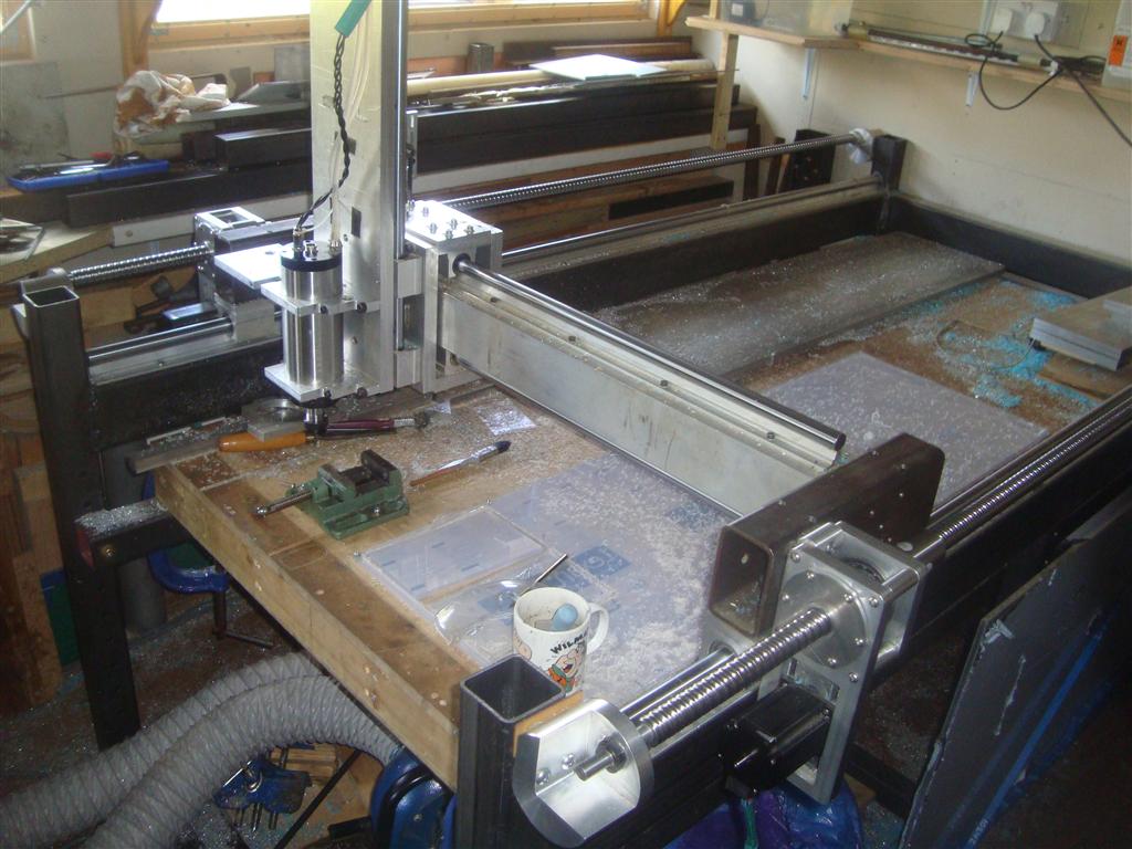

2 Attachment(s)
Next update. Its now a rolling y chassis. The mounting plates above the x bearings will be cut down to size after i know where the ballnut bracket will be located. It does not look much since last time but I must have drilled and tapped 50 or so holes.
If all the limit switches are connected in series would it make sense to mount them all on this gantry as this would mean only one cable going from the gantry to the control box?
Yes With a bit of care and planning it's possible to use just 1 switch for each axis all wired in series. Doing it this way then yes it's possible to mount them all on the gantry.
Basicly you need some kind of ramp or bracket either end of each axis to trip the switches.

I take it that these switches are homing at one end and limit at the other? Or are homing switches separate?
You will notice that i am entering another area of simple and possibly obvious questions. YOU HAVE BEEN WARNED!:smile:
Just to let you know that this build is not dead I am thinking about the base. Steel box is 50 x 30 and 100 x 50. I intend to fix 10mm ally plate on top with an overhang that will support the screw/ motor. and give it some protection from debris. Therefore the rail and screw are fixed together and the critical factor should be lining up the left and right plates. Fillets will be added on the build.I really ought to start setting up the electrics now but this part does make me a little nervous so listen out for some stupid questions soon. :confused:Bruce
