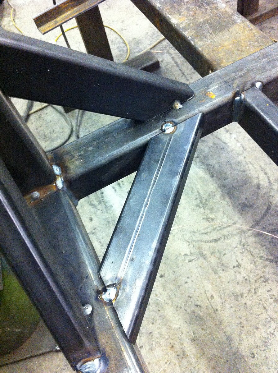

Apart from looking nice, I'm not convinced these types of bed frames, with massive members, need to be fully welded at the joints, from a stress point of view anyway - stitch welding would be perfectly adequate - having said that, the effect of inducing bending due to weld shrinkage is possibly only noticeable on smaller dimension square hollow section, less than 70mm say.
Charles Very true regards Stitch welding being plenty strong enough if done correctly but even larger dimension SHS will distort if the heat put into it is too great. Spreading the welds around and keeping the bead length down to a minimum is very much needed with any size material if distortion is to be kept to minimum.
I've just got my self a New 250A AC/DC Tig welder with pulse and I love it for just this reason as the heat is kept very isolated to small area. Fact I can weld thick Aluminium plate as well as thin Aliminium plate is lovely as well.
Re: Sturdy and Fast all Steel CNC , my first build

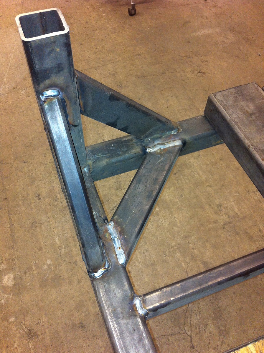

Any chance of some advice on best welding strategy for welding novices like me? Starting with the assumption that we are welding box section (I'm probably talking 50x50x3 in my case), what's the best way to get an accurate frame that's not going to distort as you add bits on? I'm starting to hear things like tack welds to hold it all together, then add more tacks/spots for strength, but continuous welds at the joints are not needed.
Specific example - you are welding two pieces of box section that meet as a Tee. Couple of spots on the "internal" corners so that you don't pull the pieces out of plane, then tack the sides, then add a few more spots for strength?
I'm guessing that all this is blindingly obvious to an experienced welder but I get the feeling that a lot of people cut their welding teeth for the first time building a router!
Erm, I don't have vast practical welding experience, but I'd say two decent 30mm long 3 or 4 mm leg fillet, i.e. one in the middle of each of the 2 flush butting sides of that joint should hold it good, for strength - just weld through (over the top of) any tack you've put down. I don't see any point welding round the corners or trying to fill the whole void in where the square cut end doesn't meet the radius edges of the mating member - doing this is just adding loads of extra heat and metal that isn't doing anything. The important point about tacking together is to set and maintain the WHOLE assembly geometry before laying heavier deposits down, so if you have any gussets orbraces supporting the ends of your T assembly, IMO they should be tacked in after the T is tacked together but before putting the structural welds down.

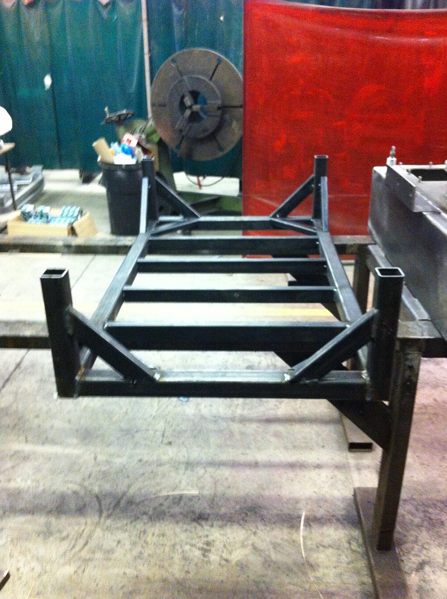

7 Attachment(s)

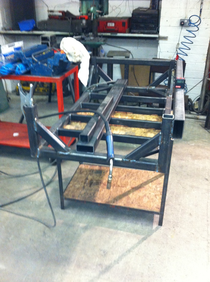

I'm no expert (I seem to weld every 4 years or so) but what I did was cut the pieces to length, dry assemble the uprights and the main frame outer pieces then put either one tack or a couple of tacks on each piece.
Attachment 11529
Then I got a square and spirit level and made sure all was as good as I could get. I then tacked in the bed braces..
Attachment 11530
I then checked all was square again before starting to add the angle braces...
Attachment 11531
I then checked that the uprights were still square and all was good and then started welding the uprights. Now here I confess I didn't do it in small short runs spread out round the frame like I probably should have. I just did it in one or two runs per weld (50mm long welds as using 50x50x4 box)
Attachment 11532
I then checked to see if all was still square (otherwise the angle grinder would have to come out!) and then proceeded to weld up the rest of the welds. I didn't do it in any particular order (it was pretty random) and then after finishing the frame (but without the X axis rails welded on) I checked all the frame was still level and the uprights were still 90° to the bed.
Attachment 11533
I then offered one X axis rail up, clamped it with F clamps roughly level and then referencing off the frame rails and tacked it as parallel (using a digital bevel box) as I could. I then put lots of tacks on it, checking in between that it hadn't moved, and then once cool I welded over the tacks in one go.
Attachment 11534
I then did the same for the second rail checking for parallellness (is that a word?) in both directions with the first rail as a reference but also checking the second rail against the frame to make sure it wasn't out. I then did the same weld procedure for the second rail and it turned out pretty square and parallel....probably more from good luck than skill!
Attachment 11535
To be honest it's not rocket science but the Welder your using does make a difference to some degree.
Arc or MMA welders put a lot more heat into the steel than Mig or Tig so it's a good idea when using Stick to keep runs shorter and spread them around but keep balanced. By balanced I mean if you weld Left side of material for 1 " then weld right side 1" at same time before moving to another spot.
For general steel work then Mig is best has it's relatively quick and easy to learn but it's not has cheap has stick to buy equipment.
Tig is best for controlled heat but it's slow and more specialised and expensive so I wouldn't use it for steel frame work. (unless using MMA option)
Just for building a one off frame and keeping costs down then MMA(Stick) is best has it's cheap to get setup and not too difficult to learn.
Just remember bird shit can be scrubbed away so tis is true with welding and grinder is your best friend. . Lol
Welding and Epoxy leveling make steel frames very easy and cheap to achieve.

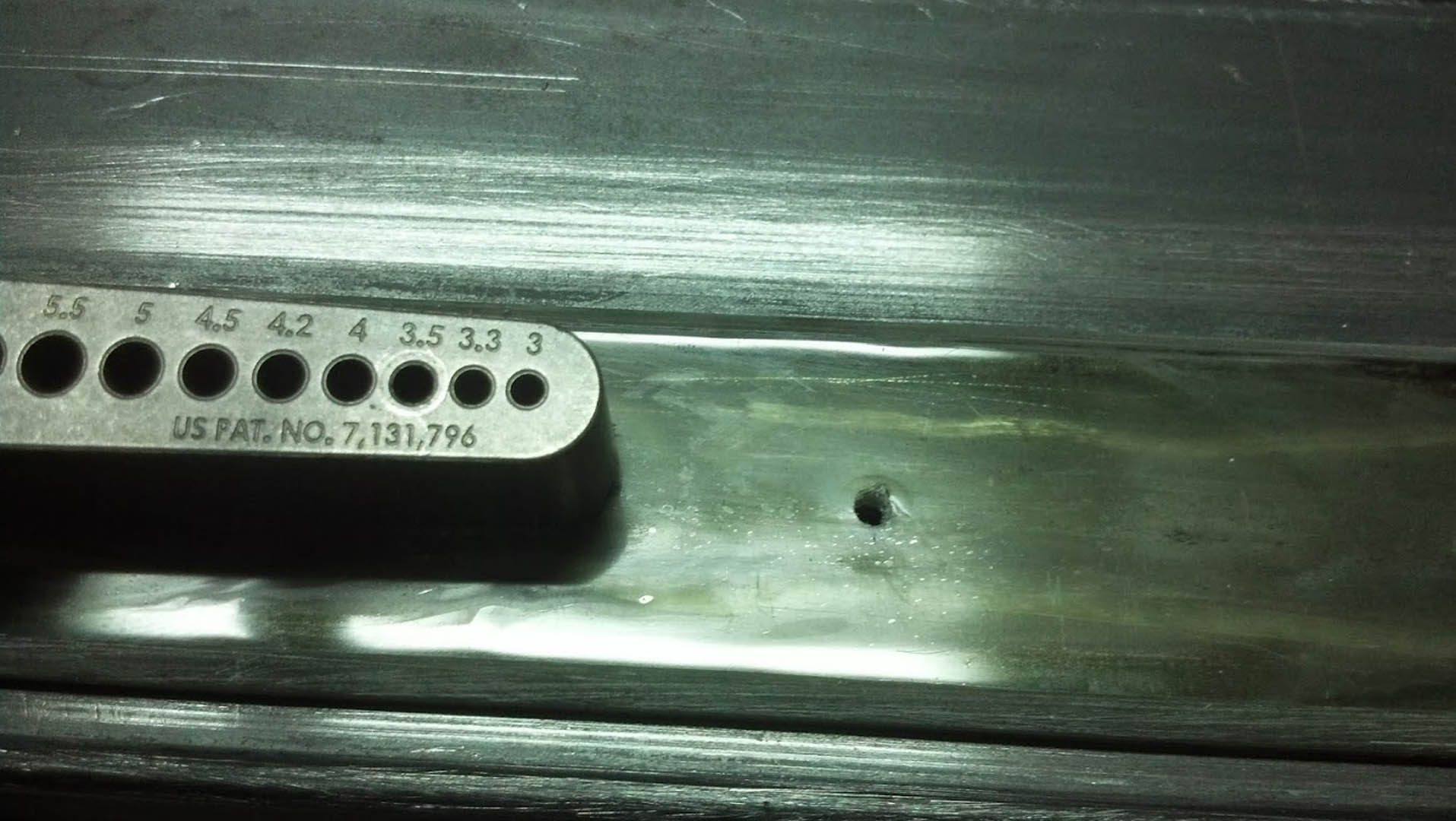

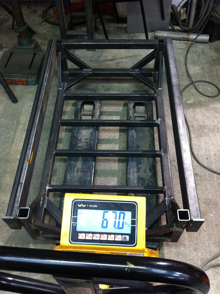

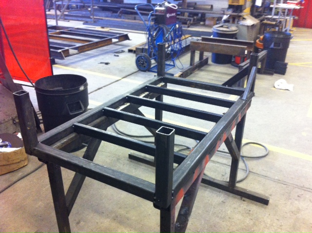

Hi there,
I would like to point again that the further i go building the machine, the more discover how important and later time saving was to weld the whole machine with under 1mm, even possibly under 0.5mm precision.
I would like also to remind you that i welded the machine fully, but it took like more than a half of day, due to waiting things to cool and the having in my left hand the IR remote thermometer, controlling that the overall temperature of the frame and gantry stays under 60C. So any change of dimensiones was successfully avoided.
So if you don't have thermometer at hand, just wait untill cool to the touch. And no more than 2 inch at once, always mirroring.

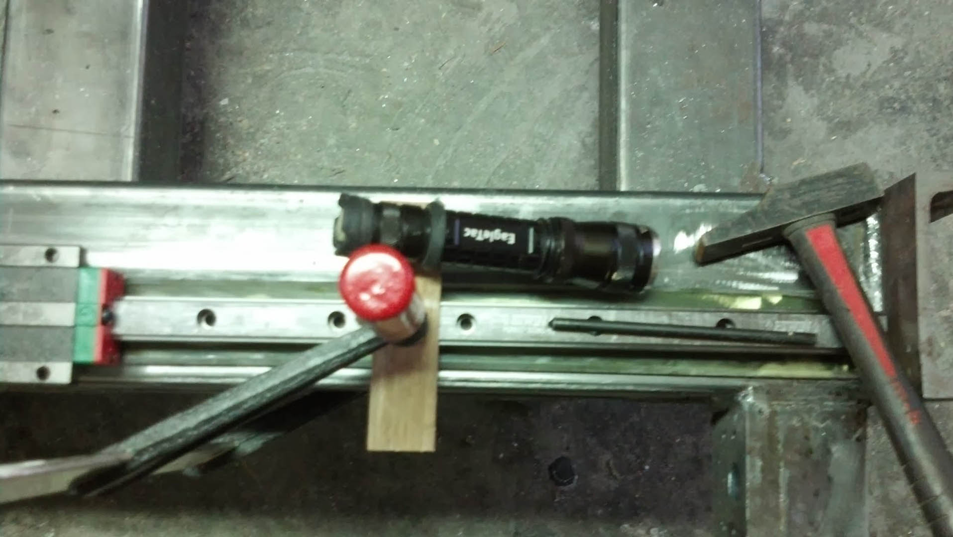

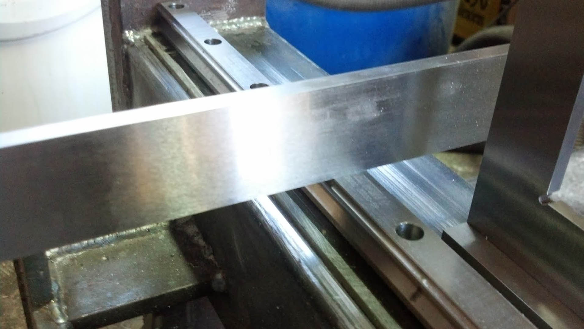

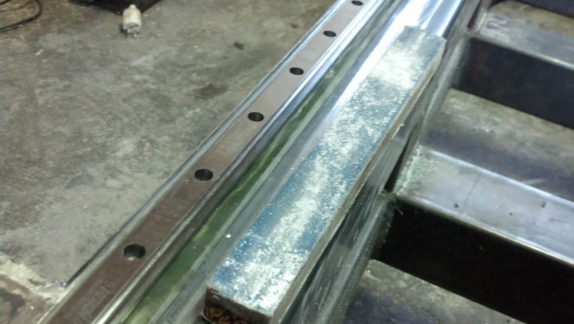

Here is some more progress in details.
The Hiwin are wide 20mm, i made the epoxy 40mm wide, hence-10mm each side. Thats should be the proper way. The meniscus took like 3mm at least.
So how i dealt with the meniscus? I decided i would not waste time on it, so i glued sand paper to a stick and started sanding it off. Not completely. I decided i will mount the rails and then continuing with epoxy leveling the gantry rails and side supports.
In other words dealing completely with the meniscus is a waste of time. The process took me 20 minutes, the epoxy sanded like a snow flakes. 20 min more for the end of the epoxy, where the end of the rails would be. here i checked with straight edge and scraped a bit the last cm.
It is a very good idea to stuck a tape over the middle of the epoxy, where the rails would be, as not to scratch it!
Attachment 11542
Well, it seems it worked as supposed. The epoxy i mean
Attachment 11543

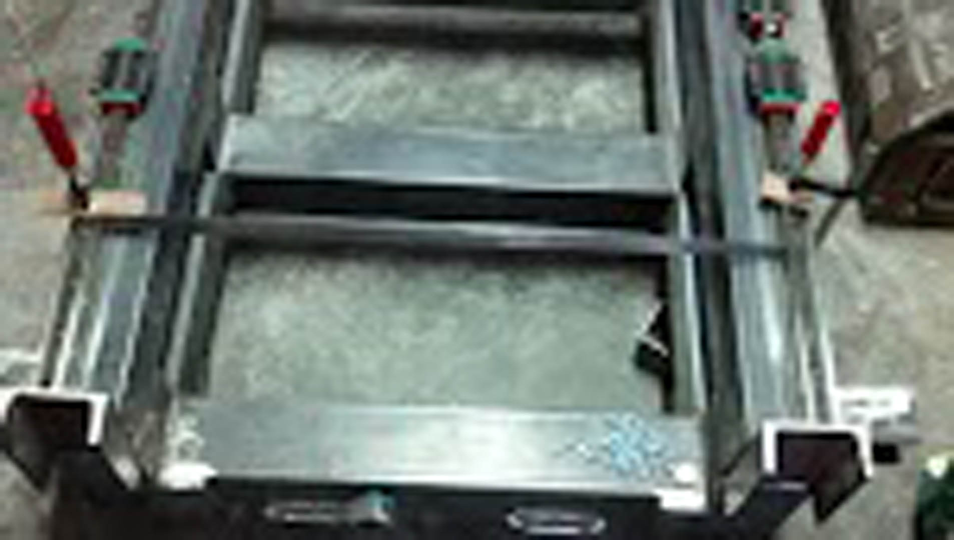

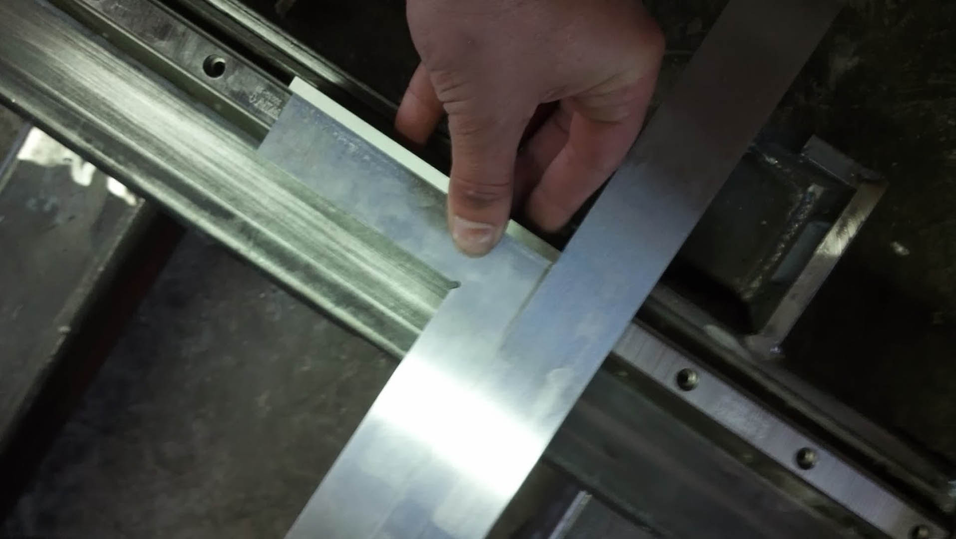

Buying the precise 1m straight edge and precise square was a very good idea. In a matter of minutes i placed and aligned the rails. I would say that its crucial .
Both cost around 100 euro and a week research , see here: http://www.mycncuk.com/forums/tool-t...-straight.html
Attachment 11544

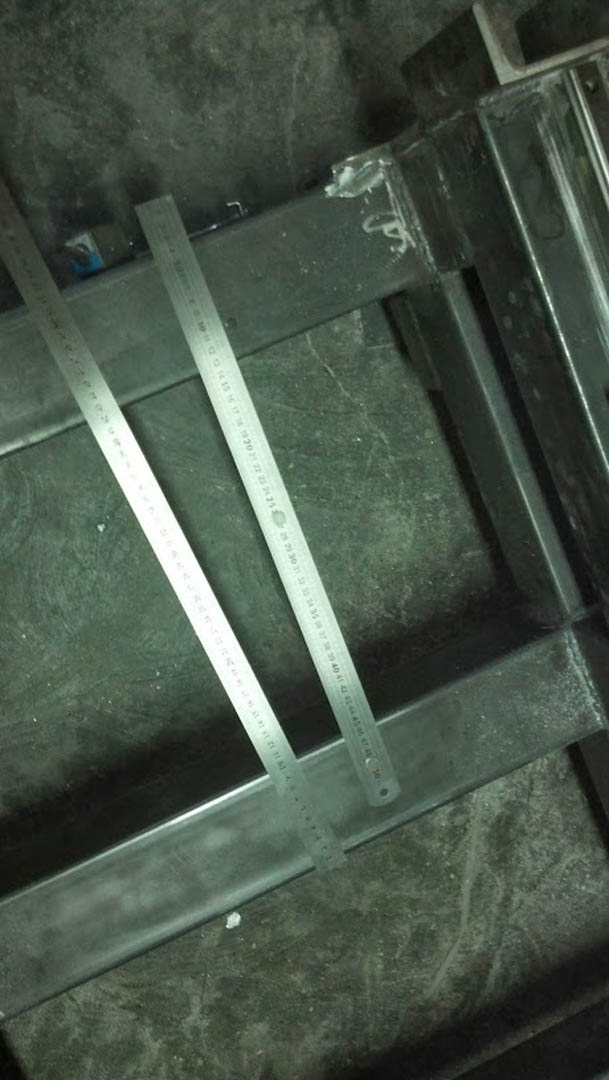

Once in place and squared i rechecked them using a long steel ruler made from 2 rules and magnets, which i fitted inbetween and checked at both ends. Tight fit as expected. I supported it with alu beam so it would not bend/ like in the picture, while i was making the shot/
Attachment 11547
Attachment 11548

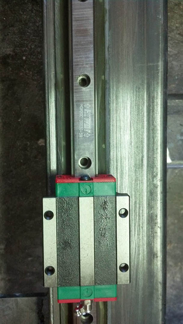

Just a side note here. Forum is ok, but read the frigging manuals. Hiwin rails have direction, also the carriages/ its not seen on the pic, but the letters should be at the side where the arrow points to/ . have that in mind, is buried somewhere in the long manual.
Attachment 11545
I was tired and working after work. But i wanted and started to feel a kind of satisfaction not being in a hurry and doing things right. So instead of drilling through the clamped hiwin rails, i used a hole transfer tool lightly using the hammer. And a torch, to see better.
Attachment 11546
And as i started to feel that satisfaction, i decided to continue accordingly the process, drilling first 3mm holes, using the very handy tool to keep them vertical.
The torch helped again to see things , illuminating the epoxy from below.
Attachment 11549
Some holes and here is what happened. I had to go for a new drill, as it seems if the drill is not perfect, it adds heat and the epoxy lifts around the hole. Not a big deal, will scrape it with a small straight edge. The epoxy scrapes nicely, as i said-like snow flakes
Attachment 11550
Now i am waiting for a new brand M5 tap and the bolts for the Hiwin to arrive. I wouldn't risque with the cheap tap i have. I bought them from internet as it seems that screws are quite expensive locally.
Thats all for now.
Obviously section 1.10 of the Hiwin manual is the 'correct' method but if you don't have the gear . . .
To mount rails similar to yours, I first clamped a straight edge along the top with the edge parallel to the beam and for the Hiwin rail to be in the centre.
Then I clamped the Hiwin rail to the beam making sure it was tight up against the straight edge. The holes in the rail are about 5.5mm diameter so I used a 5.5mm drill in every mounting hole to make a dimple in the epoxy similar to using a centre punch. This allowed my 4.2mm tapping drill to go right through the epoxy and beam, all central to the Hiwin mounting holes. The other rail was mounted in a similar way but using a DTI gauge to keep them parallel.

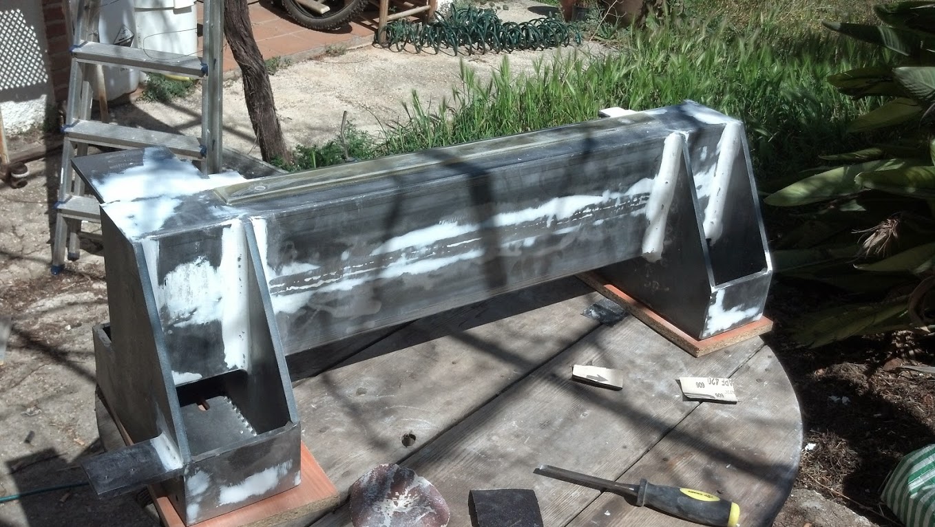

yes its been a while. I am not the fastest builder around it seems :redface:.
Basically what happened is that apart from other jobs and orders on my small machine, i had to change house , and it was 3 weeks madness. Now i am happyly suited in a new house with a proper garage/workshop/ so from 2 weeks i am continuing the build.
Here is what happened in short / only problems :chuncky:/:
1. Mistake one
I bumped the frame a couple of times when i was trying to reach the washing machine. So it moved a bit. As i wanted perfection in leveling...Only if i had hot glued the legs to the floor :anonymous:, this mistake will be not repeated again. So here is the solution. Again pouring epoxy, this time on my soldering jig. Waiting , fixing, pouring again, turning around, pouring. It took some time. A week.
Attachment 12395 Attachment 12396 Attachment 12394
2. Next mistakes
Then when the epoxy on all necessary surfaces on the gantry was dry enough, i decided to open the holes necessary for the bolts to hold the gantry to the bearing blocks.
WOW, another mistake. The epoxy chipped and the drill bit unglued the first of 4 epoxy plate from the gantry. Now i was worried. So i marked it and cut the corners as seen in the photo. I marked all others with numbers and crossed lines and using Dremel filed the corners. And...everything unglued. The good thing was that all was marked so i knew which is which and where it has been exactly. So i finished them, cleaned everything and using instant glue and pressure/clamps fit then where they have been.
Perfect fit, the glue squeezed equally , checked with the straight edge, well it was perfect. Hell, i was worried, and the epoxy was starting to finish :greedy_dollars:
Attachment 12397 Attachment 12398
3. Painting problems
I actually bought a car paint. But as it was quite expensive i decided to base coat with anti-oxide yellow paint meant to be painted directly over the metal.
I found the following things:
-successfully painting small things doesn't mean you can paint a big thing well at home :toot:
-having pro HVLP gun doesn't help if your compressor is small and you want to paint big things. Not enough air.
-having smaller airbrush type gun doesn't help either
-not having dry filtering, i mean real dry filter on the air line , means bad things happen...
-painting yellow is a mean thing, really mean. 3 liters of paint. Well i sued a roller at the end, as otherwise i had to paint it a whole week.
in short-painting is not my strength :-)
Attachment 12399 Attachment 12400
4. Bolting the gantry to the frame and aligning the gantry rails.
Needless to say - a lot of problems.
a/ First to say i have dry bolted the gantry before painting all. It was ok. So what was my surprise when everything was painted, the machine fixed on the welding jigs for comfort and the gantry will not fit. So i called a friend that helped me and 3 times i had to lift the gantry and lower it, mean while widening the holes. The reason. This is crazy- the machine is outside, the sun heats the frame and it widens. cause i made the machine in the winter...
So basically now i cover all the time it so it could not heat . My garage is small i mean to work inside.
So at the end i squared perfectly the gantry and bolted it
b/ Now next unsuspected problem. How do i fit the rails on the gantry to be perfectly square with the long rails on the frame? I knew i could do it somehow but in reality it was a big challenge.
I know how to do it if say i make 10 same machines, a fixture and no problem. But how to do it on the cheap. Cause this machine really ate a lot of money spend on little things.
After a lot of thought i fixed the straight edge perpendicular to the base rails and decided to start with the upper rail first.
Once the upper rail was square, there came the problem with the lower rail. A friend of mine says we have all necessary stuff always at hand. So i was in no rush, thought it a whole weekend and just have done it.
Another difficulty was that i do all alone at home with no help, so first i more or less squared it using clamps and then drilled and tapped 2 holes only. Then aligned and bolted until happy. Then drilled the rest of the holes directly on place and bolted. Photos speak better than words how all of this was done.
Of course i managed to chip the paint here and there so it seems when everything is working i have to retouch it at the end. No big deal.
2 equal pieces of aluminum square bar were used to fix more or less the correct distance to the upper rail.
Attachment 12401
Both were precisely squared to the straight edge which was squared to the base rails. 2 pieces of rail were used to support them, a kind of parallels . Not seen on the pictures at the end only one was used at both sides so to make sure the fit is perfect and is really squared.
Attachment 12402
Holes were marked, 6mm drill used to clean the epoxy so it will not unglue or raise during drilling the beam, then 4.2mm drill to make the holes and then tapped. With the help of the nice little block i have.
Attachment 12403
On all drilling and tapping the gantry was clamped so it will not move around. here is the fixture which helped me align the lower gantry rail. Dont laugh at my square, had to clamp a rule to make it longer. I said we have all we need at home, just some imagination is needed.
Used thickness gauge though to align it perfectly /yes i love that word/.
Note should be taken here that when i bolted the 2 plates from the Z i pushed them from behind till they touched the screws, so i know they are alligned to the bearing blockes, as the holes are laser cut. I mean because of this i am sure that their edges are parallel with the corresponding rails. Later i will have some additional opportunity to align them on one plane/the z face plate/ as i can move one of them a bit back.

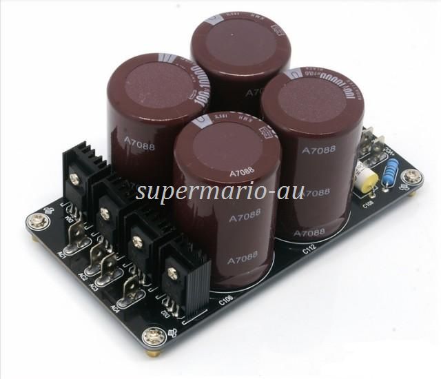

Now i before i update with pictures and details i have a question. Please sb. help cause my ignorance here is astonishing! I thought all was simple and obvious, but...

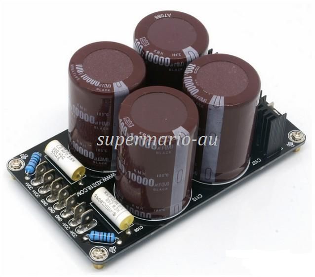

I have a toroidal transformer 2x50VAC and Power Regulator Board PSU. So one side of the board says AC1 AC2 AC3 AC4. Here i connect AC1, AC2 to the 50VAC1 and AC3,AC4 to the 50VAC 2.
At the other side it says VDC+ VDC+ Ground Ground Ground VDC- VDC-, so as i need 70VDC i connected Both VDC+ together for the + and both VDC- together for the -, but now i gave 140VDC measured between + and -. What i am missing??? i remember the time at school when + was + and -was-, something changed these years or what?:redface::redface::redface:
Attachment 12626Attachment 12641
PS: PSU problem resolved, Neale helped me here http://www.mycncuk.com/threads/7659-...9481#post59481

1. How did your succeed to have Z axis rails in the same plane? Did you use epoxy, or did you mill the 6mm plates?
The Z axis rails are in the same plane for 2 reasons:
1. When i mounted the bearing blocks first, i checked the plate with straight edge. luckily it was almost straight. Some hits with big rubber mallet made it perfect.
2. Now having achieved to mount them on a plane surface, using precision square i squared 1 raw of them and tightened them. The rails were in the bearing blocks but not attached to anything else. cause when you measure long things, its easier to detect any error.Then using digital caliper i measured 150mm, tightened the bolt on the caliper and from both sides made sure the distance is the same . Tightened a bit, then with the digital caliper made sure its parallel to 0.01mm. Little bumps with small plastic hammer helped. Then tightened it finally.

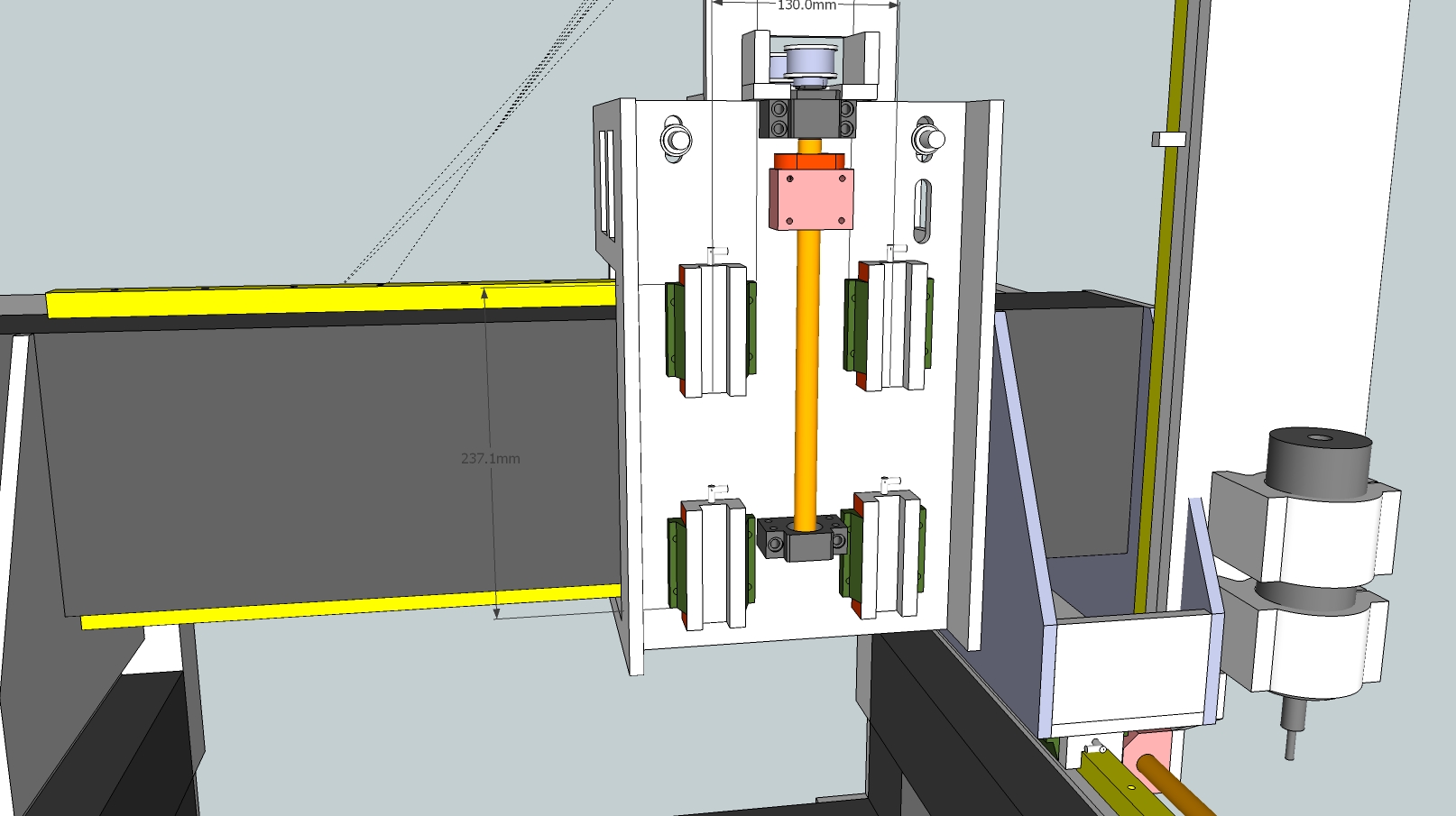

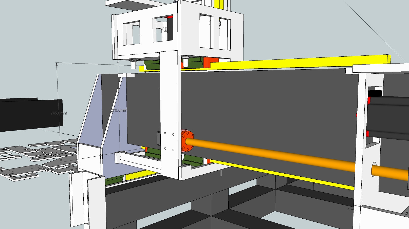

4. What is the clearance from the lower part of z axis to the cutting surface. Also what is the real traver for your z axis.
260mm and real travel of 215mm
Now, careful cause this is still unconfirmed info and just a point of view. Its just what months of mind games told me. As i said it many times in the forum, cause that's my view for a DIY really multitask machine, i seem to find that the Z to bed/ frame without anything else/ 250-260mm is perfect. With the trade off that when alu sheet is routed it had to be risen another 100mm at least, using MDF, wooden or so, ribbed or solid, removable bed or fixture.
Below is how my z plate ended. As you see the solid bars combined with the rails reinforce the plate and is very doubtful it will bend, think of bending a solid steel bar ~50mm thick and at least 50mm wide, 500mm long. Another pint here is that i use 2 spindle mounts separated at spindle both ends. So the mounts and the spindle further reinforce the thing. No it will not bend in any way.

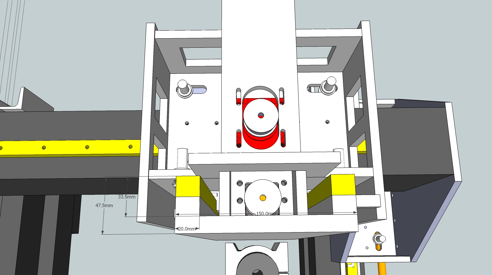

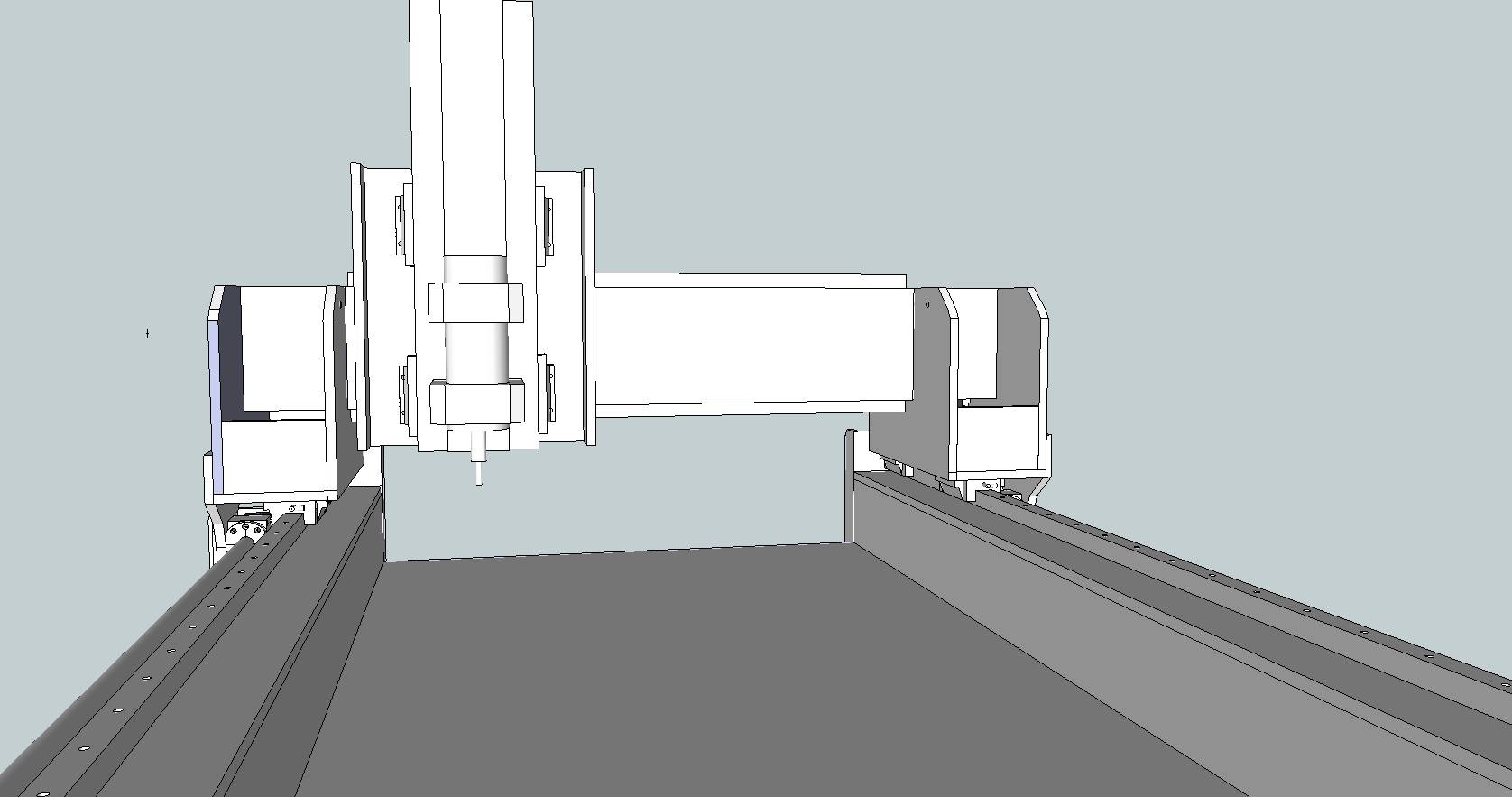

5. Finally what is the horizontal distance ( from left to right ) for y,z axis carriages and the vertical distance ( from bottom to top) for y and z axis carriages ( outer side of carriages)?
Thanks for you time
Vagelis
What i believe is the absolute minimum for a good strong machine- 240mm for the Z Spacing left right
Attachment 12685
The vertical is my minimum for such a long Z plate. The width of 150mm is the minial as i see it , again having in mind the length
Attachment 12686 Attachment 12687
Hope that helps.
Vagelis, something else.
I have been following your build with great interest, please let me tell you something. This also to the other people that aspire to build a machine. You will need to spend at least 100eur on the following things if you don't have them, to be able to accomplish the precision mounting successfully. They are a MUST. I don't see how it can be done without them and especially by one person.
Believe me on this. Not to mention the satisfaction you will feel when all is mounted precisely.
-1m straight edge or longer.Stainless better
The Must here is to be at least long enough that it can lay on both parallel mounted rails that the gantry slides on. In other words wide as your machine. Without this you will run at the moment of mounting and later at countless problems. The best will be if it has length of the diagonal of the bed or at least of the rail.
Many will disagree but Rectangular section is better than knifed edge, especially if you work alone. Much more cheaper also.
Here is my initial experience with links from where to buy. http://www.mycncuk.com/threads/6546-...o-straight-%29
To summarize it DIN 874 is the magic word. Whatever accuracy. Or Din 866 rule, especially if you go bigger machine build. Like my next one. You guessed right, i will buy at least 2 meter one.
-2x 30cm precision squares . Din 875 is the word here. these will help solder , square the gantry, the gantry to the bed, etc. Yes, 2 of them because many times you will clamp them together in clever ways.
-1x <10cm precision square , Din 875 is the word here. Stainless betterfor the tight fits, squaring the spindle, etc.
-2x cheap chinese squares
Once you have bought a really cool reference square, you go with it to the shop and buy cheap squares to use for soldering and damaging jobs. Once you reference them against the good one.
